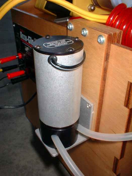

hi,
i am thinking of buying an electric pump for my field box.
i saw hobbico at about 15$, sulivan at 15 , sig at 30$ and h9 at 17$
any sugestions please?
i dont want any leaks or electric problems to start a fire...
thanks very much

Stay away from electric fuel pumps if at all possible. guaranteed you will get a face full of fuel at some point when the fuel line pops off and sprays everywhere before you can turn it off. Most of the guys at my field don't use them for that reason.

For electric fuel pumps, just remember that if you get a cheap electric pump, then you've got a cheap electric pump. I've tried a lot of them, from cheapo electric windshield washer pumps to Cadillac of them all, the Slimline Boxxer. The Boxxer is a nice electric pump, and in my experience, of the ones I've tried, by far the nicest of them all. It's very quiet, pumps fairly quickly, and when you stop the pump, the fuel stops flowing, unlike some of the other pumps. It will prime itself instantly, even with a nearly empty jug of fuel (this was a real problem with some of the cheap (and not so cheap) gear type pumps that I've had). So far, I have yet to find a fault with it, honest.
As for manual fuel pumps, I don't think you can't beat the Dave Brown Six Shooter. Used one (the same one) for YEARS, from 1982 when I started flying, up to about 5 years ago when I upgraded to a bigger electric flight box with a power panel, and MANY MANY MANY gallons of fuel. All the good qualities of the Boxxer, except it's armstrong powered
Slimline Boxxer-- About $50 (I paid 48.95 at my LHS about a year ago.)
DB Six Shooter-- $10 probably (I think I paid 9.95 for mine back in about 1982). Maybe the price has gone up in the last 25 years, I don't know. Whatever the price is, I think it's the best manual pump out there, bar none.
Both are peristaltic pumps.
Either one is excellent... If you want to go electric, I'd highly recommend that you spend the $ in the beginning and go with the Slimline Boxxer instead of what I did and try a bunch of other "cheaper" electric pumps before getting a good one. Only the rich can afford cheap equipment.
Oh, and you should NEVER have the FILL direction (and IMHO the defuel direction also) of your electric pump wired to a switch that can be left ON unattended... that's just asking for trouble, even though unfortunately this is how most of the power panels are built. The FILL direction should be on a momentary switch that you have to hold continuously. Then if you have a problem all you have to do is release the switch and the flow of fuel stops. You should never turn your back on a running fuel pump, no matter which direction you're moving fuel, IMHO.
Good luck on your fuel handling quest!

hi,
thanks for the help Brian.i ordered a few days ago from towers a sullivan pump for 15$ i think.i dont received it yet and dont know if it is a good one.you have absolute right about the switch. it is very easy to make a mistake and leave it "on" all the time. since i am new to pumps i am thinking of the posibility of fire.electricity and fuels dont seem wright together.
have you got any info on that? is it posible to cach fire if accidentaly short cirquit the motor or overheats? (parhaps due to forgoten swich to "on" position.)
thanks very much

Fire is not likely as long as the pump doesn't leak, which is what happens to most of the cheaper gear type pumps... they start to leak around the motor shaft seals, or in the pump body itself. Then, if you get fuel in the motor, along with electricity, then it's anybody's guess as to what can happen. That being said, I've seen a lot of pumps leak, but I have never seen one catch on fire, yet. Hopefully I never do.
If you're really that concerned with the fire hazard, then I would go with a manual pump. That would be the lowest risk option for you. But, like I said earlier, I've never seen a flight box catch on fire, yet, out of my 25 years flying RC airplanes. I've never seen an engine fire yet as well, for that matter. And that's where you're trying to get the fuel burning
All in all, I would say, from my experience, that as long as you stick with glow fuel, the fire risk is very, very low, even with an electric pump. Assuming that all of your wiring on your flight box is safe (no exposed wires, good tight connections, etc.) If you twist wires together and then wrap them with duct tape, well, all bets are off, if you know what I mean.
As far as short circuits, any time you have a 12 volt lead acid battery (either wet or sealed gel cell), a short circuit could make for an exciting event. Wires can get hot and burn very quickly. It's a very good idea to put a fuse in your flight box electrical system. I've got a 30 amp fuse protecting my box electrics. A 20 amp fuse might even be sufficient... I don't really know. With the starter at full stall (as it would be when cranking an engine and stopped against compression) and the power panel running the glow plug driver, I'm sure that it's getting close to 20-30 amps load through the wiring. But a short circuit will blow the 30 amp fuse almost instantly before the wires get hot enough to start a fire. I use 10ga wire from the battery to the power panel, and 14ga wire out to my fuel pump. The 14ga wire will carry enough amps to blow the 30 amp fuse before getting hot enough to burn should there be a short circuit out at the fuel pump end of my flight box (I've got a Sig Field Boss flight box with a 12AH motorcycle battery for power.)

The slimline boxxer is the best electric pump for glow fuel. Don't use it for gas! I've been using one for the last four years, regular use, no issues. Once in a while, I dismantle the pump body to clean the rollers. I bought a maintenance kit for it but haven't had any need to use it yet
I'm rigging up my own electric pump for gas using a miniature pump from Greylor

I looked up Greylor on the 'net, I'm assuming that you're using the PQ pump... just curious, if you're going to go with the 12 or 24 volt model, as the rated flow rate is pretty high with this pump. I tried a similar gear pump a while back from B&D Pumps (a buddy of mine swore that this was the holy grail of fuel pumps), but I used the 24V model, running it on the 12 volts from my flight box battery to basically cut the flow rate in half. Before it started leaking like a sieve, it would fill a 13oz tank in about 30 seconds or so. Worked pretty well (for dropping the flow rate), never blew off any fuel lines or fittings.
Oh, and if you're tempted to try a B&D pump, don't. Took 2 tries to get a pump that would last more than a week with glow fuel, Mine wouldn't draw fuel up out of the jug if it was under 3/4 full, and in less than a year it started leaking like a sieve. And their customer service is pretty much non-existant, as well as their knowledge of materials compatability[:@] . Hopefully you have better service from your greylor, I've seen some ads in MA that looks like someone is using a Greylor pump on a 5gal gas can and selling it for like $200 or something... [X(]

I agree with asmund. About twice a year I see someone at our field, who has become distracted from his electric pump somehow, pump half a gallon of fuel out the exhaust and into the dirt. I have to suppress my laughter. My trusty old Dave Brown hand pump has lasted many years and never let me down. It only takes a minute to fill a 16 oz tank.

Well i found a hand crank pump the will pump gas and its alot cheaper then an electric one so i will pump the gas manually. So no need to know much about the electric one. But the fuel pumping staion i was going to build would have has a button on it that you have to hold in to pump fuel and one you have to hold in to remove fuel. if you have a switch that requires you to hold the button to pump the fuel then your not as likley to Over fill the tank.
But i guess enven then if your not paying attention and keep holding the button you could overfill the tank. But with a switch that yuu have to hold as soon as you let go of it the pump would stop pumping so getting a face fuel of gas would be alot less likely if the pump is stopped.
But i will be hand cranking to fill my tanks
