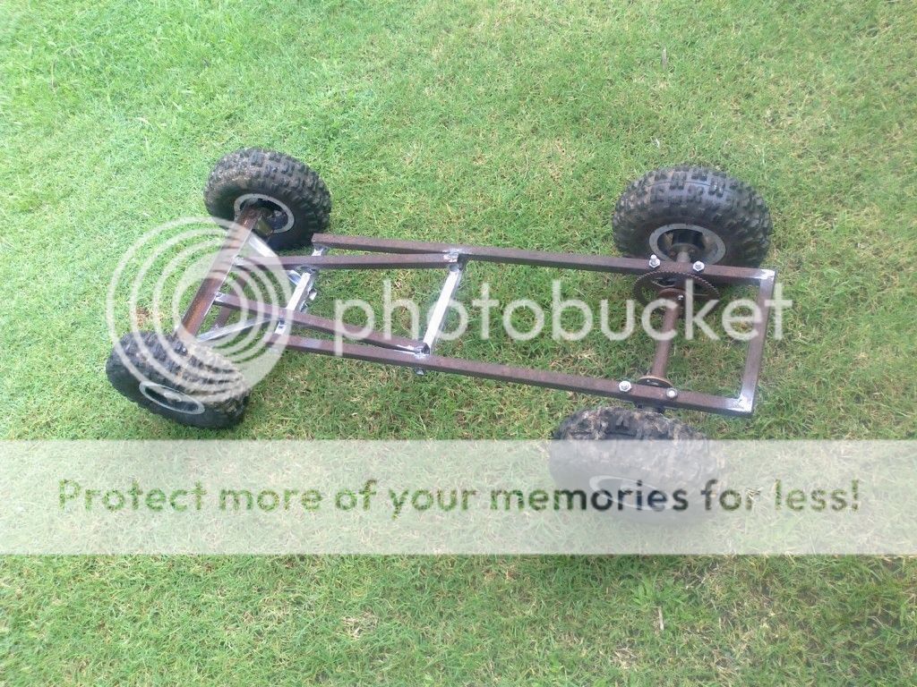

Well I've started this build, and really I have no clue what I'm doing. I'm just sort of running around trying to make this work. Anyways I don't want to re-explain everything I'm doing since I have documented most of it here : http://traxxas.com/forums/showthread...Y-RC-Car-Truck .
Basically I'm trying to build a large electric rc on the cheap, but I'm worried about my steering. I know it's not the best set up but its what I came up with, but there is a lot of drag. I was wondering if you guys had any tips for me, I'm fine re-working the whole system, but I'd like to keep it on the cheap side.
ps. you can just skip to page 2 post #51. Thats where the first pictures of my steering are.

Are there bearings inside the steering knuckle?
If not, you will need to have some in there.
If there are, I'm wondering if the steering knuckle itself is rubbing against the chassis where it's mounted?
Washers between the centre part of the bearing and the chassis will help.
Also, the axle is really quite long.
The distance between the knuckle and the center of the front wheel could be shortened.
Try to make the front crossbar wider and get the knuckle closer to the wheel.
Hew flexible is that angle steel you're using?

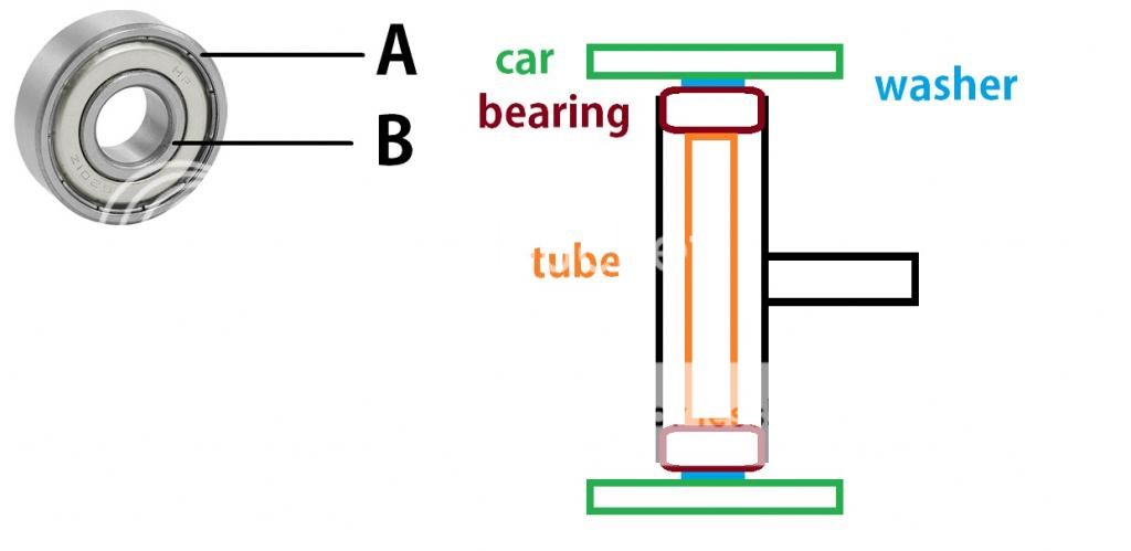

Maybe this pic will explain it a bit better
Bearings inside the knuckle, preferably a press fit.
Part A against the knuckle and part B has to move freely.
Note the washer between car and bearing.
Same size as part B.
A tube between the two bearings, the same size as part B will help stop the bearings "pinching" when you tighten the bolt holding it all in place.
Also, look at making the frame narrower to allow for the wheels to be mounted closer to the knuckle.
This way the front wheels will turn tighter, rather than moving in such a big arc.
Or take it in like I've done here:
Hope this helps

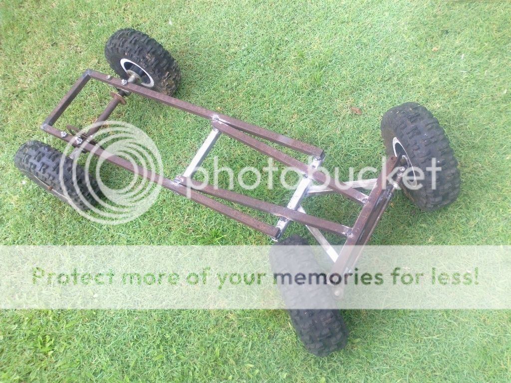

Thanks a lot,
Yeah I don't have any bearings in there, but I haven't been able to find any that might fit in there. Do you any good site where I might be able to find some?
I'm not quite sure what you meant about shortening the distance between the knuckle and the center of the wheel though. As far as narrowing the frame goes, I probably could do that, but right now it actually doesn't rub the control arm. The hub of my wheel rubs the axle housing.
When I started building the angle steel seemed pretty rigid, but I can tell it flexes a little underneath the weigh motor and everything else.

Most of my bearings are from things I pull apart like old drills, angle grinders etc.
I've got a good scrapyard just down the road.
I also buy some from a local bearing shop when I need bigger stuff.
What I mean is shorten the axle the front wheel sits on.
See how close to the knuckle my front wheels sit in the pics compared to yours?
The wheels in the first pic I bought online.
They're some kind of 1/5th scale monster truck wheel.
Not very good, the glue lets go and they are hard to mount securely.
The ones on the big rusty one are from a pocketquad.
As is the rear axle.

As far as getting my wheel close the knuckle its actually about as close as it can get to it. The pictures i have of it are without the nuts holding them in place, so they kept sliding out. But with he nuts on there the hub of the wheel is within about 1/2 inch of the knuckle.
Ah yes I see what you mean now.
I got hung up on the pic where it's sitting on an angle and the wheel has slid off.
