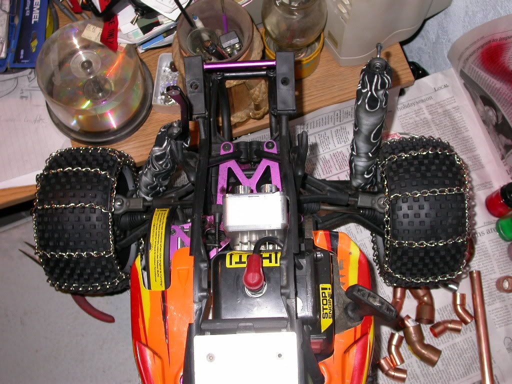

wassssup all? due to the increasing white stuff (SNOW) i have 2 ideas to keep me moveing this winter. first is an idea a member of the bajaforum posted about, so i did it. looks like this
which then looks like this
and finally takes on this appearance.
The other mod i ll be starting this weekend. first is a set of custom paddles as ive posted b4, then in addition will be a set of skis if i can get them to work, i think either of these 2 mods could keep things FUN FUN FUN this winter.

Nice work! What did you use to attach the copper tubing inside the larger one, as well as to the Xcan?

that and the pic of that sweet muffler Hellya posted is where i got the idea. THANX!
ah how did i put the 1/2 into the 3/4 is the ? of the week. ANCIENT CHINESE SECRET!! Lol no. its actualy VERY Easy. use a 3/4 to 1/2 reducer bushing for copper pipe! VIOLA. done. to fit to the XCAN i used a 1/2 to 3/4 adapter into a 3/4 street el, the bushing inside the El and the 1/2 in the bushing. the trick is you need to use 1 reducer bushing and cut it in half, so you have room for the 3/4 pipe to cover the 1/2 pipe. this all copper set up is fairly heavy though. im looking at useing alum. pipeing, but its not the same as teh copper as its 3/4 measurement for the aluminun is O.D. and with copper its I.D. so im still looking for the correct adapter pieces to get the weight down some. then 2 1 in pieces of silicone tubing to put the can and the extensions together and zip strip them. i also fabbed a hanger to go to the original hanger position to help hold the extensions solidly in place.
the stuffing is my only draw back at the moment. i deffinatly want to use some, for dirt more than anything. but finding the right material has been a bit of a pain.

Nice chains, but will they make any difference with tires that have that tread?

yes, they did make a differance. rather noticable too. snow was heavy and wet as its warming up. still about 3 or 4 inches deep. i was getting along pretty good, then as i had susspected, the pressed together links let go in a few spots and tossed both sets at the same time, i just did a powerslide, and gassed it as i was still sliding backwards, the tires hooked up n both chains went sliding off the tires. so all the links will NEED to be soldered solid if you plan on useing this type chain. im not sure i can find a better chain, without adding a crapload of weight.
But while they were on, ya, they Deffinatly helped alot.
