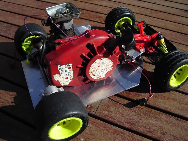

Hi there everyone, I would Like to share with you some pictures of my homemade creation:

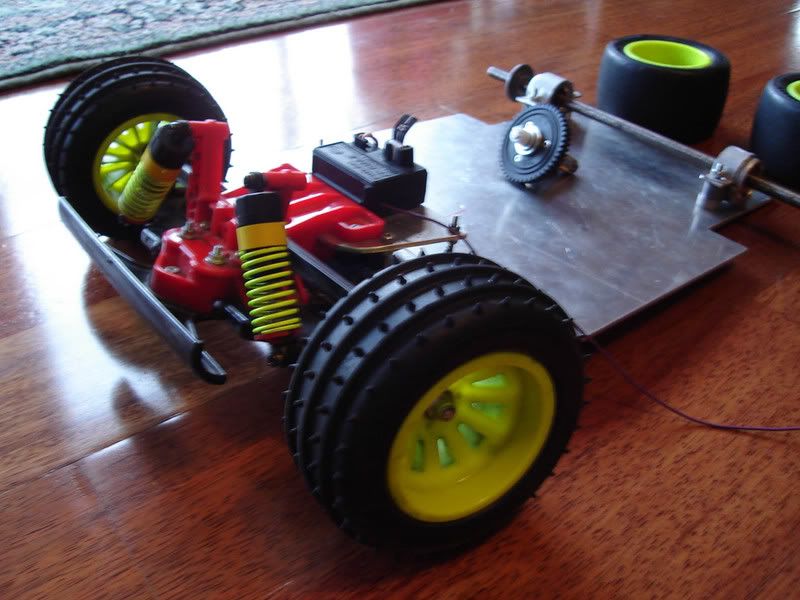

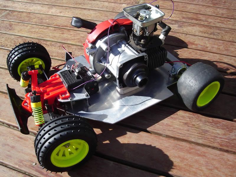

engine is a kawasaki 18cc
chassi is made from 3mm thick high tensile aluminium
front end is off an electric powered off road rc car
fuel tank is a small poweraid bottle
rear wheels are from a hardware store (you can see they're already going bald from doing too many burnouts )
It has no breaks at the moment
It weighs about four kilos
has all standard electronics - no need for special steering and throttle servos.

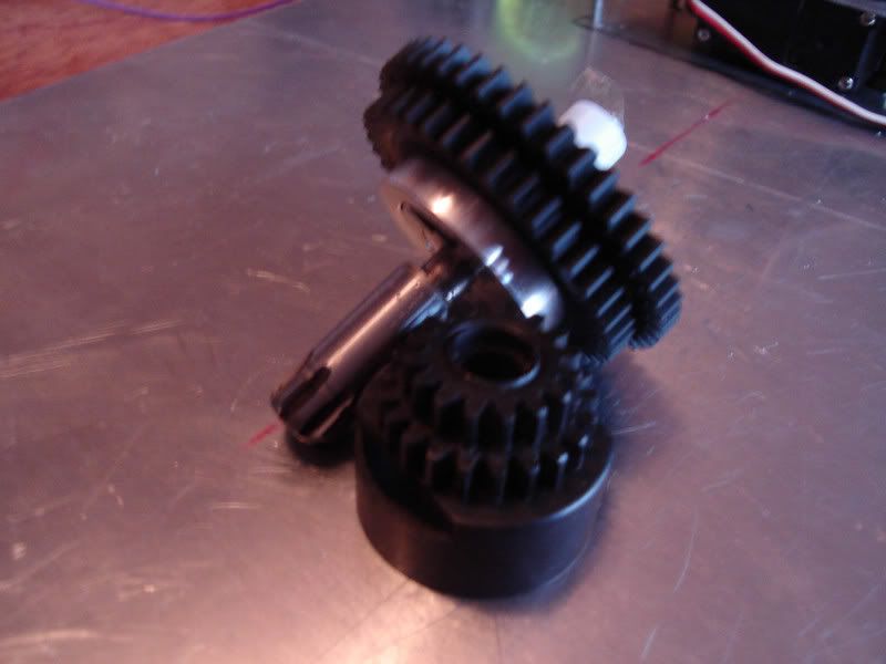

The front sprocket is six tooth (from a pocket bike) and the rear sprocket is a 28 tooth (from the cam of a four stroke dirtbike engine). The wheels are about 3.7 inch in diam. This car has VERY good acceleration and top speed. The steering is the part that amazed me the most, as it is just as good as any of my other RC cars. The only problem is that if you turn too tightly and give it too much throttle at the same time, it flips over. I am going to fix this problem by lowering the engine and rear end of the car. Another thing I have to do is add breaks to it. Even though I have not yet gone to top speed with this thing, I am fairly certain that it will go between 60-65 km/h.
The rear axle is just a solid piece of steel bar that has the wheels and sprocket hub pressed onto it.
Tell me what you think!!

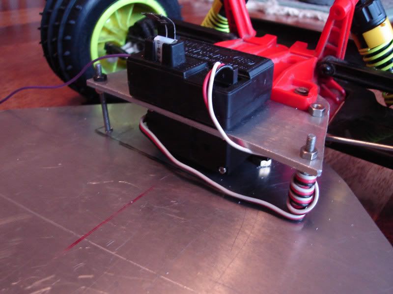

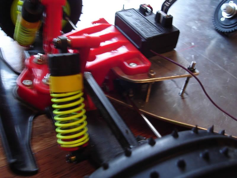

Thanks for the replies everyone. This first car was just a practice model. I am now in the process of making a new rc car that has a stronger, lighter and better looking chassis. The engine is going to be a 22cc echo hedge trimmer engine. Here are some pics:
The front end of the car this time is mounted to the frame and also a second plate, which also holds the reciever and has the steering servo underneath it. This time the chassi is 3.5mm thick. The rear end has a completely different setup, the axle is smaller and the bearing mounts are different. The front end and wheels are also off a newer and better car
These pics are a bit outdated, because I have since mounted the sprocket on the axle, mounted the fuel tank and alsomounted the engine.
I have one question: Do you guys think that this 22cc 1hp engine would be too powerful to use with the transmission of a 1/8th scale thundertiger buggy? (the car is the thundertiger S2 PRO and all the gears are hardened steel)
Thanks!!

i dont think the engine has enough power to damage those gears .. a good .21 nitro motor has more power then the Echo engine .
nice creative work ... its great to see people using there head for other then a hat rack ..

are you planning to put some suspension at the rear as well?

Itd probably make a difference and make the car go better, i think...

For the body, I am just going to have a rollcage with pieces of aluminium plate rivitted onto it - much like the sand-rail type buggies.
I am not going to have any rear suspension because it makes the car more difficult to build (I only have basic tools: cordless drill, files and a hack saw). To compensate for having no rear suspension I have tried to keep the weight down as low as possible.
Once this project is finished I will be converting my thunder tiger nitro buggy to petrol powered, because the engine on it has siezed and I don't want to waste all my money re-building it. Soon I will have some progress pictures of that project uploaded too.

I see you dont have rear differential, its bad for stearing, you will have over-stearng
