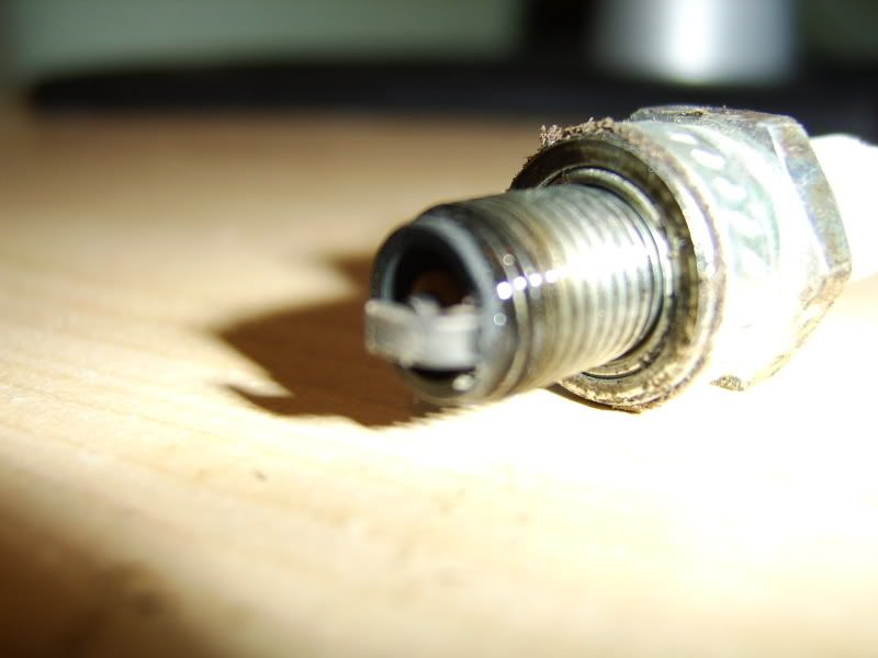

I just got my baja today and the spark plug is black. Is it to rich? looks like carbon on the plug and on the cylinder. also, there is no smoke? what gives, i richened it up some but still no smoke. it is just like my weed eater no smoke. what is factory settings for the carb?

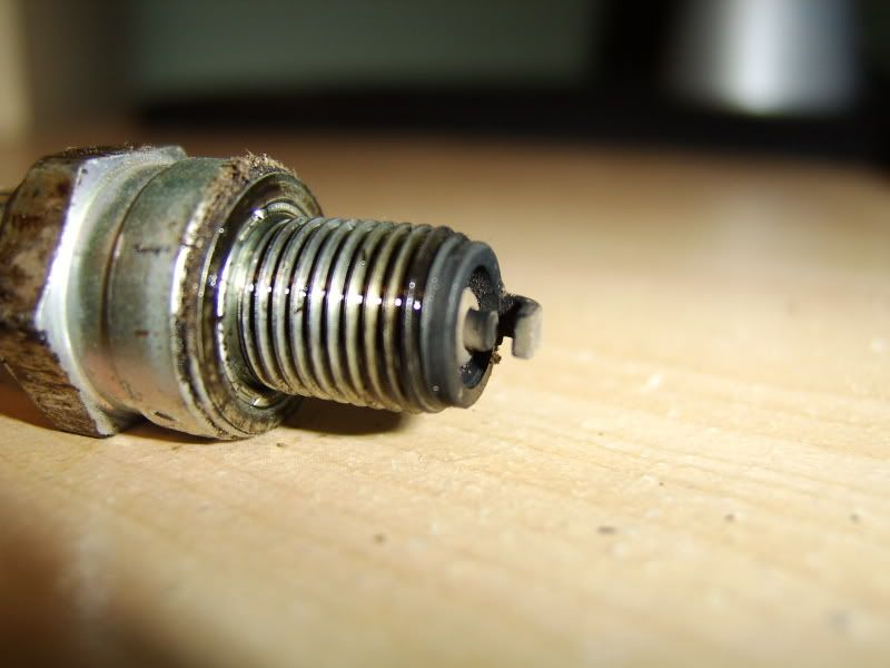

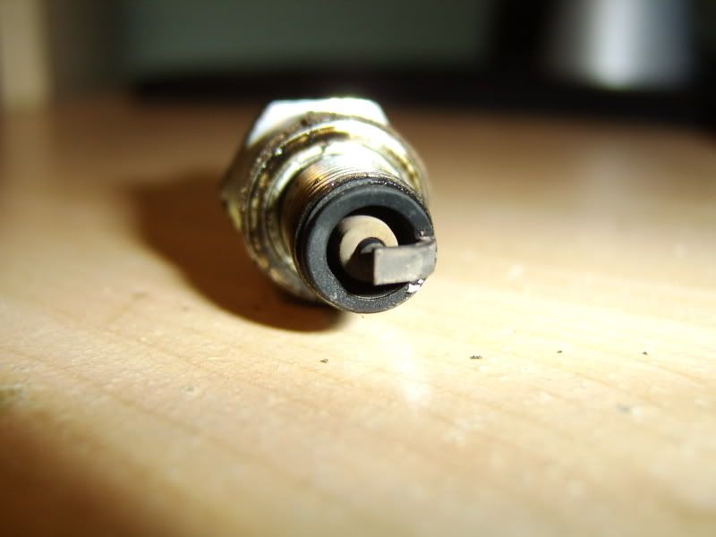

Default RE: Black Spark plug= what
Pics
that plug looks rich on the low end
looks fine to me a little rich thats all no problem
Looks just fine to me.
How long have you ran this engine for ? Chances are it is still in teh BREAK-IN time frame of the first tanks of gas right ?
On the FG I have I run 25:1 right now, and rarely see any smoke except when I start it and engine is cold. Once warmed up, I see nothing.
