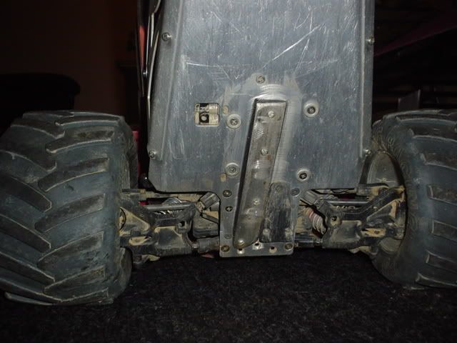

So I have a FG MT for about 4 months and over 10 tanks of fuel. I have broken about 7 or 8 lay gears/large diff gear teeth over this time. I have found I can break one just about every time I use it if I am not careful. Yes I do drive this thing like I rent it and breakage is to be expected. I know what breaks the gear and how to prevent it but I just don't like to let off the throttle over uneven surfaces. So I make changes.
I stripped my FG MT down to the bare plate cause it was dirty and looked like this.
But just before I did strip it down I did some thinking, I found that the reason why my two rear most gears are pulling or walking apart and then snapping a tooth off is Obviously because of flex. So I took a pry bar and pry'd the two gears apart....I found it was not the plastic stock engine mount flexing or the plastic stock diff housing but the weak lower plate or tounge section flexing and allowing these gears to pull apart.....esp during accell when the natural wheelly force is pulling the whole frt up.
First I tried tieing the week points together and still allowing the flex but the goal was to keep the gears from pulling apart, good results but would still break a tooth off. But alot less often. Using a column Eye bolt I secured from the top of the large engine mount to the rear diff.
Better but not good enough cause I am done with this rear flex and buying gears. SO next
Now I have a bit more weight but Zero flex and so I purchased AGAIN more gears, set the mesh and drove the truck hard. NO breaking and I know forsure I would have broken before-No doubt I would have broken one before. I have this large section bonded and bolted to the bottem and one on top 1/2 its size sharing the two middle bolts on the top of the alluminum plate.
On a side not it also will wheelie easier cause the body is now more ridgid.
Sorry bout the spling and gramer.

Just noticing, You still have the stock rear upper controll arms. How in the world did you manage not to breake those yet like everyone else
Also is that the stock gear carrier i see or is it just that dirty??

After doing some searching it is odd to find that some people break completly different parts over and over then others. I would estimate 15 tanks atleast of fuel through my FG MT. And I only keep breaking the 48 tooth steel lay gears and I pulled out a frt upright. Yes I am still on both my stock rear upper control arms and have not yet broken my large plastic gear either. I have NO alluminum upgrade parts and all are still original. I have alloy engine mounts and servo saver ordered but not yet arrived. But I was convinced my problem was flex of there lower plate at the rear, and it was!

If you change the rear upper arms to alloy, you will remove a lot of the flex when you jump. This will spare your spur gear and it will last a lot longer. Also change your spur gear carrier to alluminum and that will help also.

check your layshaft also, that may be bent. If it is bent upgrade to the hardened version.

This is the repair required if you are breaking teeth like I was. Re-inforce the rear section with a small strip of steel or other alloy, bonded and/or bolted to keep the rear section from flexing.
I have not broken another gear since and I would no doubt have broken 5 or 6 by now!!!

Countless tanks of fuel through this FG MT and since I put this bracing under the truck and a matching one 1/2 its length on the top I have not broken or chipped a rear diff or pinion tooth. Now my brother has a FG MT Jeep with out a brace and has not experience the same problem I did. Maybe I have a poris or poor quality belly pan. Before the brace I could not get a tank of fuel out of the large gear on the rear diff no matter how tight I ran the mesh. Now Zero problems even with poor overlap of the gears. I now have Cat5 gears off the bell so no more melted plastic
The gears get driven hard.
You can see the bracing under the truck.
Hope this info helps.
