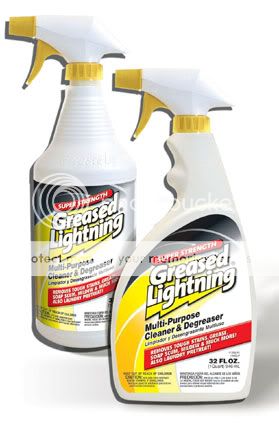

Greased Lightning! It is the best and safest way to deadonize the aluminum. I got the trick from Baja Planet's forum.

did you paint over it or did you leave it bare?

They are bare...less maintenance that way for me...

is this the stuff?

can you spray it on and then wipe it off, or does it need to soak?

You soak and agitate the parts in the solution until the color comes off...then rinse and wash with dish detergent. It typcally took about 1-2hrs depending on the parts and how well they were anodized.
