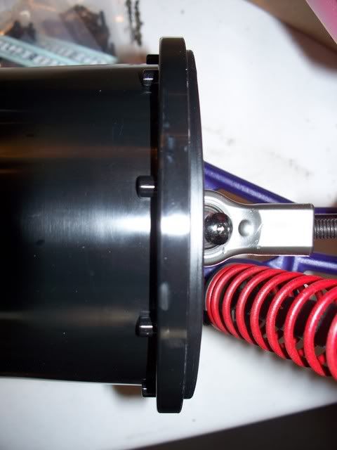

well here is a slight problem there 2707-03 wheels (the 5t conversion wheels) do not fit on the front
the offset between the HPI wheels and the proline wheels are only 2mm diference.
but the 2706-03 wheels do fit perfectly
also the screws that come with these are BIGGER then the stock HPI screw 3mm heads
and they also stick out of the beadlocs on the fronts(outers)

Matt, do you have front extenders on your baja? That would help to make it fit.

No I do not.. according to Proline I should not need them. I already sent them an email. they said they fit their cars fine without extenders??but the proof is in the pics.. all the parts are new on the the front hub area new axles,hubs etc it is all in stock form...I sent them pics still waiting for a reply back....

they do fit perfectly with my Vertigo Performance axle extenders but I had to remove my cable brakes to use them[]

I thought they came with different offsets front and rear to widen the track on the front to the same as the 5t as they're the conversion wheels (front and rear track is then the same), what happens if you swap them around do they fit then? I want some for my rampage but 2 pairs of the front wider offset ones

No they do not fit unless you use an adapter
this is what happens if you do not use an adapter it hits the front steering arm, we've know this before with the ORIGINAL b5 rims that you cannot put them on the front, so I do not know what proline was thinking? the proline rims are 75.45mm wide and the HPI rims are 75.02mm wide.. I showed the offest difference above..
