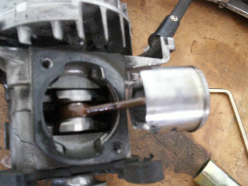

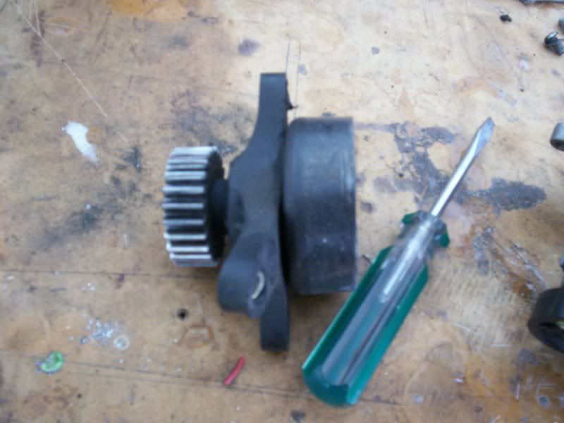

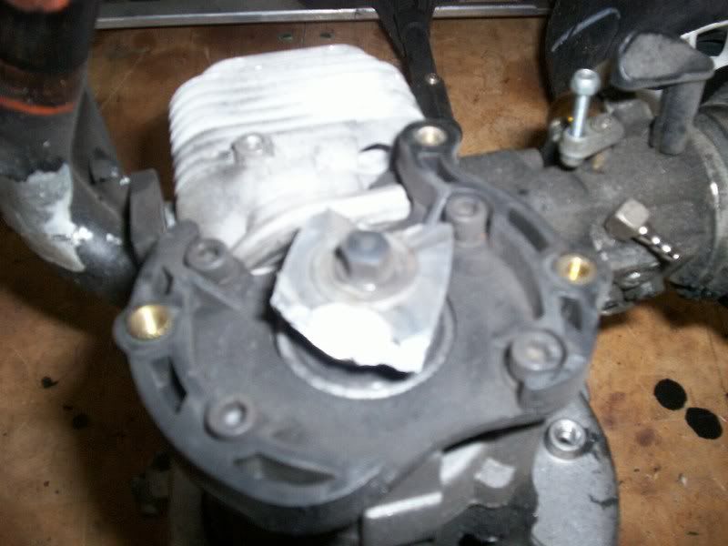

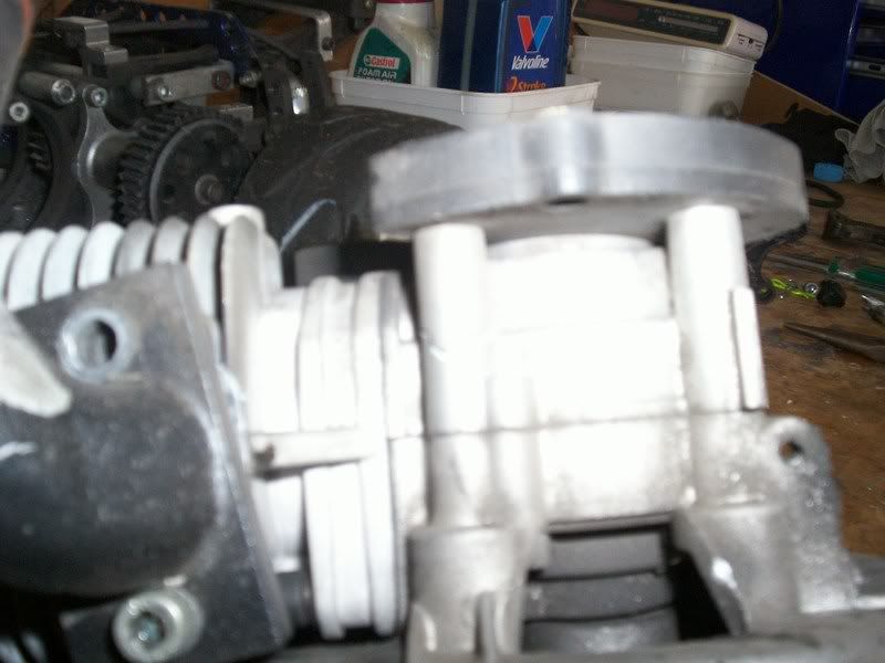

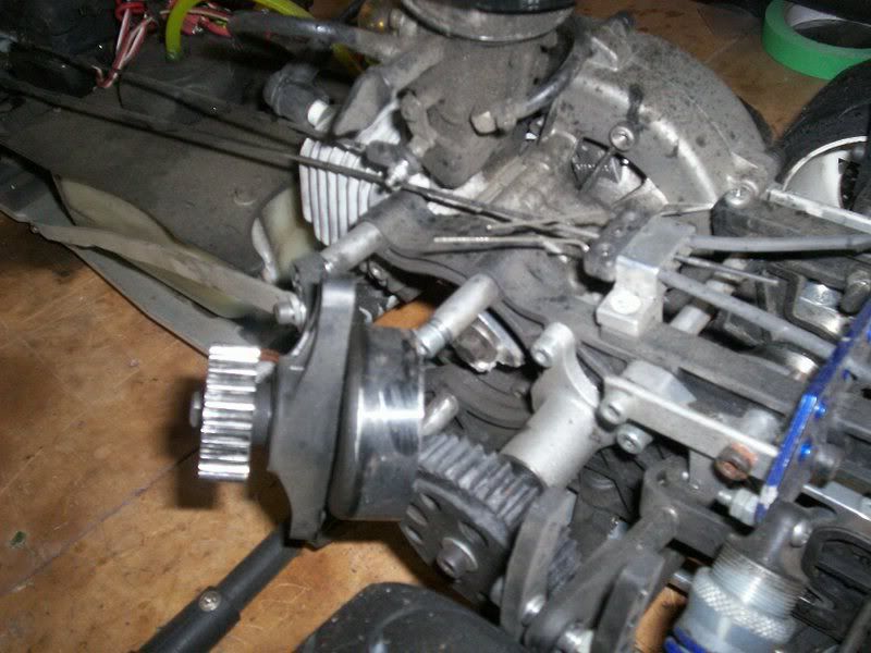

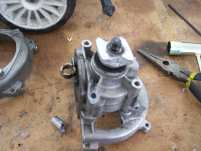

well we were out bashing out on road cars today and mine got a mind of its own and run off mounted a curb at full speed aprox 79-80ks rolled a few times in the garden ended up upside down at full revs and b4 i got to it the clutch had exploded sounded like it was doing 20,000+rpm
only bent the bumper and broke a lower front arm the rest of the car is ok
this is what hapens when ya over rev a engine
ok broken bits are
clutch
clutch bell and carrier
broken crank case
bent crank
bent fly wheel and missing fins
cracked fan cover
striped engine mount threds
the head and piston look ok ;D
and the pull starts still ok ;D
any way heres some pics

it wasint the impact that did the damage it was from over reving with out load the clutch exploded

my radio was not the prob a wire cam off in side the servo making it go to full throttle
