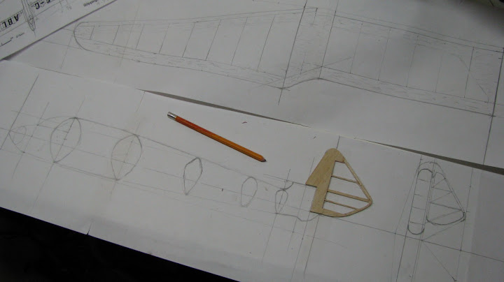

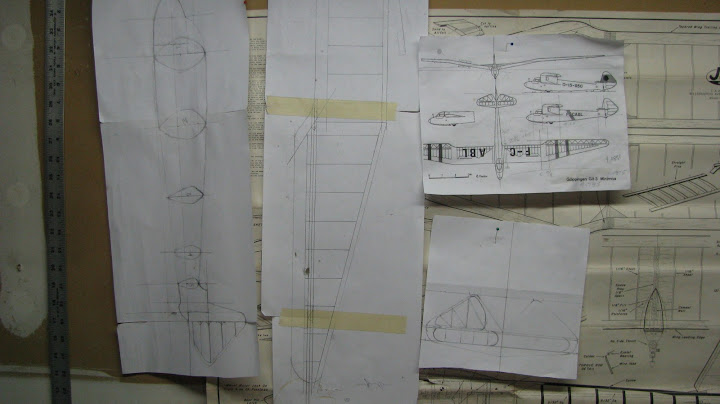

Anyway, here is a 48" Minimoa, I scratch built from a 3 view I found on the Net.
It uses 3 servos, 2 aileron and 1 elevator.
I still have to hook up the elevator, it is proving to be difficult due to the ideal exit point for the push rod is just a little low and inside.
Enjoy...
First my funky hand drawn plans, I came out with multiplying everything by something like 4.085, pretty goofy I know.

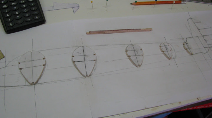

I fiddled around drawing bulkheads in a teardrop shape until I was happy, then I just took the biggest one and drew smaller ones keeping the keel and main side stringers the same. (I got to get a cad program...)

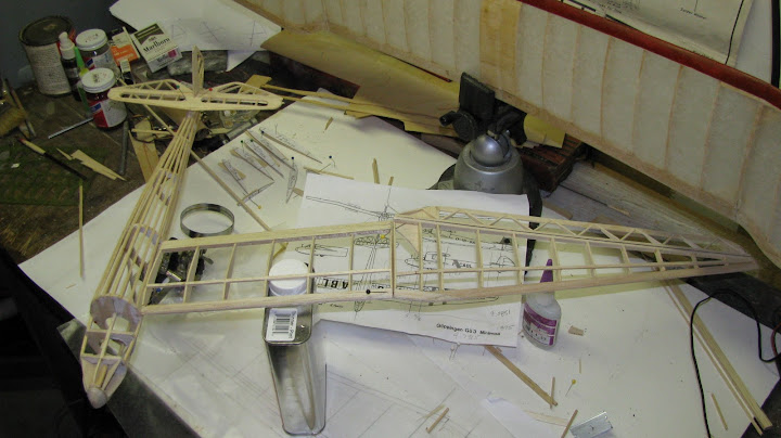

I haven't built in about 8 years. The leading and trailing edge was cut from some huge TE stock I had on hand from the old days. WOW, it looks heavy...
After some sanding I dont feel so bad, it is looking rather light.

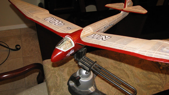

Still some more painting to go. Started playing with the printer, the markings are just tacked on for photo purposes. I have some old printer decal paper but I need to take it to some one who has a laser printer.
Those are my initials and birth date. Also note the flying Hog on the nose.
I also made the canopy hinged. I still need to figure out how to latch it.
I hope to fly it this weekend...I will put out an update.
