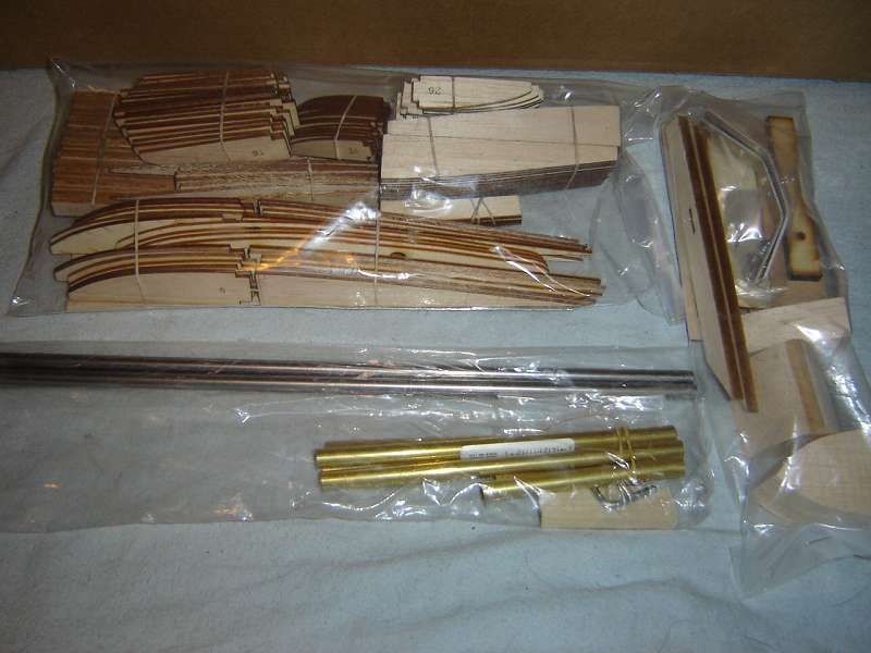

Ya Hoo! Today I received my Cloud Bound 4 kit.
Lots of nice lazer cut parts and all the goodies. No clear canopy but I will buy or make one later.
Tonight I will clear off my workbench and study the plans and instructions.

Hey Mike, went back and enlarged your pix. Looks good, two questions, Does your plane have a wood fuse? and what are those two alumm. pieces that look like landing gear to me for? Are you going to build it full house ie: flaps, ail etc. or something else? Woops that's three questions isn't it. How about a forth, whats the wing loading?
Rick K

Yes, the fuselage is all wood with probably over 100 parts!!!!
The pre-bent aluminum plates are for the V-Tail.
I am thinking of using flaperons. One servo in each wing. Maybe spoilers too?
The advertised wing loading is 9oz/sq. foot.
I was disappointed no supplement instructions for Rays modifications was included with my kit. Later I discovered there is a 3 page parts list with information on Ray's modifications included with CB4 kits. This was missing from my kit and Ray emailed me a copy.
Now that I have studied the plans and instructions I am realizing this may be a difficult kit to build. This is not your typical kit with step by step photo illustrated instructions. All things considered, I should have this kit finished in a couple weeks! Ha ha, maybe a couple months!

I got my cloudbound4 back in December of 2003 and am still putting it together. I was pretty much done with the major building in late May, but have been having issues since.
Here's tips I'll give (aka - where I messed up)
1) I thought each wing was in three pieces (a double polyhedral) - the wing being separated by two pages on the design is not meant to be a seperate polyhedral - they just ran out of paper!!!
2) The spar joiner between the polyhedral is "WAY" to short (1.5 in on each side). I landed just a little hard on one side and the two pieces of the wing split (my Aspire ARF handled rolling down the field on wingtips - when I was first learning to fly) - to get around this, throw out the little joiners and have the polyhedrals joined to the second rib on each side.
3) I'm having to take the covering off the back end now because I had to put a full pound (16oz) of weight in the nose to get it even close to the marked CG point (granted you need to fly it to get the CG correct), but without the nose weight , the CG was two-three inches behind the spar)
Some suggestions - 1) make sure to look at the tips for building the fuselage on Ray's website - I was doing the diagonal braces on the horizontal (like on the plans) - but Ray has pictures where he's just doing a few verticle pieces between the longerons. 2) I saw this neat trick in Quiet Flyer where they had a pull string and a spring on the rudder - really light weight as compared to pushrods/linkages. Maybe something like that could be rigged up
I set up mine with flaps and spoilers and dropped the drag brakes that are shown and just built the wing out at that point.
I didn't know much about building before this, but after all the mistakes I made, I sure did learn a lot.

Thanks for the tips David!
Wow, 16oz of nose weight! The original RCM construction article says the model required 4oz nose weight. Your model is much more tail heavy than the original.
I don't understand your tip #3. Why are you taking the covering off the back end?
I am still inhaling all tips and possible modifications before I begin construction. Probably will start on the fuselage this weekend.
If possible please post a picture of your Cloud Bound 4!
Cloudbound, Mike
