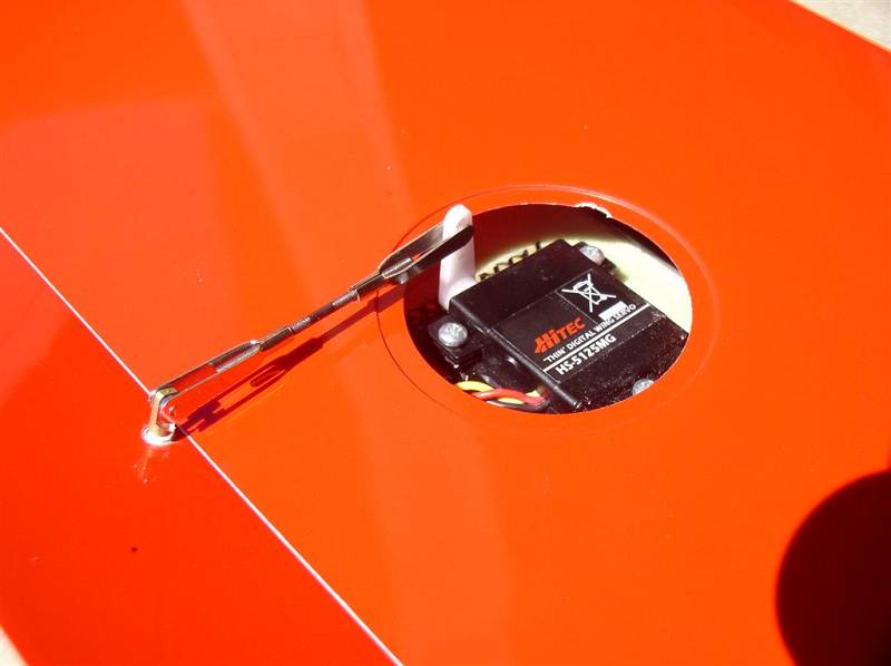

Flew my first flights today. Had two experienced pilots with me. The new bird flew great but had a flutter that only appeared to occur out of a shallow dive, not high speed and not under power. The other pilots said a couple of things about the linkage, but it appears to be slop free. One of the pilots pointed out that the servos did not appear to be locked in, in other words, they had play around neutral center when they should have been rock solid stiff. Ther servos are Hitec HS 512mg. No other problems, flew well and didn't even need to trim it. But, this is my first fixed wing and I could have overlooked something newbe-ish, so veterans, please help me out.
Attached are photos in case that helps.

I'd like to wax eloquent about a couple of things in your pictures.
I noticed that you have threaded ends on both ends of the connecting rods. Both clevis are threaded and free to move right?
Neither clevis can unscrew/screw because they're trapped by the horns BUT........ the rod can do whatever it wants, and just might. I landed a big 4Star the other day with the connecting rod on one aileron dangling in the breeze. So was the aileron. The rod had screwed itself deeper into one clevis and unscrewed from the other. The plane's owner had forgotten to tighten the lock nuts on the rod. The other aileron connector was almost out as well. Wonder what it'd flown like with both ailerons unhooked?
If I were you, I'd epoxy one clevis to it's rod. You've got way more than enough adjustment on one end.
Just a suggestion.

About your horns......
A couple of suggestions:
It is always worthwhile to have the servo arm connection closer to the servo and the connection on the horn on the surface farther from the hingeline. The idea is to give the servo the mechanical advantage. It's also worthwhile to give the surface less mechanical advantage. The way you have your connections, the servo has the least advantage to move a horn that is going to have even more advantage resisting that servo.
I would suggest that the leverages that're present will contribute to the problem you're having. They will also help the aileron flutter beat the servo's gears to death.

It looks like you've made excellent choices of hardware. The aileron horns look especially good. They'd be even better if they were longer, but what the heck.
You ask about using metal servo arms. No real advantage since that application really doesn't need that much strength.
Actually, yes, but maybe in a surprising way. Every aerodynamic structure will have a specific flutter speed, even a bowling ball. The "airfoil" that resulted from the deflection could have been in "flutter speed range" at the speed you saw the flutter, whereas a "straight" orientation could have been outside that speed.
BTW. Every surface has a flutter speed. But sloppy linkages introduce new and wider flutter speed ranges for those surfaces.
and flaps were still down a few millimeters neutral. Could this contribute to the flutter I experienced?

The basic hardware looks to be up to the task...
Get rid of the dual clevises.
You only need adjustment at one end.
The connection to the surface. What is that? How securely is it installed?
I've had something like that flutter the wing so badly the slip-on nose cone on the glider came off in flight!
You mention it's a moldie.. the whole servo as mentioned could be moving with the skin.
Pack some stuff around the servo.

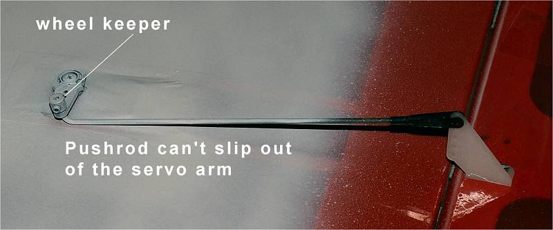

I use a Z-bend or a plain 90 degree bend with a wheel keeper, at the servo end on most of my planes.
The yellow is my Stick-It V.. and the other my Somethin' Extra.
Neither flutter, and the pushrods can't rotate.
With your surface connections JBWelded in place, that should be good enough.
The "stuff" around the servo would be balsa.
Or if nothing else works, pull the servos, mount them on a large piece of plywood, and then reinstall in the wings.

If I understand you correctly, I should move the linkage on the servo arm inward so the servo arm is effectively shorter?
You always want the connection to the servo arm "shorter" and the connection to the surface's horn "longer". And you always want your computer radio to have 100% throw on every servo, no more, no less. That's the most efficient, effective situation for the servo. If the connection on the servo arm is as close in as possible, you'll get whatever power the servo can deliver, and it'll deliver it with the most accuracy. If you have that close connection, the next problem is simply to set the connection on the surface's horn so that full movement of your TX stick gives the recommended surface deflection.
With your existing components you will probably have to swap out that aileron horn to be able to shorten the servo arm connection because that short aileron horn is going TO MOVE THAT AILERON a lot being that short. And if you shorten the servo arm connection, the pushrod movement might not be long enough. There is no rule that says you have to use only the stuff that came in the kit/ARF box.
As you've set up the connections, you're using a fairly weak servo and then putting it at every disadvantage.
If it was my airplane, I'd replace the aileron horns with longer ones. What do they cost? a couple of dollars? Then I'd reconnect the pushrods on the servo arm closer to the servo. Then find out where to make the connection on the aileron horn to get adequate deflection.

Regarding some 'stuff' around the servo...
It's really simple to see if you have that problem. Grab the aileron and hold it so it can't deflect. Move your aileron stick on the TX. This will not only show you if the servo is solid, but it'll also let you feel if there is any slop and where it is. You can feel or see if the clevises are loose on the rod, in the horns, or if the servo gears are not tight or whatever...........
If all the connections and gears are tight, and the servo flexes, check out why. Are they taped down? tape giving? Or is what they're attached to flexing? If so......... stiffen the structure around the servo..... etc etc
edit..... oh wait, I just looked at your pictures again and noticed the servos are screwed down. whatever.........

RE: flutter in aileron and flaps
ORIGINAL: Tall Paul
THe servo has x amount of torque available.
Moving the pushrod out from center increases the moment arm, which increases the push available to the surface.
Force times distance.
torque = force x distance
force = torque/distance
Doubling the length of both horns will not change the servo to surface motion, but it will halve the pushrod force.
The effect of clevis slop will also be halved.
In contrast, doubling both horns will not change the servo gear slop or servo resolution. To improve these, increase the servo throw as much as possible (to +/-45 degrees or more), by making the surface/servo horn length ratio as large as possible while still maintaining adequate surface travel. In the original photo, the surface horn looks too short, and the servo horn looks too long in comparison.
My Feedback: (31)
Join Date: Nov 2004
Location: Dalzell, SC
Posts: 1,411
Obviously they don't understand levers or mechanical advantage. Think of tightening a bolt. The the longer wrench you use the less torque you have to apply to move the bolt, Same thing with a servo the closer you are to the rotational center the higher the torque the servo can handle to hold the arm still, the farther out the harder it is to hold the arm still, it's simple. That's why we use a 1 to 2 or so mechanical advantage when we set up our airplanes. Out on the servo arm gets you more throw and less torque and less resolution. In on the flight control surface gets you more throw and less mechanical advantage.
Join Date: Jun 2006
Location: Fenton,
MI
Posts: 68
I think I've got it. (if only I had paid attention in that vector dynamics class I took about 20 years ago). It appears to me, after reading several very informative replys to my question, that I have set myself up in the worst way possible; very short control horn on the control surface and relatively long servo arm.
I already have my order in for replacment, longer control arm for the control surface and when those come in I will be moving the clevis on the servo inboard toward the drive output of the servo. The lugwrench analogy was very insightful as were the drawings.
I'll post the results as soon as I can try out the recommendations
