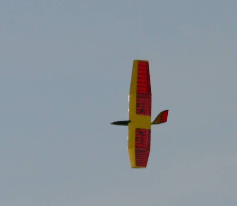

Thought I would show you my plank wing for thermal flying. It is an my enlarged and updated version of David Jones's Raven 2M. My Raven 2K is 100" span ( 48" center section with 24" tips). uses a BW050209 airfoil and is wood with 1/2" carbon tube spars. It was a good flyer till it rekitted itself on launch last fall. A new 120" version ( 48" center section with 36" tips) is on the board and will fly next spring.
Edg :-{

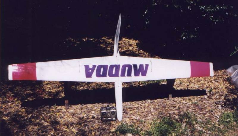

You should google images of Scott Hewitts "Mudda", which is a 100" slope plank, similar in appearance to the Zipper. VERY fast. In the Dave Reese video "Lift-Ticket" theres some video of it ripping up and down the coast in Santa Cruz very fast. A 3-meter one would RIP. Do you have any spots for DS'ing where you fly? Planks excell at it.
