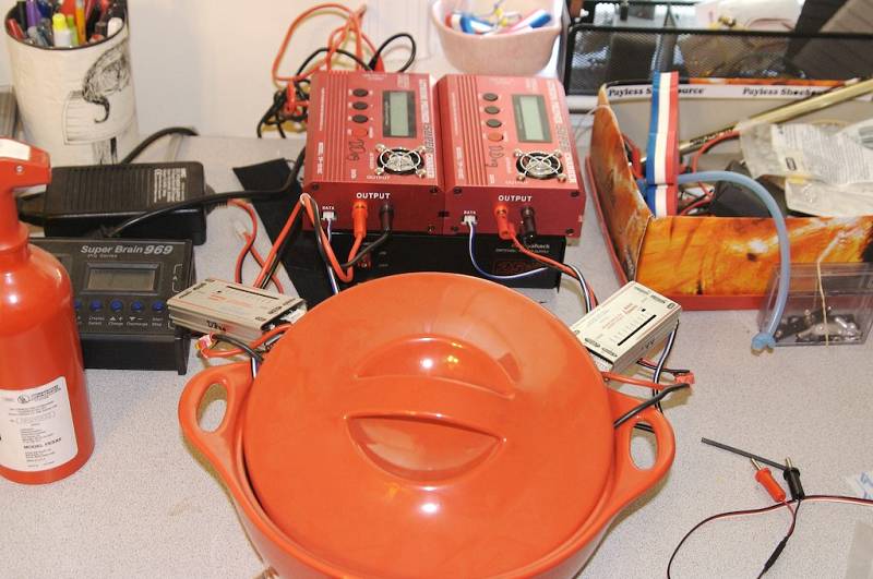

Every fire I have ever heard of is either:
- Cheap/Wrong Charger
- Cheap Packs
- No Balancer
- Trying to charge damaged packs
or a combination of the above
I know pretty much the whole Flightpower Team... we have probably charged 1000's (if not tens of thousands) of packs and I do not know of one incidence of fire.
BUT I still charge in a ceramic bowl with a lid and keep a fire extinguisher handy

ksechler...my brother in law lives in Frederick near Liganore HS. But anyway I guess what I said was hypocritical about skimming. My $300,000 investment is worth a whole lot more than $500. Where do you get a ceramic pot with a top from?
RE: How do YOU charge your Li-Poly's?
ORIGINAL: HeliTB
You could also use a clay type pot from Lowes or home depot. Just put the part that is supposed to catch the water on top of the pot.
