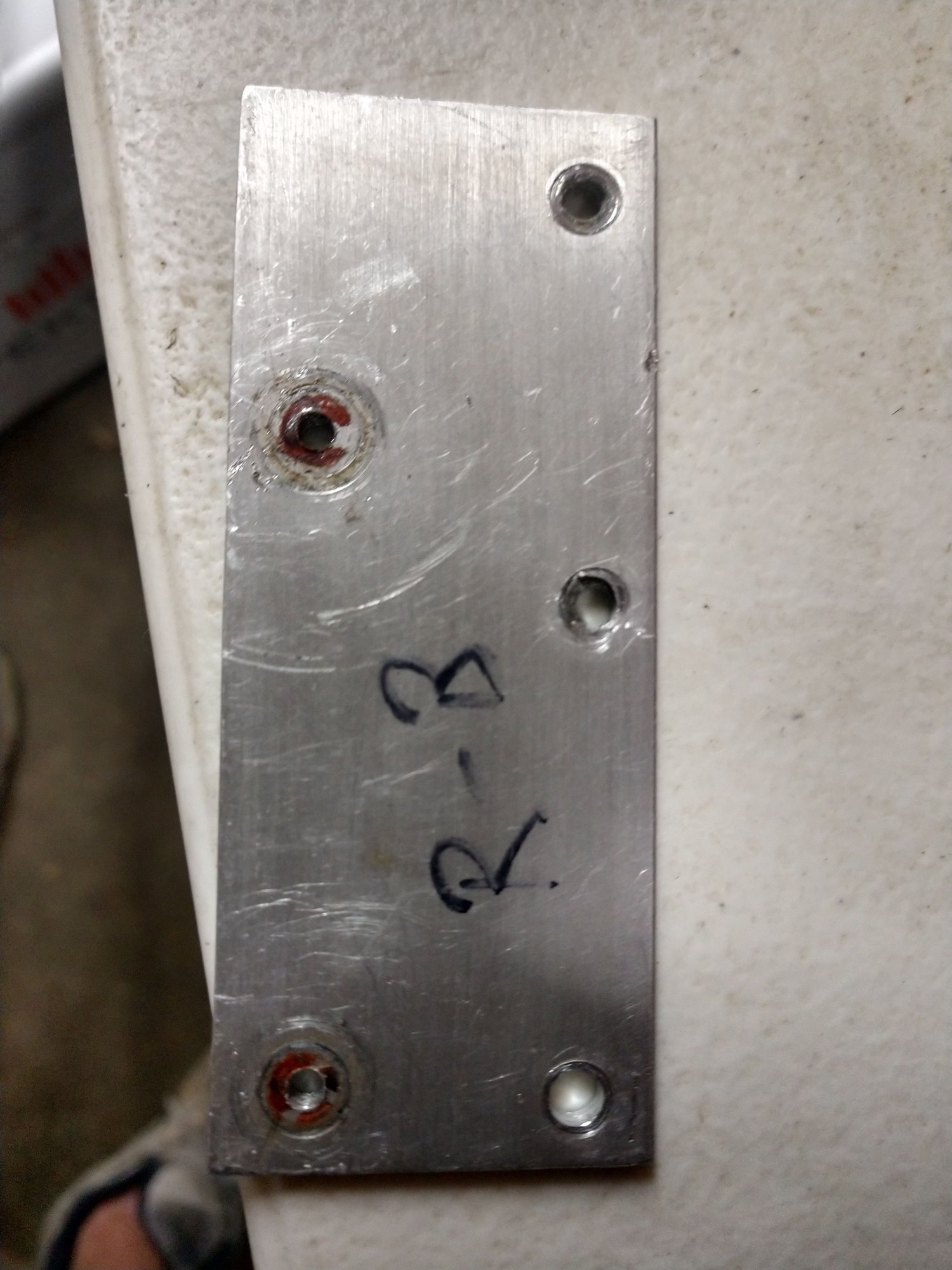

Can anyone using a Cheetah post a pic showing how you mounted the engine?

Default Cheetah engine mounting
I used a piece of 1 1/2" x 1/8" aluminum stock, drilled engine and rail mounting holes, make sure engine mounts are on the bottom of the aluminum or in this case toward the top of the plane to ensure the engine stays centered top to bottom. If you mount the engine on top of the aluminum, the engine ends up 1/8" too low.
This is one of my mounting plates.

That’s the ticket, thanks for info!
