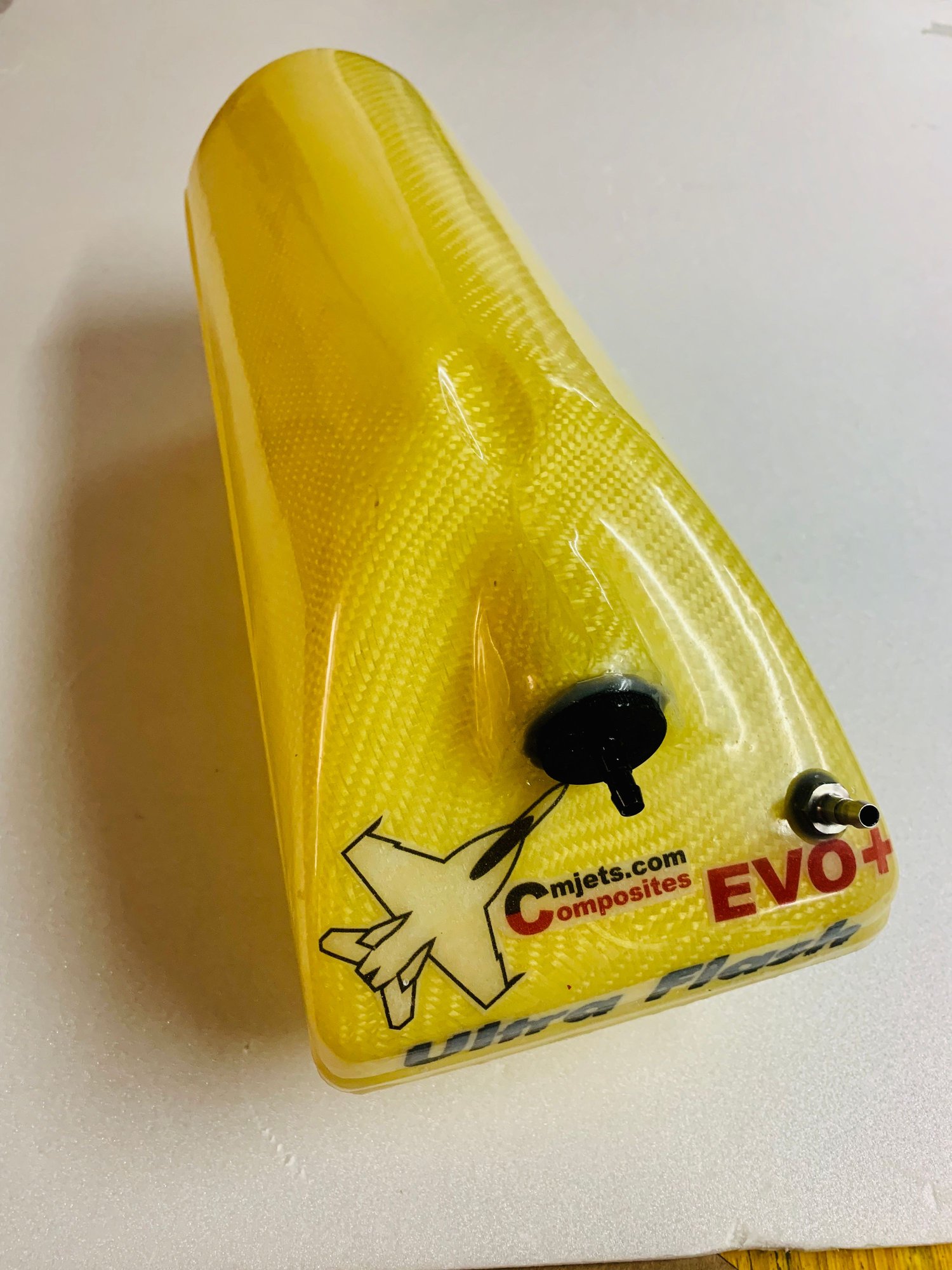

The problem is that the top round shape hit with the close system, in my tanks that is solvent:
That looks nice. Why is the vent outlet so low?? How can you fill the tank all the way up?

My vent has a internal tube that go to top, simple and effective !

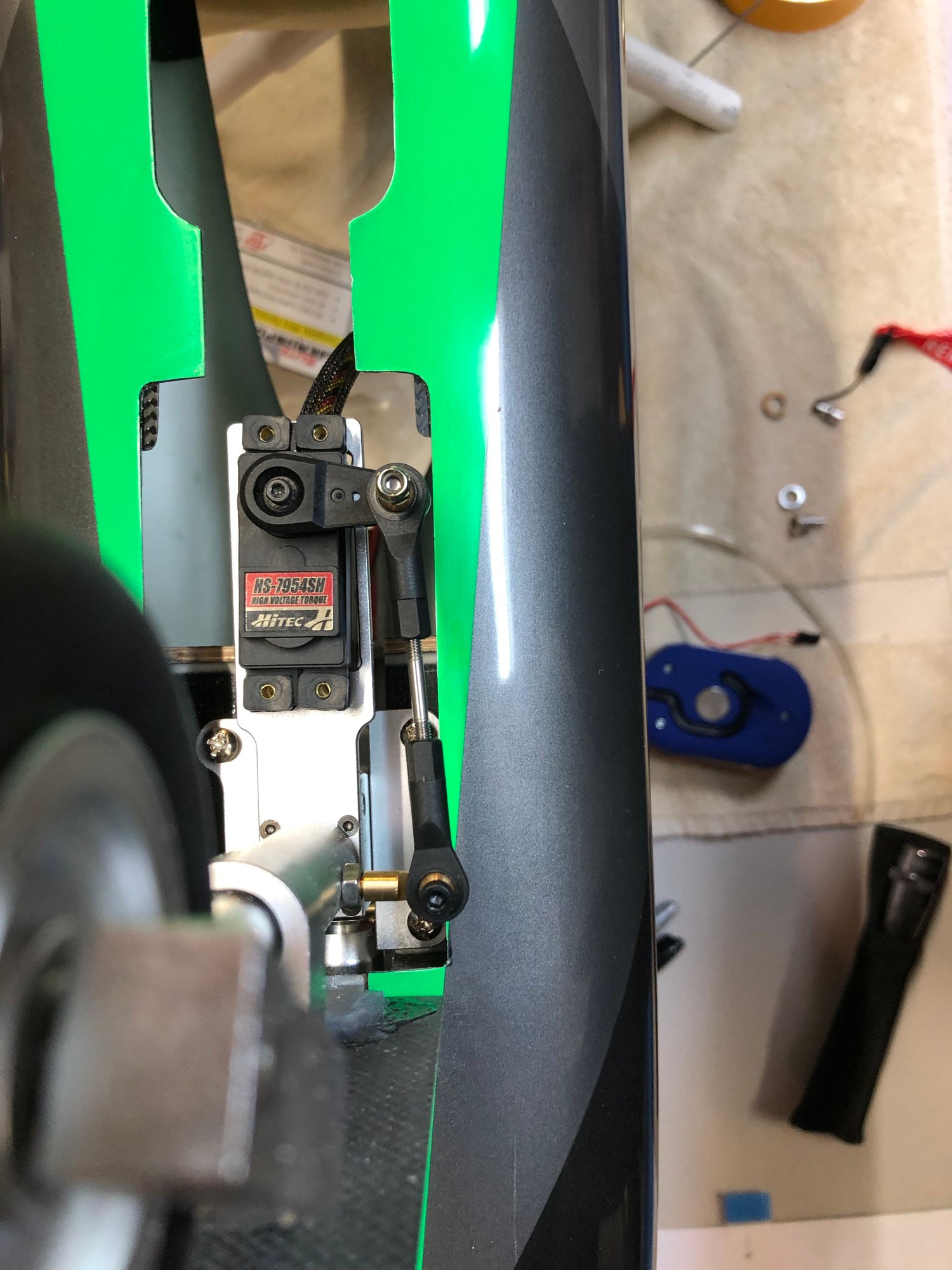

Couple more questions as I worked on this a bit at lunch....
1-what is the brass colored cylinder? It was in the package with the nosewheel stuff.
2-should the stud that threads in be at this position? It's just hand tight and the servo arm is not drilled, but it does not appear that it will retract without contacting the fuselage.
what is this on the EVO?
this is going to hit, do I have it correct and I will need to cut the fuse?

Spare nose pin and sleeve.
Take the nut off the steering arm and screw the stud in fully (add a little thread lock) till the linkage is parallel, you might have to trim the opening slightly.

Thanks! The nut shall be removed. Brilliant... sometimes you can't see the forest for the trees as they say.
