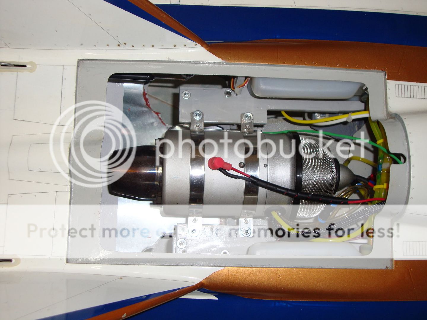

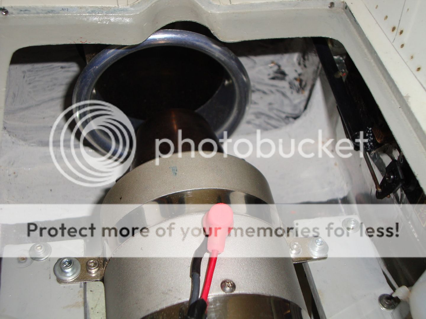

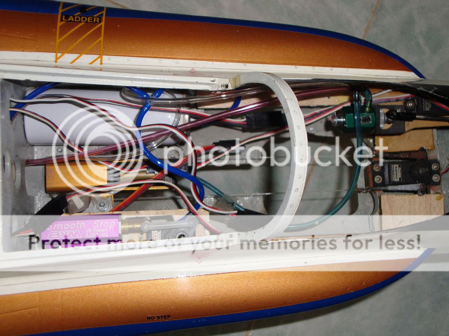

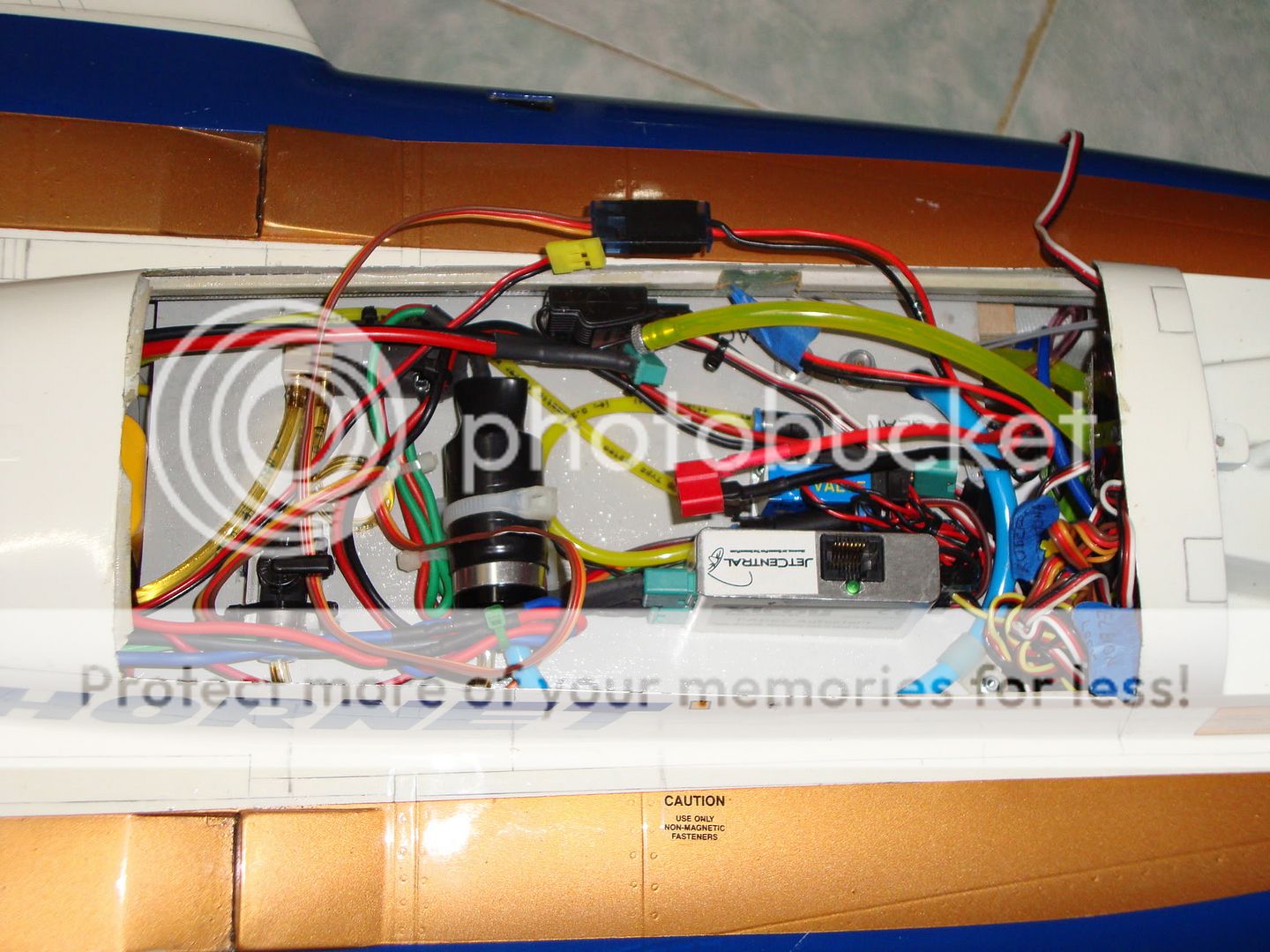

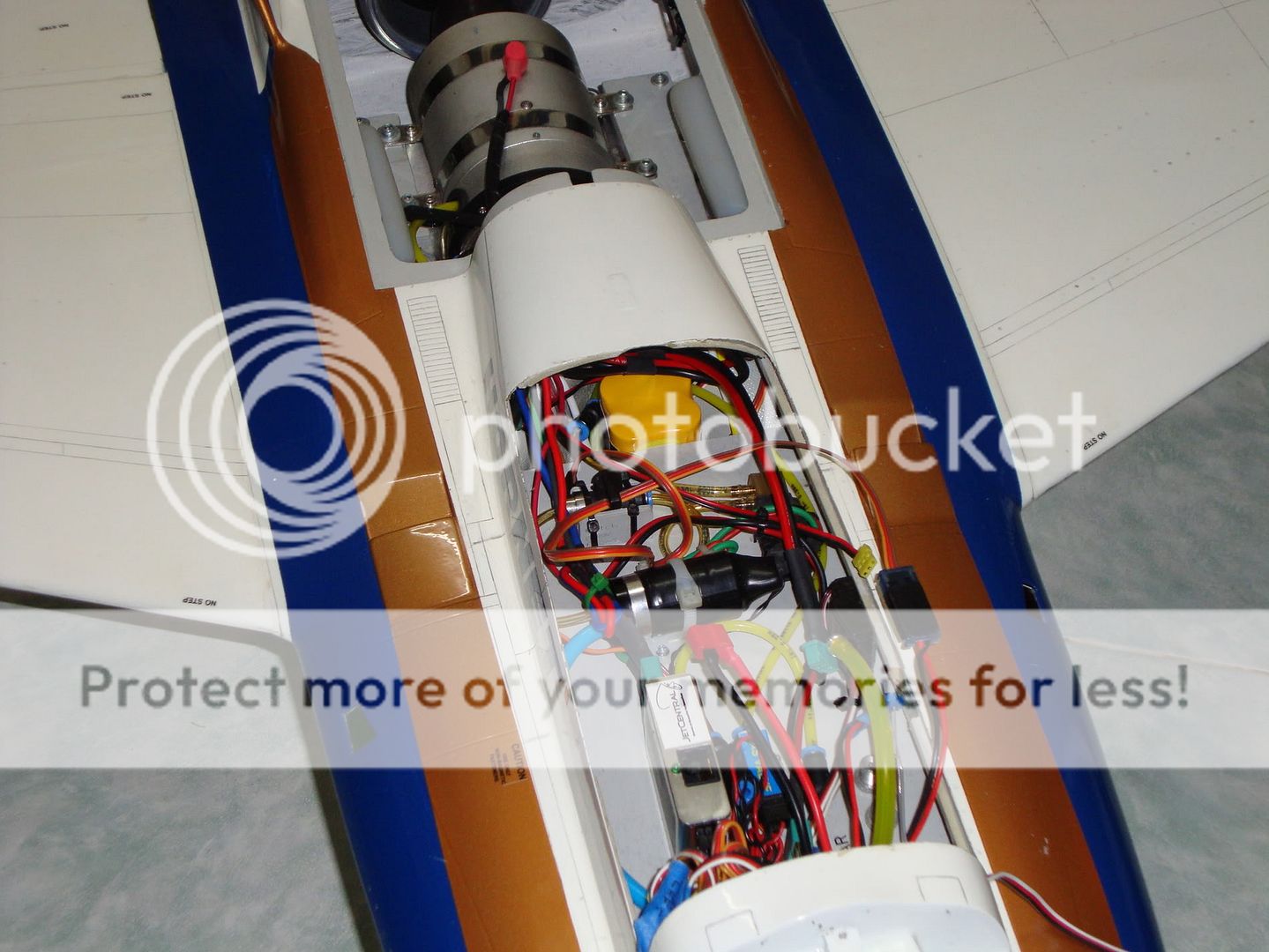

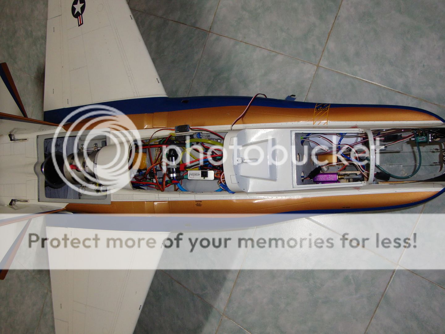

This is my hornet arf f18 Yellow Aircraft, originally was a ducted fan, is nearly ready with a jet central super bee turbine , could you recommend the televator, aileron and flaps set up.
FRANCISCO RUBIO is offline

Francisco,
The Super Bee is a very good engine for this bird. May I ask, why did you opt to do your rudders that way instead of an internal linkage? Also, why do you have your pipe sticking out the tail cones like that? Do you have some internal heat insulation back there?
To answer the question about ARF's, no, Yellow isn't currently offering this bird as an ARF.
Shaun Evans is offline

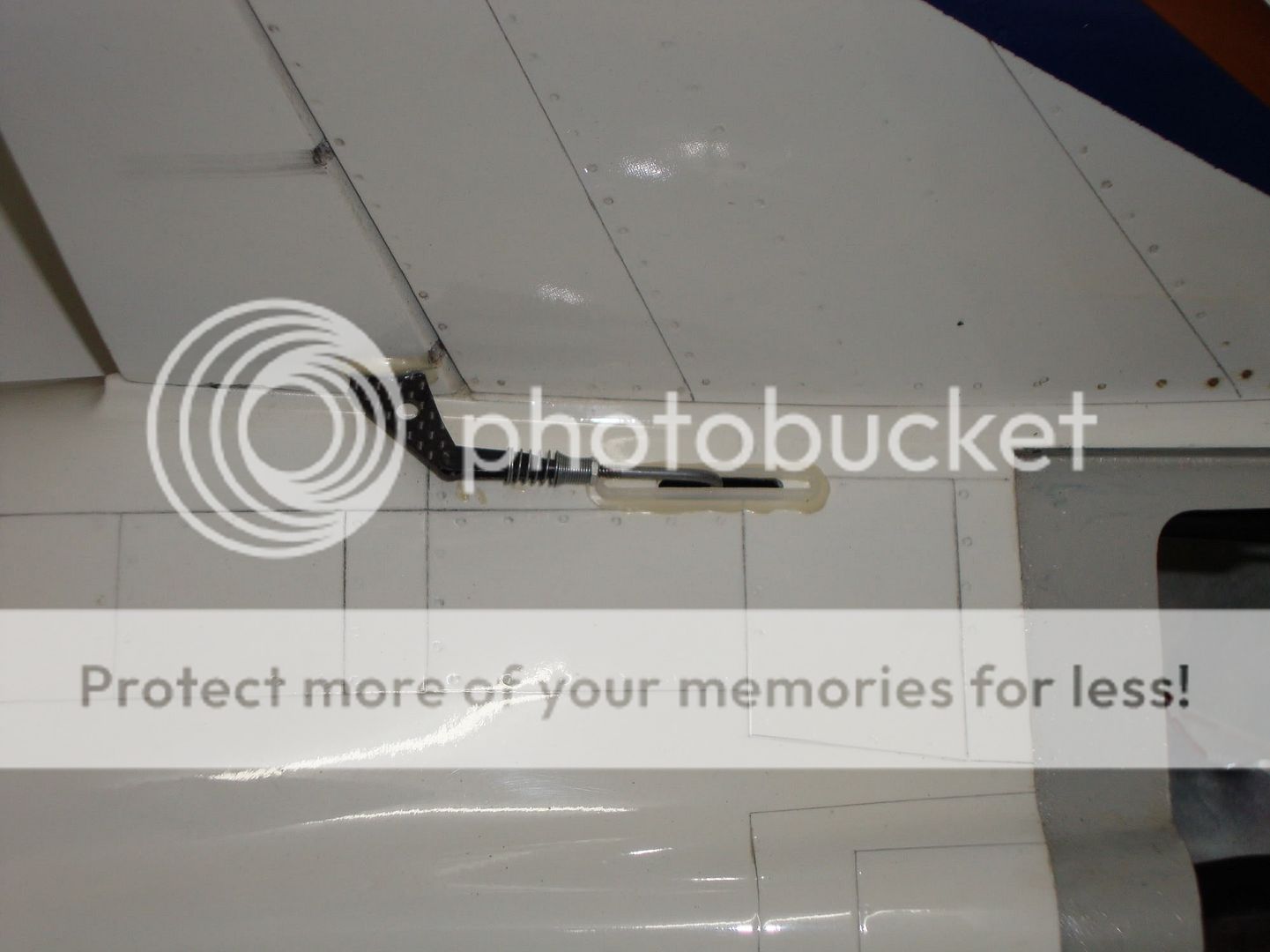

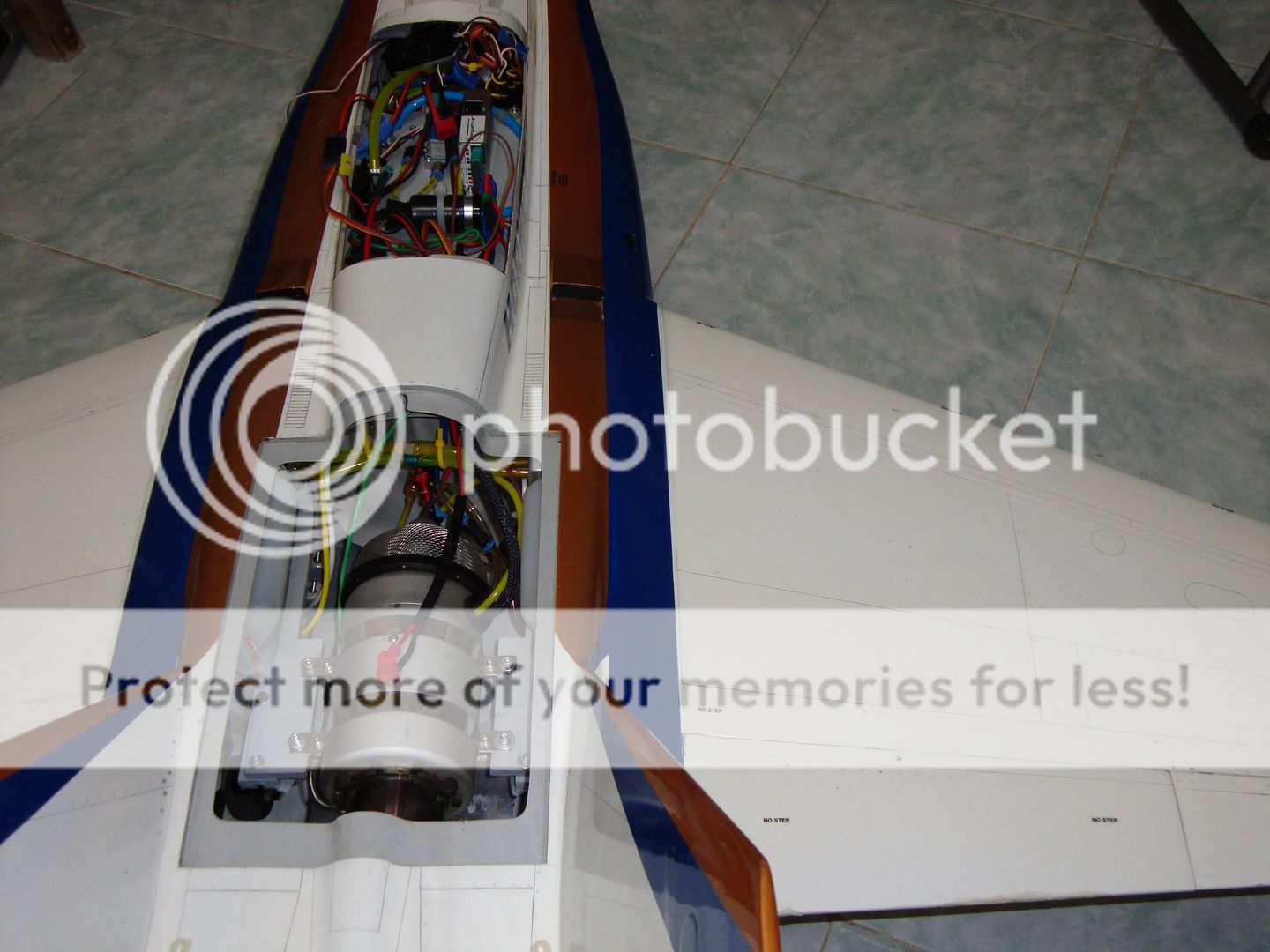

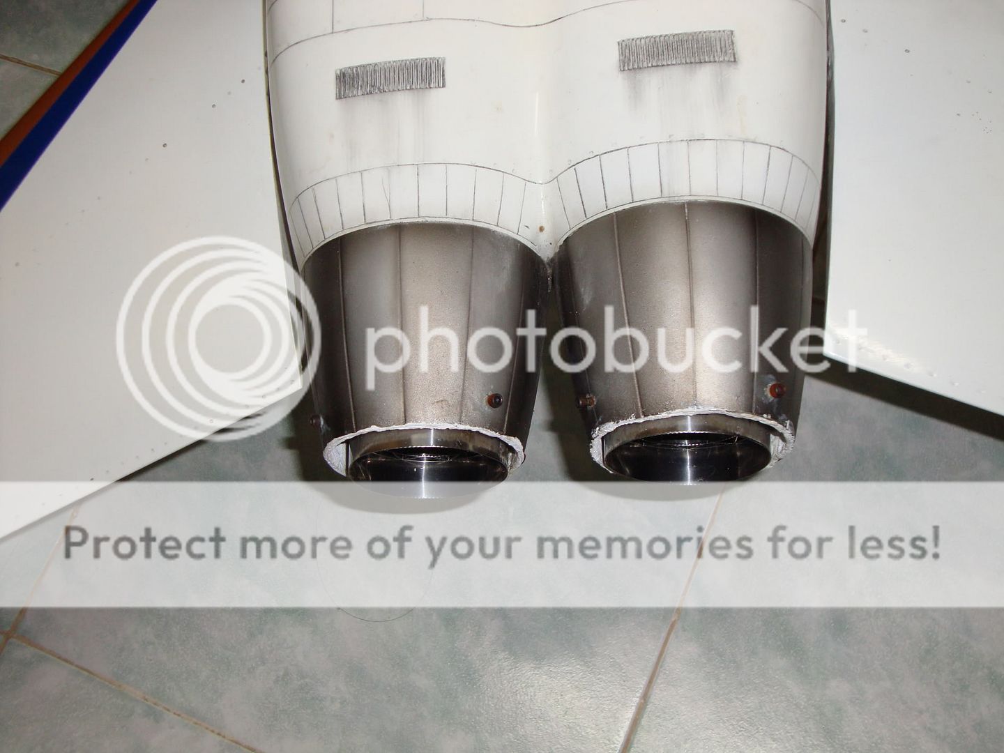

Default RE: New Build Thread: Yellow Aircrfat F/A-18 Single
Yellow aircraf
Idid opt for external ruder rods because the plane was a df and the previus owner cut the internal linkage , to avoid cutting the hinges I did opt for external rudders control rods . The pipe sticking out the tail cones because the pipe is screwed to the fuselage former and the pipe result longer, need I to relocate with additional support for that has not protrude from the cones?. Inside the fuselaje in the pipe area I covered with aluminum foil and BVm ceramic coating.
Greetings
Francisco
Hi,
I see what you're talking about. Yes, I'd move that pipe forward until you get it at least 3/8" inside of the tailcones. That will cut down on the heat buildup back there. The foil is a great idea, though. When will you fly it?

Hi,
thanks for your advice I'll move the pipe forward to place it within the cones. I plan to fly in 2 weeks, hope all goes well and make a video of the first flight
