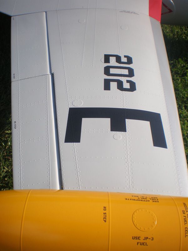

OK, Panther is finally finished...
After thinking about weathering, I decided to not made it this time. If some one want it, weathering can be added...
So, few days ago I put letters from Taylor Decals firm on surface and took model on final painting - layer of 60% gloss clear cote...
Results? See for yourself...
Yesterday I put some Panther parts back in to the model...
Inside, under of the cockpit, model is green, same like in area of the wheels...
Thrust tube was easy to instal... Tube is from two walls titanium sheet metal and same like aluminum inlets was made in German firm Jet Cat..
Nice day "call me" to get out in front of my work shop, so I instal retracts and wheels cover in my back yard...
Retracts are from Robart and front leg I bought later from German firm Behotec. Geometry of that leg suit better for grassy air field we have here...
Sunny day was perfect to made pictures of surface with all details...

Next was to put wings and take model on the ground...
Hope that you enjoyed in this topic. I want to show all steps in this model "face lift" work.
