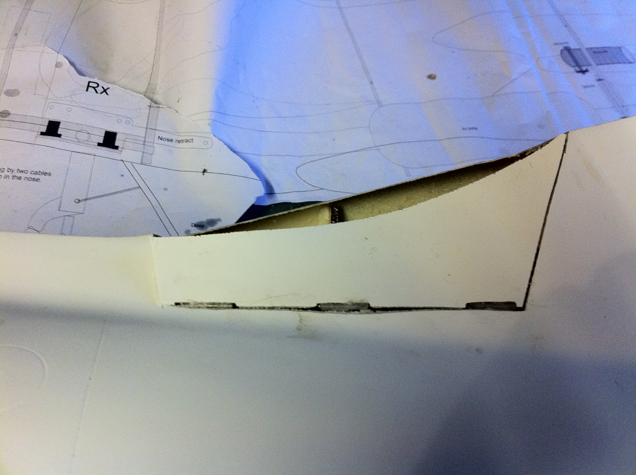

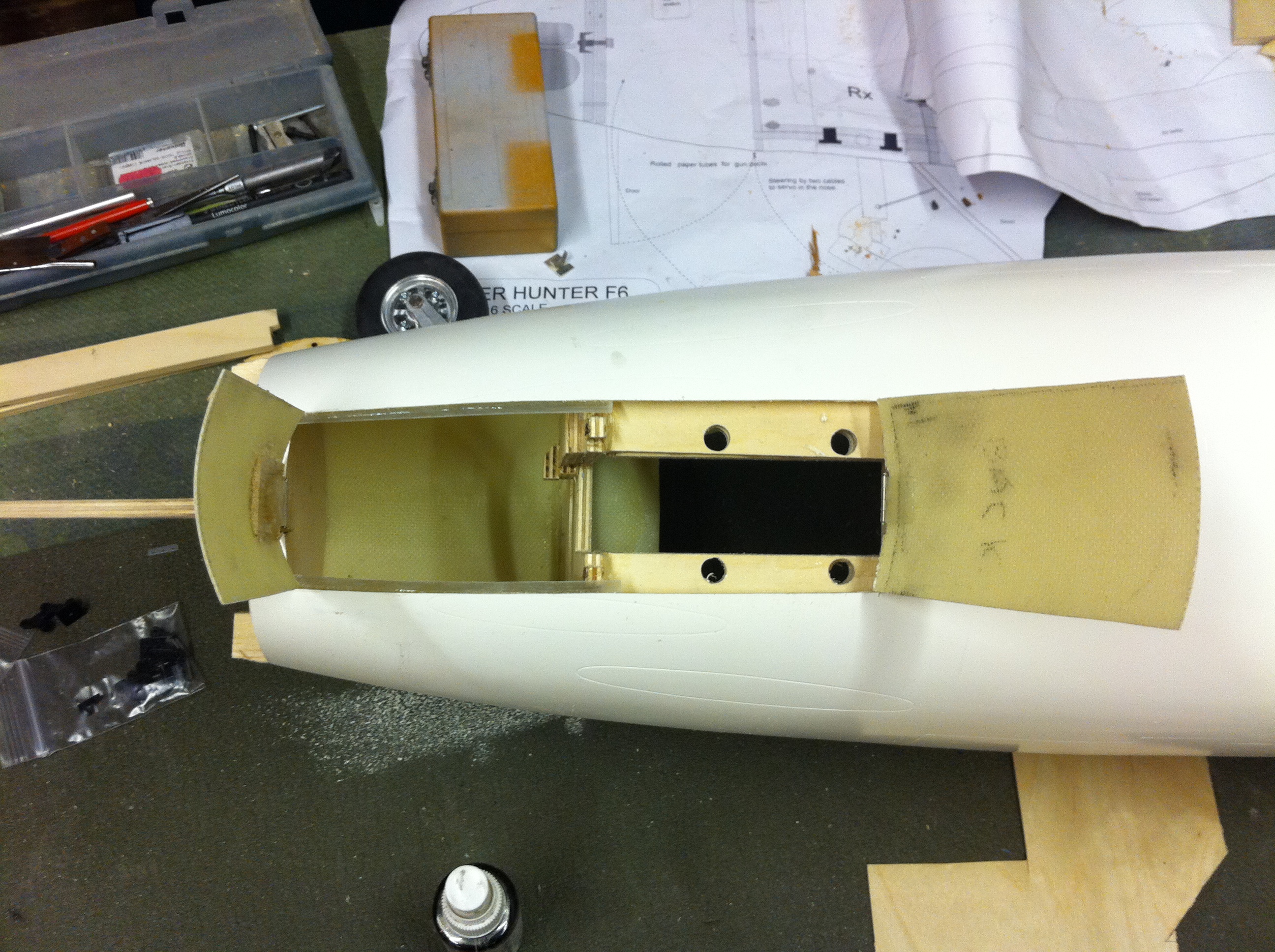

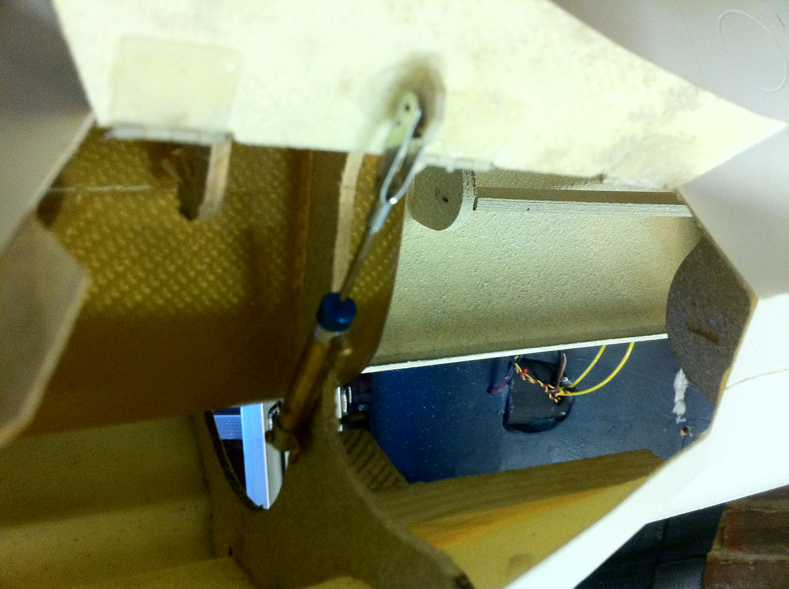

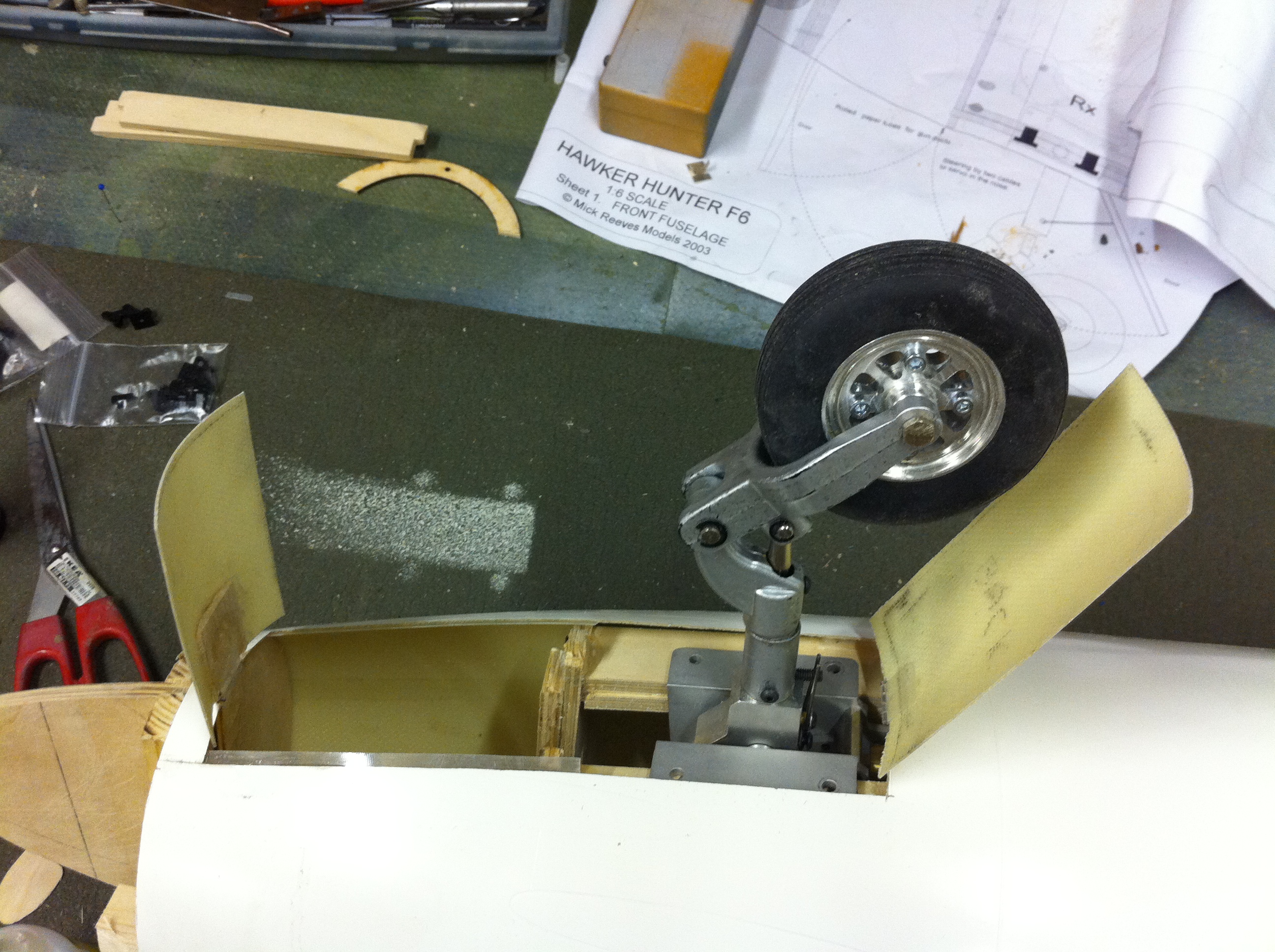

Sorted out the hinges on the nose leg doors. The rear door needs to rotate quite a long way past the 90deg mark so it was quite a challenge to get a suitable hinge. Having tried several types of door hinges the best result I achieved was by using a basic flat pin hinge.
Just need to wait for the air rams to arrive then I'll see if I can get them to open and close correctly.

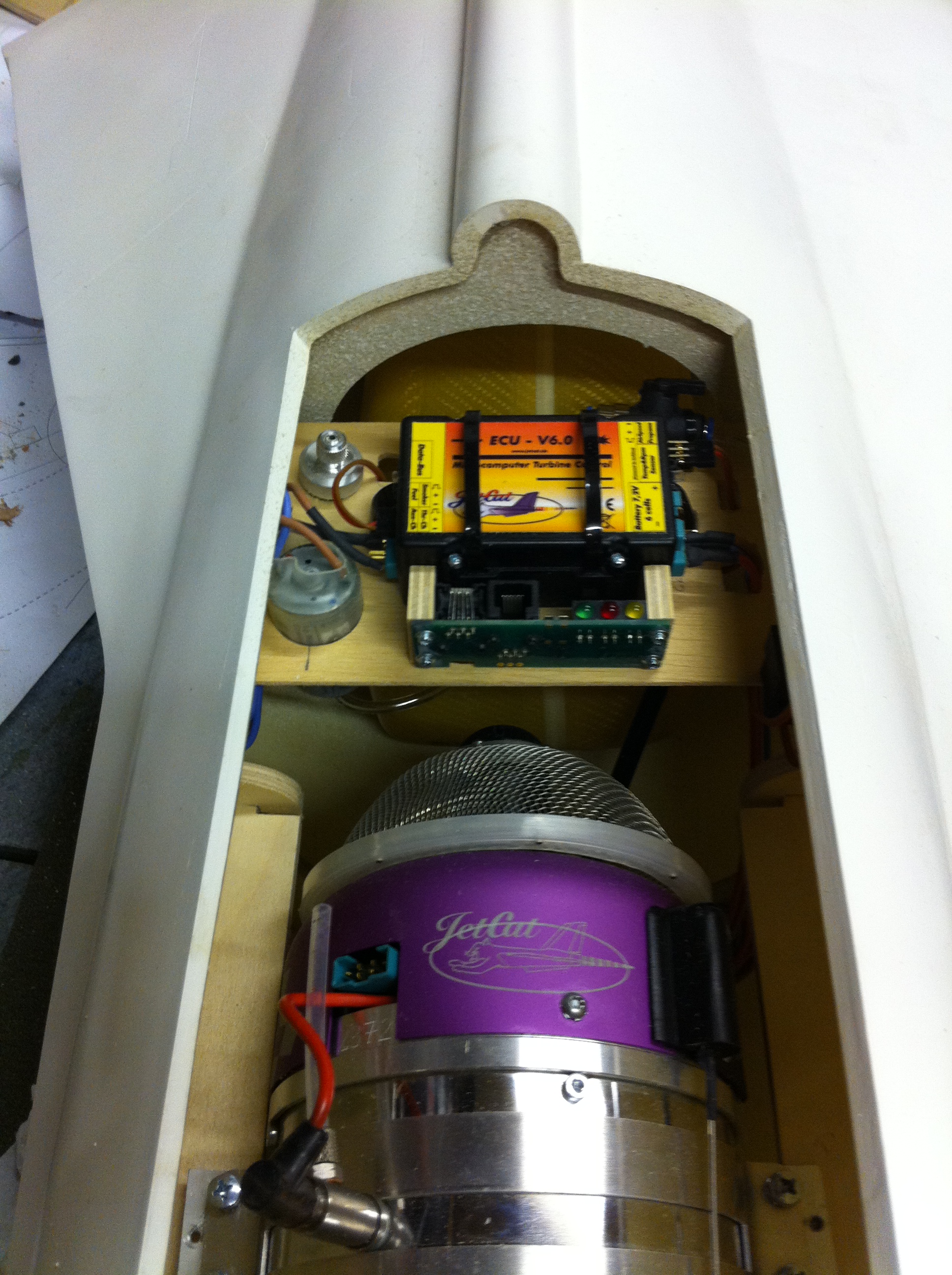

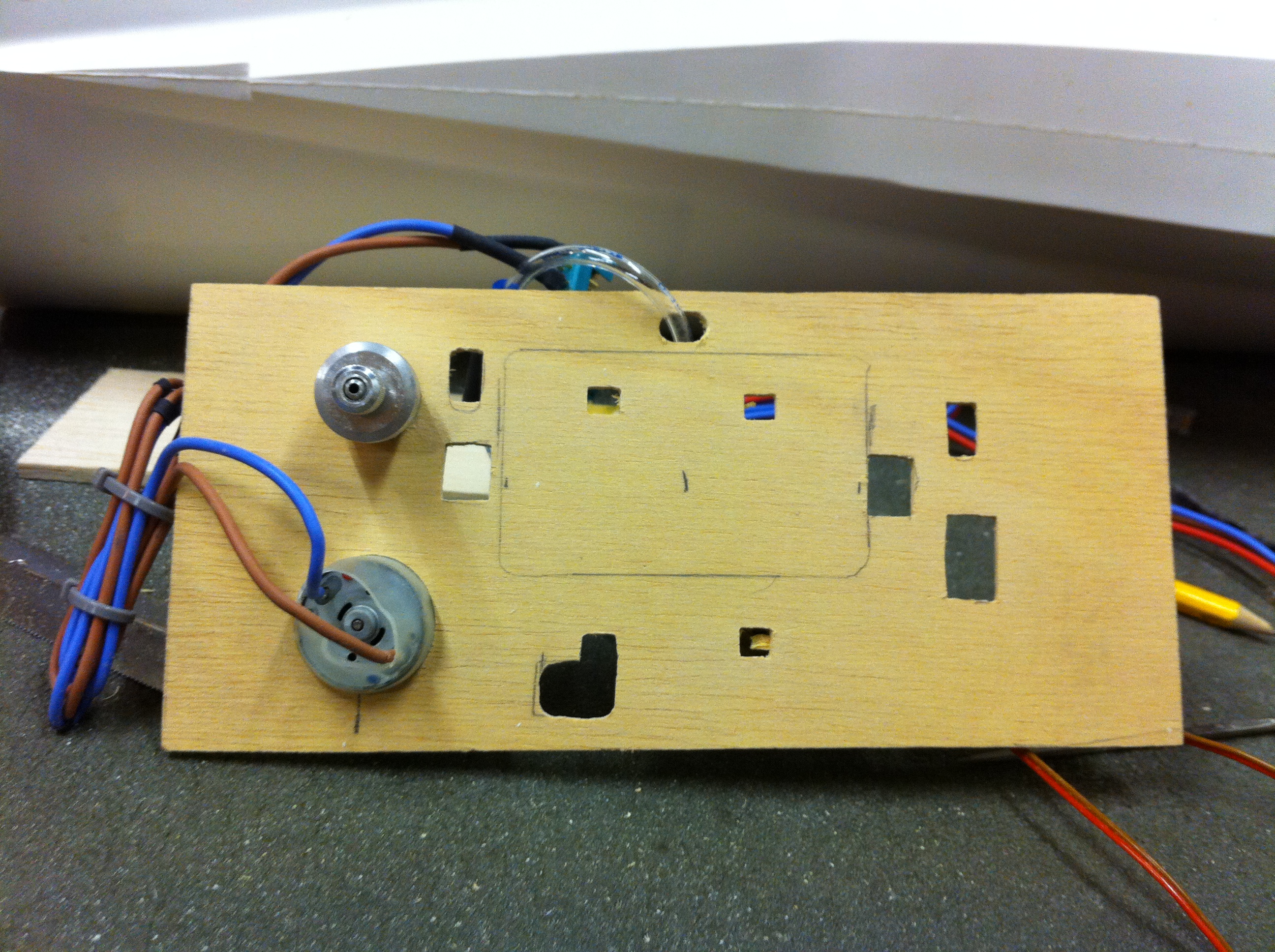

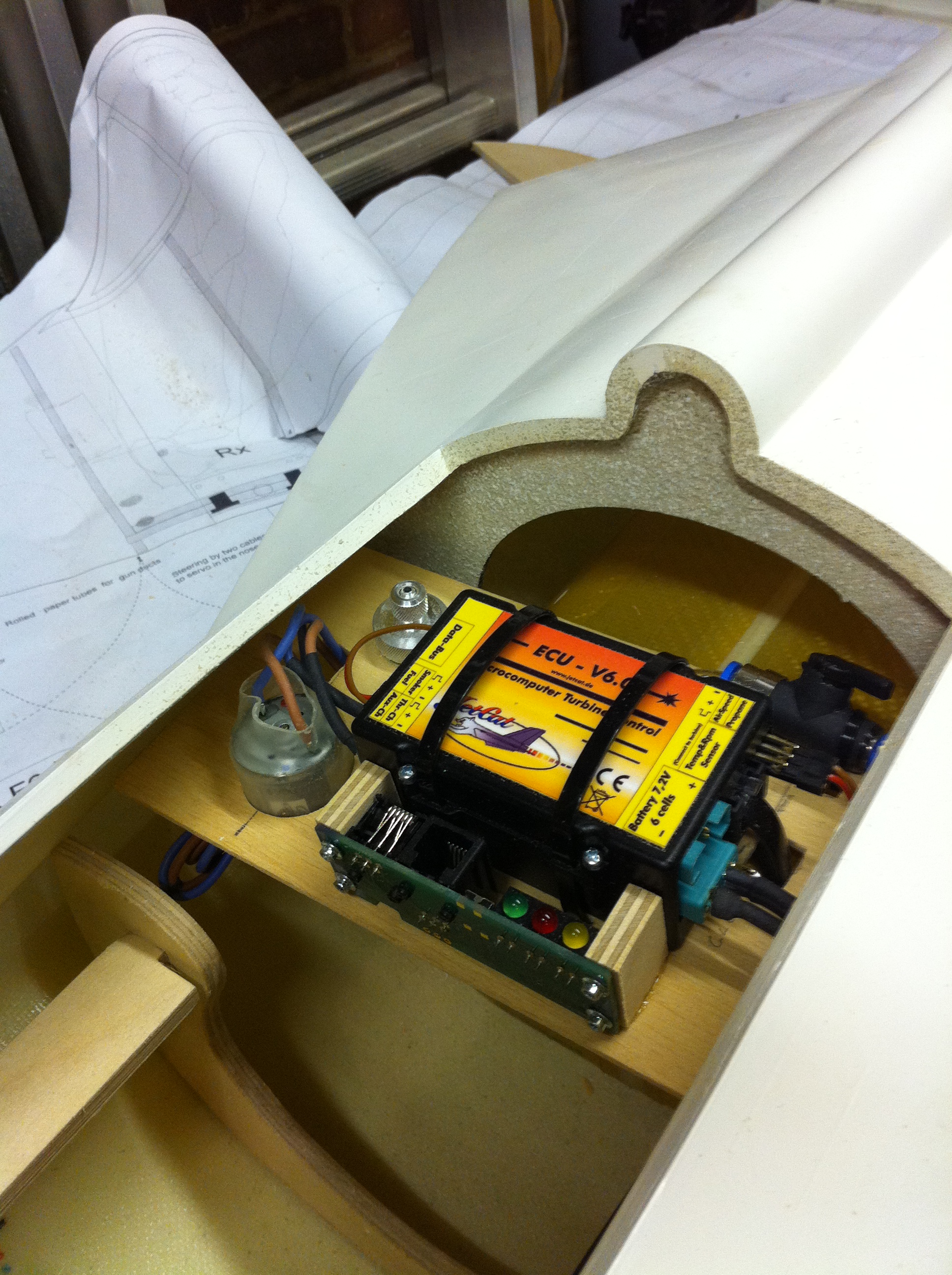

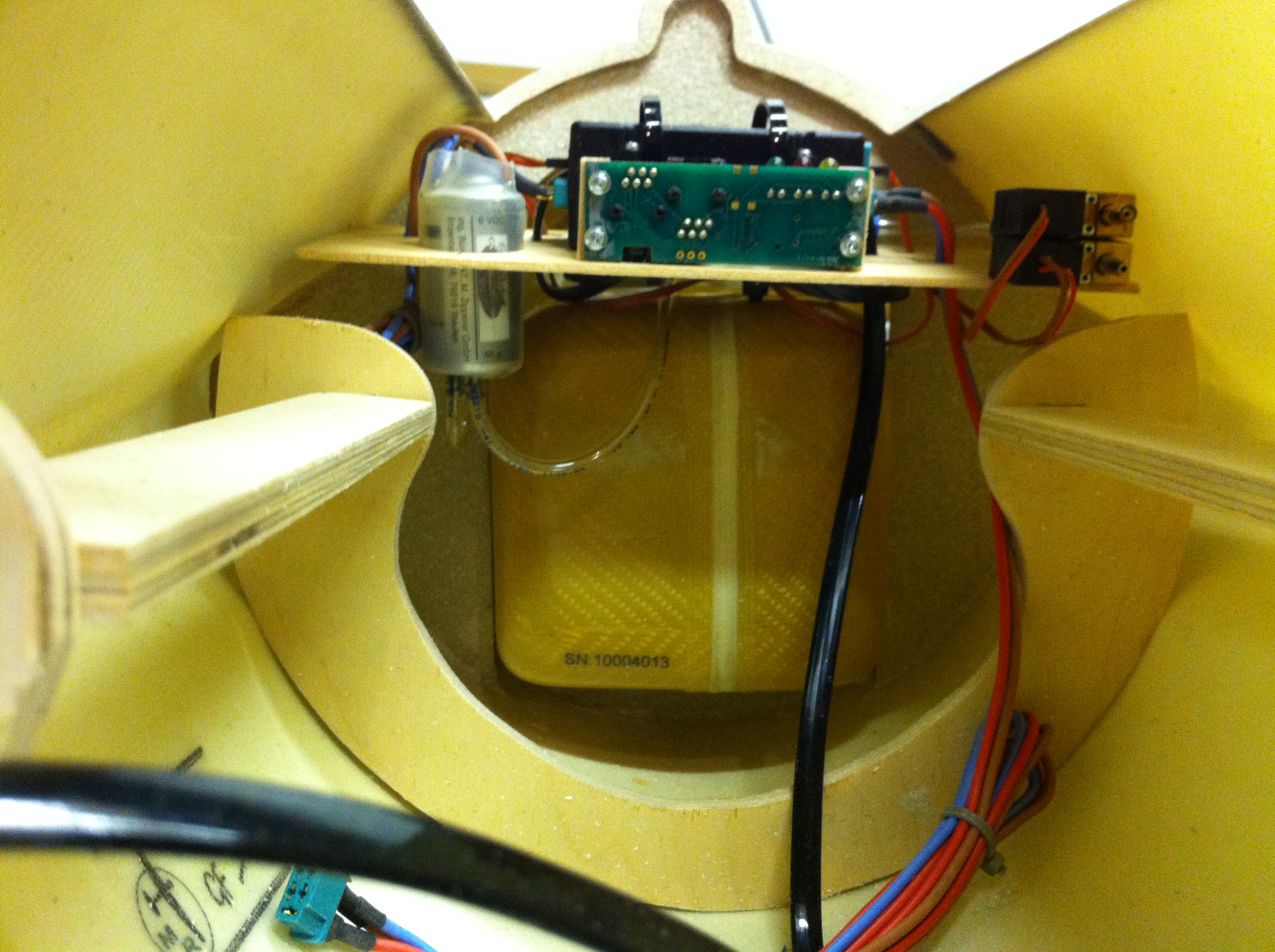

Turning my attention to the ECU and other engine related stuff, I decided I wanted to make it as easy as possible to transfer the turbine to other airframes and so have mounted everything engine related on one ply plate.
Changing engine should be a case of unbolting the turbine, unscrewing the ply plate and disconnecting fuel and turbine power - everything else should be self contained.

Before the ECU goes in there is quite a bit of space around the tank for airflow to the turbine, but once the ECU and bits and bobs are in place it restricts a lot of this airflow.
...I decided to open up the holes at the sides of the former in the front of the engine bay. I don't think its compromised the structure, but has given a decent amount of area for the air to get to the turbine.

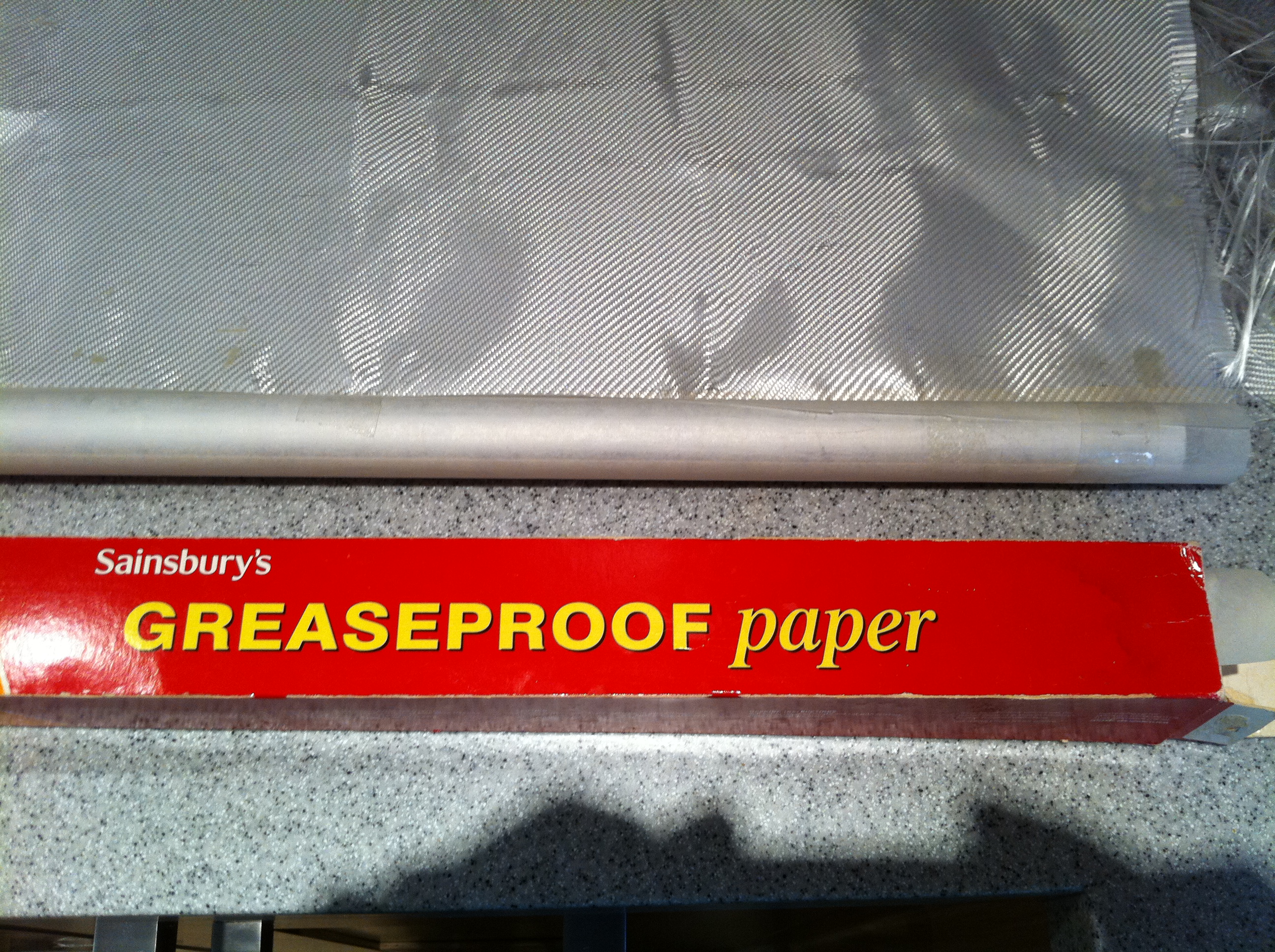

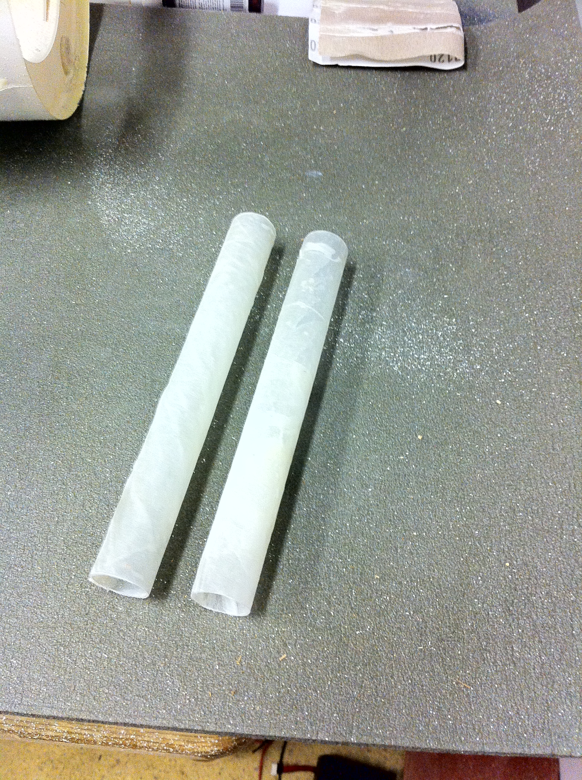

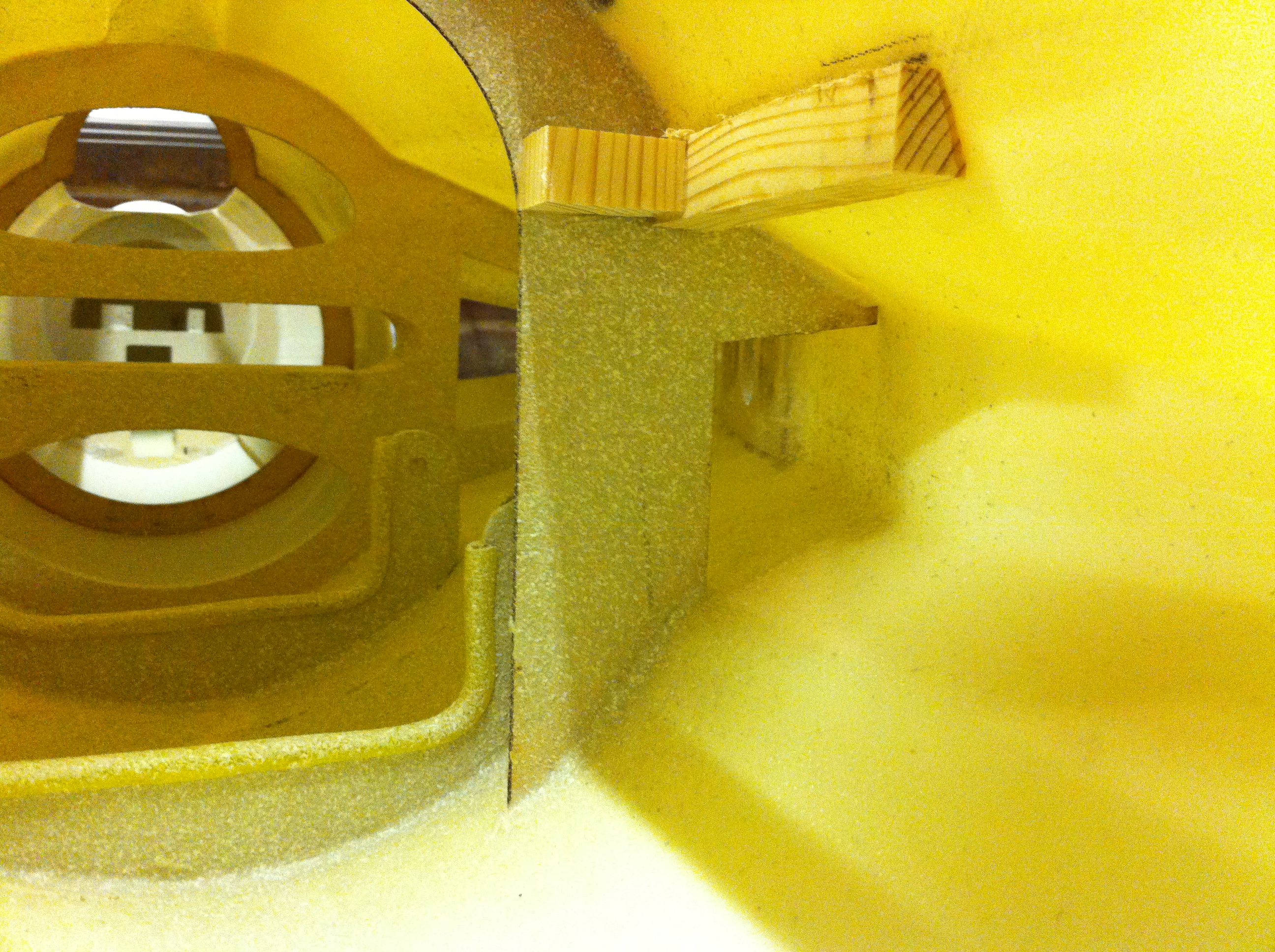

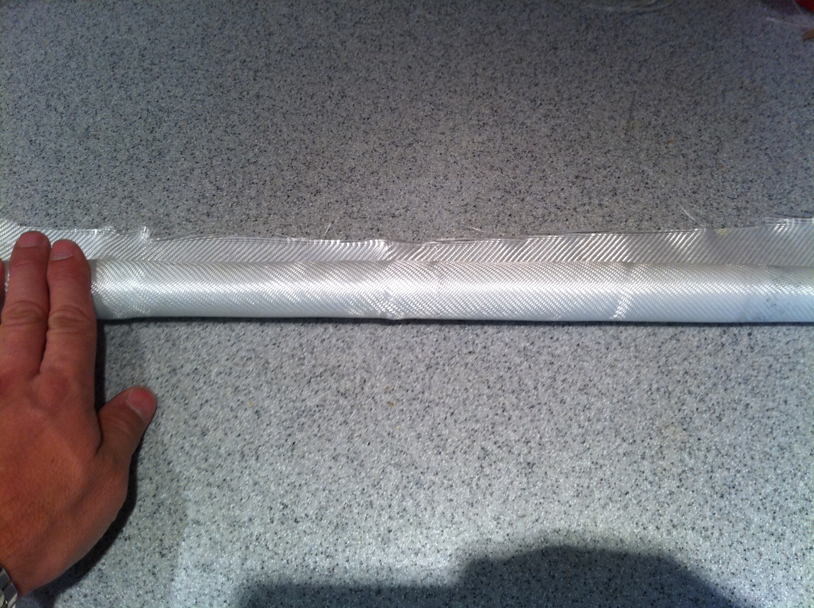

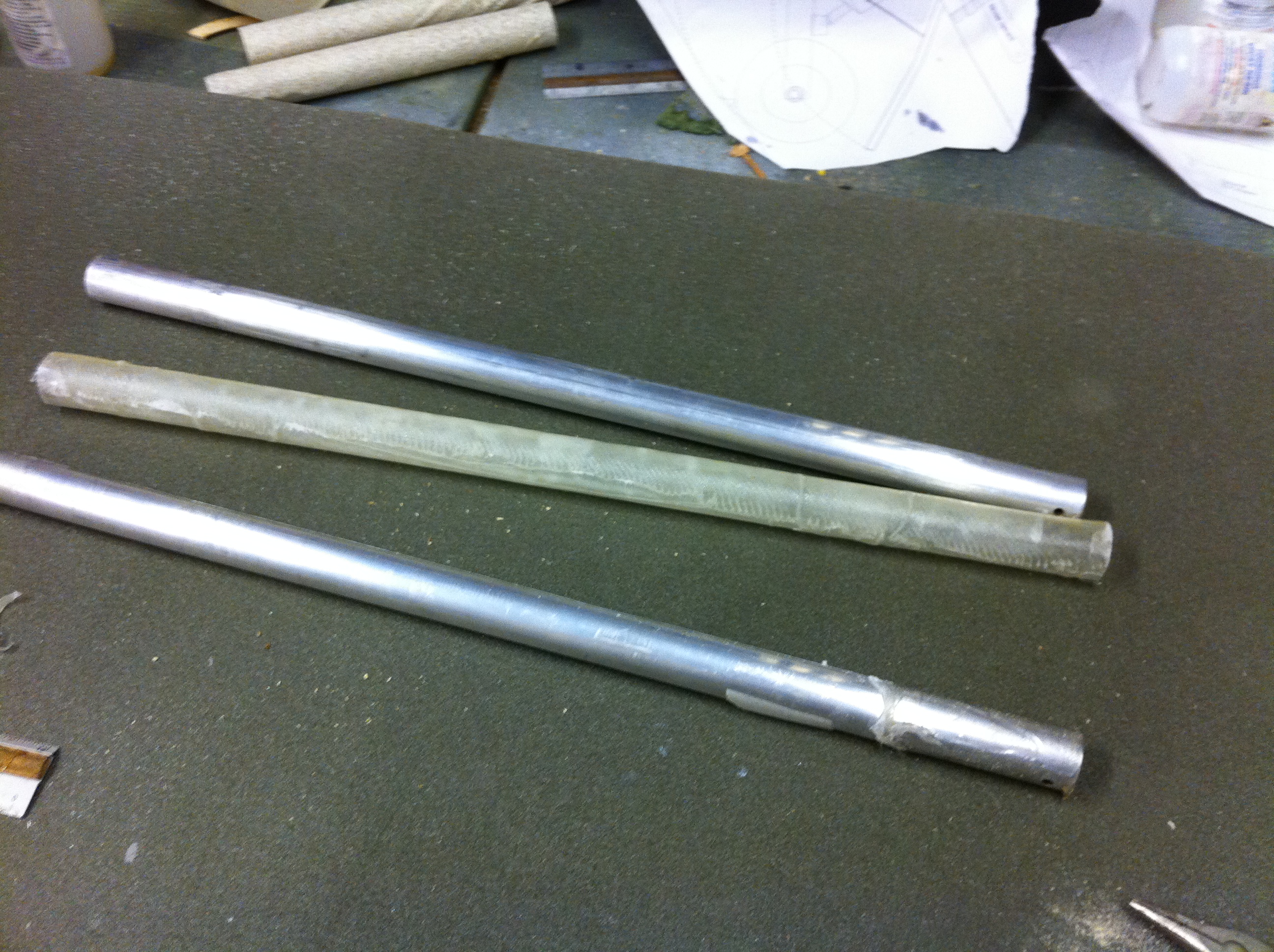

Decided to use static wing tubes in the fuz to make it easier to mount the wings. None are provided in the kit and Mick suggests making some by wrapping card round the ally wing tubes.
...I tried looking online for some tubes with an inside diameter of 1", but couldnt find any so had a go at making some. I put grease proof paper around the wing tubes and then wrapped them in glass, left them over night and the end result seems to work fine.

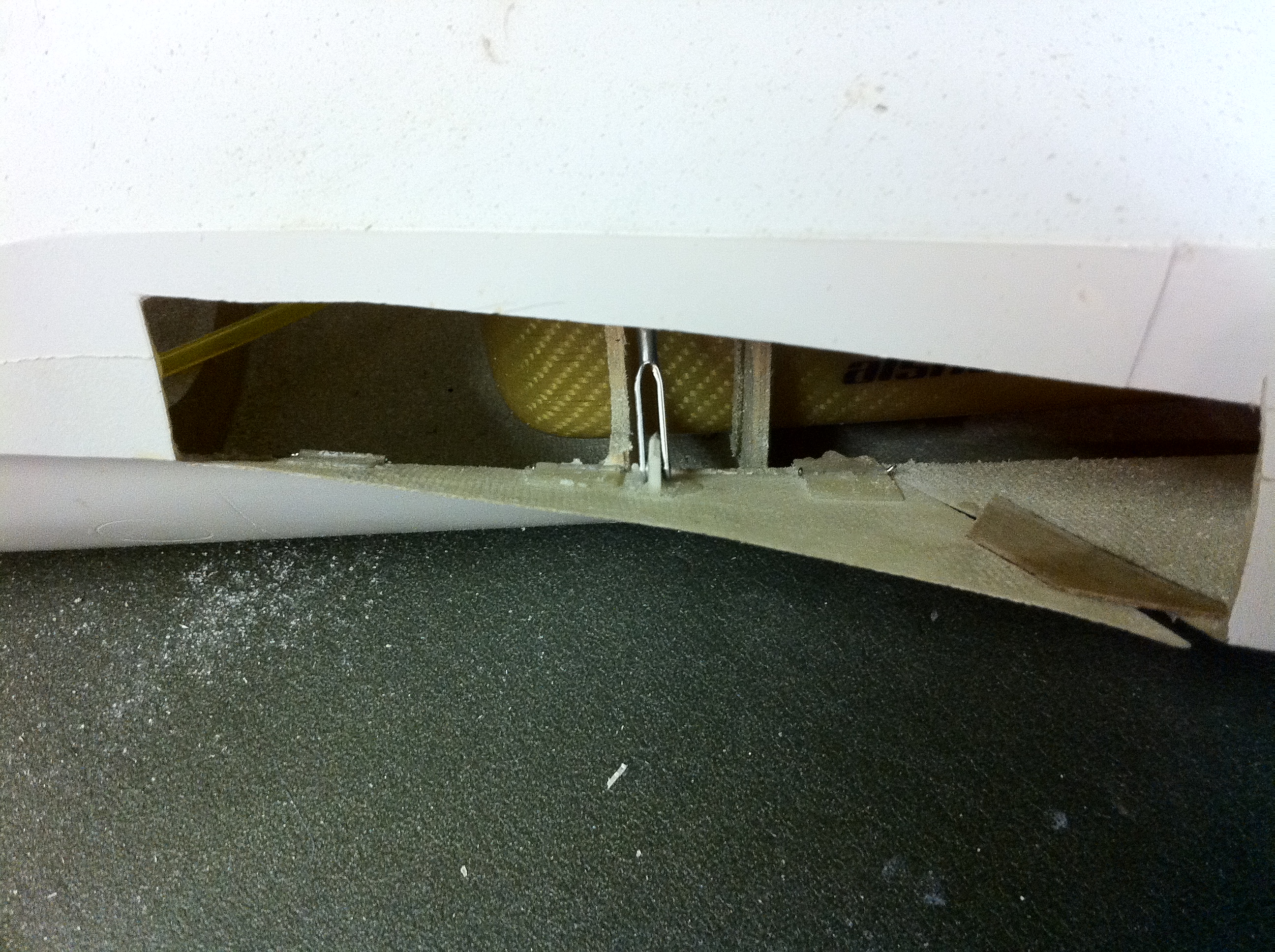

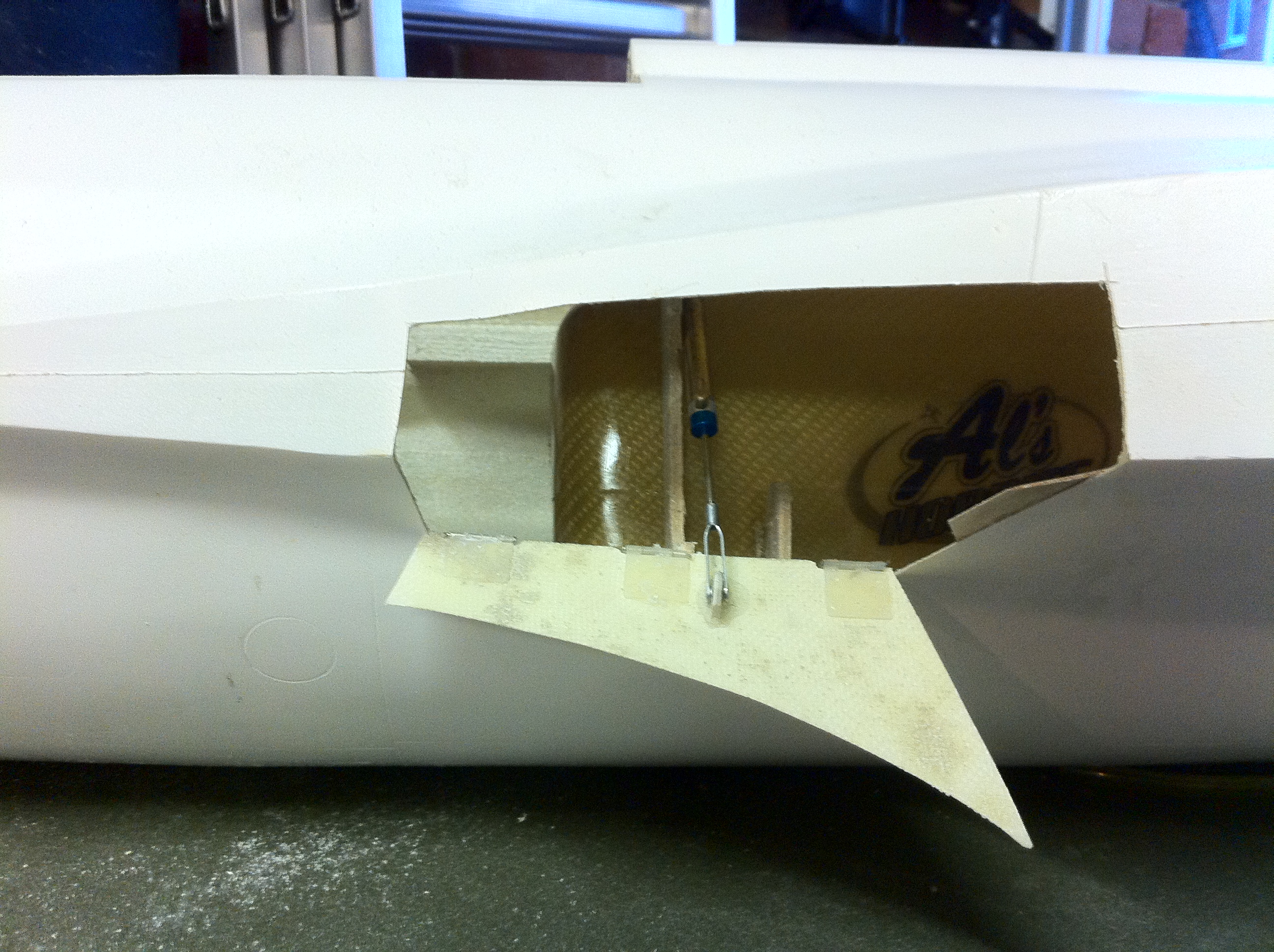

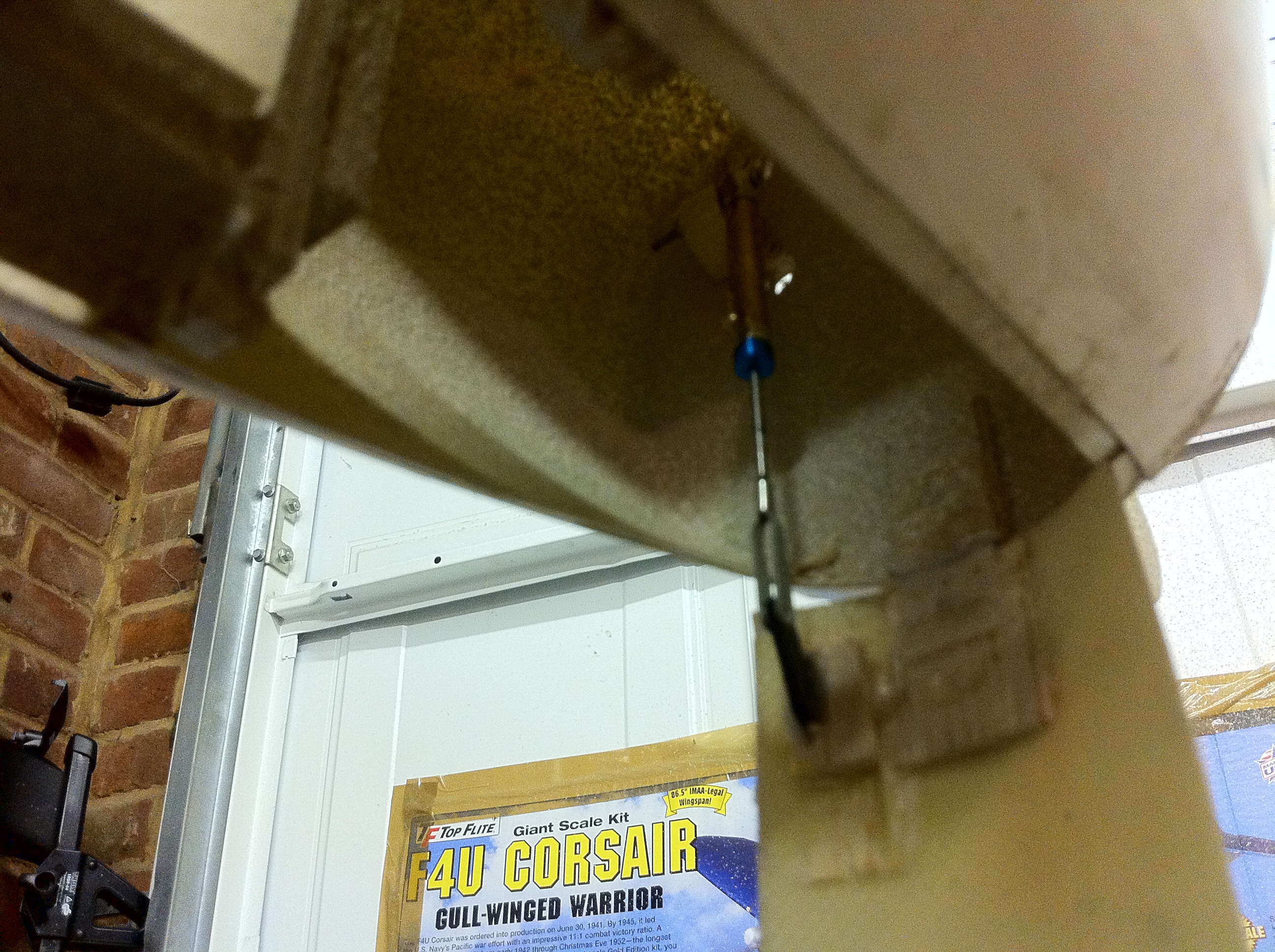

I've been working on the main gear doors, these arnt big and are in the fuz. Mick suggests using servos, but I've gone for small air cylinders. The rear bulk head is conveniently positioned to attach the top of the cylinder to and a since the door moves through 90 deg its quite easy to estimate where abouts it needs to connect to the door (ie approx the same distance from the hinge as the cylinder travels - 20mm in this case. (plus a couple of mm to allow for the fact that the swing of the cylinder is reducing its effective length a bit)
...I done lots of thinking and then just decided to guess - and it seems like a good guess since when the cylinder is closed so is the door and when fully open the door is at 90 deg! Hurrey!

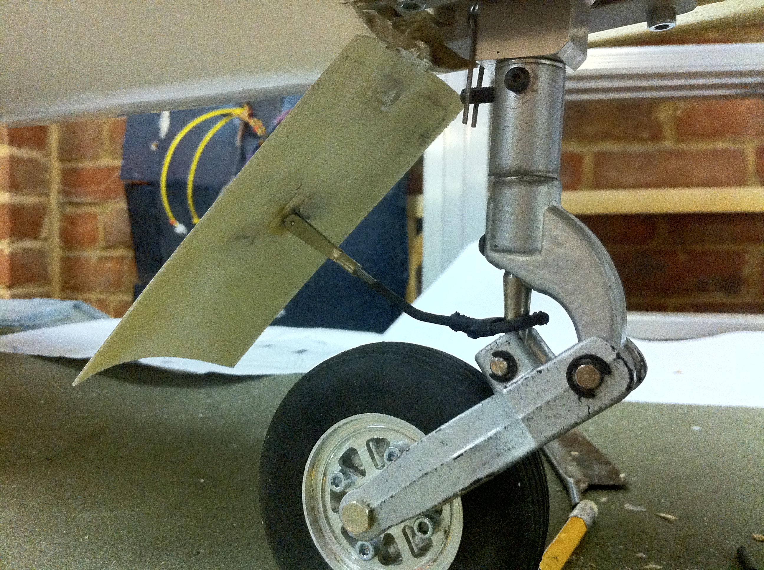

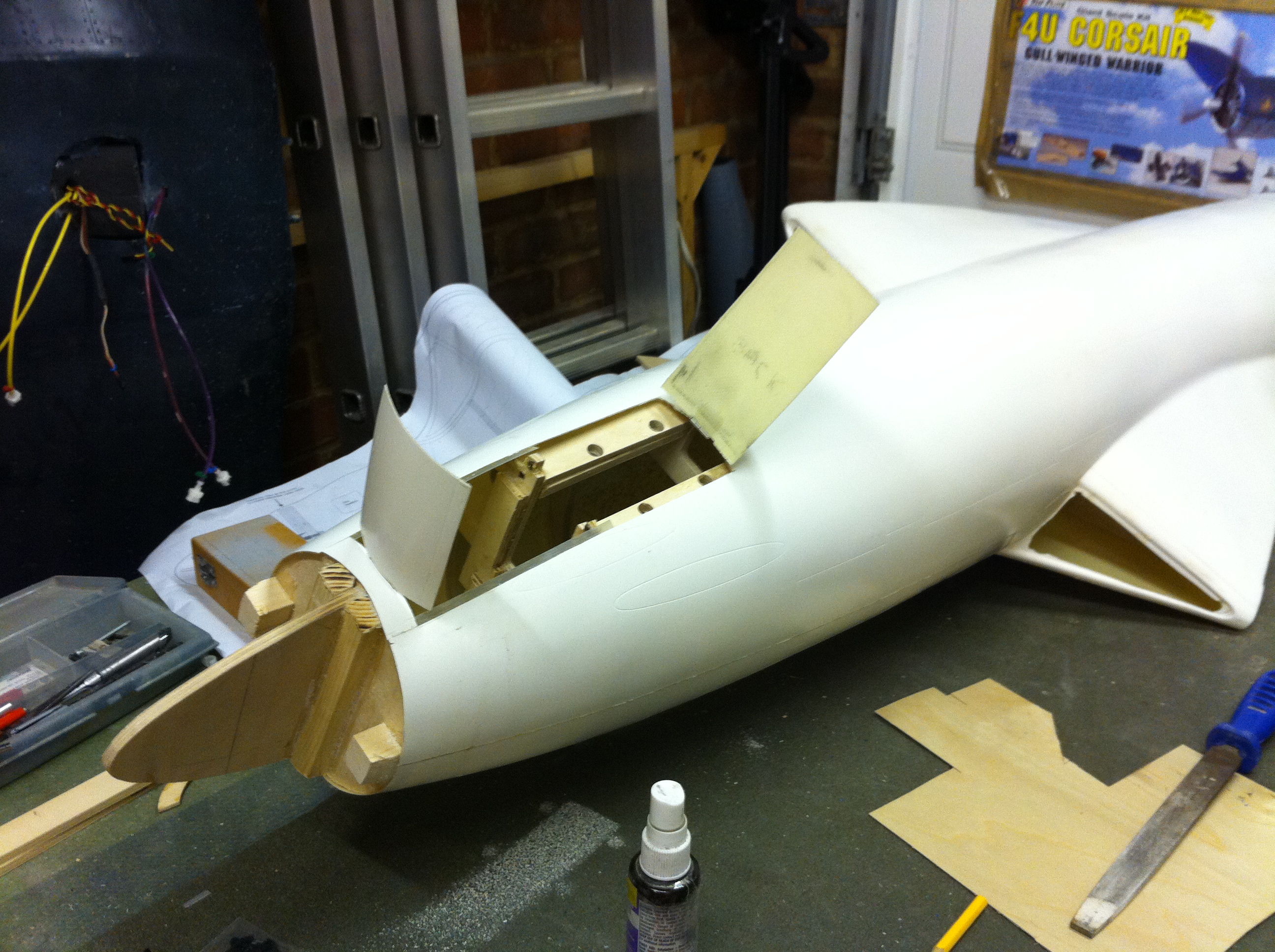

Next set of doors are the nose doors. The front door has to open first, then once fully open the nose leg comes down and pushes the rear door down and beyond the 90 deg line so that it leans backwards slightly and gives a bit more ground clearance.
The difficulty with the front door is that the tyre of the retracting wheel virtually touches it on the way in and out so its not possible to put any kind of linkage in the middle of the door - instead I've had to offset it. Again, since this is a 90 deg door its easy to estimate where the cylinder should attach and again it seems about right. My only concern is that since the cylinder attachment is off centre it might twist the door as it moves. If this happens then I might just have to put a cylinder on the other side to to balance it out. I won't know until I attach the air to it.
The rear door is a bit harder to estimate, it is attached to the gear leg, but has to move further than the gear leg moves - to do this we have to make the distance between the door hinge point and the connection on the door less than the distance between the gear leg hinge and the attachment on the gear leg.
...A few calculations and estimations later I tacked everything in place and closed the gear - unfortunately the linkage fouls the steering spring on the back of the leg as the gear retracts.
A few more attempts and I finally got the position right - then a little adjustment of the clevis and the door was closing perfectly.
