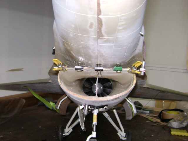

My Feedback: (13)
RE: BVM LE flap.
Now to make the duct adapter for the dymemax to the smaller BVM intake. Also a pic of the cnc cutter I used to make the thrust tube support. I have had it since it was introduced but never use till now. I may have to sit down and learn how to really use that cnc cutter. it can make anything really if you know how.
Note, I am using the one of the nitro version dynamaxs I have to mock up the ducting. 90% Same thing really, with a few minor modifications.
Almost there.
Steve
Almost there.
Steve

My Feedback: (13)
RE: BVM LE flap.
I had a intake duct liner detach from the fuse intake upon test run. My solution that has worked better than I expected on previous intakes, is to take fiberglass seam tape and put small roles between the intake and fuse. It not only supports the ducting, but also has the ability to avoid breaking away in case of shock. It also adds additional support to the fuse with out distorting it. It is also very light. And a layer of glass on the outside lower lip.
The other thing that the "Yellowaircraft" rcu member pointed out is that the top ducting liner can also detach so, I put a lightweight kevlar seam cap on that one.
I also made a transitional ducting from BVM intake to dynemax. My adapter is made to have a mated connection to stop the duct from getting sucked into the blades and have the duct go inside the dynemax and avoid the step and hard short angle change right before the fan blades as you would have if you put the ducting outside of the dyenemax fan shroud.
Steve

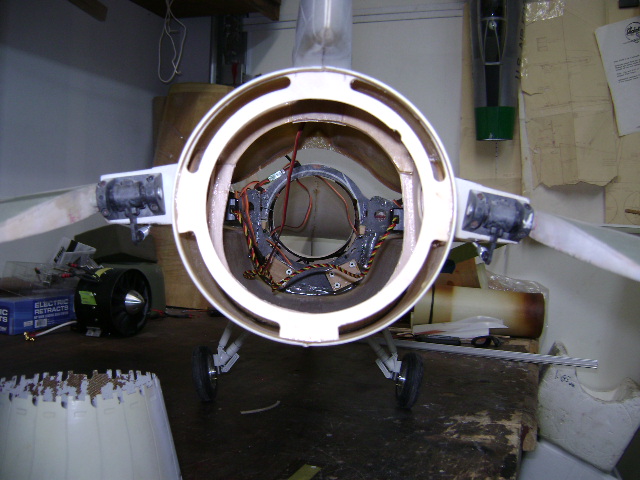

My Feedback: (13)
RE: BVM LE flap.
My dynemax conversion of the BVM F-16 so far. Coming in at 15.5-15.75lbs.
Lipos are 5300Ma, 6Sx2
Had to beef up the intake duct with kevlar. Kevlar does not block radio frequency and is lighter than carbon anthough not as stiff, but stiff enough.
Also my adapter ducting for the dynemax to BVM intake is made to be inside the dynemax and not on the outside. Better for the Fan area, especially at the blade tips. It is supported by a glass tape as well.
Steve
