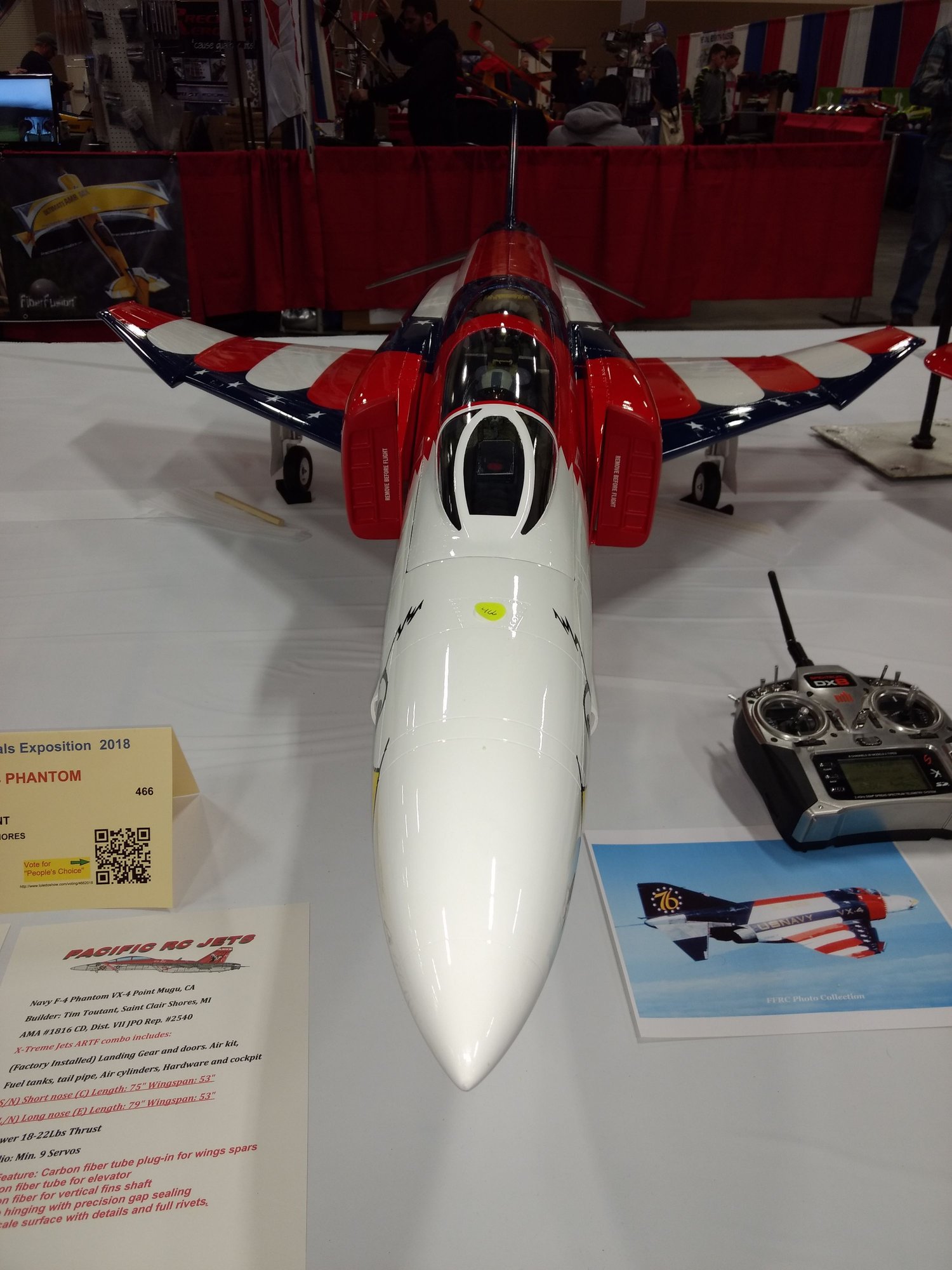

Toledo RC Show and my F-4 for static display and judging. My B1RD didn't place. Next year when it's all complete.

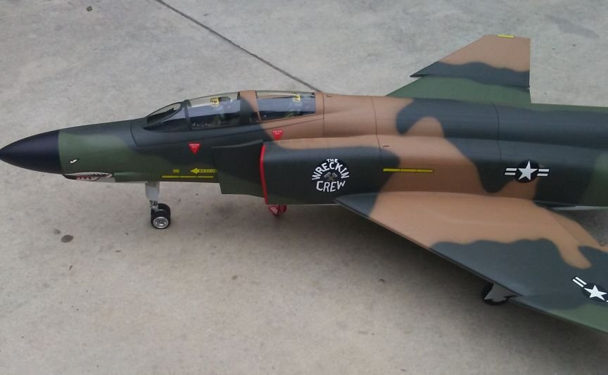

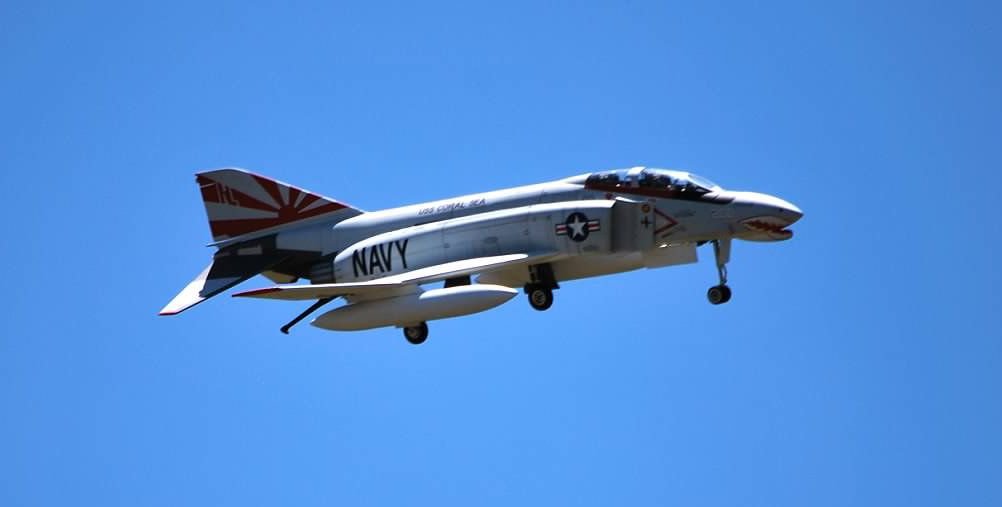

Just a quick picture of the painting/marking progress...
Still have the nomenclature and the aft hot section and tail hook to do and then clear coat.
Bob

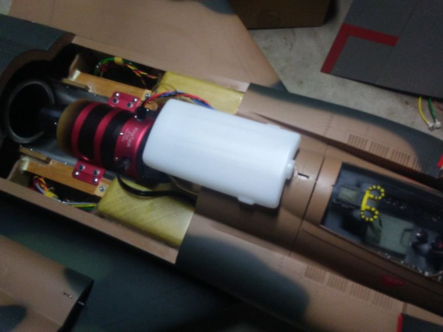

I was just wondering, is there room to add a smoke tank and pump? I changed up my scheme to the Thunderbirds for visibility and then if I decide to make the modifications for "G" version, then I will paint the Wild Weasel scheme.

The great thing about the forums is the ideas and perspectives you get from others. I like to find ways to make things work, and if I was doing a Thunderbird I would do a smoke system in this plane. Solid smoke on with a 24oz tank will last about 6 minutes, so you can get by with less than half that and still have a great effect.
With a Sullivan Saddle Type tank 11oz you could easily get this to fit where I show it, in fact you could get 2 tanks to fit there. I would go with one, some of the intake would be cut away, but it would not be visible looking into the intake. Also the tank is shaped like the intake and would function the same.
I never had to cut any of the cockpit away and there is plenty of room for a pump just in front of the forward tank. I think mainly due to the excellent components provided with the Kingtech turbines, minimal, very small and easy to install. 11 oz would be plenty for a blast of smoke show center for your entire flight. Also like I said before, with proper energy management a 120 can handle the extra weight, plus the more smoke you do the lighter it gets.
Put smoke on it, if you need help just let me know.

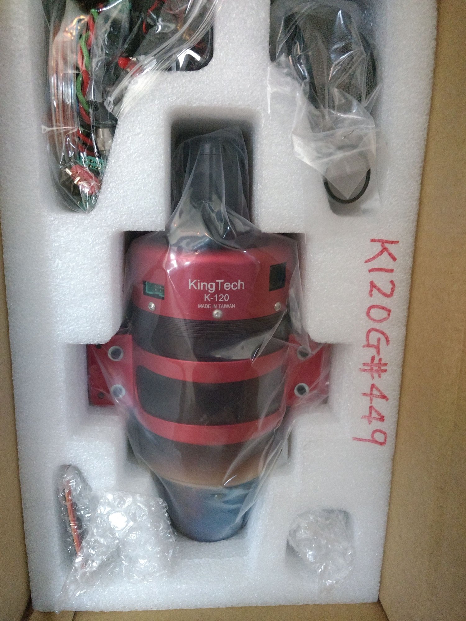

Default It has arrived
KingTech 120
