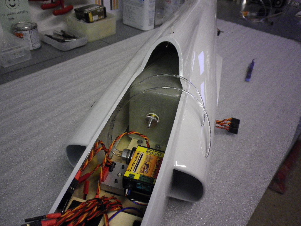

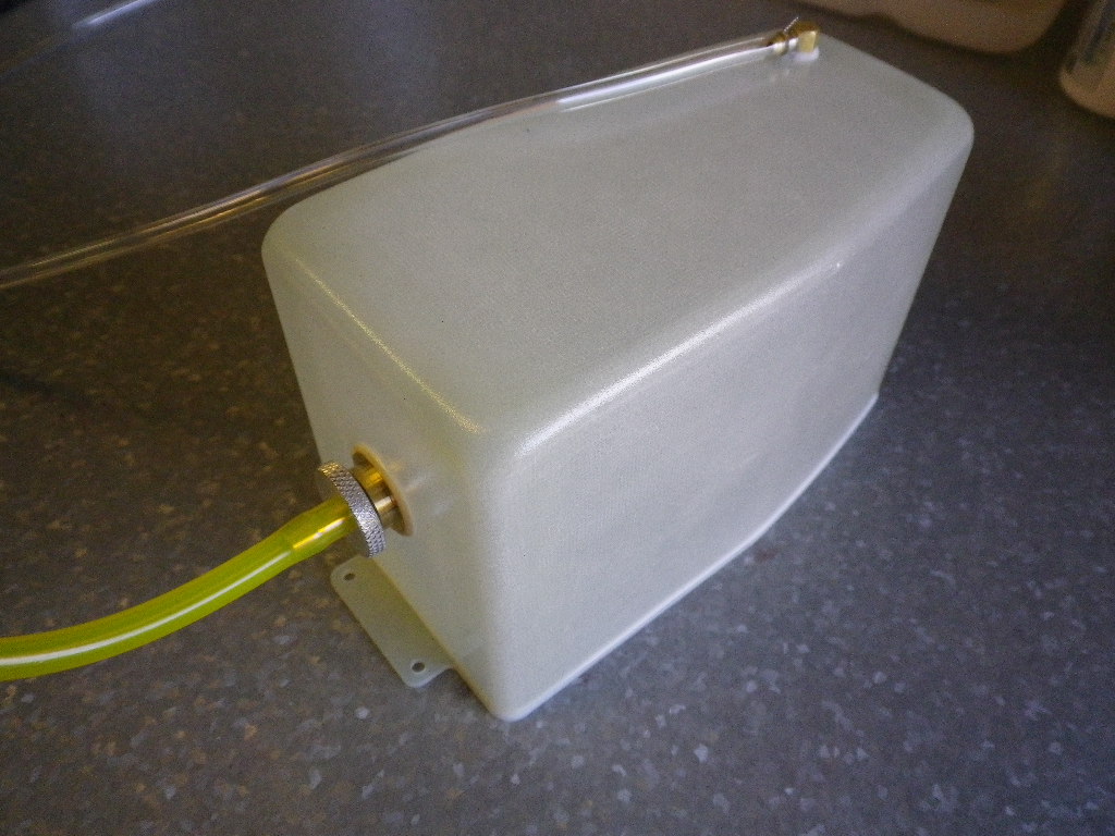

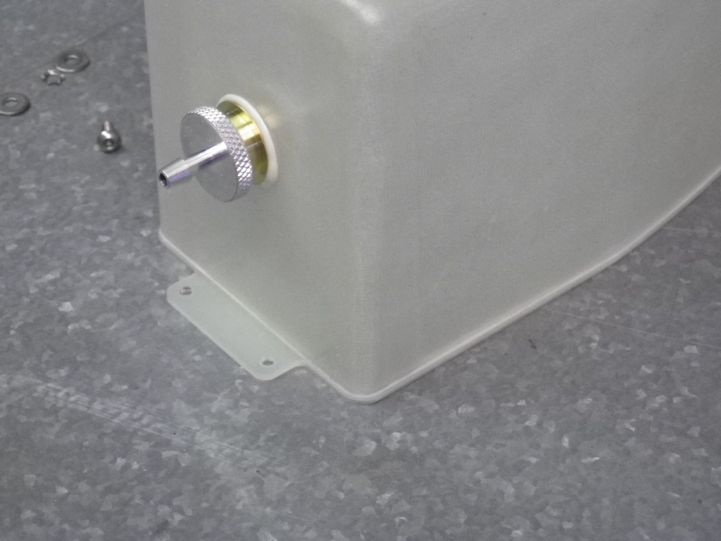

Instal of major items now, the key to the turbine version is the fuel cell, this unit is custom made specifically for the Stinger, it is 810cc in capacity and fits right back between the intake ducting. The tank is a single moulding with an FR4 base plate to which the lower edge is bonded with Aeropoxy, this plate has a rear tab built into it and a front tab with fixing holes pre-drilled. The rear tab slots into the main wing tube former (slot can be seen in previous post) and the front fixing bolts locate into holes and blind nuts installed before the lite ply base plate is glued into place.
Infront of the tank is plenty of room for electronics and equipment so have made a small removal plate which houses the fuel pump and ECU along wit the controller for the electronic gear, doors and brake systems. This fixes with two small screws and can be removed easily to allow the tank to be slid forwards for service etc.
Servo cables all terminated with connectors, and will fit Rx and final electronics tonight, may also have the new turbine mounting rails to hand so the turbine and pipe can be fitted too.

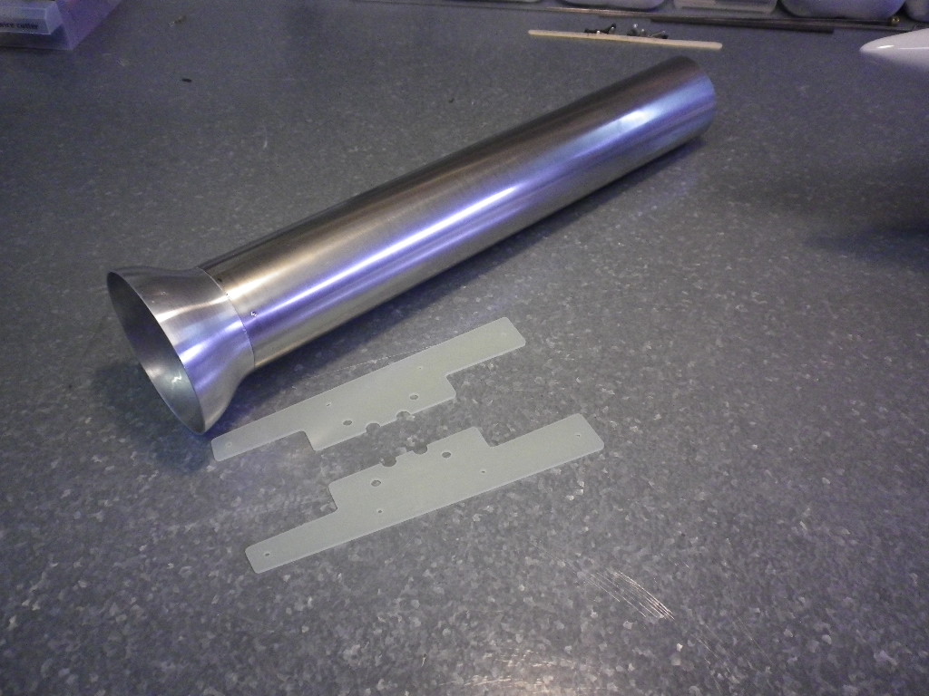

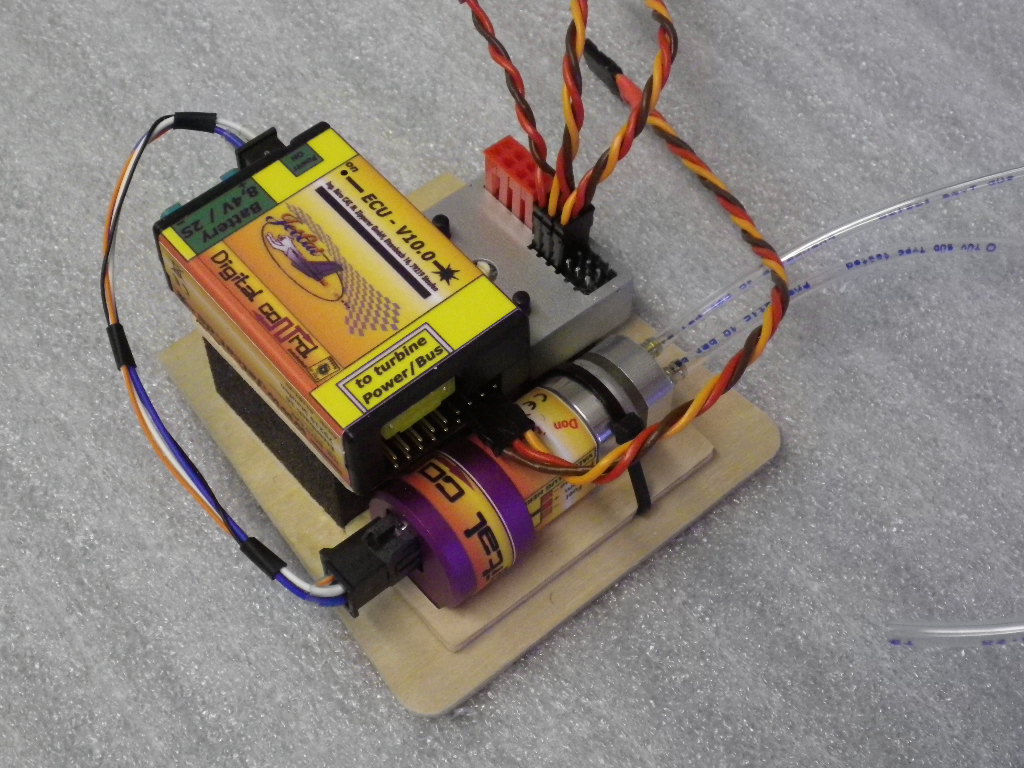

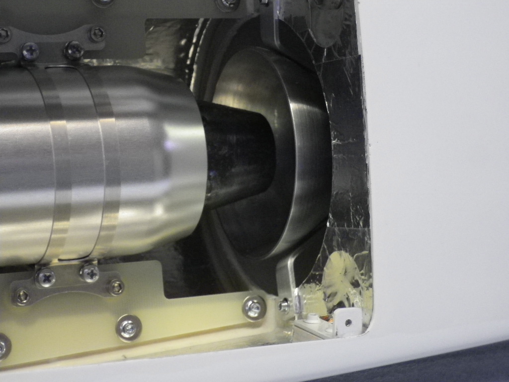

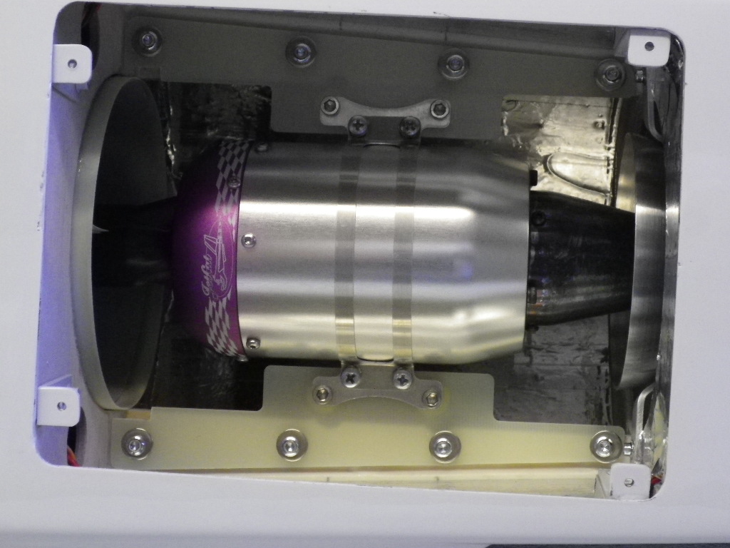

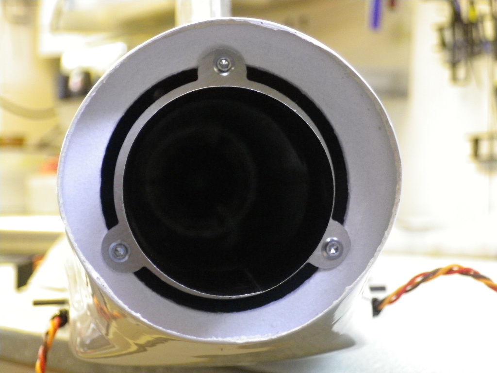

Progress has now sorted the turbine and pipe installation, had some FR4 adaptor rails made to suit the P20 as the rails pre-fitted in the Stinger allow for a 90mm EDF fan. These (with a few tweaks) will be included in the 'turbine' conversion pack. The 'turbine' conversion will include the fuel cell and base plate ready to slot in, CAT (UAT device), pipe, bellmouth, mounting straps, rear former and ali support for pipe and FR4 rail conversions all with the hardware to fit.
The pipe took a little working out to get it to line up nicely but eventually came up with a simplish method using two ali flats screwed to the side of the pipe using the same fixings that secure the bell mouth to the main pipe, these were bent to shape to allow the unit to screw to the rear former sides with two servo type socket screws.
Heat shield in the form of foil in the main engine bay, and a few coats of BVM headshield along the back sections.
Hope to get the rest of the equipment wired in tonight and then a check over. EDF next but this should be easier as the planning has been done once now

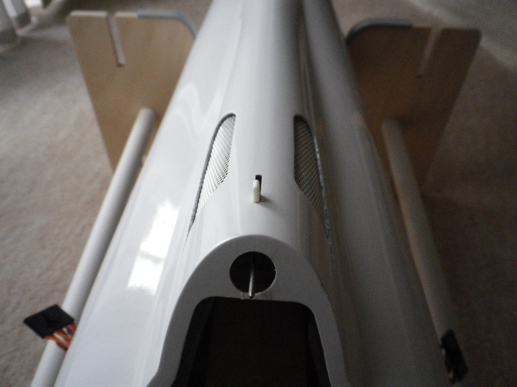

Whilst getting the FR4 rails cut last night on the cnc, designed a cradle for the Sv2 which can be 'stacked' so now I can get both Sv2's in the back of the car hassle free........

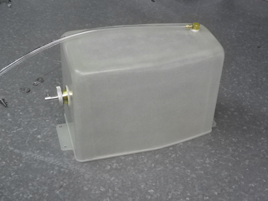

Made a slightly lower fuel tank for the P20 version, now a 750cc unit but the space above this allows for a nano CAT (UAT) of 90cc to fit which provides the additional security.
