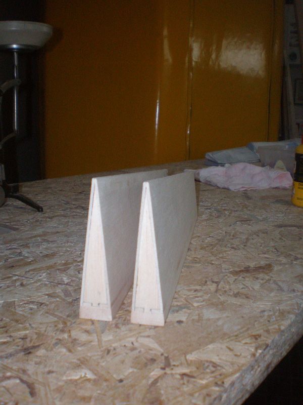

Elevator was first part which I made in this part of building. Because everything was cut on laser cut machine, all parts fits very well.
Trailing edge was 5 mm wide balsa reinforced with 3 mm ply in the middle...
First I glued ribs from the middle of the elevator. I used white glue, and always check alignment...
Soon every rib was on position...
Before glue was complete dry, I add front part which connect all ribs and made alignment in the front of the elevator...
On that part come three 3 mm balsa plates which will care leading edge...

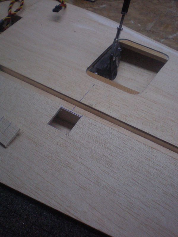

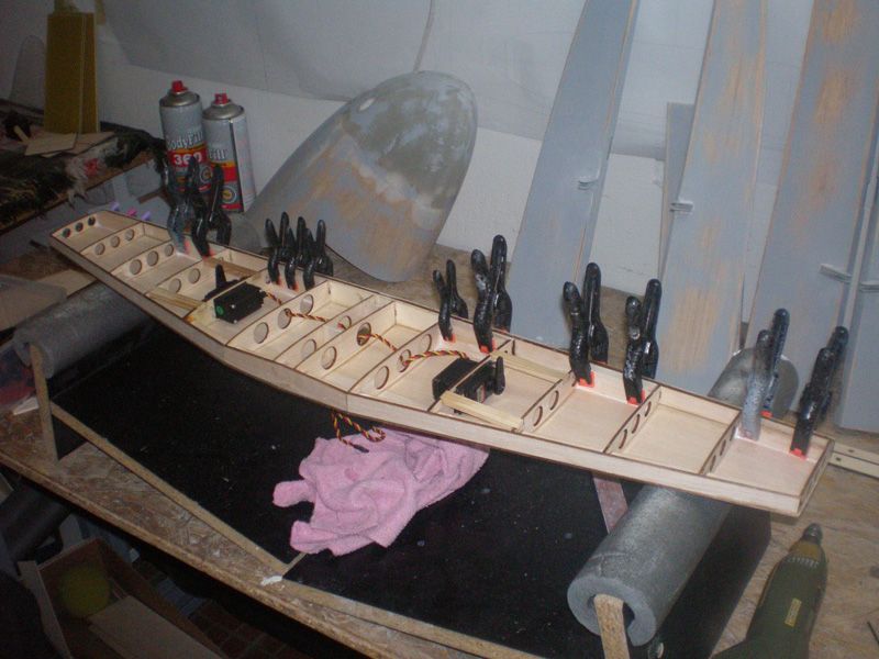

On Saturday I made just few details on elevator. I glued balsa blocks for hinges...
Than add lower balsa sheet. It was cut on laser machine too...
As you can see, servos are in the elevator.
Last for yesterday was to glue leading edges...
Before close light in my work shop, I measured weight of the elevator. It's 250 gr...
That's all for today...
Regards
Mirce

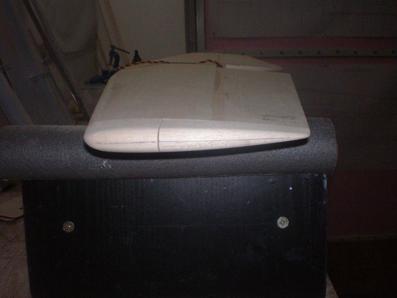

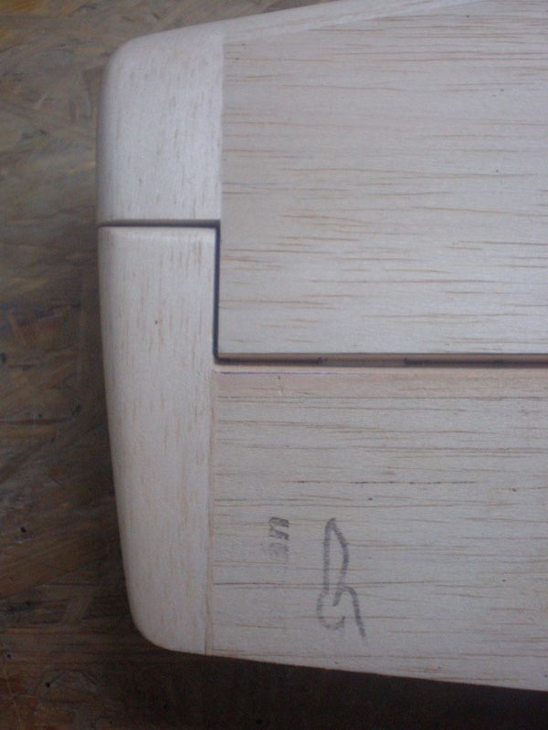

Yesterday and today I used to work a little bit on Galeb. I continue job on elevator...
On moving part of the elevator I glued balsa parts in which will be later make slots for hinges...
After smooth sanding upper balsa sheet was glued...
Next I add leading edges - 10 mm wide balsa...
Finally, everything was sanded...
Who read my topics know that I used some same techniques in my buildings. One of that is gluing parts together with double side adhesive tape...
This help me for better sanding...
Next step was to add balsa parts on the ends of the elevator...
Same was for parts which come in moving elevator parts... First paper template...
...than same procedure like before...
Before I glue balsa parts on elevator I must add 1,5 mm wide balsa to made gutter...
I connect also left and right elevator side to get perfect alignment...
And at the end sanding...
Working on elevator is not finish yet.
Martin arrived today from vacation, so I expect him tomorrow to come and to continue with work on fuselage. About 75 - 80% of fuselage drawings are finish, so we haven't a lot to do to made parts ready for laser cut.
Can't wait to start working on fuselage...
Regards
Mirce

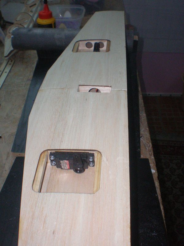

I finish work for now on elevator...

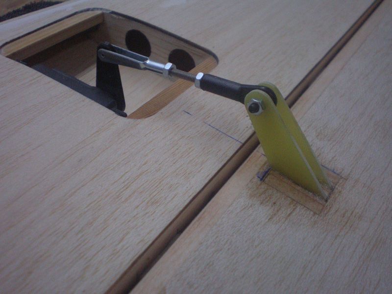

Hinge instal:
Weight - 365 gr with two standard metal gear servos (Hitec HS 645 MG)...

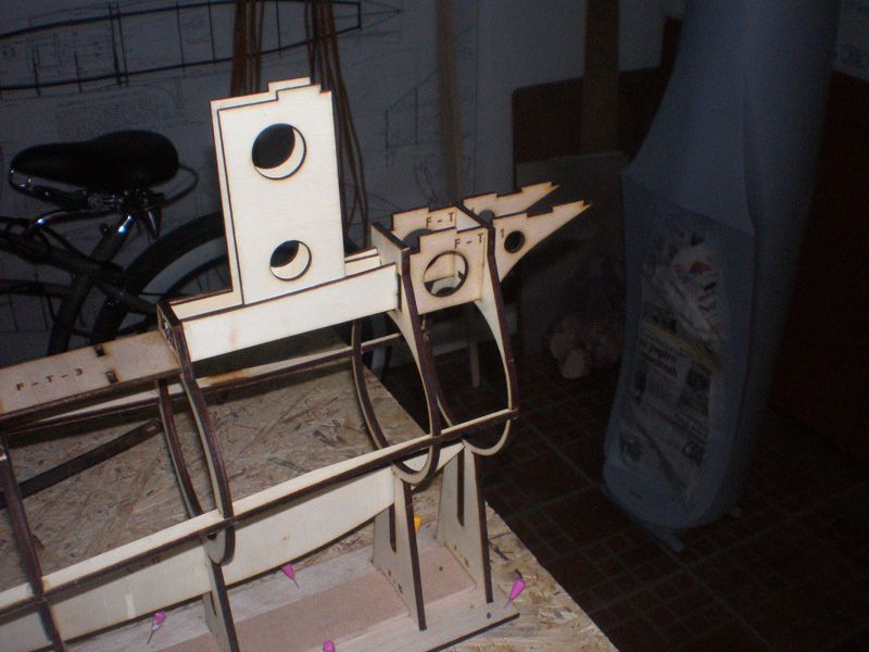

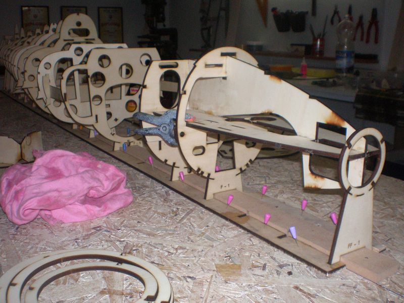

This morning my friend, who made parts on laser cut, bring me last two balsa parts for fuselages ribs guide.
Parts are longer than laser cut machine, so Martin need to made connection of two parts...

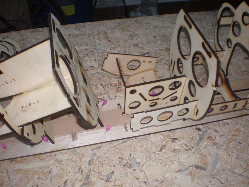

This system allow me to made fuselage without plan, and all ribs will be in line on right spaces.
Ribs was on position in 3 minutes...
Every rib fit very tightly in guide...
Rib No 4 is doubled, because first four ribs will be removable for easier access to front part of the fuselage...
Before start working I print two papers to have better view where to put every part of the fuselage...
As you know, I want from this project to made kit for building, so with plans for wings and other parts, there will be CD with animation for every airplane part, which will show every step in building process.

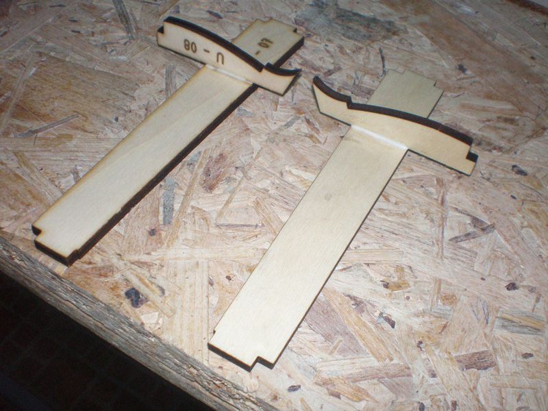

Fuselage of Galeb G2 have many parts, so I prepare some of them on worktable, to be sure do not forget to put every on right place. Every part have gutters so it's important to build in right moment.
Before adding glue, I try every part to check how it fit. I saw that all gutter holes are just a little smaller. For precise sanding I made tool from 1,5 mm G-10...
Working on this fuselage is something new for me also, so I need to think "three steps forward". First I made all small frames...
Small part I glued here is reinforcement for front landing gear plates. On that rib (and small part), are two holes. I use two tubes for good centering those holes...
On next pictures I just want to see hoe parts are fits...

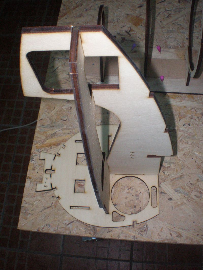

...and when I saw that everything is OK, I glued first vertical part on rib number one, and after that I glued rest of ply parts... Than I put this frame back in guide on worktable...
I made few more sets...
Time is come to glue first parts which come between ribs...
Next step was to put inner wing saddle parts. Of course, here, like everywhere, I first fit all parts without glue...
On rib No 3 I add next part...
In meantime I made bracket of front end of the lower tank...
Rib three was glued in place, together with tank bracket...
After glue dried, I embed front part of the fuselage. Before that I must put UAT holder in place...
Everything fit perfectly...
Last big part on front end was upper plate...
I glued it all, just not glued rear edge, because I need to separate front and rear fuselage part when need to put outer wing saddle part.

Yesterday I continued my work on G2 fuselage frame. First I was working on the fuselage rear part...
Next was to add first rib on air intake. Thar rib is under angle, but design of the parts allows you to put that rib exactly in position...
First you need to glue rib joiners. Don't forget to pull through that part in the rib...
Than I add few hardwood parts, lower tank holder and turbine carrier...
