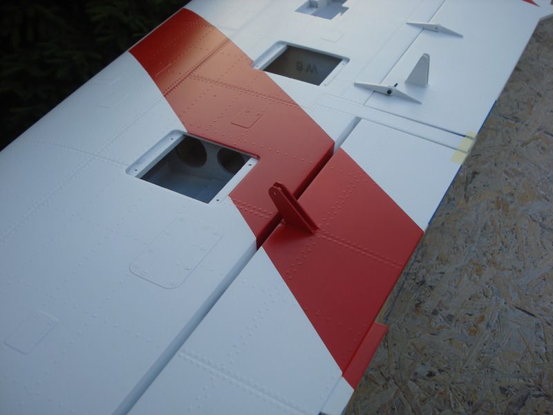

Yesterday wasn't Christmas, but I have same feeling like when open gifts...
Red color is finish...
Nothing without red star...
Fuselage...
Model is almost prepare for blue color, so in next day - two it will be in paint shop again...

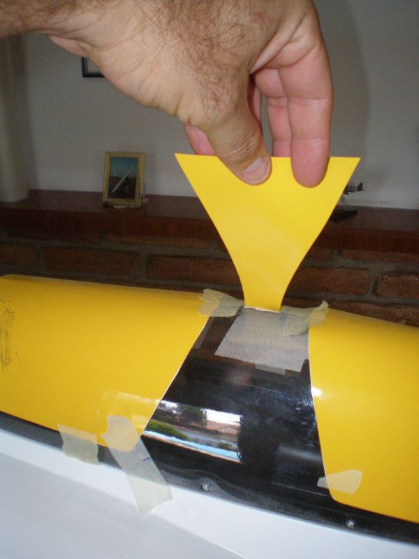

Tomorrow I will finally go to my friend workshops for painting and paint blue color on model.
Unfortunately I need more time to prepare all parts. Wing was relatively easy to prepare...
I forget to apply masc for insignia so I add it later. It's not on this pictures...
On fuselage I have more work to do. Front, removable part get clear plastic...
Biggest work was on canopy. Old canopy, which I made few weeks ago, now I used for template for new canopies, I got few days ago. This new canopy are made from 1 mm thick plastic, and are quite sturdy.
After I trim and fix new canopy on frame, I must apply vinyl masc for glass areas. Template I get from our 3D drawing, so I cut every glass separately and glue it...
First I put all glasses and fix it with tape.
When I measure all distance I apply front and two side glasses. I mark exactly position for every glass masc...
Next was glass in the middle of the canopy. After measure, I fix it on the top of the canopy and glue firs one, than other side...
For two biggest glasses I first made frame from 3M thin tape and fill it with paper tape... For tis operation you must have good eye and steady hand...
Finally I apply screws around of the glasses, like it was on real Galeb G2. I forget to made picture of this details...
Canopy is now ready for painting in blue. After that process I'll remove templates and canopy will be clear with blue frame...

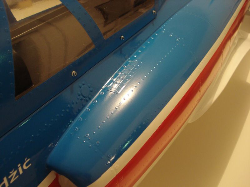

OK, here are all pictures...
First, two from yesterday of the canopy with dummy screws...
My friend Golub paint model, and like always he made perfect job...
After fuselage and small parts, he apply blue color on the wing...
This is paint masc for insignia...
Wing surface details...
Wing stay in Golub's work shop, because we need to apply red star in insignia, but other parts I take back to my work shop, where I start take down paper and vinyl tapes from the parts...
Without every new paper Galeb was to be more and more beautiful...
At the afternoon I went again in Golub's shop, where I apply paint masc, and he paint red star in insignia...
After that I take wing in my work shop also, and later my friend come to check is paint OK...
Model is perfect...
Two more of the fuselage...
Tomorrow we will start work on clear cote. For this operation we need three days...

Thank you guys...
Everything is going according to plan ... Yesterday wing is paint in clear cote too. Both side was done at same time, first lower side...
...than we turn around wing, put it on wooden beams and then Golub Paint other wing side...
With clear cote wing get new dimension...

Yesterday I assembled painted Galeb for the first time...
As can be seen, I just install retracts for this photo session... Camera wasn't my, so color on pictures are little brighter than it is live...
I call my friend and pilot of real Galeb G2 - Dragan Amidzic, to come and see model of his jet airplane.
He wasn't seen it yet, so was very impressed, and order to make him same like this one, but for static display... That is first order of this projects...[8D]
For Sunday we made agreement to made pictures of our two jets - real G2 and model G2. Hope weather be nice for this photo session...
