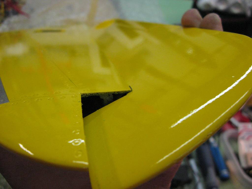

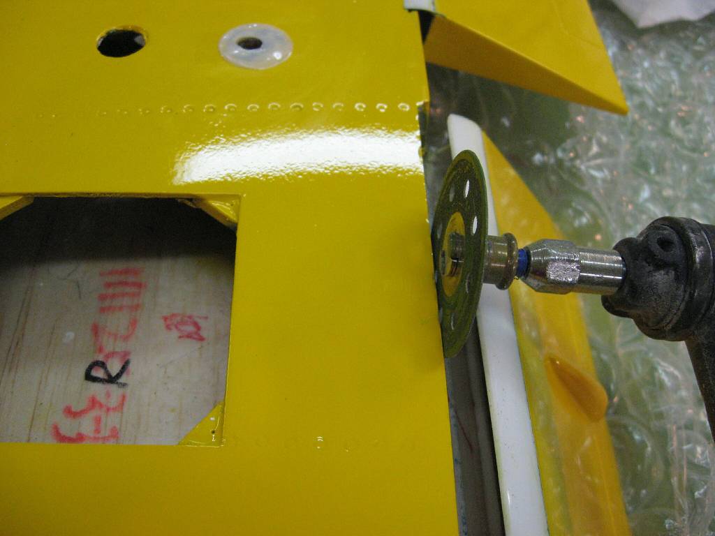

In order to get full defletion of the elevators without
drag or friction... Ihad to remove some of the edge where the
elevators meet the stab.. on my unit this was WAY too tight and Icouldn't get
the deflection called for in the manual.. SO I marked the stab with a straightedge
at approx 1/16" and removed material with a dremel equipped with a diamond wheel
This is NOTfor the faint hearted!! since a slip here could cause problems...
It all went well then Isanded where Ihad removed to a feather edge by hand with a flat file
Ikept doing this until Igot good deflection with "0"drag...
Isuspect this will have to be done for the Ailerons and Flaps too!!!

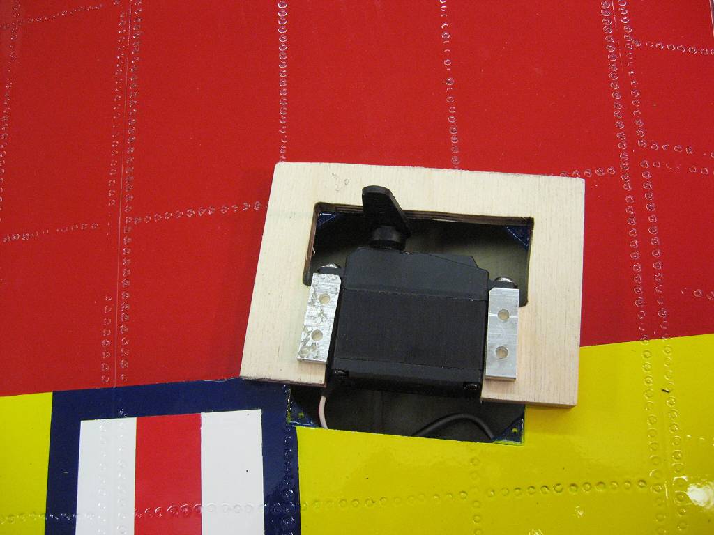

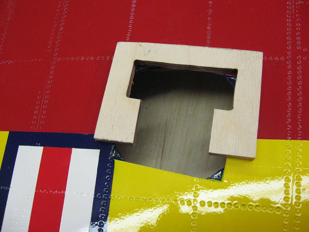

There are no servo mounts supplied for the flap or aileron servos
Looking at the Skymaster manual online, this is how they did it.
I made a 1/4" thick "U" mount that will beattached under the wing skin
then the servo can be mounted to the sturdy tabs on this!

OK 1 wing done. I had to mill the servo mount tabs
so the servo cover can be installed flush with the wing surface.
It fits great.. WOW after I cut the slots in the aileron & flap. I discovered
that there is NO woodunder the surfaceto act as a backer!!! Hmmmmm more work!
this should have been done at the factory!

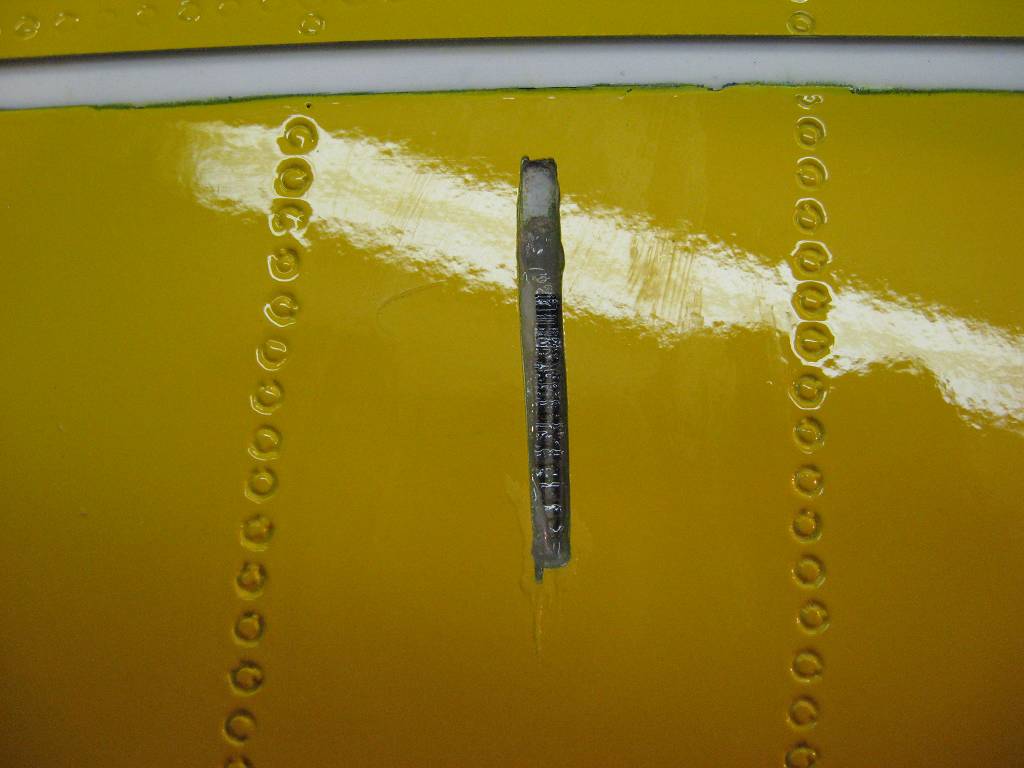

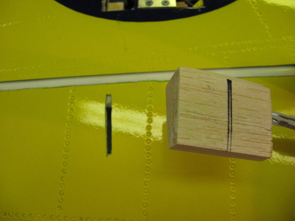

OK Iam placing the backer pieces in the ailerons, flaps and elevators!
Doing this:
1. Removing one end of the surfaces to allow insertion of backer
2. Fab a backer out of hard balsa.. mark the centerline on the backer
3. Using a #13 acid brush on a long stick.. Iplaced epoxy inside the surface wher it goes
4. Butter up the outside of the backer
5. Slide it in, reglue the end removed in #1 above
6. Dremel out the slot for the horn, then attach the horn..seems like a lot of extra work for an "ARF"!!!
Doing this:

I typically slide the blocks in from the leading edge of the control surface if the hinge allows enough deflection without damaging it.

You could dremel a slot in the area inside thefont sideby bending the surface at a high angle so you
can access it with a thin grinding bit, then insert a backer in that slot BUTIhate to bend the surfaces too much
in fear of stressing it. The way Idid it the backer can be made to be almost an exact fit to both sides of the surface

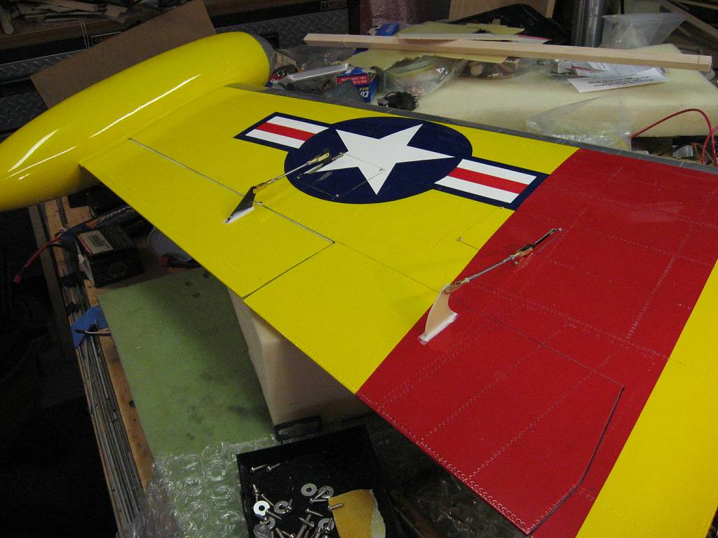

OK 1 wing all done
I made the following changes:
1. Tip tank removeable
2. Designed a different control horn for the flaps
with greater glue depth (all the way to the inside of the upper flap surface+ higher
formore mechanical advantage) + it is mounted 1/2" behind the hinge line as well
3. Removed 1/16-3/32 of the lower lip where the aileron closes against the wings for
more throw and vastly reduced friction here.
Now I have the following surface throws:
Aileron + 40mm
Flap - 128mm This will allow for a setting that gives greater drag than lift so steeper approaches are possible

OK I am placing the backer pieces in the ailerons, flaps and elevators!
Doing this:
3. Using a #13 acid brush on a long stick.. I placed epoxy inside the surface wher it goes
6. Dremel out the slot for the horn, then attach the horn..seems like a lot of extra work for an ''ARF''!!!

#44
My Feedback: (84)
Join Date: Oct 2003
Location: wilmington, DE
Posts: 1,374
RE: SKYMASTER F9F Build Thread
Well it's not too hard to do, just frustrating that it wasn't done at the factory
it IS a gorgeous plane with lots of nice features.. it always has been one of my favorite planes...

Hi,
These kits were the first batch. I received the same batch for manual and suggested this in the manual. Also no accessory tray was supplied in the 1st batch.
The latest batch will have the wood in the control surfaces and tray.
Best regards
Morne
