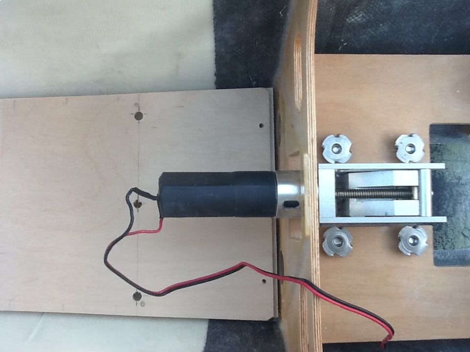

Today I got everything together to start the latest Pinnacle Aviation build. The kit is the new C&C models (Italy) M346 and will be powered by a Jetcat P160. The model was supplied in white which is straight out of the mould. It needs a little work to replace some of the detail that's been removed during assembly. I am waiting for the detailed cockpit to arrive but the amazing electric retracts arrived with the model, just stunning piece of engineering.
Anyway I will be progressing over the next couple of weeks as the model is due to be displayed and flown at Jet Power 2012

Yesterday I had some great progress and a slight set back. I was able to fit the engine, fuel tank, battery tray, GBRJet CAT, jet pipe, utility panel and the main component tray.
As the u/c is scale but does not retract the correct way (should twist and turn on retraction) I decided to have the main door open outwards and the small door to open inboard and stay open whilst the gear is down, the real aircraft this door is attached to the leg it's self. With this in mind I decided to make the offset hinges myself as on the rear doors I wanted them to open more than 90 degrees.
I have one side complete, I will fit the other at the end of today so the hysol can dry over night and not hold me up during the day.
I should have her finish and ready for the paint prep tomorrow, I am looking forward to painting her in this new scheme. The paint decals and paint masks are coming from Taylormadedecals who I feel is one of the best decals producers, if you can use him and follow his process you will have a model that will look so scale.
Umm the set back, this was very unexpected, one of the main legs just stopped working, everytime I selected up or down all I could here was a click. As this model is so new and spares at the moment are not available we decided to dismanttle the unit and have a look to see what the problem is, straight away I found the problem when the gearbox was apart, one of the bearings had disintergrated, the flange had come apart and jammed the gear box, I cleaned the debris and made a tempory one out of aluminium until I can get some brass for a new one.
And now the gearbox fault
