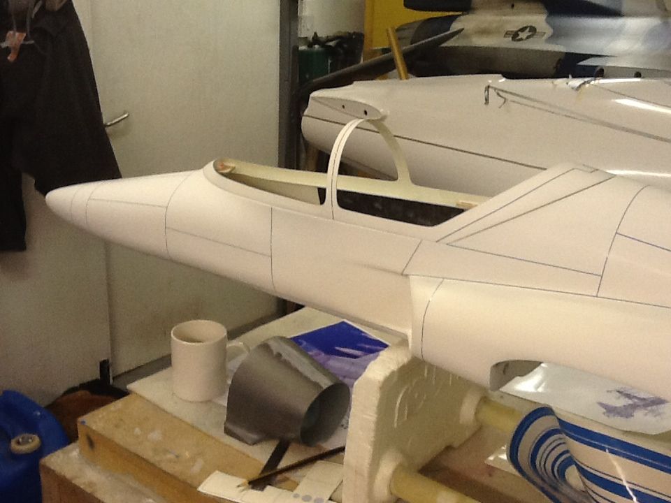

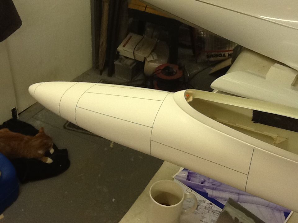

    Making an Ultra Flash into an F-20UF
    This will be the second conversion from sports jet into pseudo scale jet. As the Ultra Flash looks a little like an F-20 I thought of a refreshing change from the standard Comp-AFT standard schemes and the over used Formula 1 team schemes. I am also going to utilise the current aggressor schemes used by the US Air Force, US Navy and US Marines.
    I will leave the unavailing of the scheme just prior to painting her.
    After installing all the equipment into the airframe I subsequently removed it all to make the painting easier. The first job I did was to sand down the airframe with scotchbrite to give it a surface finish for the primer to adhere too. After that process was complete to save weight I started the panel lines using some self manufactured panel tape. This tape is just normal vinyl cut into 0.8mm wide strips. As you can see I used similar panel lines of an F-5E to give me a rough design as we used the BAe Hawk panel lines for the Ali's Futura.
    Tonight I have finished the wings and Horizontal stabiliser (tailplane here in the UK). People may ask why the panel lines, well if you have seen my previous paint projects you would have noticed that I love weathering so in this thread you will also see me weathering the model.
    Enjoy the following photos.

    This evening I finished all the panel lines on the Ultra Flash. Tomorrow morning I will give the model a coat of 2k primer over the whole model. I was hoping to have a little more time on the model but two models arrived today, Ali's FEJ F16 for installation of a new large undercarriage and lights, also the Tomahawk Large Futura for build and paint for Aerotrim wing bags. I will be adding a build and paint thread to RCU for the Aerotrim Futura.

    Looking great so far! I like the new wing planform on the Flash and I think it will look great as a Sport F-5.

    can't believe how much definition the panel lines give to the shape of the flash...It should look fabulous when it is finished!!
