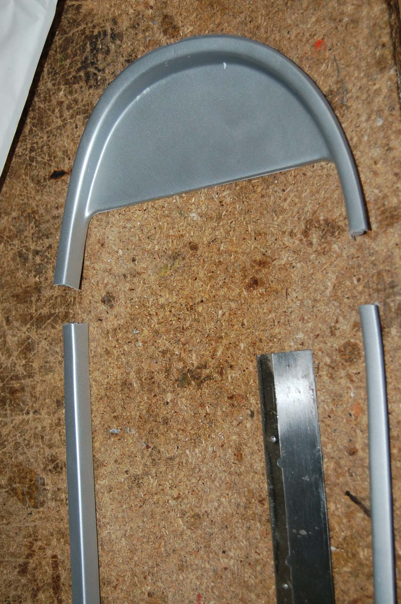

  #143
Dave Wilshere
Join Date: Jun 2002
Location: Watford, UNITED KINGDOM
Posts: 13,092
Received 732 Likes on 528 Posts
Just working on the cockpit of another Transformer L-39 and scratched my head on getting the canopy frame cover in with the glass fitted. Just cutting it in two and gluing it in position seemed a little too permanent, so I added magnets before cutting the frame. I can hold the frame at one end and it stays put!
This is it dry fitted.
Old 11-01-2019, 07:37 AM
  #144
Canadian Man
Canadian Man's Avatar
Join Date: Aug 2008
Location: Calgary, AB, CANADA
Posts: 837
Received 205 Likes on 145 Posts
AWESOME IDEA! Thank you for that!

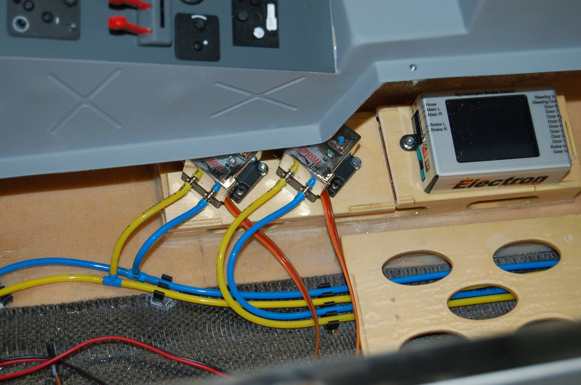

There does not seem to be any information on assembling the cockpit on this L-39. I've been working on this one for a friend-so he is what I have learnt!
The sides will be held with velcro strips, just on the high side of the cockpit. Once the whole thing is assembled it only requires restraining from slipping down or fore-aft.
I decided since the tube has to have the centre tray removable for access I have epoxied 8 M3 spike nuts to the glass sides and will use M3 x 8 button head screws.
The the assembly testing I have used magnets to hold the side as it needs removing repeatedly!
Care needs to be had on anything under the tray-the builder mounted the airvalves on a box and they were hitting the tub, so I razor sawed 5mm out of the valve plate. Yes we are using Air for the doors and Airbrakes.
Do not fit the instrument panels until the sides are complete....I guess there position and they hit the side plates-luckily I had tacked them in so they were easily removed!
More later
Old 11-14-2019, 02:57 AM
  #150
Dave Wilshere
Join Date: Jun 2002
Posts: 13,092
Panels/binicles back in. I had to lift them 4mm over the original flush with frame height.
I can now do the seats.
