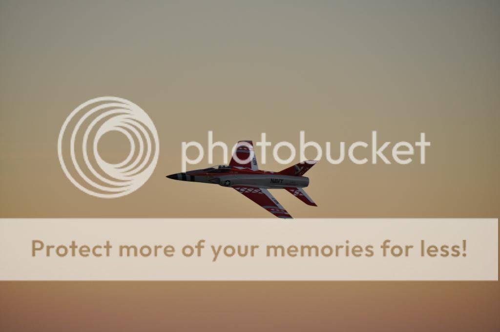

    So I was doing my usual inverted flat spins in my Bandit. And then I decided to try to do it, right side up.
    The damn airplane didn't want to recover!![X(]
    When I'm doing them inverted, my Bandits (the Ultra Bandit is like this inverted) they recover really fast.
    When I tried it right side up, the recovery didn't want to happen. I had to give opposite aileron and down elevator to recover.
    Anyone else seen this phenomenon?
    I figured the vertical stab stops the flat spin when inverted. When right side up, the vertical stab is in too much turbulence to be effective.
    Hey, a right side up flat spin killed Goose in Top Gun!

    Opposite aileron (lt in this case) typically enhances the spin rather than breaking it, as it (counter-intuitively) makes the outboard wing develop more lift while stalling the inboard wing more deeply. Then going "in-spin" (rt) would add drag to outboard wing, stall it, and slow the rotation, even as it "washes out" the rt wing and helps break the stall on that side. (If this seems confusing then remember that spins and snaps are conditions where one wing is stalled and the other is not) Ur spot on ref the vert stab being more effective while inverted.
    Dn elev is ideally applied after the rotation stops so that you don't create an accelerated spin, but hey....
    If your jet is in one piece then theory aside, whatever you did worked for whatever reason, and it's a good day !
    Big props to you for doing more than the usual "whoosh, pull, repeat" typically seen with jets, thanks for sharing the great pics!

    My Ultra Lightning recovers almost instantly both straight and inverted just centering controls...! (but I admit it doesn't look that good!)

    Normally the Bandit and Kingcat/Bobcat airframes spin great inverted but have a hard time in the upright due to the washout in the outboard wing panels and the cusp at the fuse on the Kingcat/Bobcat. If you try an avalanche with any of these three models the model will begin the snap and about 65% of the way through the snap it will stop and then begin again. Do a negative snap in the avalanche and it will do it all day long. Recovery routinely is never an issue from either position.

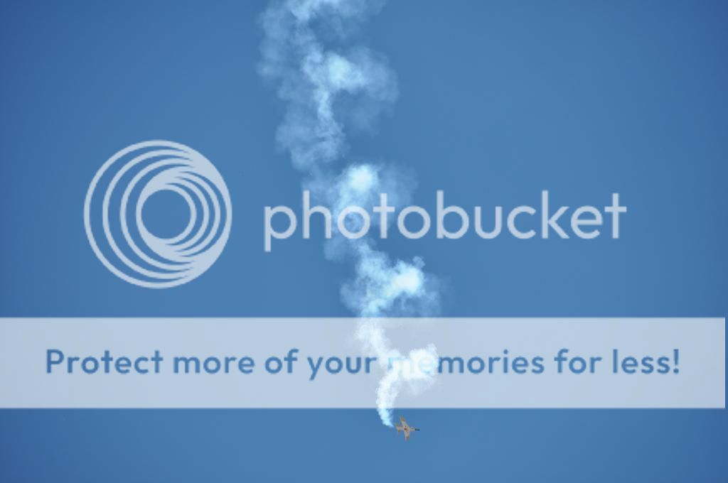

    I panicked when I saw that it didn't recover. After letting go of the sticks (it always recovers inverted), I waited, and waited and then panicked!!! I had to do something. I just input what I wanted the airplane to do, stop moving in the spin it was moving, and when it recovered, I just let go of the sticks again (for good measure). And continued a shaky flight!!
    Luckily, I had enough elevation.
    Hmmm, when I do avalanches, (I've always been more comfortable with inverted snaps), my bandits (big and little) have no problem with the snaps.
    Here is a nice pic of an inverted flat spin (and then a smiley face! )

    I think i was spotting for you and yes the plane took quite a while to recover. Killing that lift with aileron movement can definitely deepen the stall...see ya soon bruh!

    Raffi, "going to idle" and releasing the sticks always works for me. You have to react quick after the spin stops.
    While maintaining full power the recovery is very difficult if not impossible.
    I don't know the aerodynamical reason for this, but I am sure somebody here is going to explain it (probably between a couple of insults ).
