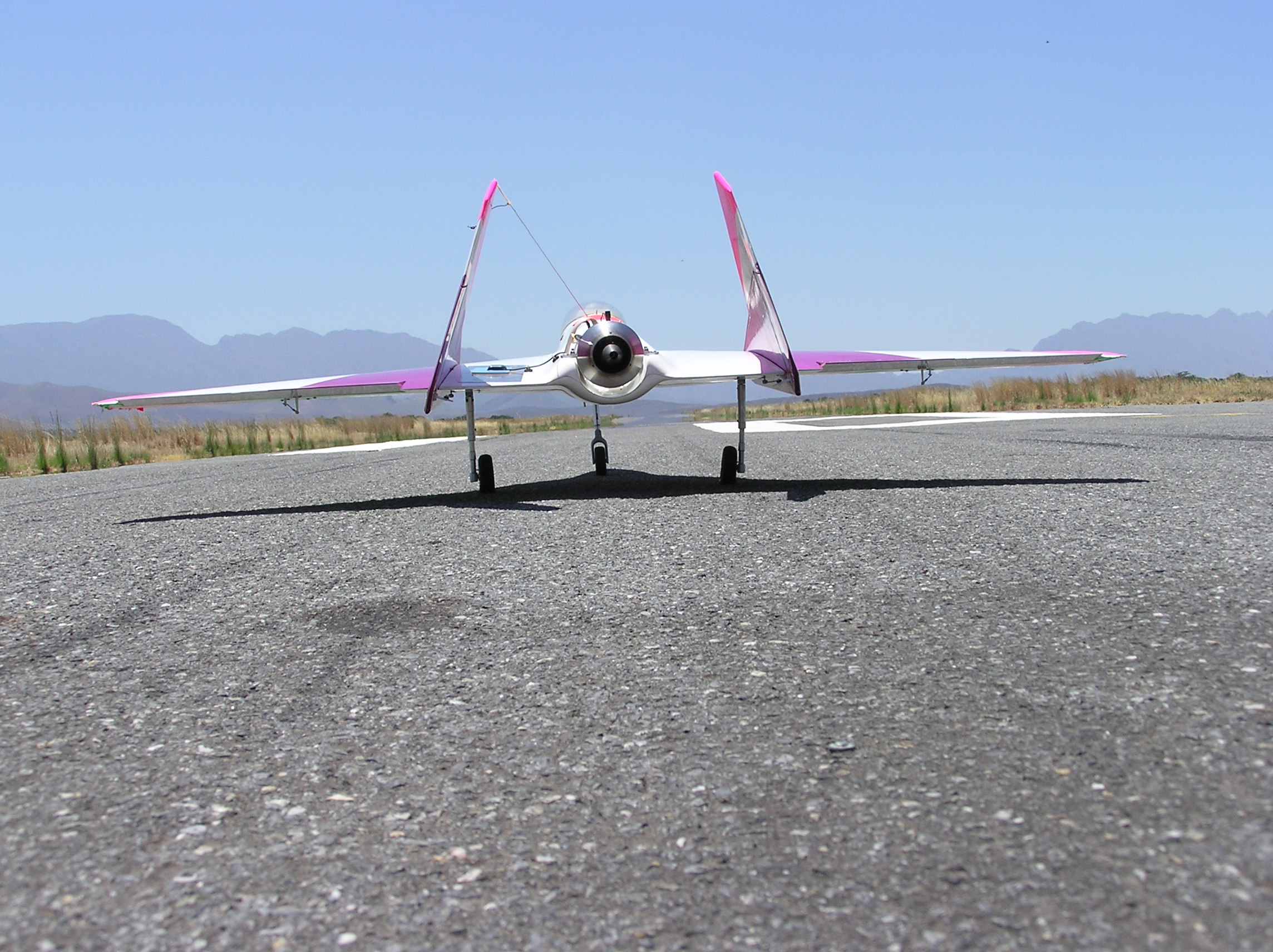

Not sure if the pic is clear but I put my rudder servos in rear fuze. I mounted them on a board and dropped them in using nylon line through the arm slot in fuze attached to servo horn to fish them through.
Then screwed them down through fuze bottom. Fins was bare wood with film covering. Not too rigid but I never had flutter at 400kph+. used plain old 504's
Also the rudders are only halfway to top of fin.
Andre
Andre

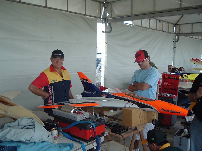

What is out of place is that left eurokit landing gear.! Stiil flying that set in my old Roo...
And the SHS is still around, and it is not a kit... it was purposely built for the jet speed event..with a very strong custom fuse, fins and wings... this thing is tank solid and very lightweight.
I once borrowed it for a friend of mine for a speed flight. He is a good pilot, but he landed it as it shouldn´t and kangarooed it for more than 100 meters... last jump went of the runway and plane disapeared in the vegetation. To his surprise, the plane wasn´t damaged or have a single crack even if the landing gear legs where bent almost flat (!)

Can you share any info / photos on what enhancements you made for flat out speed and durability? Very curious, starting my build soon! (bathroom renovation is almost done, gotta keep wife happy!!!!!)

That´s the proper way to keep flying jets without feeling guilt with your better half...
About the mods the airplane was completely scratch built. The wings where built with highest density foam,we found, with two wing tubes and skinned with veneer wood and fiberglassed.
The fins are sandwiched balsa and fiberglass, The fuselage was layed up more or less like the graupner original, but with some veneer glued on it on the straight "soft" parts.
Later, a carbon fiber rib cage was glued on it, and carbon fiber strips where glued in the leading edge seams and CF roving at the fuselage / former seams . The cabin is solid balsa sanded to match the fuselage curves. This single mod is the most important one.. the airplane feels and sounds completely different with it,.. you can hear the air being ripped if you dare to make a low pass in the runway at full power (!) The elevons are actuated by two servos each, but they aren´t split. as I think that they are more rigid this way..
Unfortunately we didn´t took pictures of the build, as we where in a hurry to build the airplane in time for the race, and at that time my cellphone didn´t have a camera..
p.s. forgot to mention that is a good idea to reinforce the fuselage underside glue joints behind the main landing gears.. some original HS´s had this part completely ripped of the fuse at speeds as little as 250mph.
