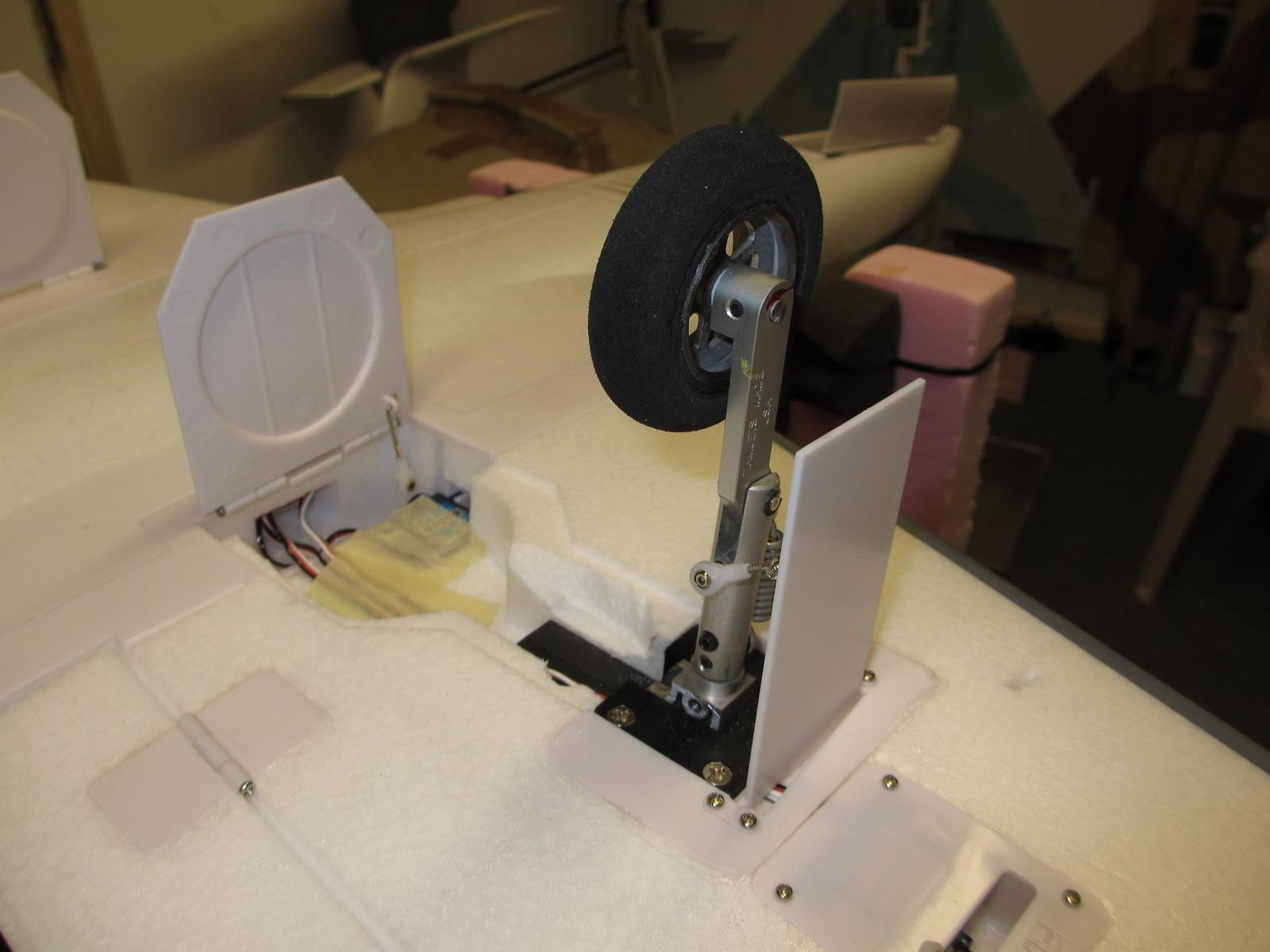

I'm just converting my Viperjet with tamjets struts and the electro breaks (with turbine I need them to ever stop)
I use the Super Sniper struts which are disassembled to be shortend by about 1/2". One of the main wheels became the new nose wheel and the larger ready2fly breaked wheels will be the new mains.
Henke Torphammar is offline

Nose gear is ready while the mains use temporary wheels(correct size) as the breaks haven't arrived yet. Useing temp wheels will make the foam cutting easier. I think it turned out pretty well. The suspention is super good now! Once again I encourage you to take the step and buy a set of real struts. They are very much worth their money and will move on to the next airframe too!
