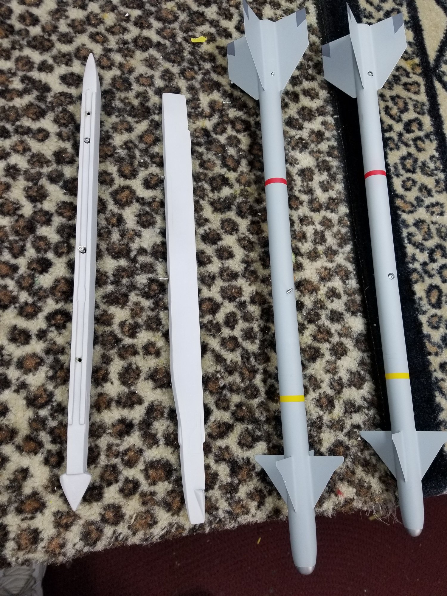

Originally Posted by egldriver View Post
my elevators are about 3/16 up. my cg is possibly a little forward ,but i like the way it flys. the missles and rails came pre drilled. i used 3/4 inch #4 socket head sheet metal screws to mount them. firm up the holes with thin ca
thanks a.lot !
can you please show me how do you install the missiles support to the wing and the missile itself to the support t?

Originally Posted by scaryxxl View Post
thanks a.lot !
Egledriver explained it pretty well, mine are done the same way, the hole should be pre drilled in the wing tip and the missile rail.
The only thing I did different on mine is I glued them to the wing tip with E6000. My idea being that if it were to break off the
damage would be somewhat mitigated as the glue is strong but will give. The missiles are done the same way. I just taped the missiles to the rail,
drilled, hardened the holes with CA and inserted two sheet metal screws.
GreaT !!
thanks a lot for the info.
I saw in my airfield one guy that done it with 5mm banana ! he glue the missile into the support and the suport install 2 male banana and in the wing drilled 2 holes and install 2 female banana !
what do you think ?
