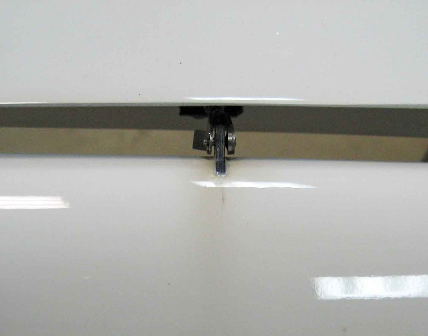

does anyone have the Fouga with the flaps in the sport scale version, with the hinges instead of the rails ?
I would need some photos of the hinges of both flaps.
Many thanks
Franz
Many thanks
Franz
I did mine with "sport" hinges. My suggestion; set up each of the 4 flap sections independently, each with their own servo. I found it impossible to drive both flaps on a side with the supplied rod/hardware with a single servo, so I did away with the rods entirely. One servo per flap worked great. This is all I could find in the way of pictures:

many thanks Craig, that helps. May I bother you with another question. What is the height of the hinges ?

Craig is right, 4 separate surfaces is the better way to set up the flaps.
here is a photo of mine (used to be Craig’s). Height of the pivot varies at each hinge. Going out board to In board they are:
28.5 mm
36.5 mm
36 mm
40mm

I was considering the RC Jet Center Fouga for a while but finally decided to am build a slightly larger model in 1:4 scale. Most of my other planes have this scale as well.
This kit is unfortunately not prefabricated as well as the RC Jet Center model was. I have to make a lot on my own.
Could you give me also the offset from the leading edge of the flaps ( or the line of the wing in front of it) backwards to the pivot point for the 4 hinges ?
That would help me a lot.
Again many thanks for your help.
