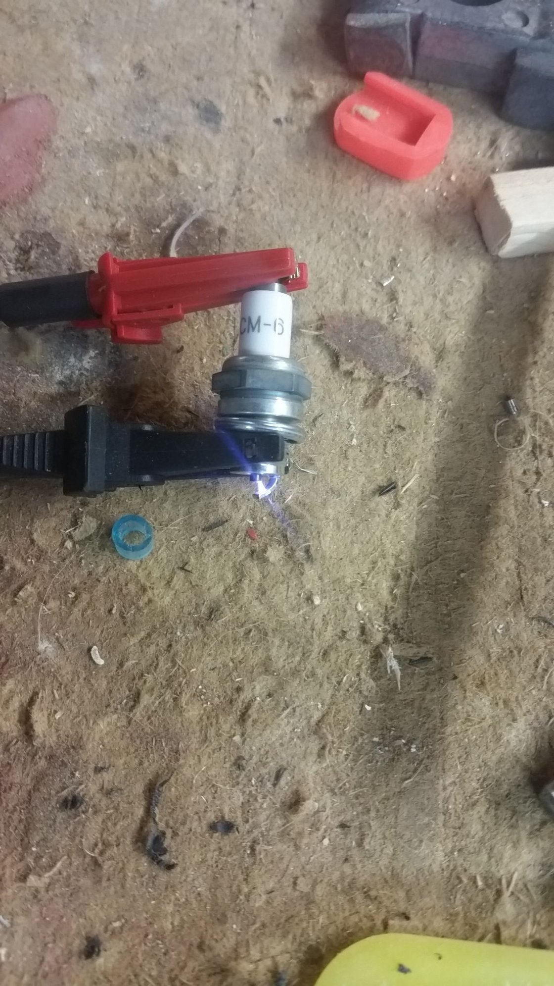

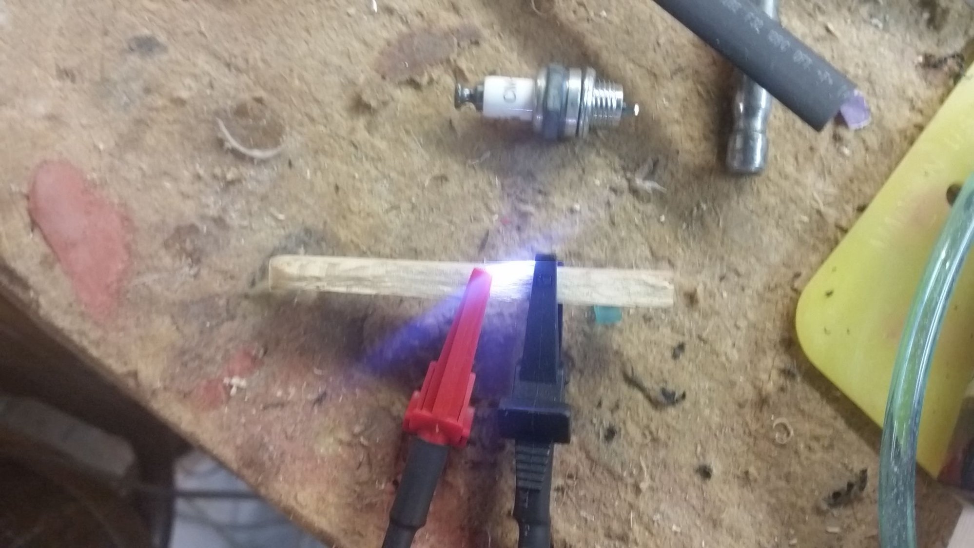

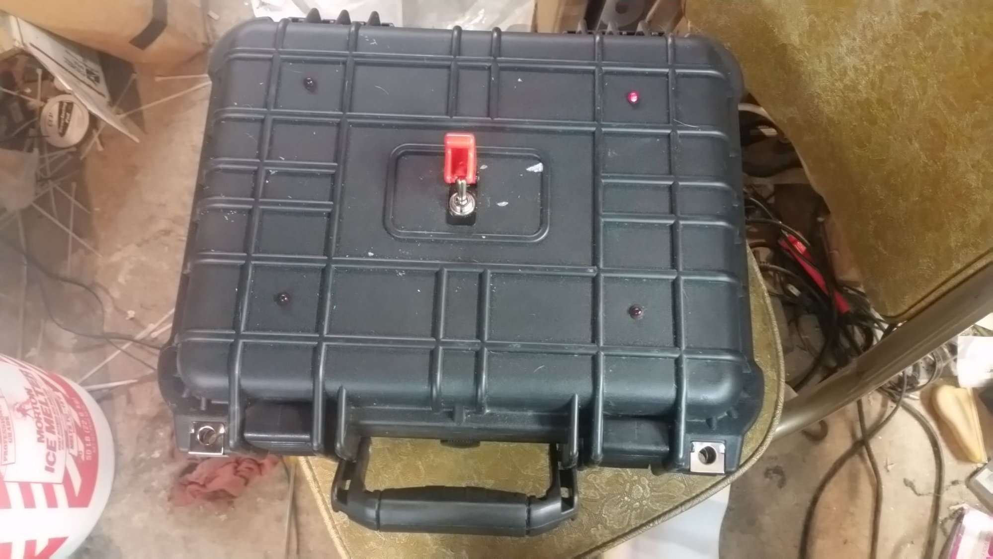

OK as promised her are some pics of the ignition box.
I have now completed the ignition system for the engine. I need a continuous spark to get the fuel to ignite. once the pulse jet is running the flame is self sustaining. this box will stay on the ground and is just for starting. It produces a spark about 3/4 inch long, and has a really hot fire across the electrodes of the spark plug. It is really pretty simple electrically. A 12V battery, A relay wired as a buzzer, which also acts as the points in an old bike, a condenser to try to save the relay contacts a bit, and an automotive ignition coil to step the voltage way up. I also added 4 random flashing LEDs to show that the power is on. I have some "DANGER HIGH VOLTAGE" stickers coming to put by the switch and the output terminals.

Ignition Box
Spark Jumping a gap.
Spark plug.
