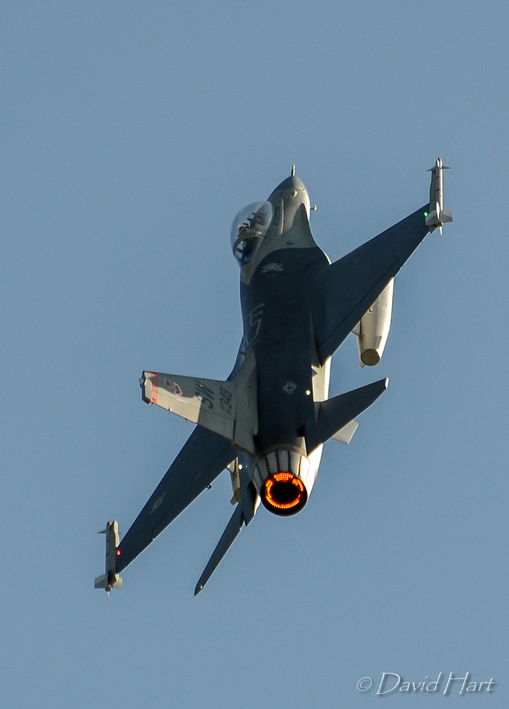

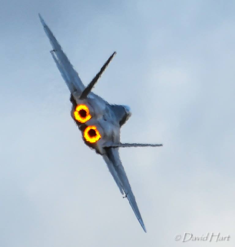

Bob I have never seen lights installed between the inner and outer wall on a pipe. Wouldn't that block the cooling air that is supposed to be flowing through the inner and out wall? On both of my planes I have the lights on the outside of the double wall pipe.
Would look better on the F16 if I could put them between the pipe walls but don't see how it can be done and still work good. Do you have any pics?

You know, you are right - color me embarrassed...
I was sure that I had seen a single row of LEDs like Dreamworks used to sell, installed between the inner and outer pipe, but maybe not. I know that the double ringed ones are too wide to go in there. There's at least a 1/4" between the walls on the Mueller pipe in my Panther and it seems like that could work - if the ring was the right size, but on my other pipes, there's not enough room...
My bad...

David Hart is simply an amazing photographer. Haven't come across any photo's that weren't 'mint'.
Cool models too Gunny
