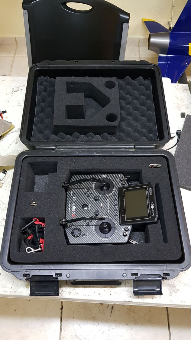

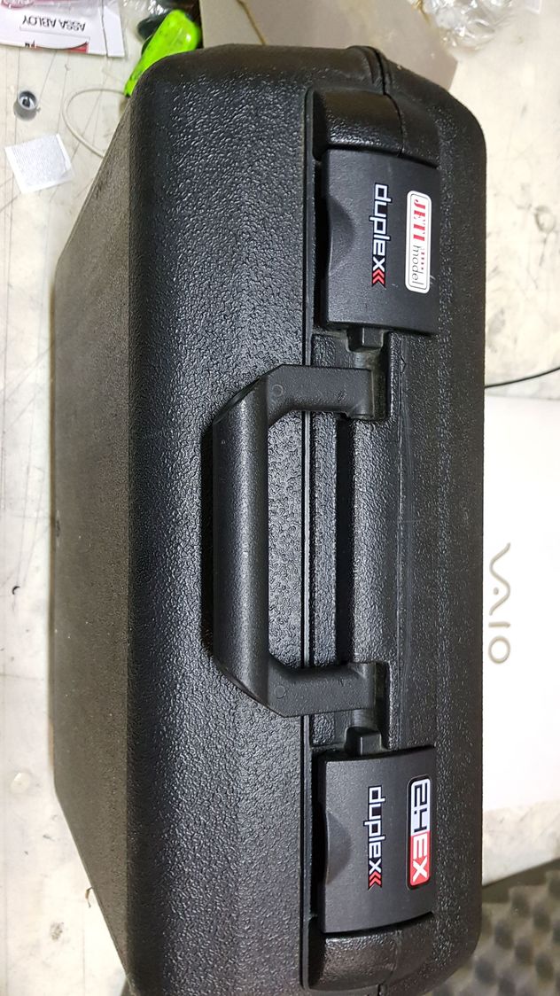

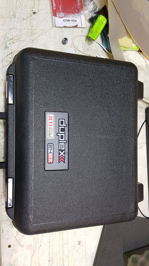

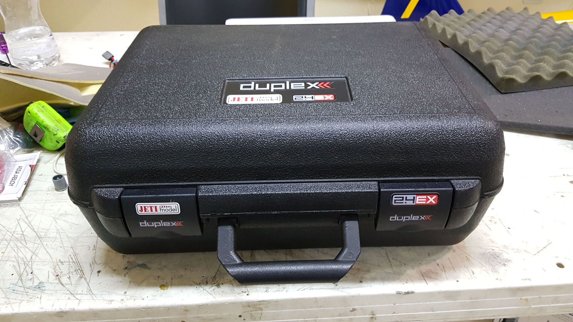

Default My jeti case
Hi this is my new jeti DS-24 case
my new jeti case

Nice case! Where from?
