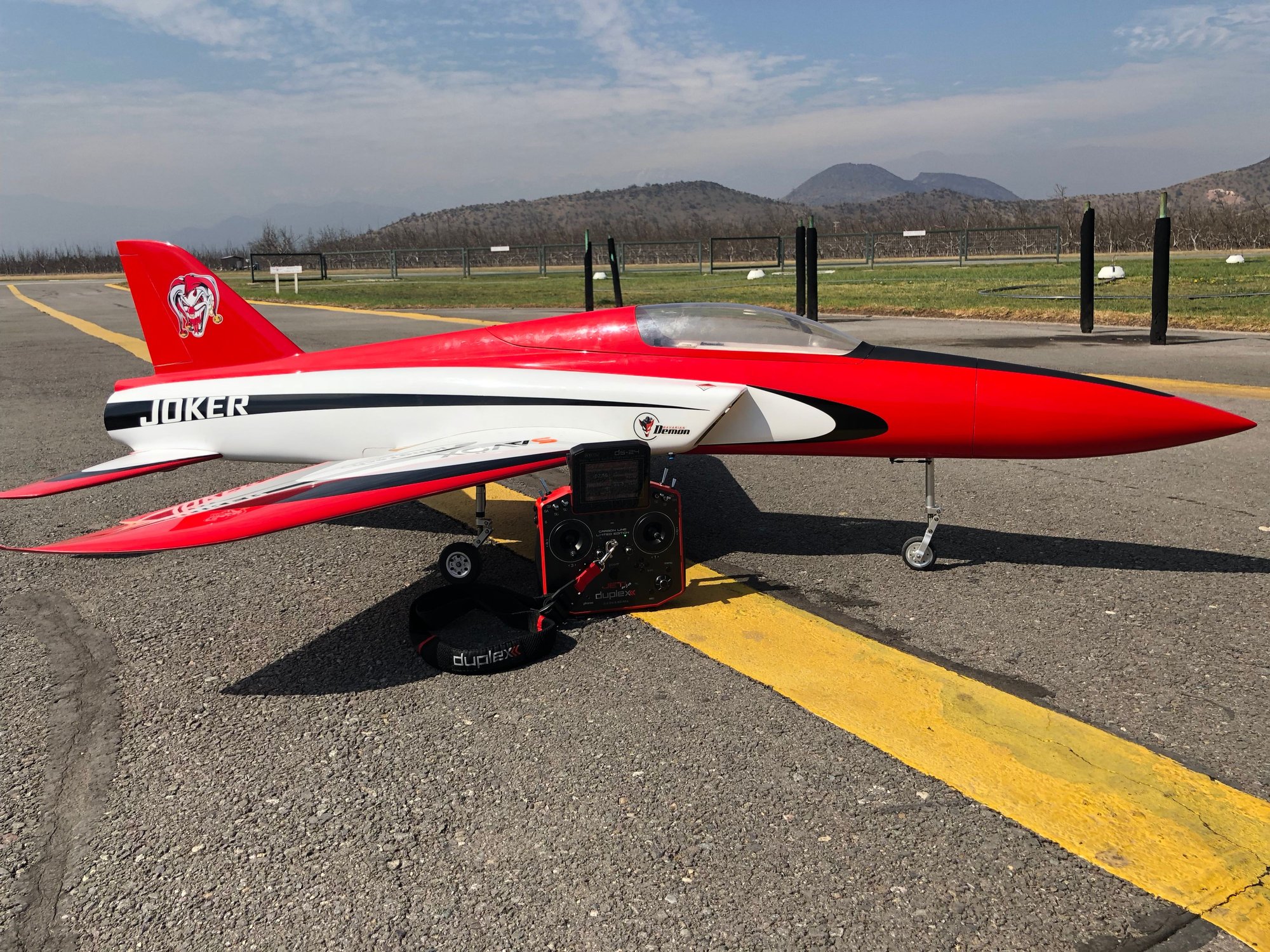

Originally Posted by skymaster68 View Post
Unfortunatelly not in the US...
Can I use the R3 in clone Mode just for the the gear with a battery just for the R3? If so how to bind it...
Problem solved!!
NO BRAKES FOR TODAY there was a strong head wind so no braking was necesay, I maiden my DS24 on my Joker that had an 18Mz before...
the handling of the 24 is supperb, Iím complity happy with it, now time to start migrating my other jets 😁
The red Joker looks cool aside the Custome Red Ds24!!
