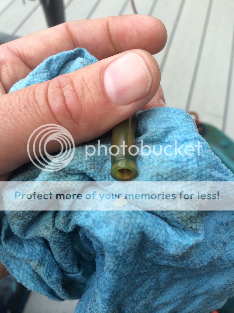

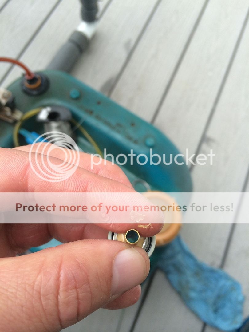

Barry, your pictures seem to show some slime aggregated around the debris as well as on the filter membrane.
It is not so easy to say from these pictures. It would require touching it ( it would feel like a jelly substance ).
However slime will certainly produce the described effect. The accumulated substance will clog the air trap after a while. Changing the unit will immediately restore original fuel system conditions, but only for a certain amount of time as the fuel system would remain contaminated and slime would accumulated again after a while no matter what type of air trap you use.
In this specific case, the best long term cure is to kill slime ( which is a type of algae that lives in kerosen and diesel ) with the proper additive. This is also explained in my blog.

Oli, there's no indication of slime or bio growth, and as stated in my earlier post, my fuel pressure gauge indicated low numbers when pumping fuel through the direction of fuel flow to simulate engine run, so low that it was even lower than a brand new KT UAT in comparison, probably due to the size of fittings as well as the single filter rather than the dual.
Barry

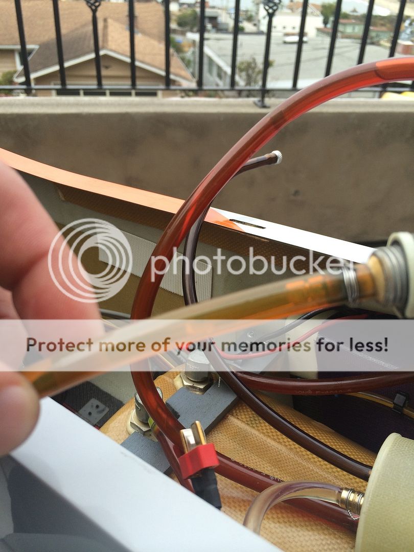

And I'd go even farther to say, that if you have a flame out, it likely points out to a "new" problem in your fuel system.
I have 3 CATS all getting worked and non babied. I had some debris in 5 year old tanks that were clogging up my PICK UP line IN MY TANK!! And it was very intermittant. I was lucky I found the debris. I could not find it before.
And by the look of the debris, it was from building/configuring the stopper/vent lines when it was being built. I was unable to pick up this debris even with vigorous flushing.
I have been very happy with my CAT's. The O-rings that come with them have been replaced with rubber bands. I don't even think about that any more.
So, is it possible the debris seen in the CAT came from the tanks?
Oh, and it's kinda funny that Barry's pic clearly show the filters in the CAT's being "Made in China" when Marc gets them from the US. Go figure.
Anyways, here is some debris that was causing my flameouts.
