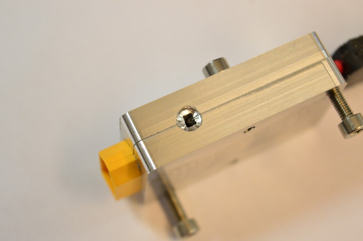

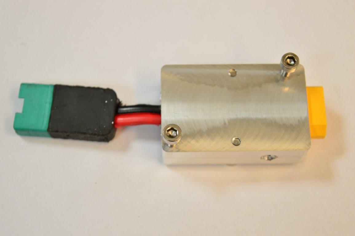

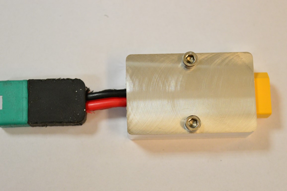

Hi
maybe something interesting for you guys.
always having to solder your connectors and having them look bad or poor isolated?

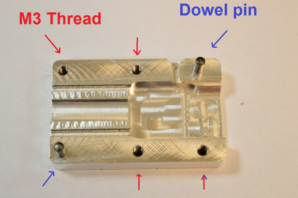

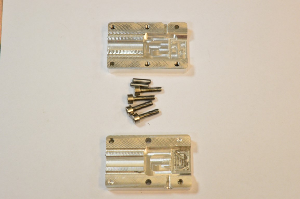

with these mouldings and a Glue gun you can make your own Isolation around Multiplex , XT60 XT90 male of female.
you just take your soldered cable AND CONNECTOR put it inside the moulding , add Hot Glue and done!
The Mould opens by fastening 2 screws that will force open the mould , no no screwdrivers or hard pulling is needed.
we have special Black cartridges that are a bit harder then the standard Transparent stuff.
For each Connector type you need a Moulding.
you need also a good Glue Gun with Good warmup time and some volume (12mm Cartridges)

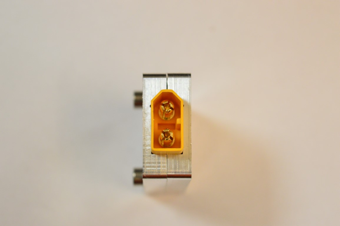

we have
MPX does both male and female (normal 3mm Leads)
MPX-JC (Jetcat batterys) has a Larger cable channel for the A123 (4mmx8mm)
XT60 does Both male and female.
XT90 does both male and female
XT90 XL Does bopth male and female and has a extra wide cable channel (12x4mm)
all is made in house on our own Mill , Alluminium 7075/ Pins and screws are Stainless steel.
milled to perfection ...

Looks good . can you encapsulate battery connectors without shorting the leads?
Old 02-13-2016, 12:46 AM
digitech
My Feedback: (10)
digitech's Avatar
Join Date: Aug 2004
Location: klimmenlimburg, NETHERLANDS
Posts: 3,653
Received 10 Likes on 10 Posts
yes we made space enough However still make sure your solderings are good and wont stick out more then the connector :-)
