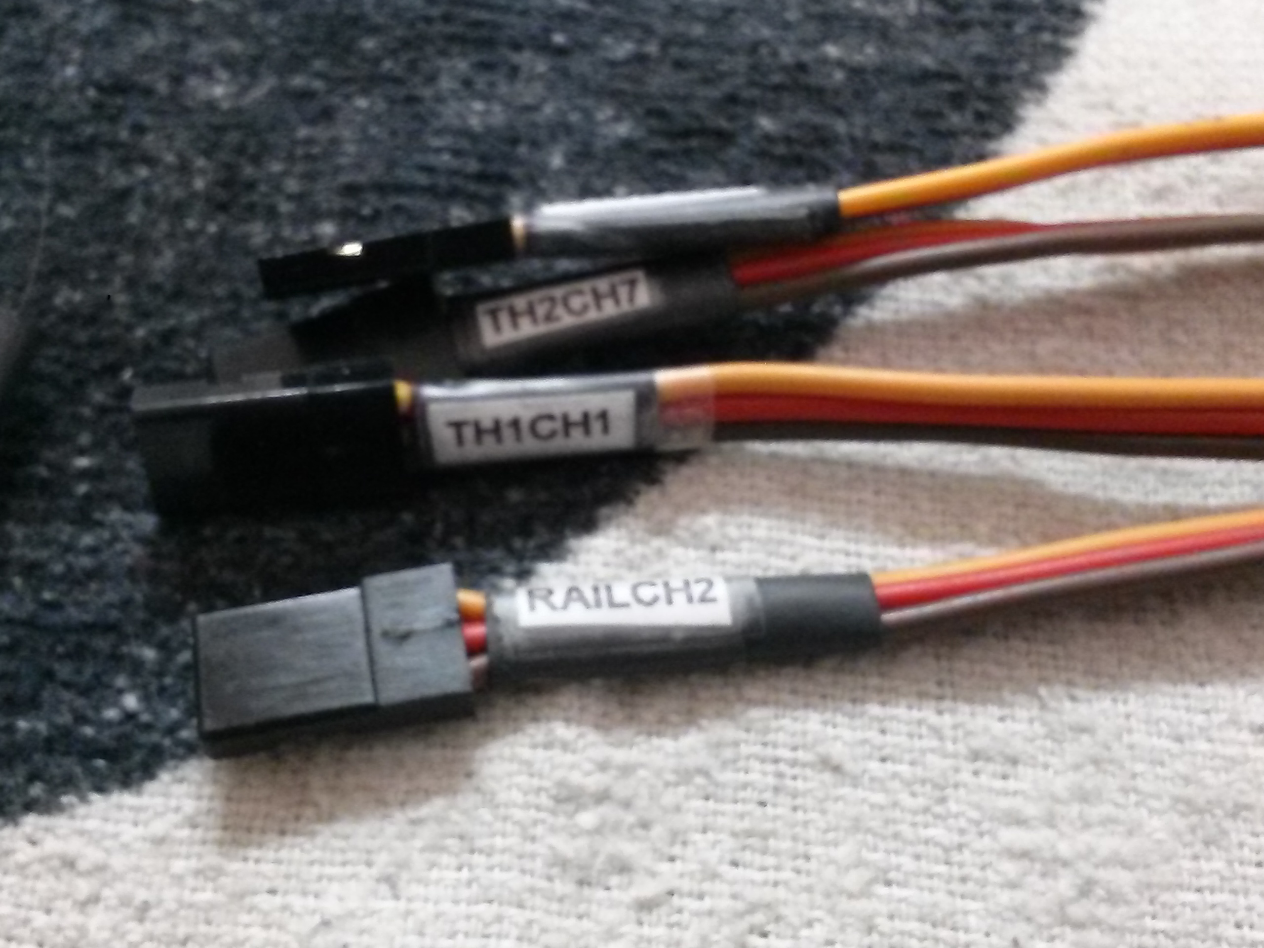

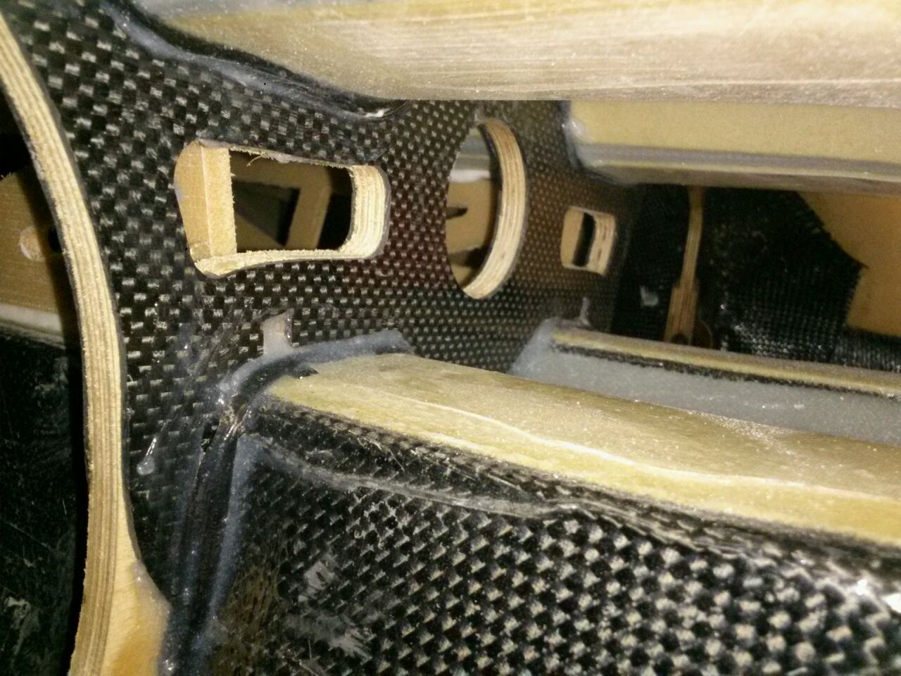

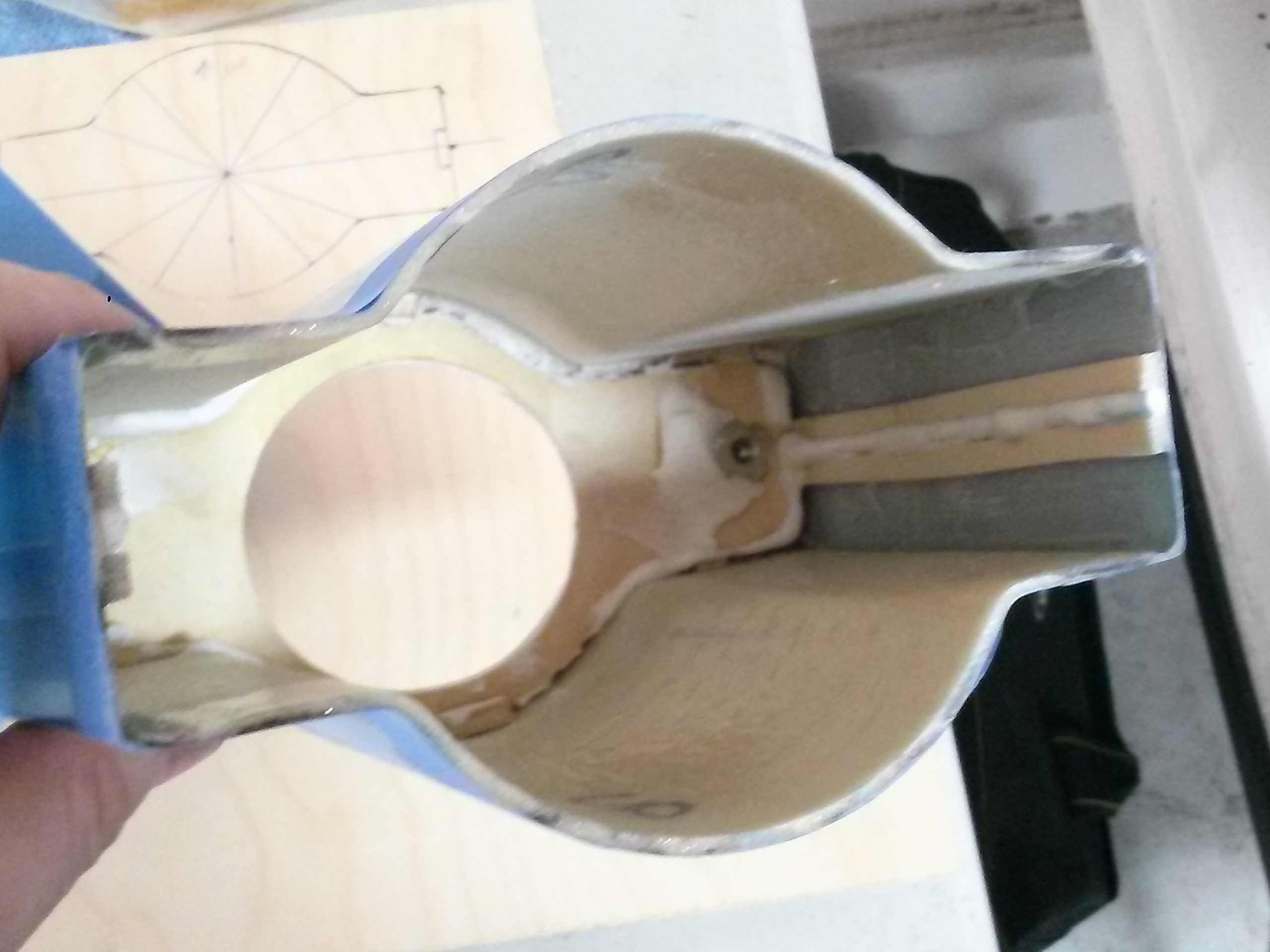

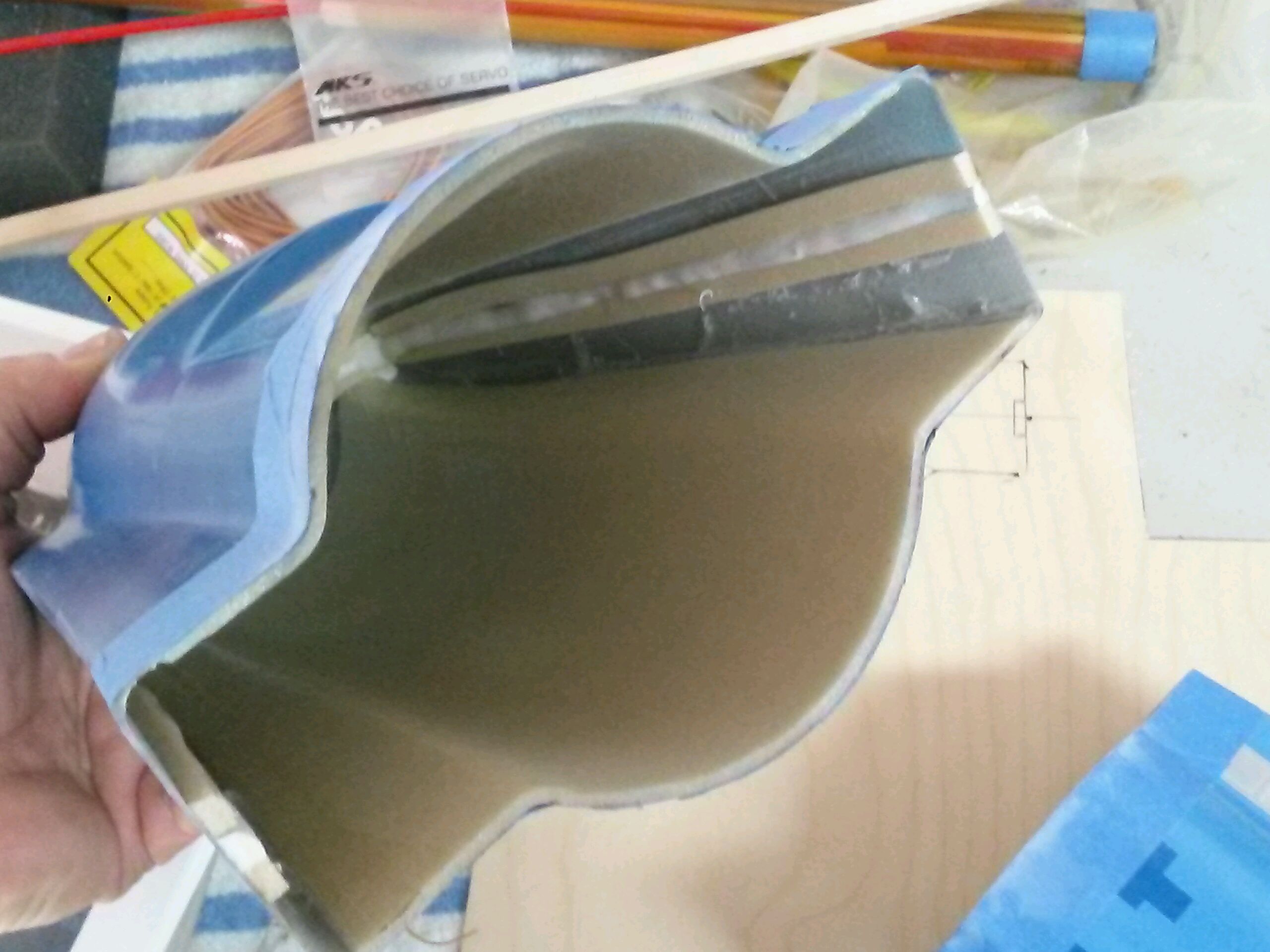

Making and labeling the servo wires. Reinforcing the tail cone by making former's ,so that I can place a carbon telescoping tube inside the plane. Like wing spar. Slowly but surely....

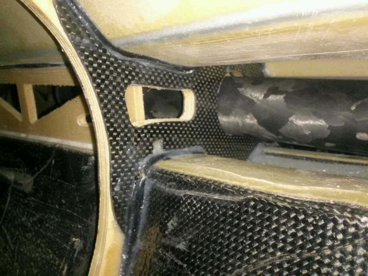

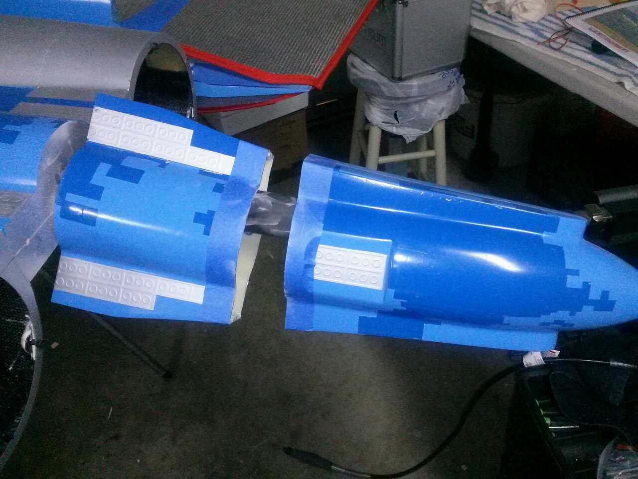

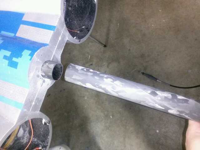

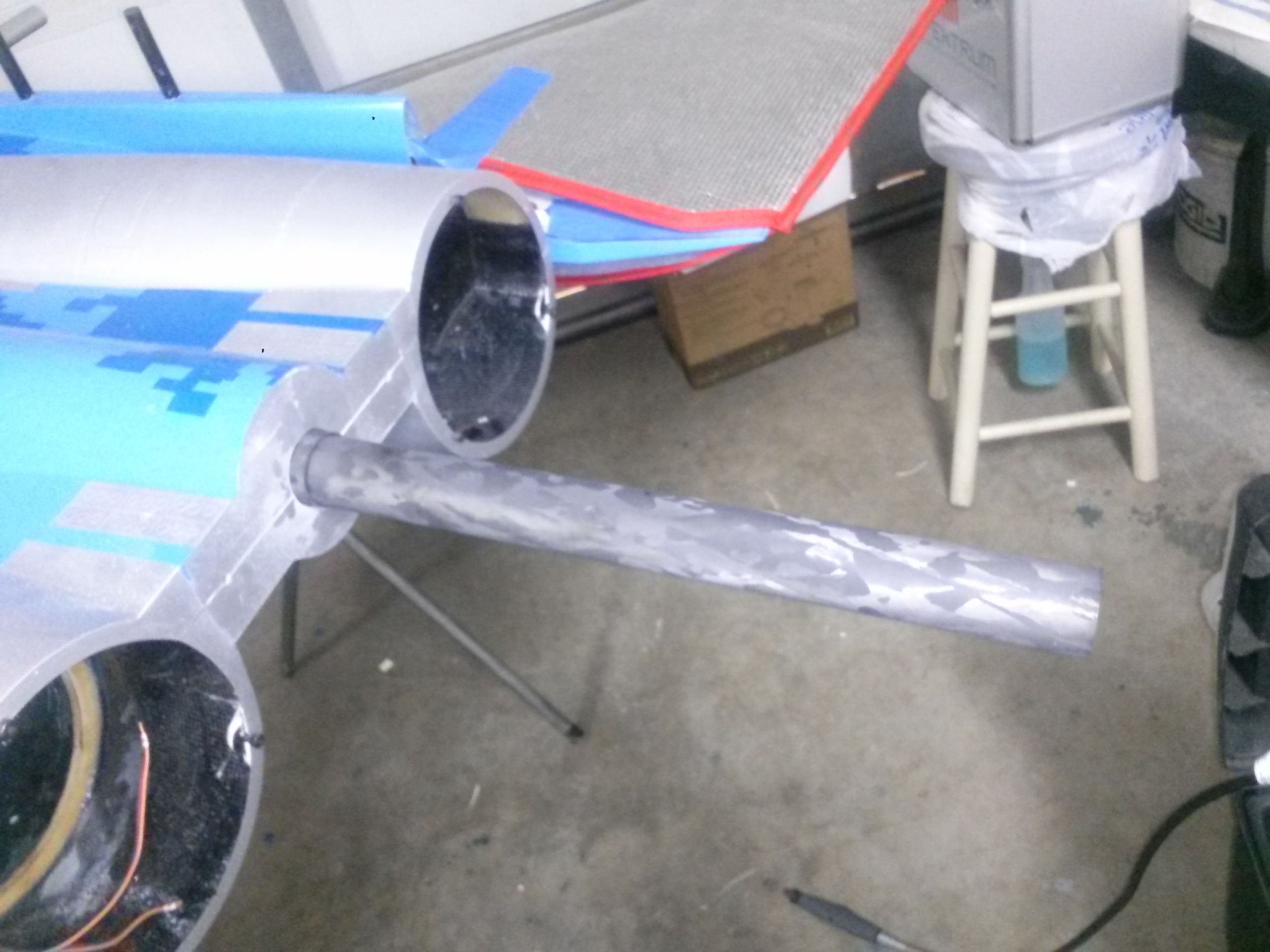

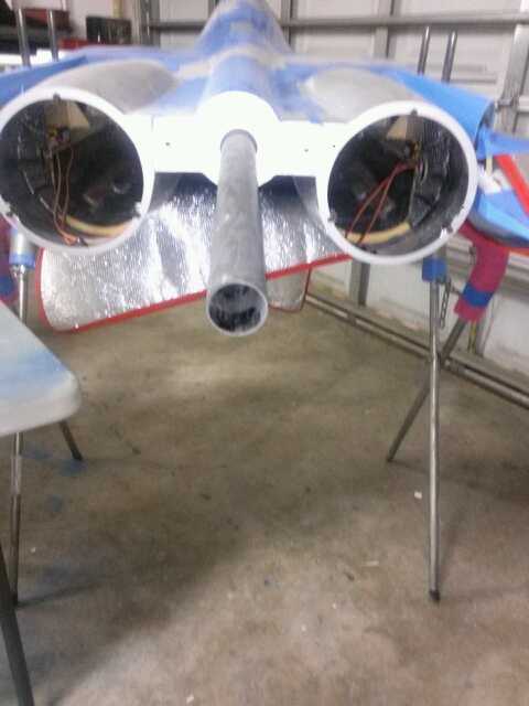

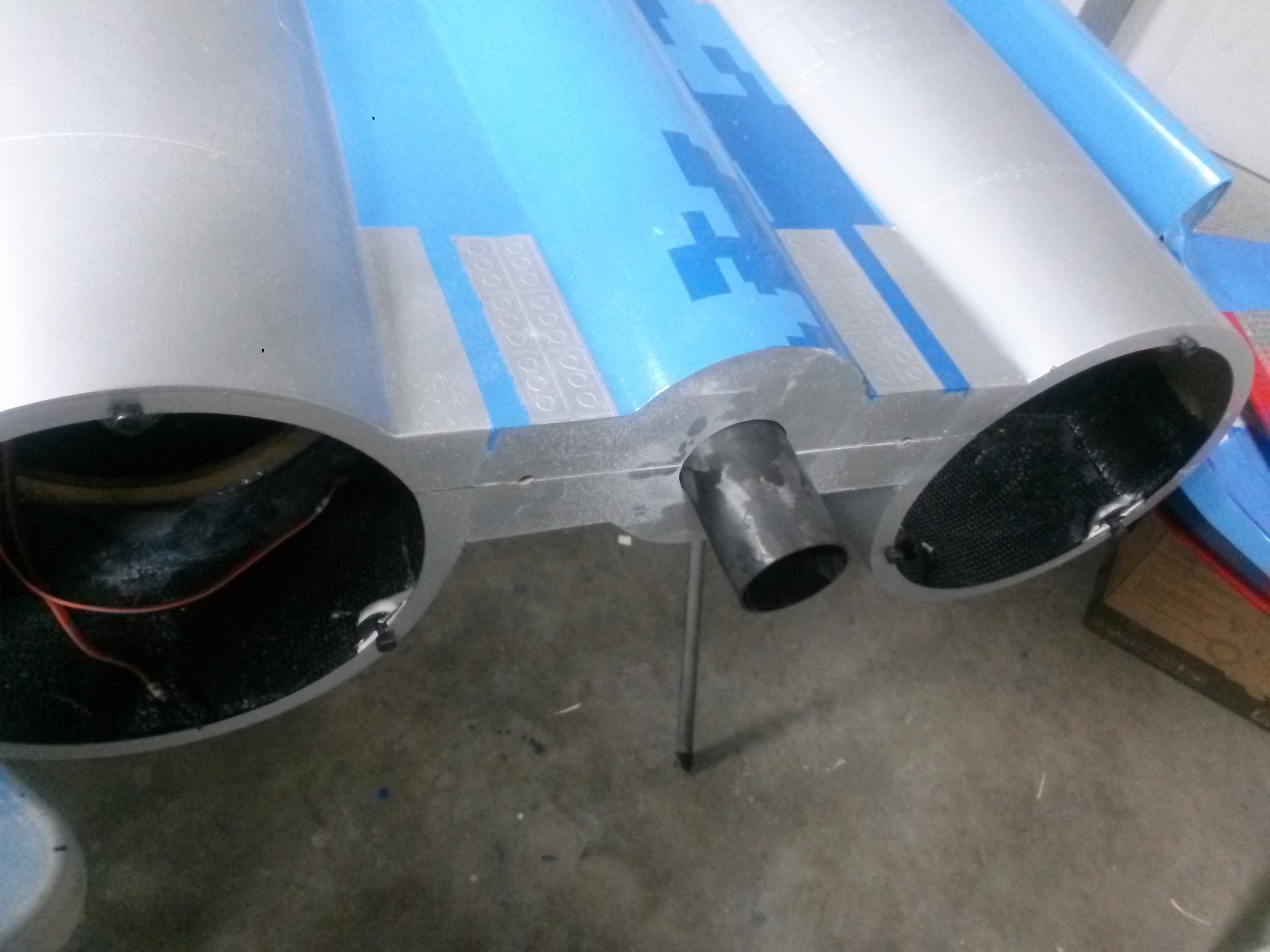

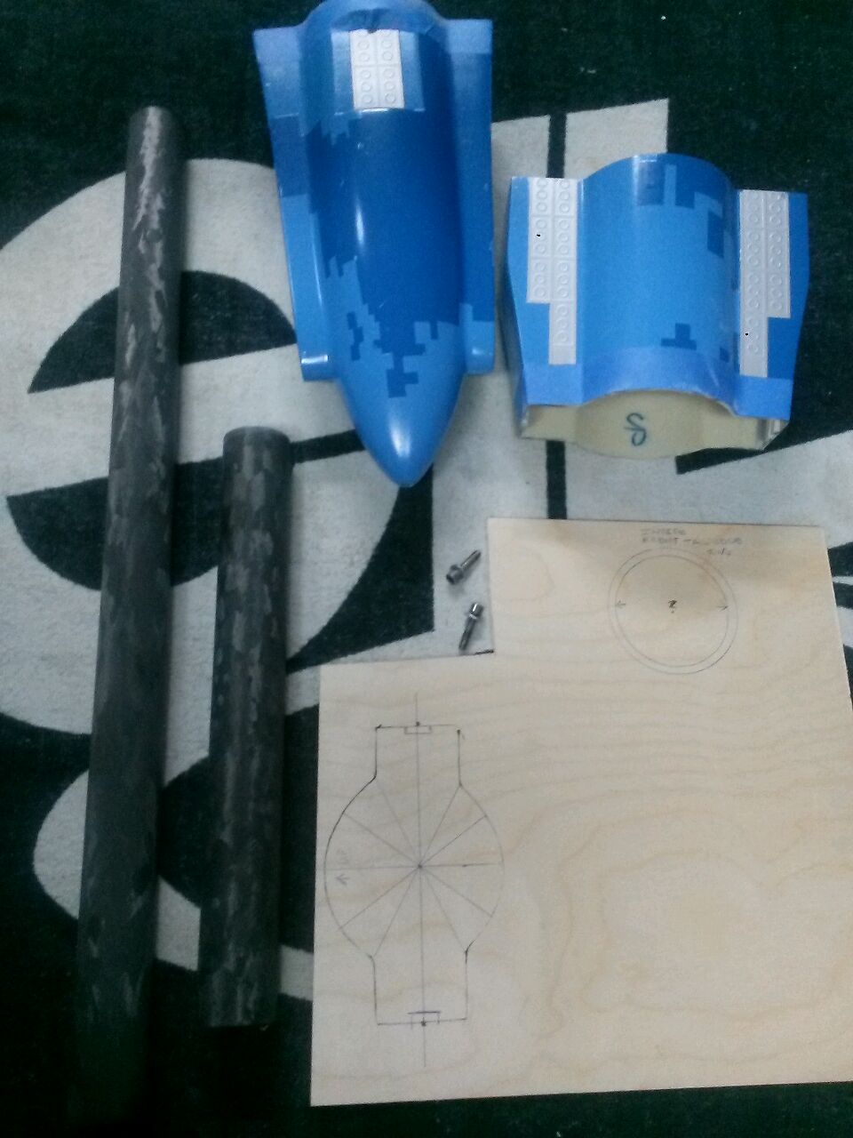

Gentleman, my carbon tubes arrived!! YEAAAAA.....It serves two purposes, my drogue chute and for transportation purposes. In case someone lifts it from the tail cone...
You all know what the last pictures of,,,,
You guys haven't responded to my slat questions.....on post #103......lol

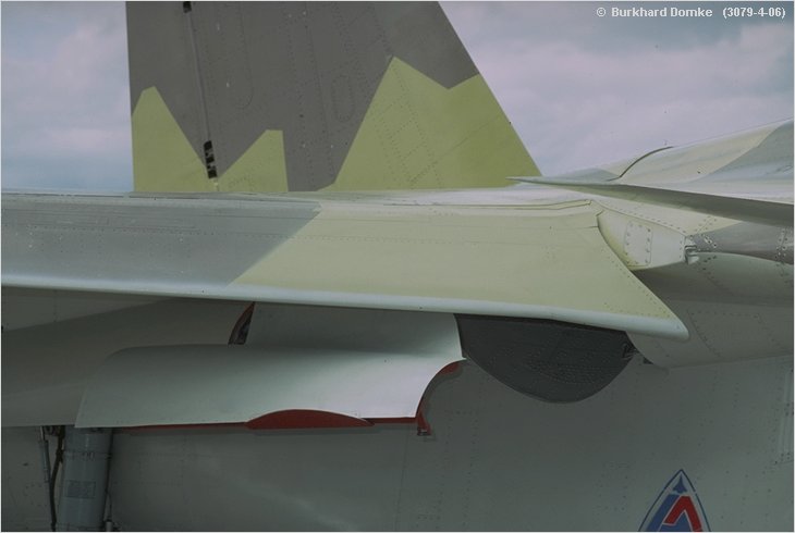

just my opinion.....I wouldn't set up your LEF / LES with elevator, as you said the real one is computer controlled and their deployment without some type of asymmetry protection ( like the real one has ) could get ugly in a hurry.
Just set them up with flap deployment. A Set movement with flap position. A little bit at half, a little bit more at full flap. Then tweak to taste with flight experience.
Also i think the SU 27 has leading edge Flaps not leading edge slats. A slat would extend away from the wing like an F100 or A4, however I could be mistaken.
A leading edge flap is simply hinged at the top of the wing. But doesn't separate from the wing. Keep up the great work, totally green with envy and looking forward to seeing it in person.

Your correct buddy , it's leading edge flap....I was just testing you guys.....i knew that....NOT....
I have it currently set up just with flaps....i'll take it slow and try them on for size, little bit at a time. Still far from the first flight...Hopefully i'll be close by the time u swing by...

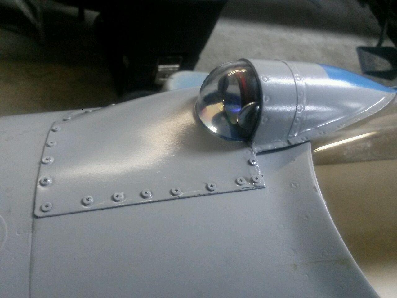

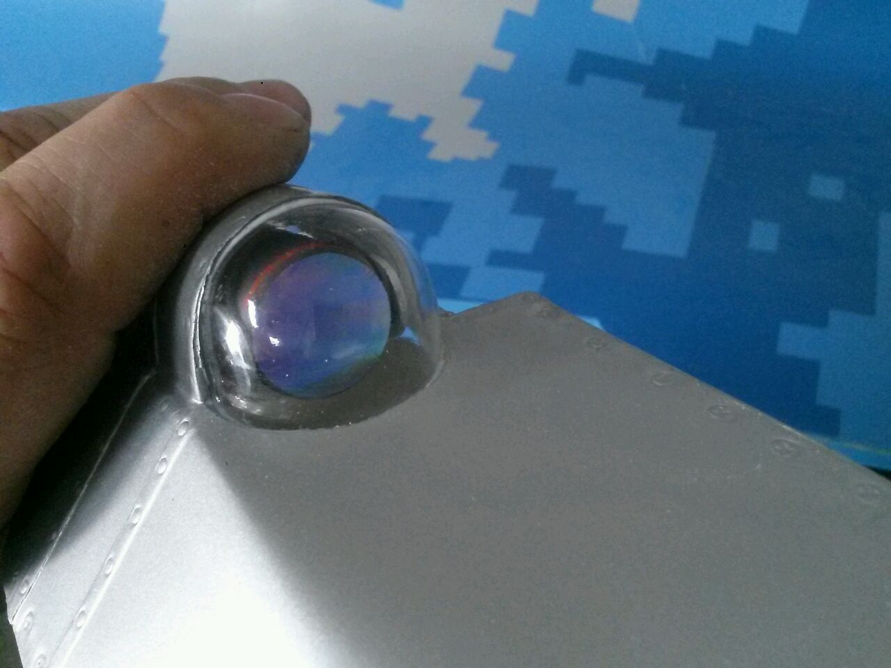

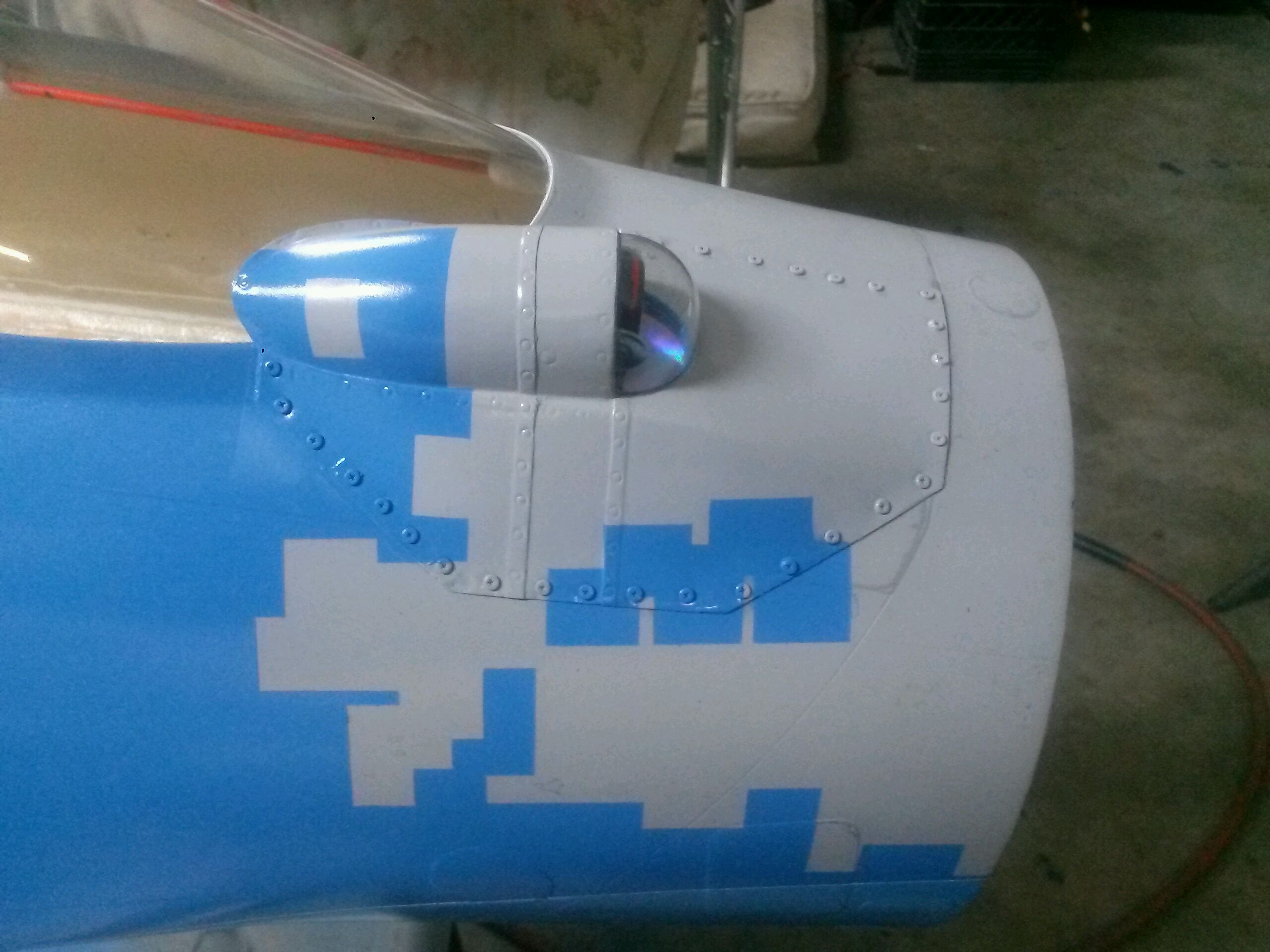

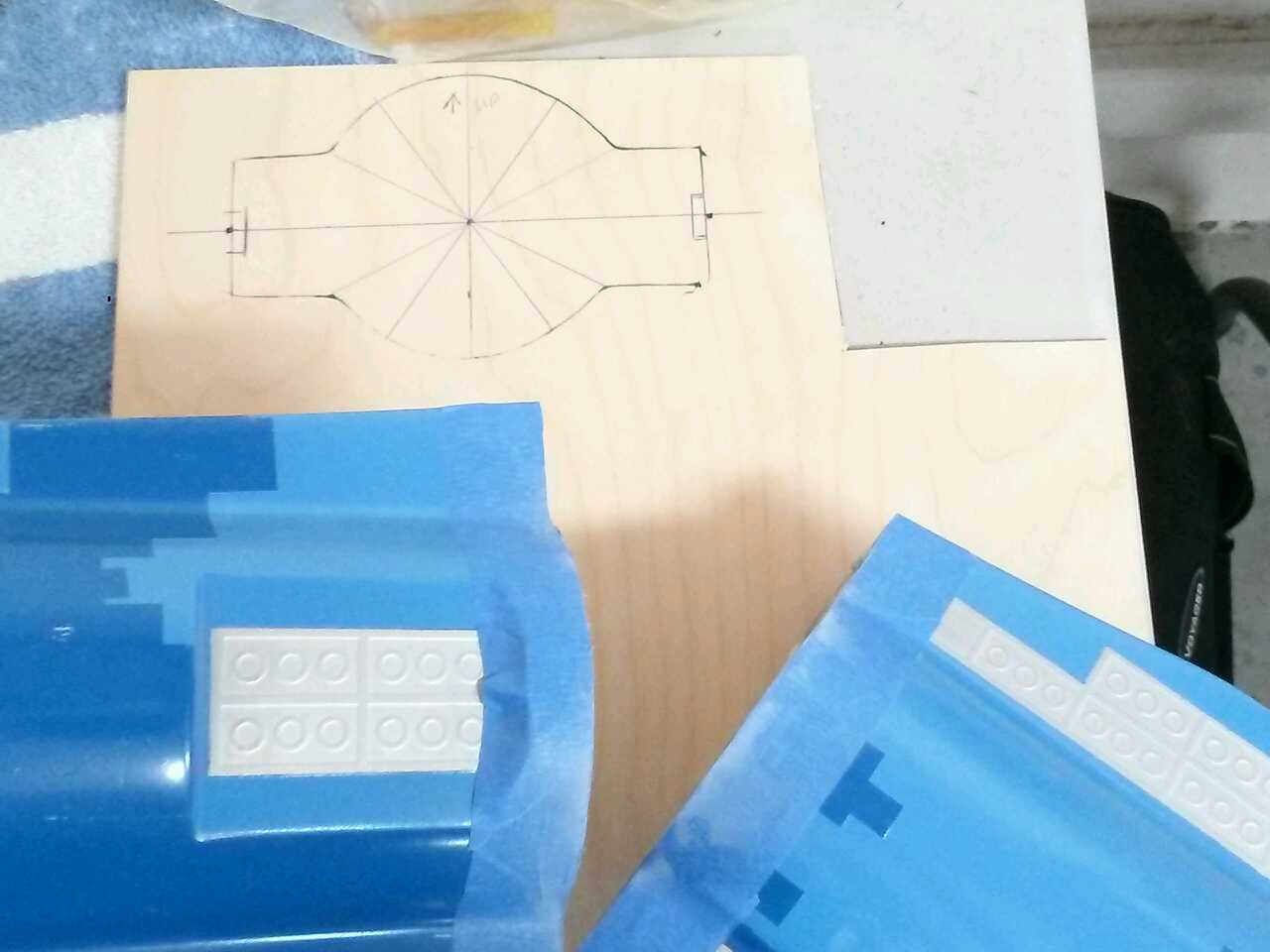

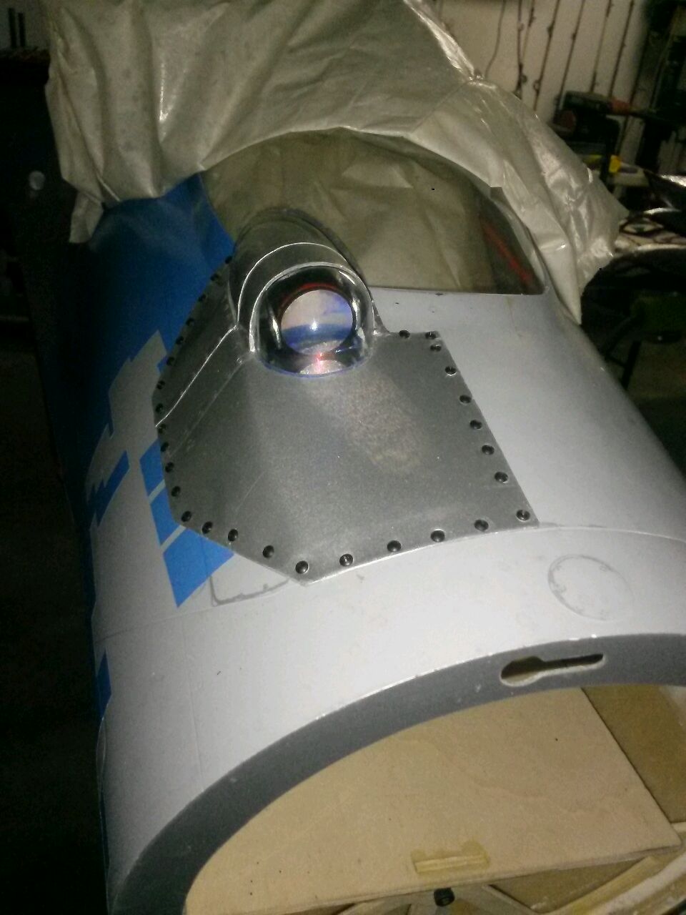

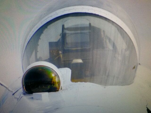

Happy Thanksgiving to all.....Since i'm still working on paint and waiting for things to dry, thought I share the (IRST) system on the SU-30.
Did it out of a compact disc, I'll probably do the same for the H.U.D., It's awesome how the light gets refracted..
Any way take care guys and lets see some more pic's from other SU-27/30 pilots...Feeling like i'm hogging up the thread....

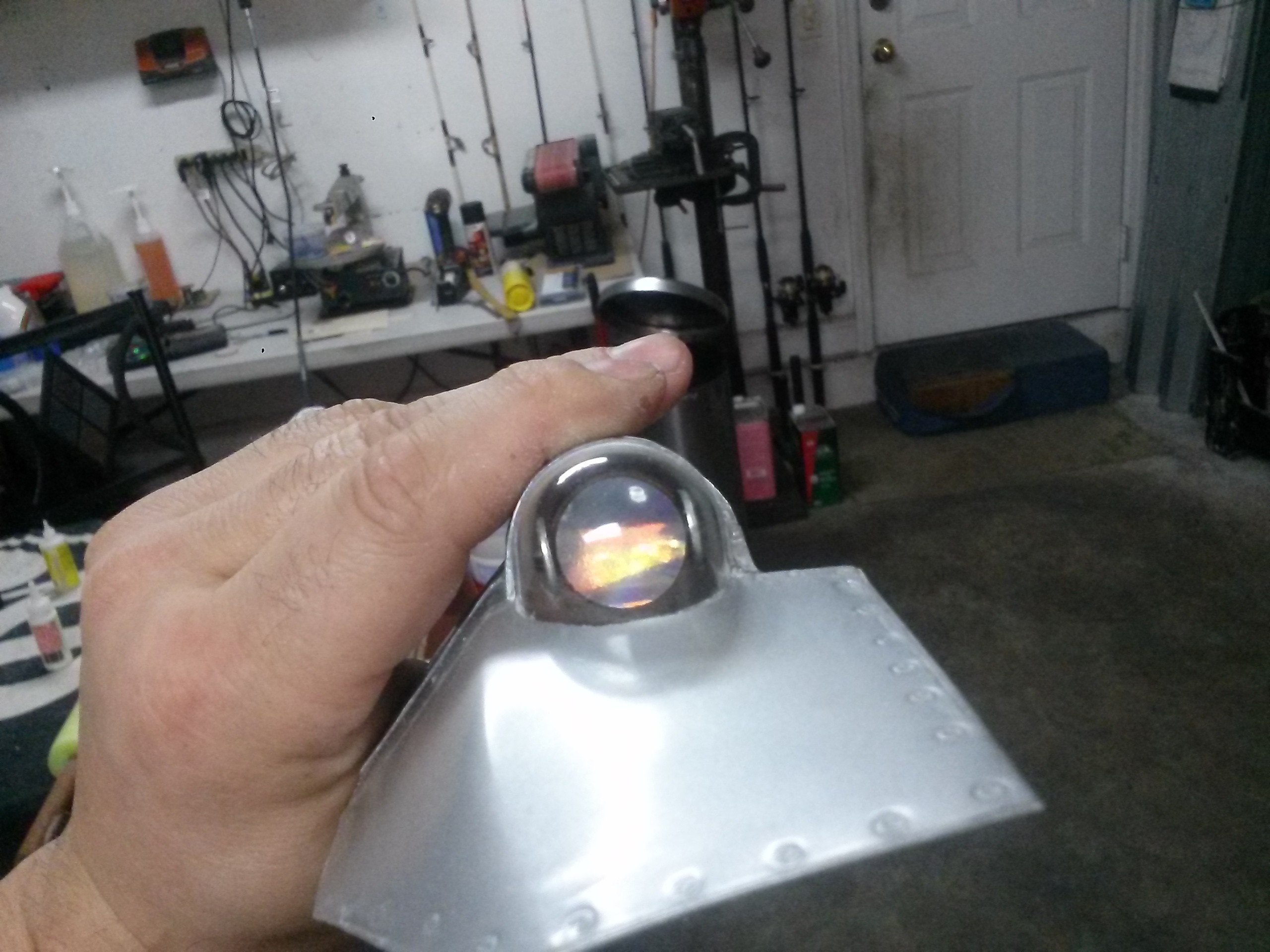

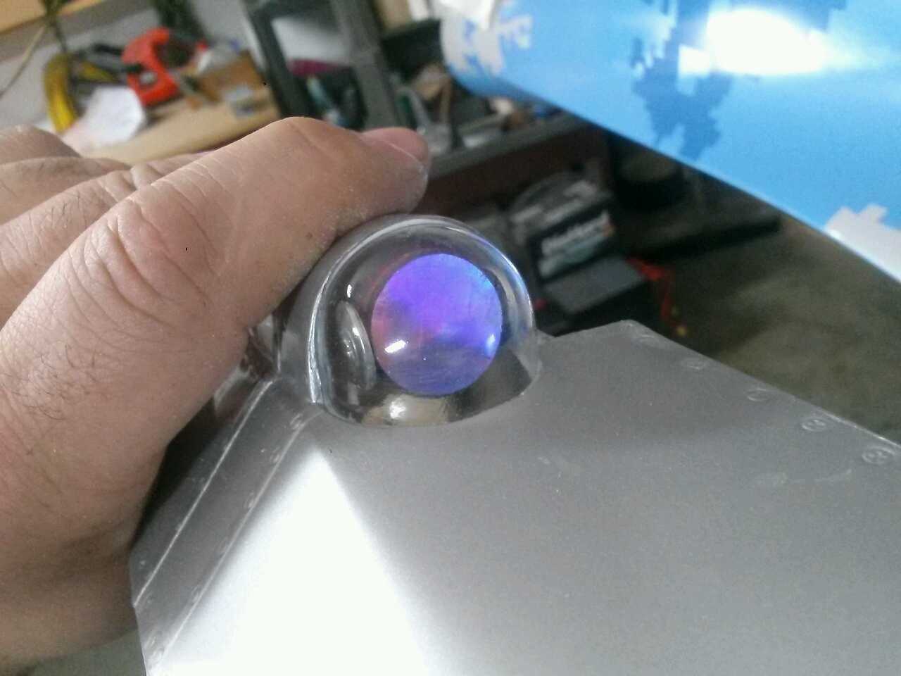

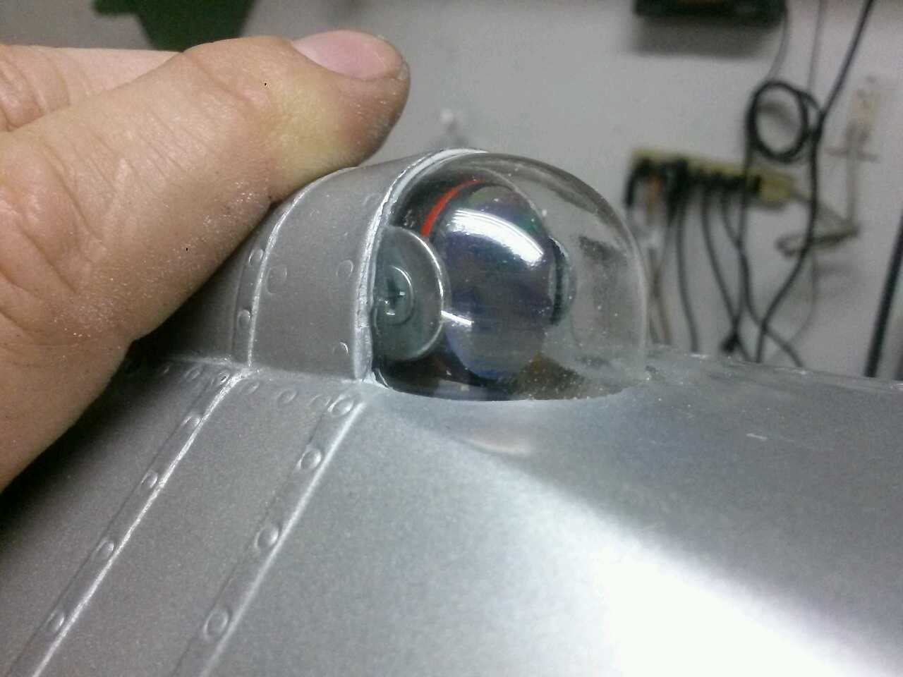

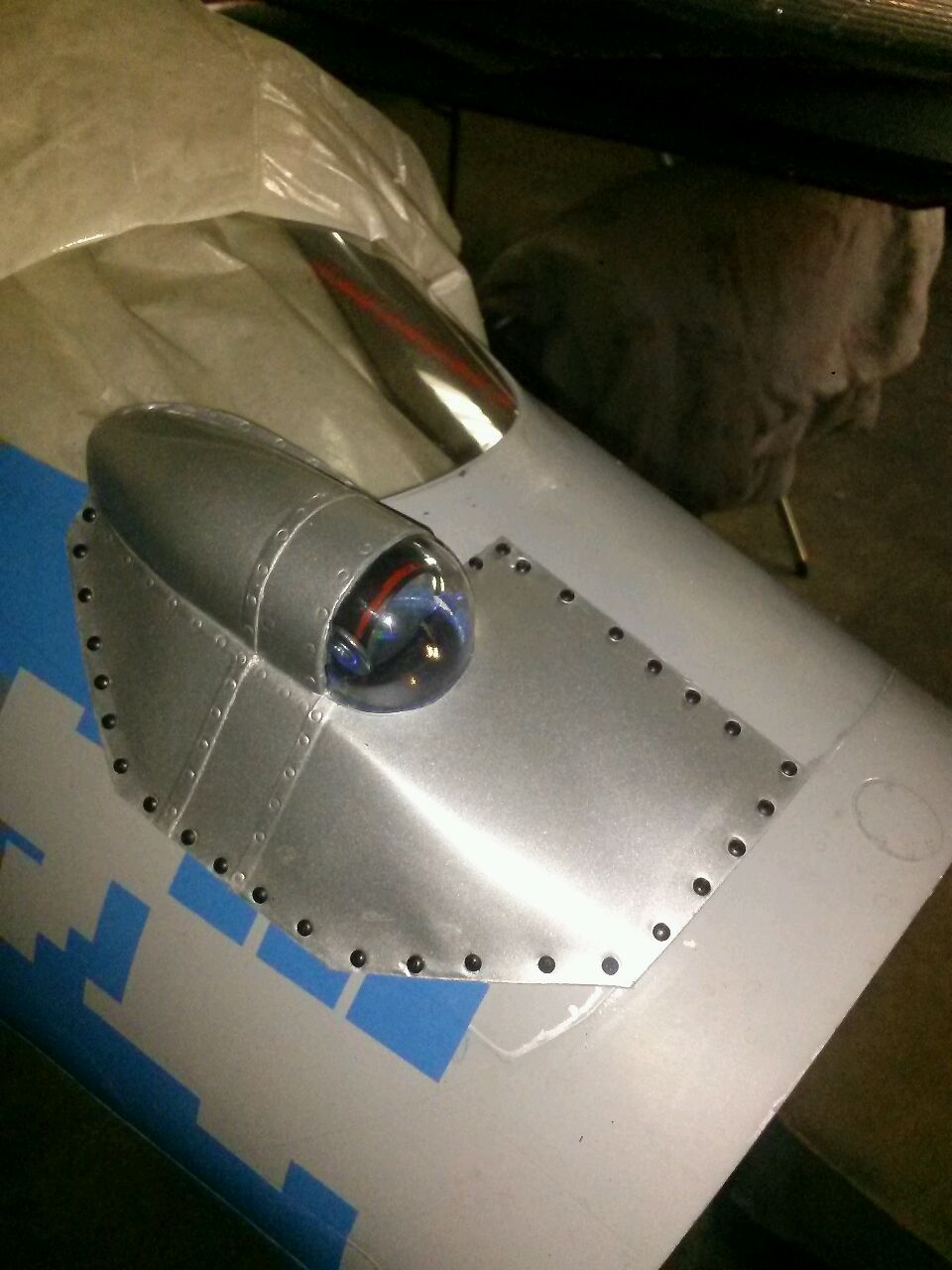

Little paint and done with the (IRST).....

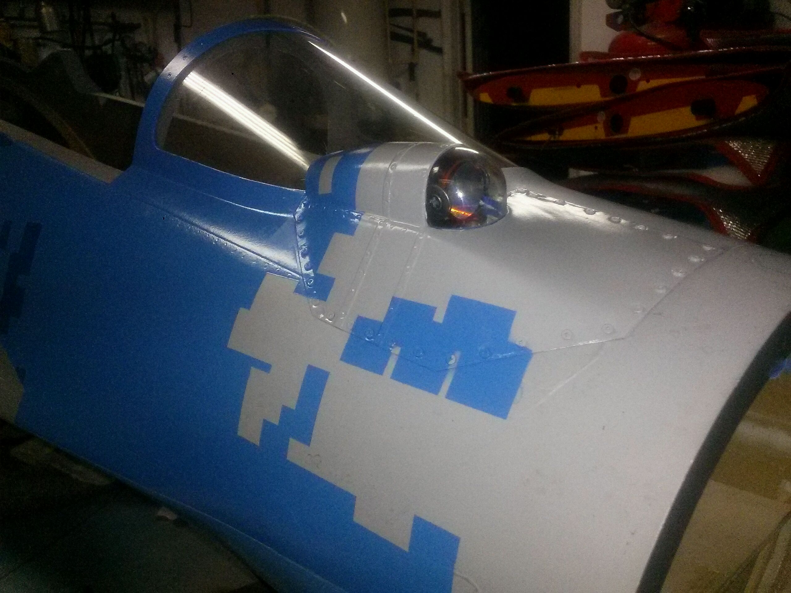

Well done for the day......painted (IRST)......

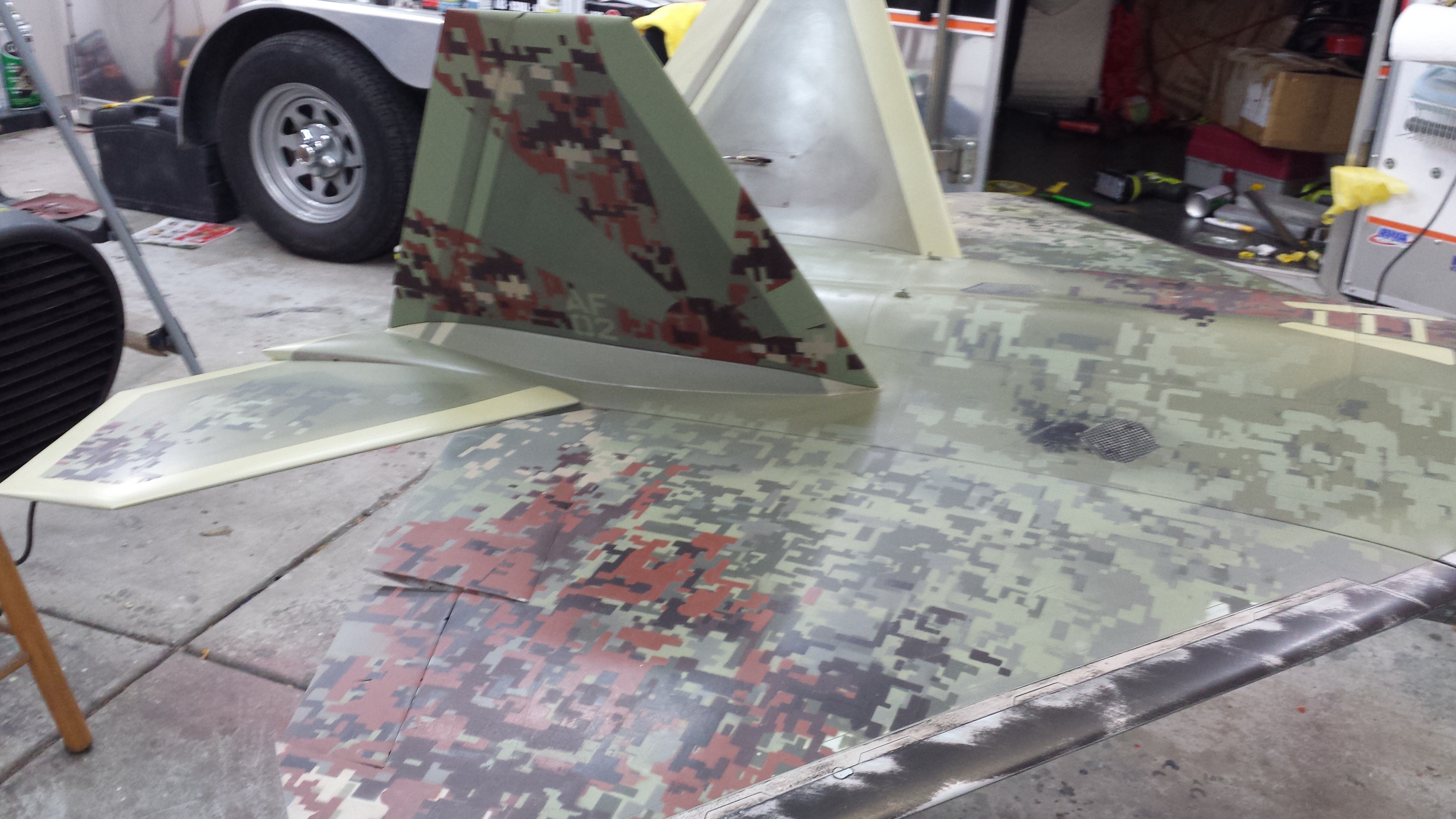

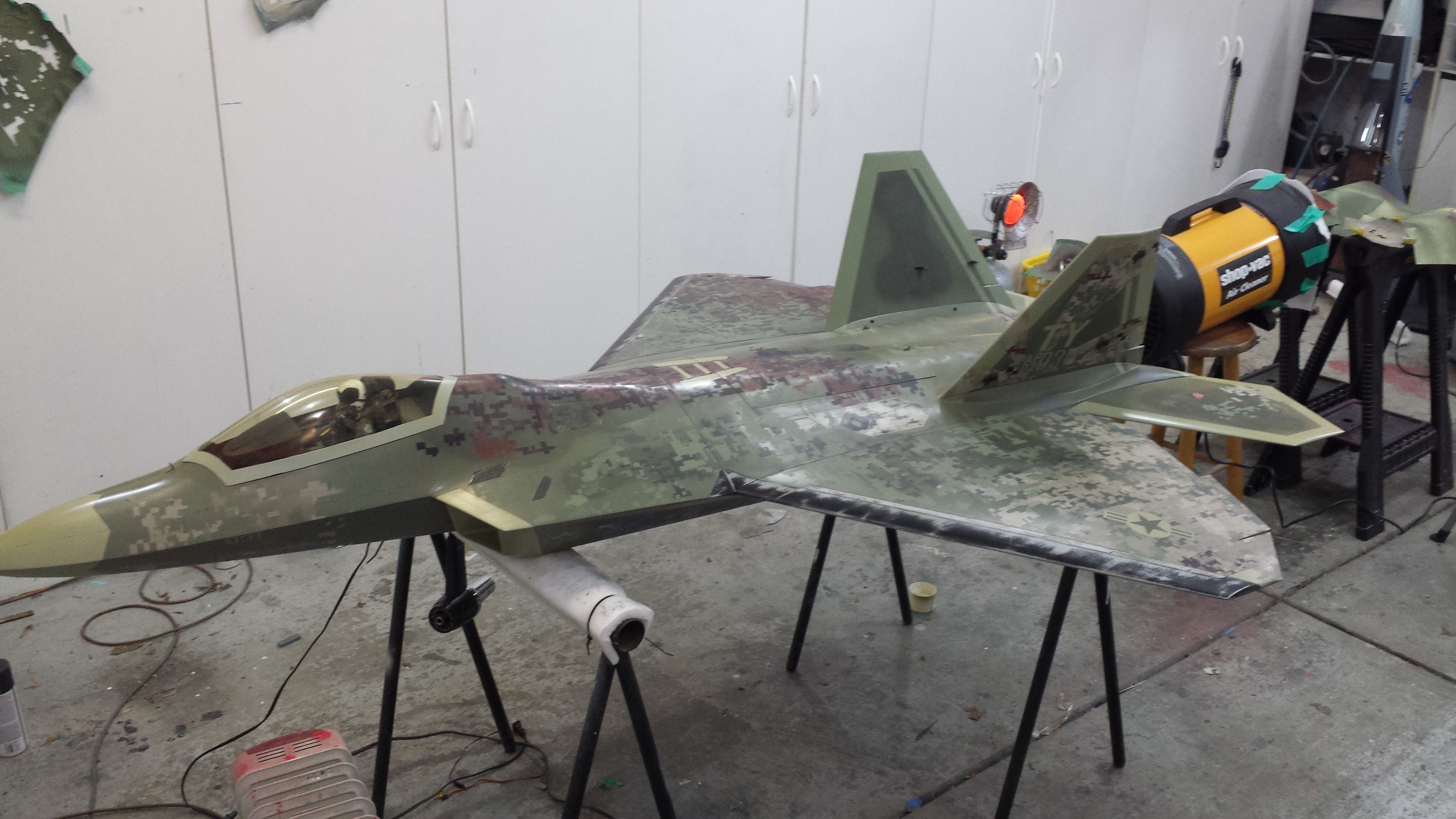

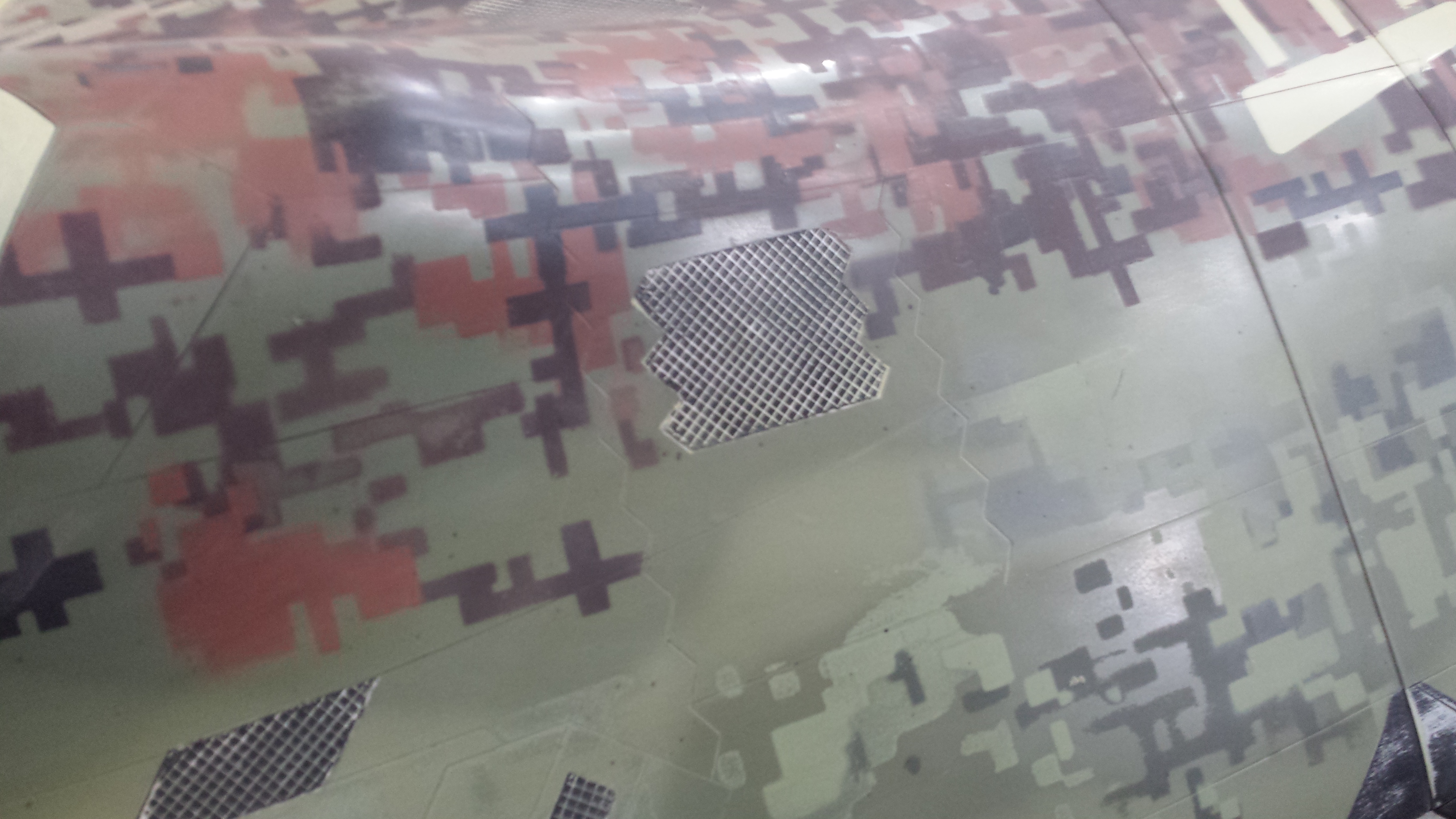

Extremely well done the su going to be the best looking out there. This is what I'm doing with my f22 .

Unique For a Raptor, Looks like you had fun taping as did I.....here are a couple that i saw that i thought were awesome...hope to see the finish project

It's almost finished just rudders and some clear cote ,maybe one day we will fly them together maybe Kentucky jets?

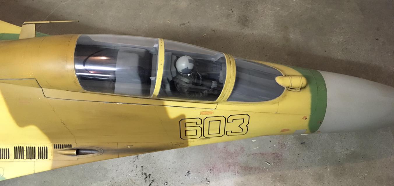

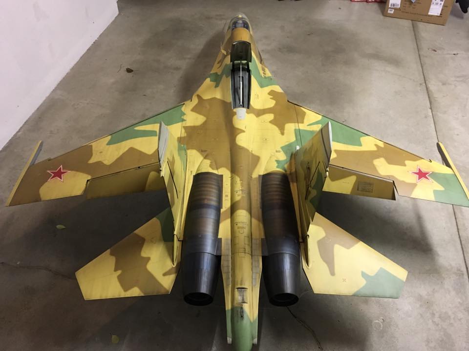

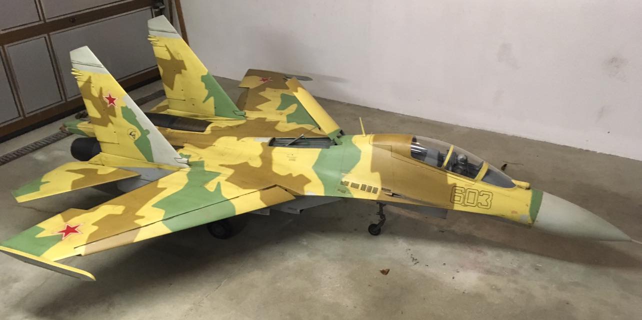

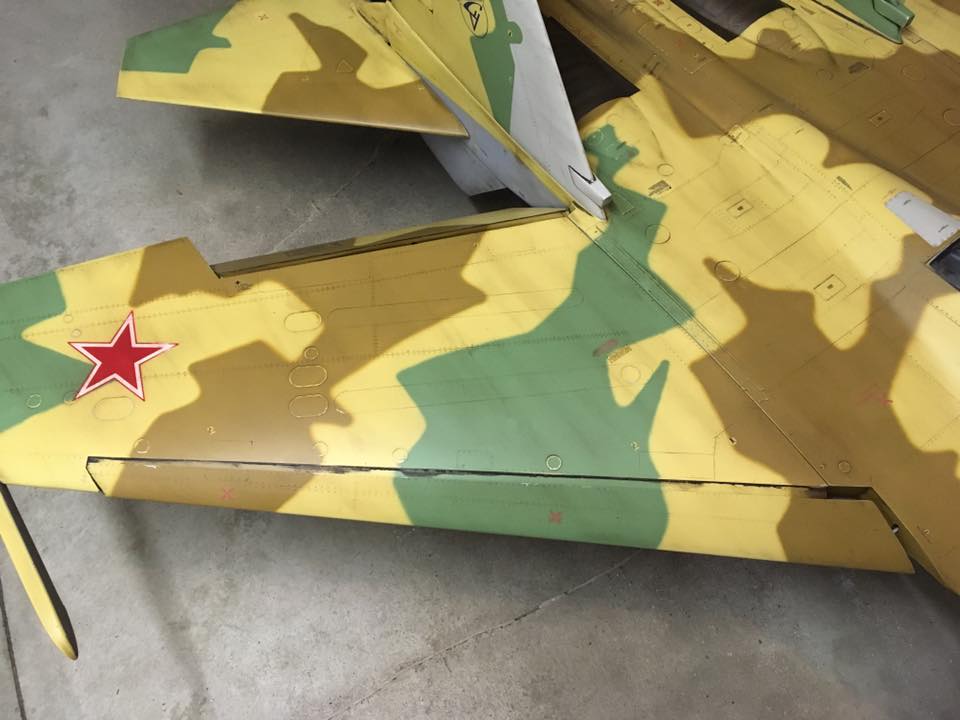

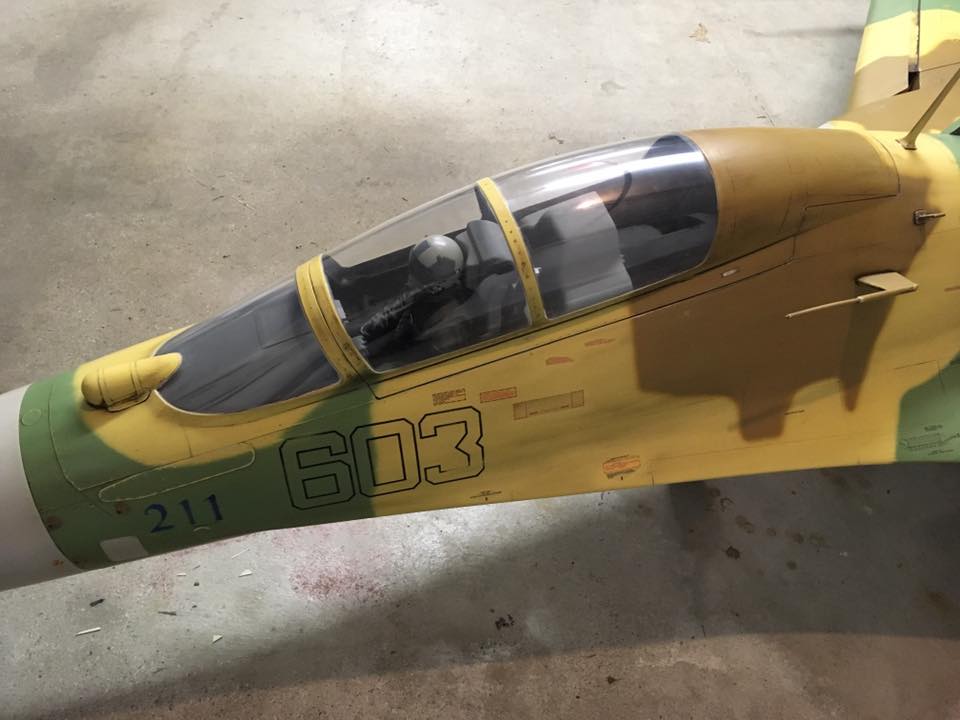

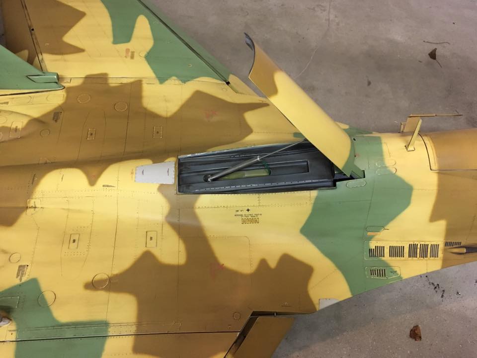

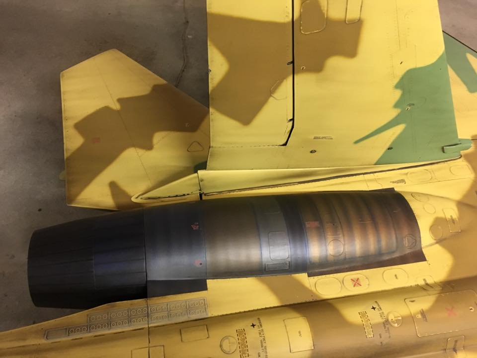

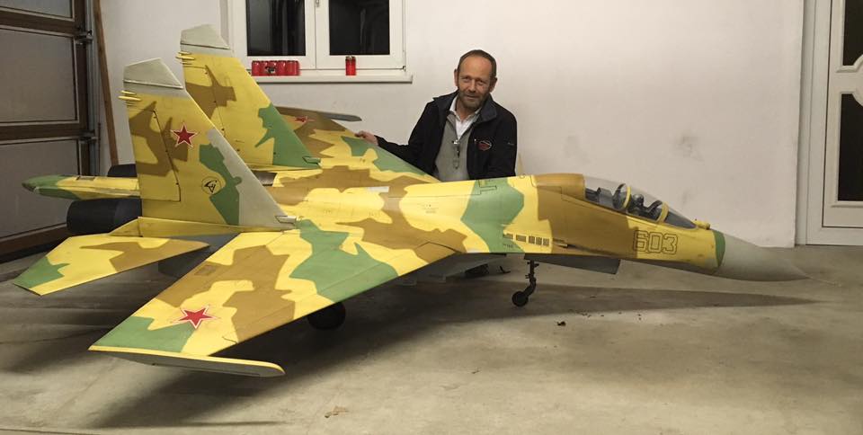

I found these pictures of CARF-Models on facebook, The fella lives in Austria, Modellbau Kager is his web page, I guess he built the jet for some one. The guy did a great job on the paint and weathering. This SU-27 is GORGEOUS....
If you notice he didn't place the 2nd seat in the cockpit...Would love to see a vid....

The engine detailing is fantastic!

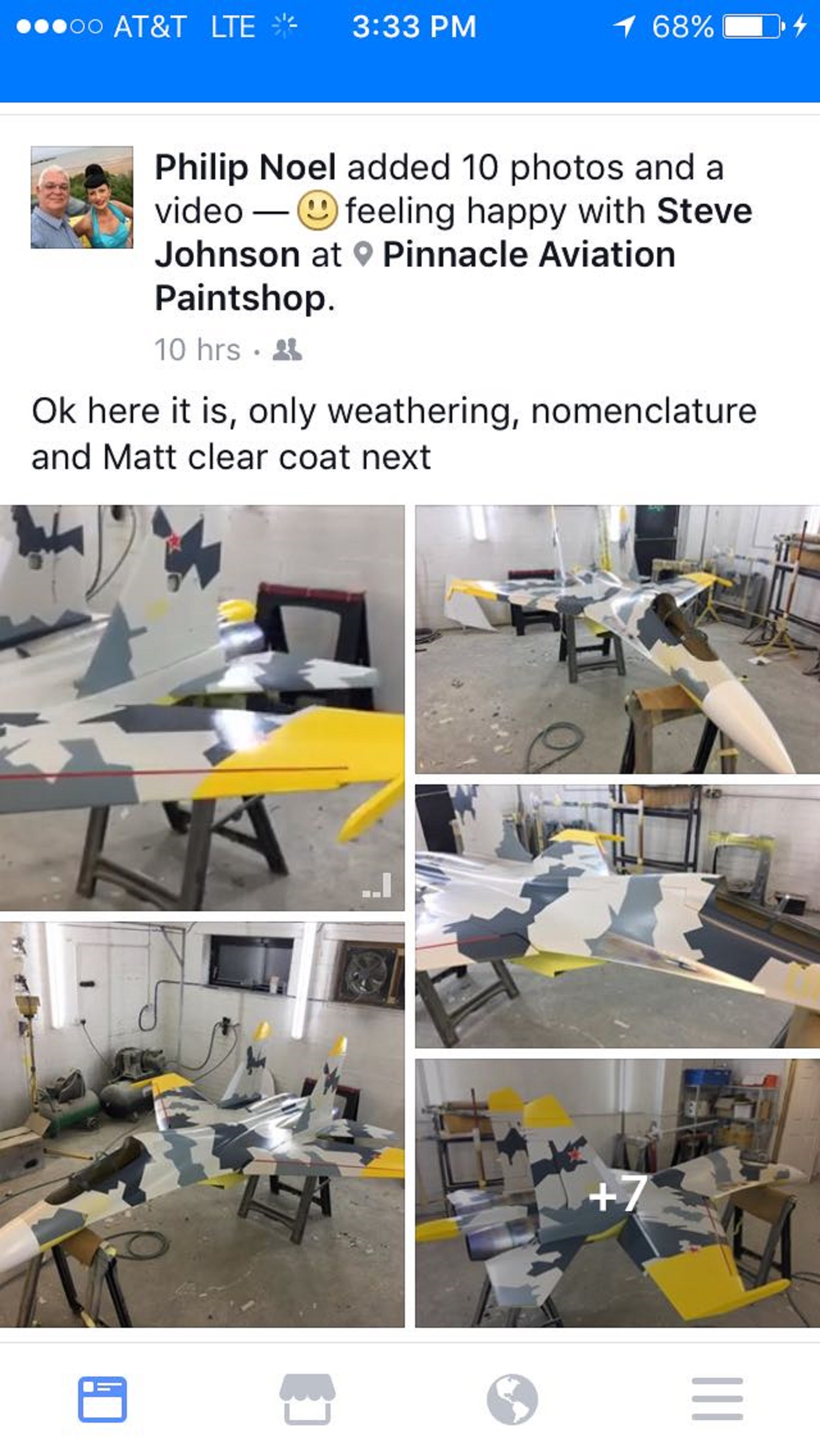

I agree, it's awesome...i cant wait to do mine, hopefully it comes out as good, never painted metallic's before....but he got the colors right....it's usually dark engines bays with a hint of burnt iron...

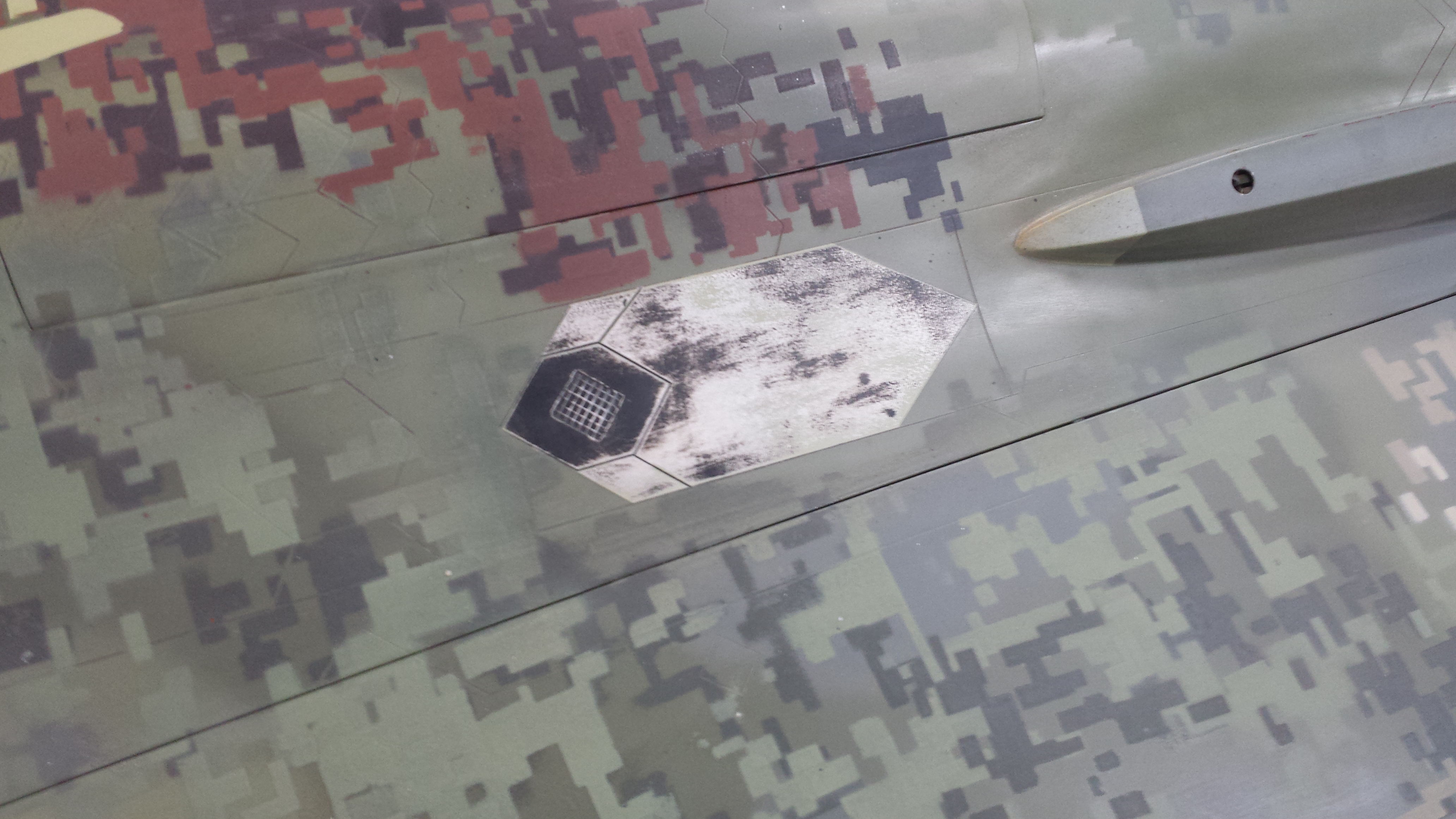

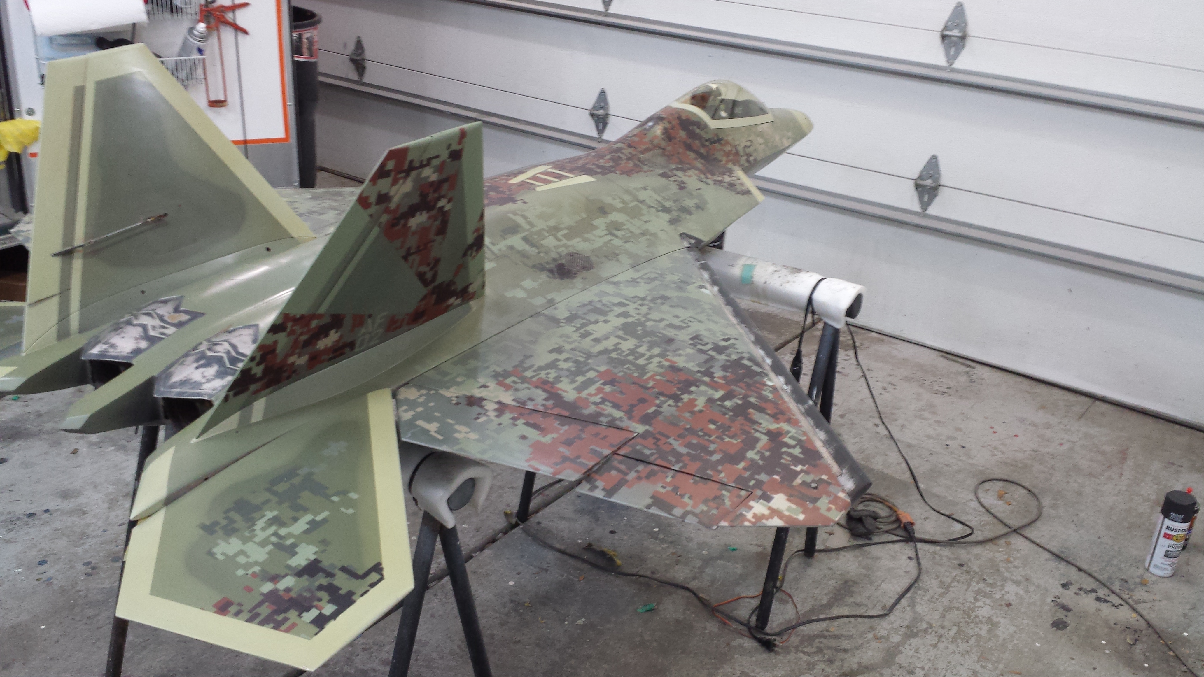

OK so this is the finished f22 .I know this is the su27 forum just showing the digital camo.

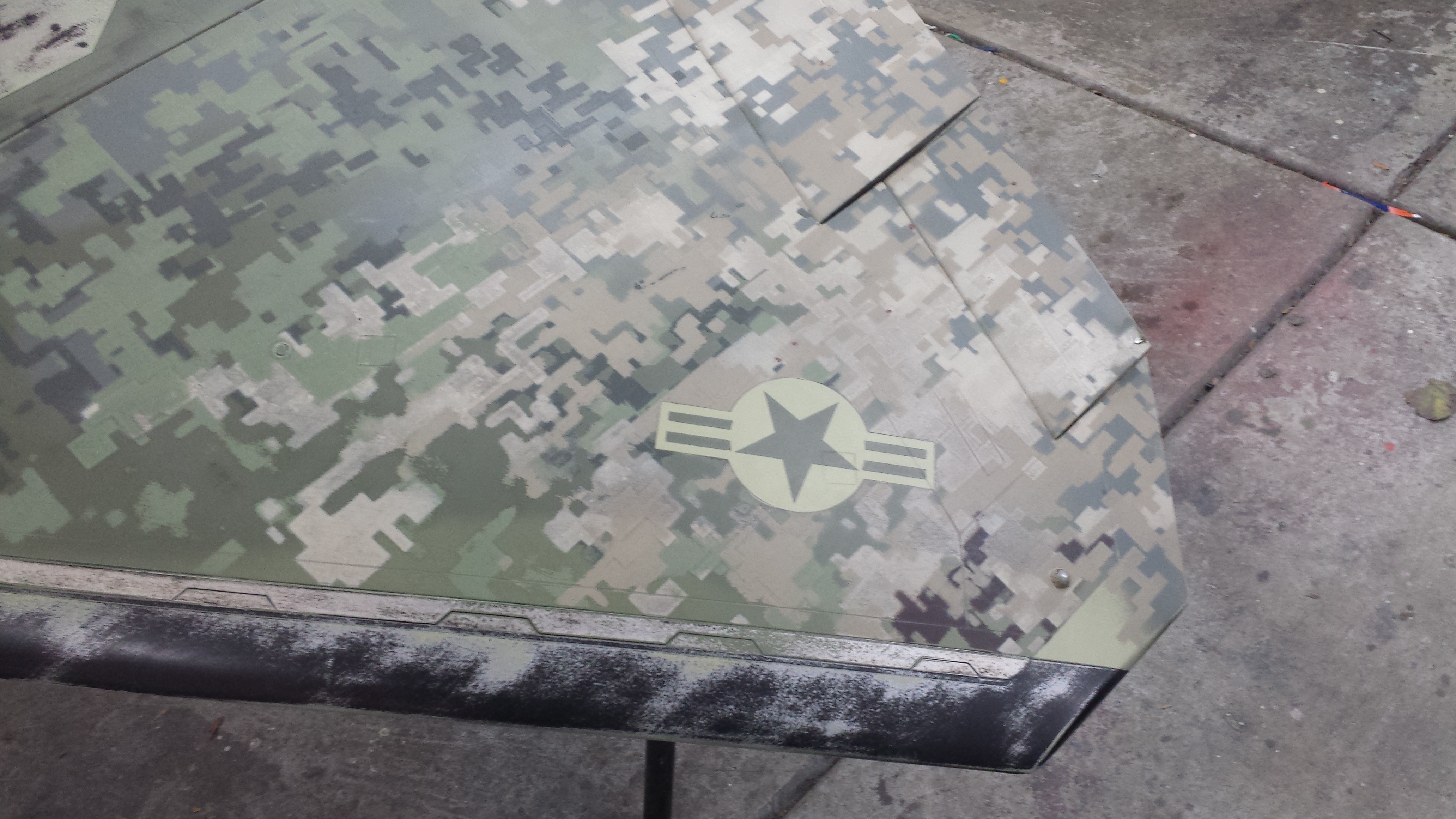

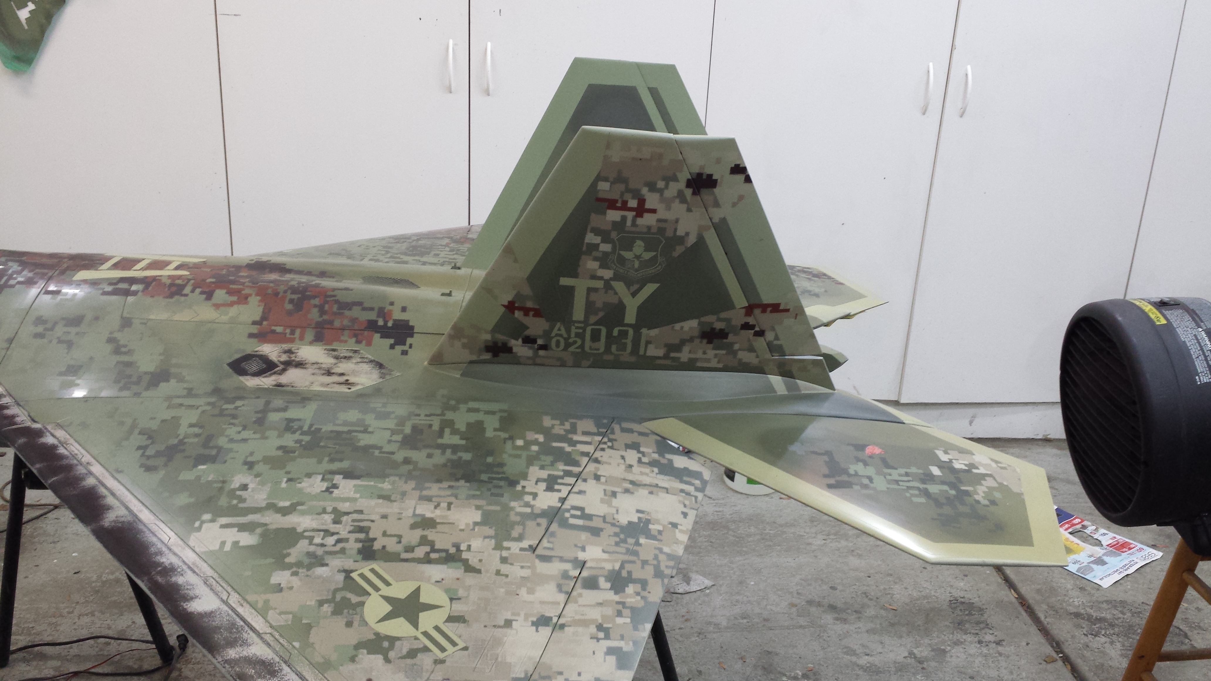

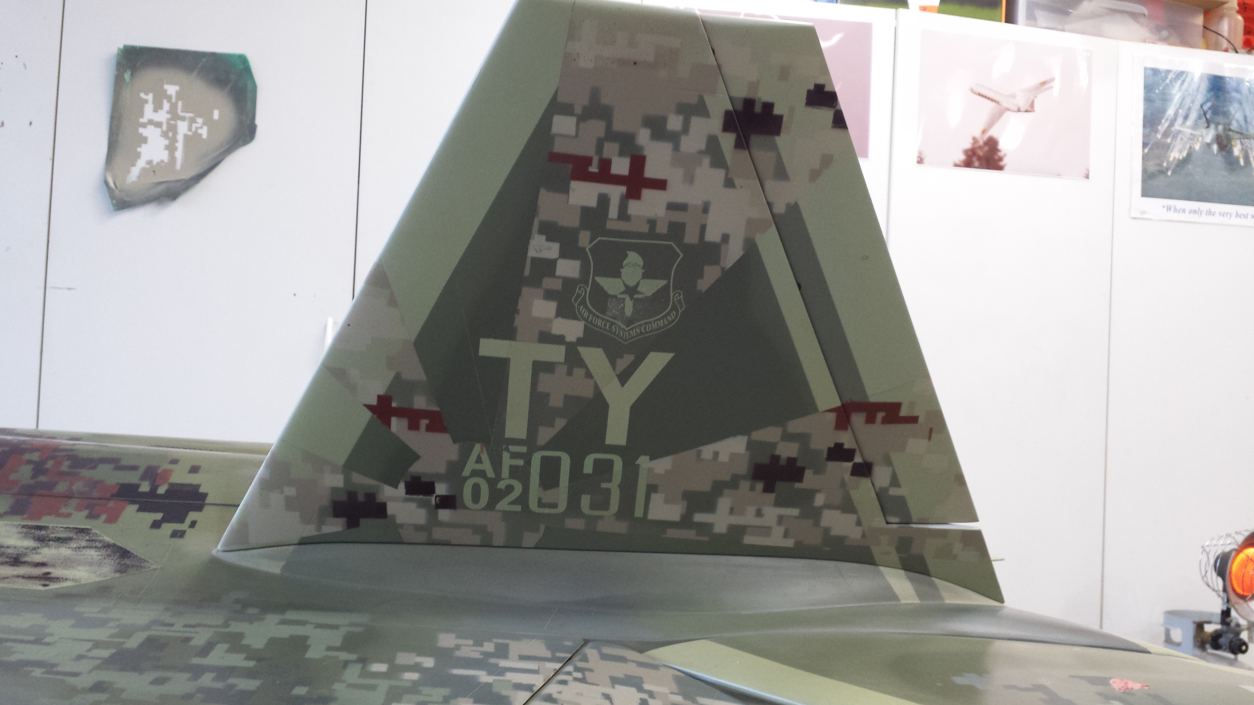

Navigation lights it's a must for this jet for all light condition day or late afternoon .

Wow Sebastian!!!

Thanks! I just hope that the camo will not work to good the f22 supposed to look like Vietnam era digital camo .
