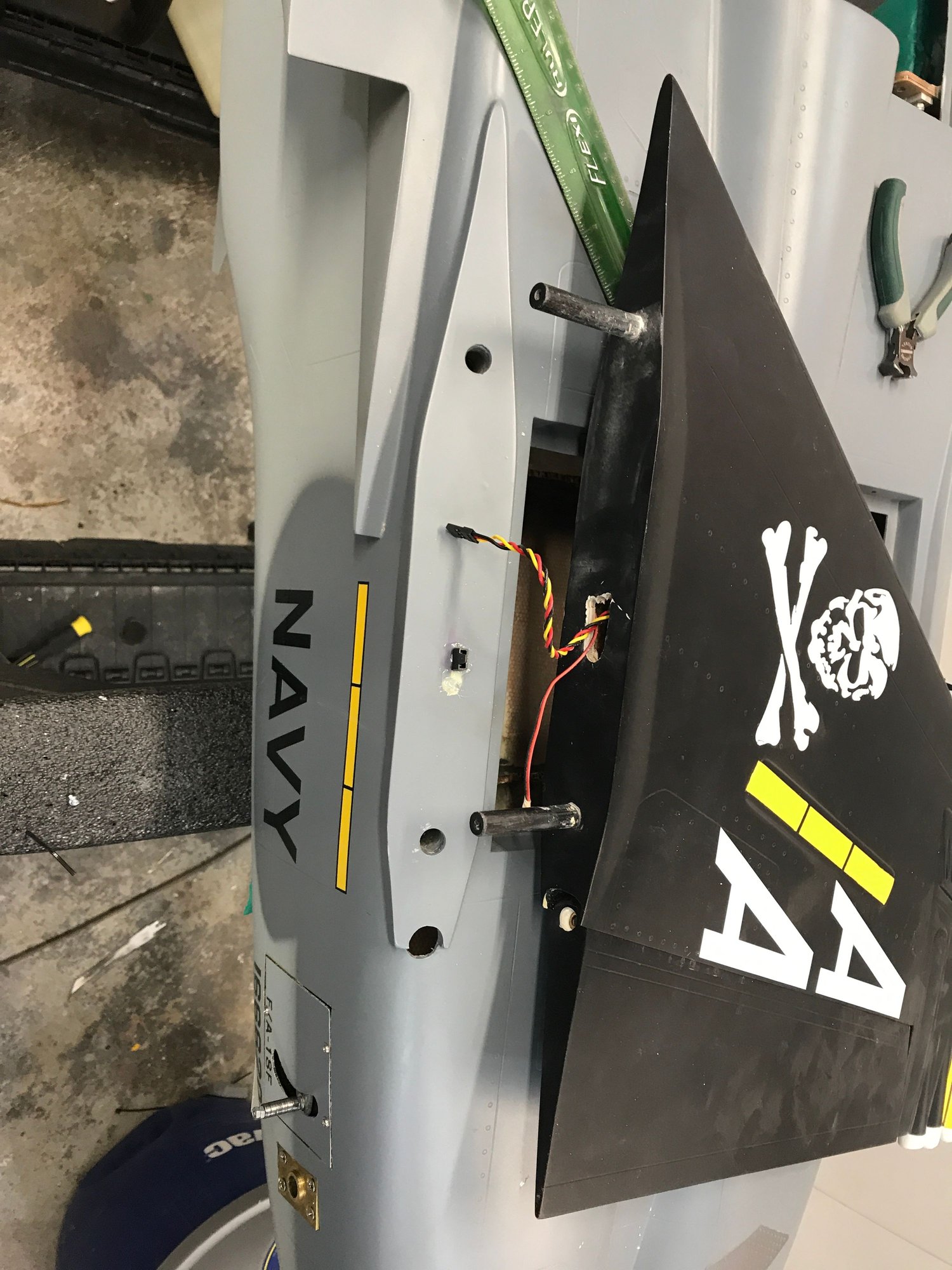

The elevators are brand new scratch build they are exact copies from the original they been bluged molded with all new shaft and plywood structure the wings looked ok with regular plywood and carbon reinforcements just like the rudders you could se on the pictures right where the servo placement +I added some thin epoxy inside the wings for all places I could reach.
Sysiek, can you please explain what you mean by bluged molded? I have a few items that I want to copy to make better but wondered how you did it.

If you have the original element you could create a mold from the original element you need to do as same way as doing regular mold from plug but using the actual elements like elevators,half and other half like a sandwich and when you have the plug you can use it to make it copies as many as you want .

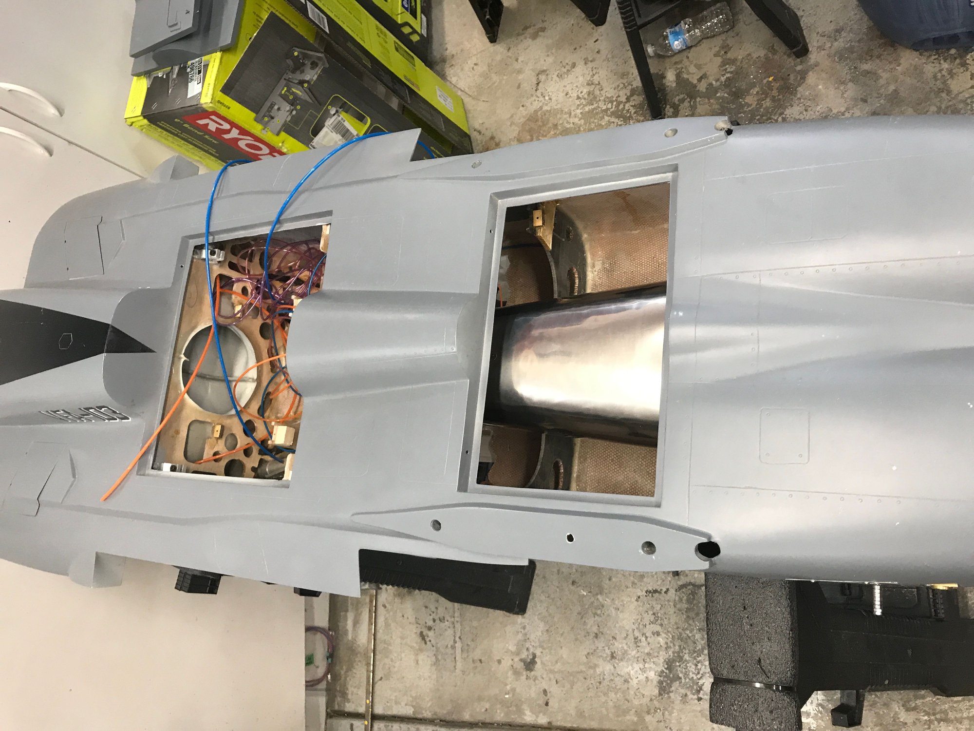

Nothing special today just glued some plywood elements to hold the back nozzles in place.

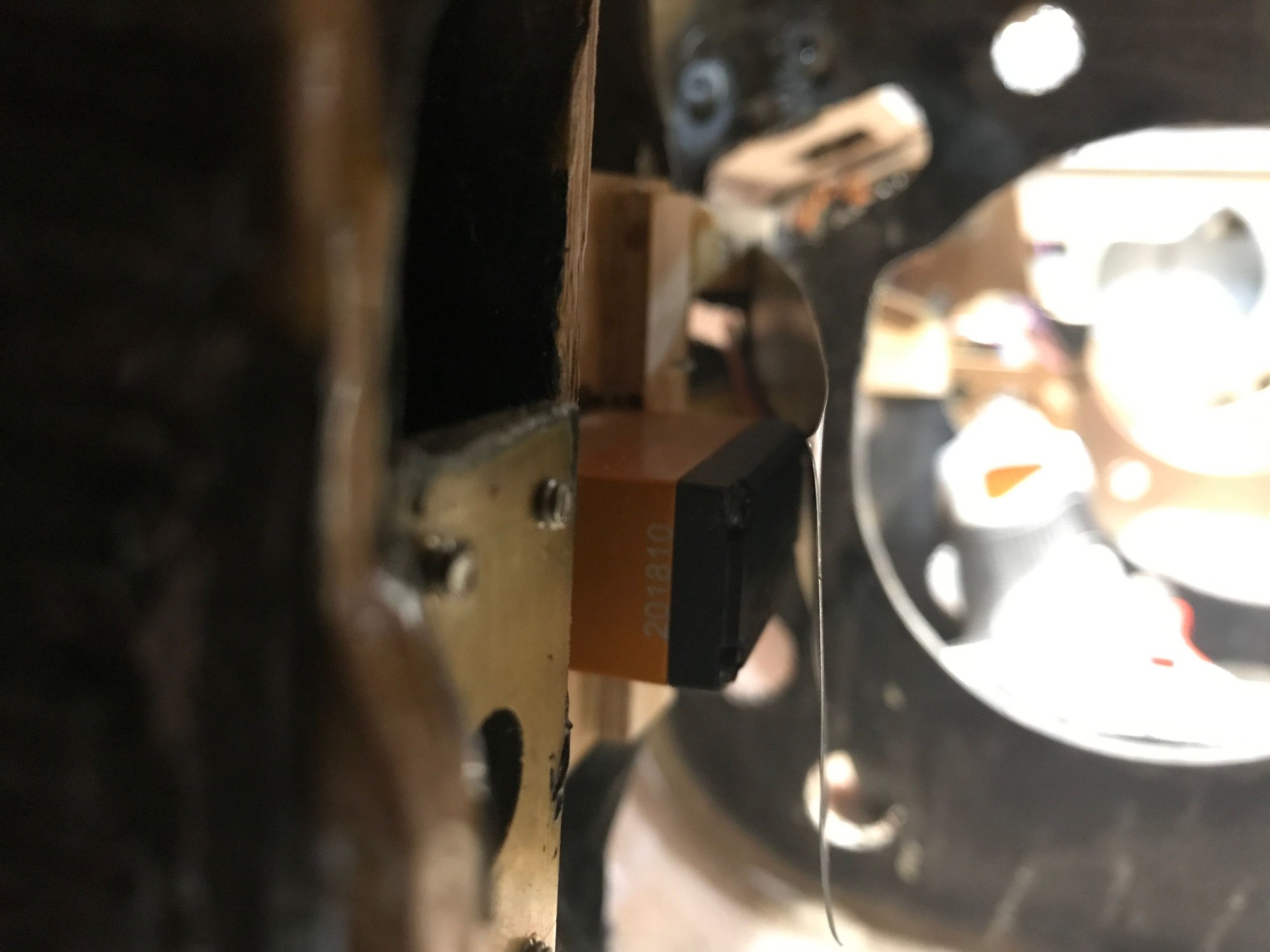

Hi

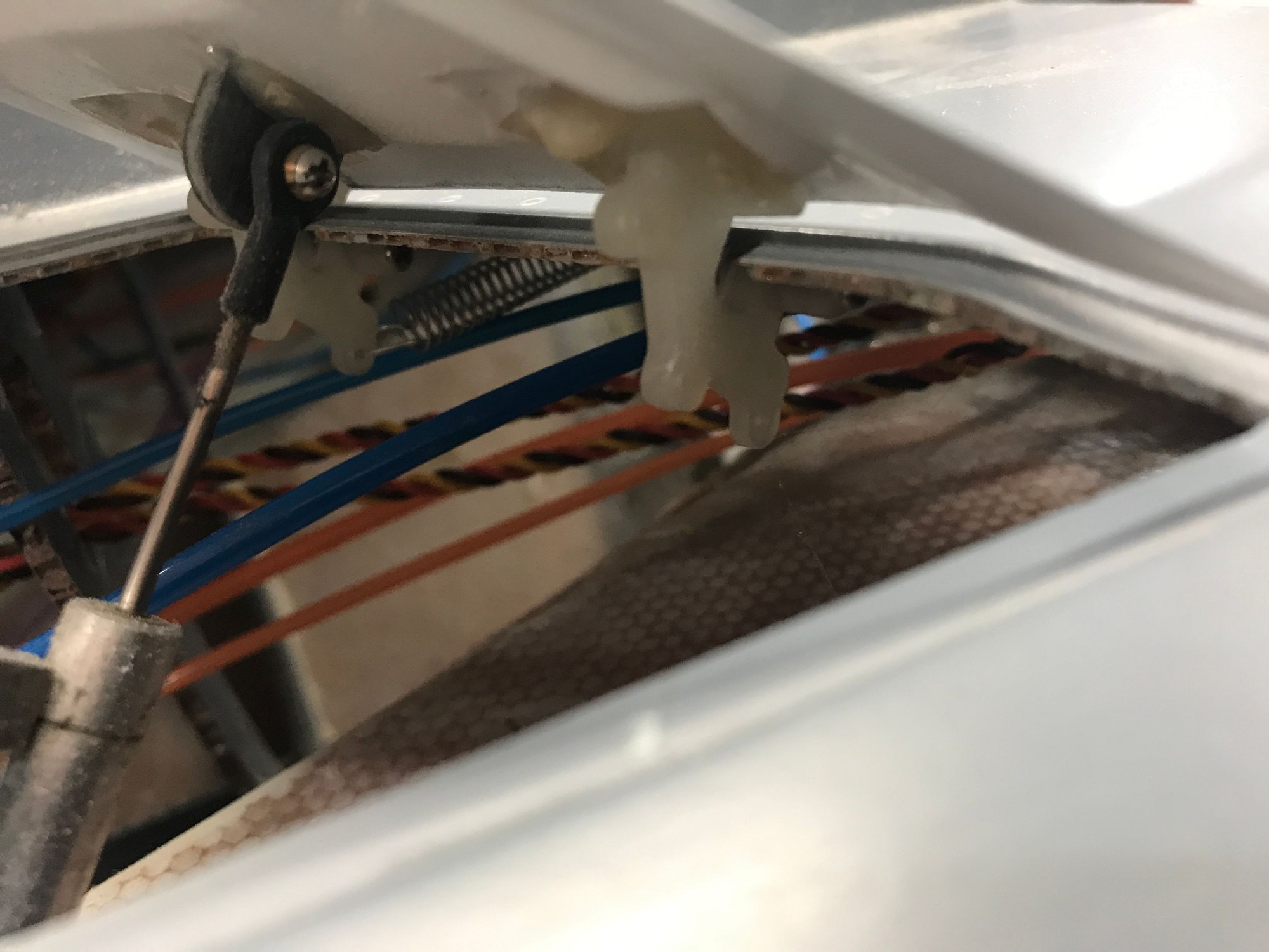

Did you find right bearing for elevator? no slop or any gap between bearing and elevator slot for servo?
suhakkogi is offline
Reply With Quote
Old 03-25-2019, 08:19 AM
  #33
sysiek
My Feedback: (176)
sysiek's Avatar
Join Date: Feb 2009
Location: Chicago , IL
Posts: 1,611
Gallery
My Gallery
Models
My Models
Ratings
My Feedback
Ok so the bearings are from eBay 3mm shaft and 7mm output size the slots I made it myself with g10 block material 12x12mm and glued in the elevators so there absolutely no gaps or spaces everything is super fit .
sysiek is online now

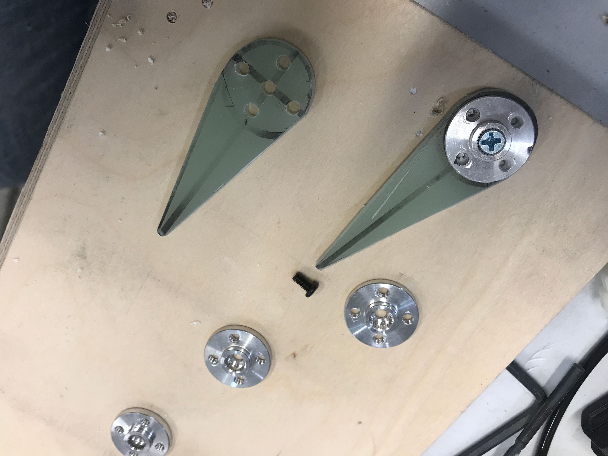

This is the way I did the flaps.

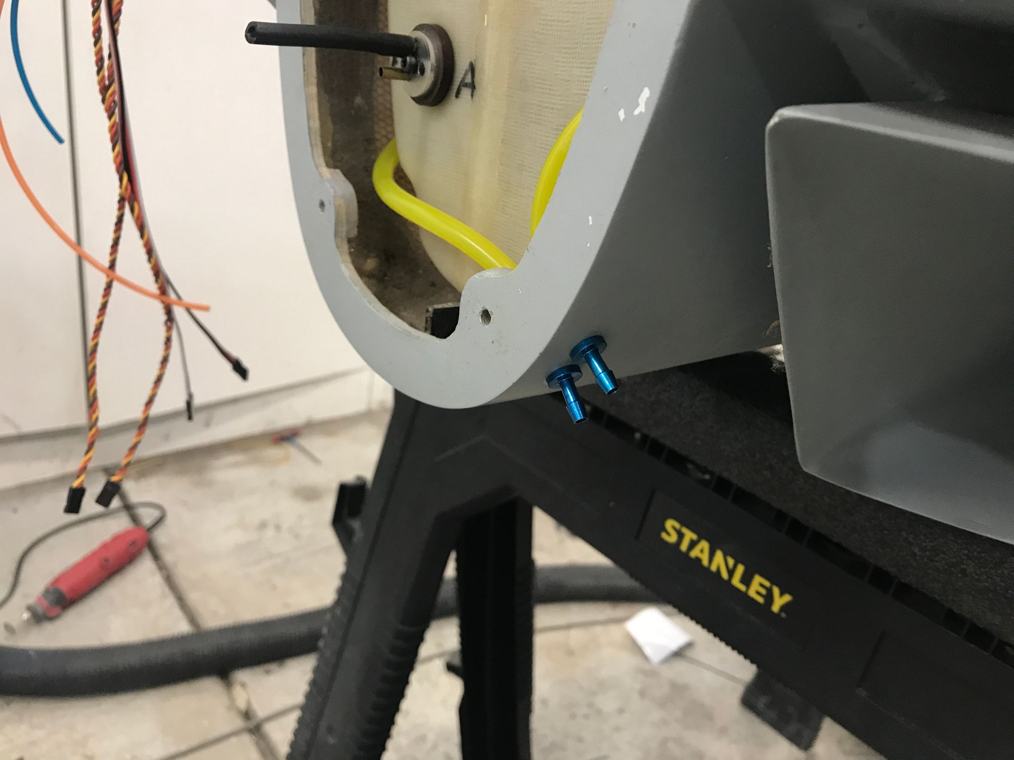

So today just the exhaust pipe support the must be made the twin version are much bigger size than the pipe Iím going to use.

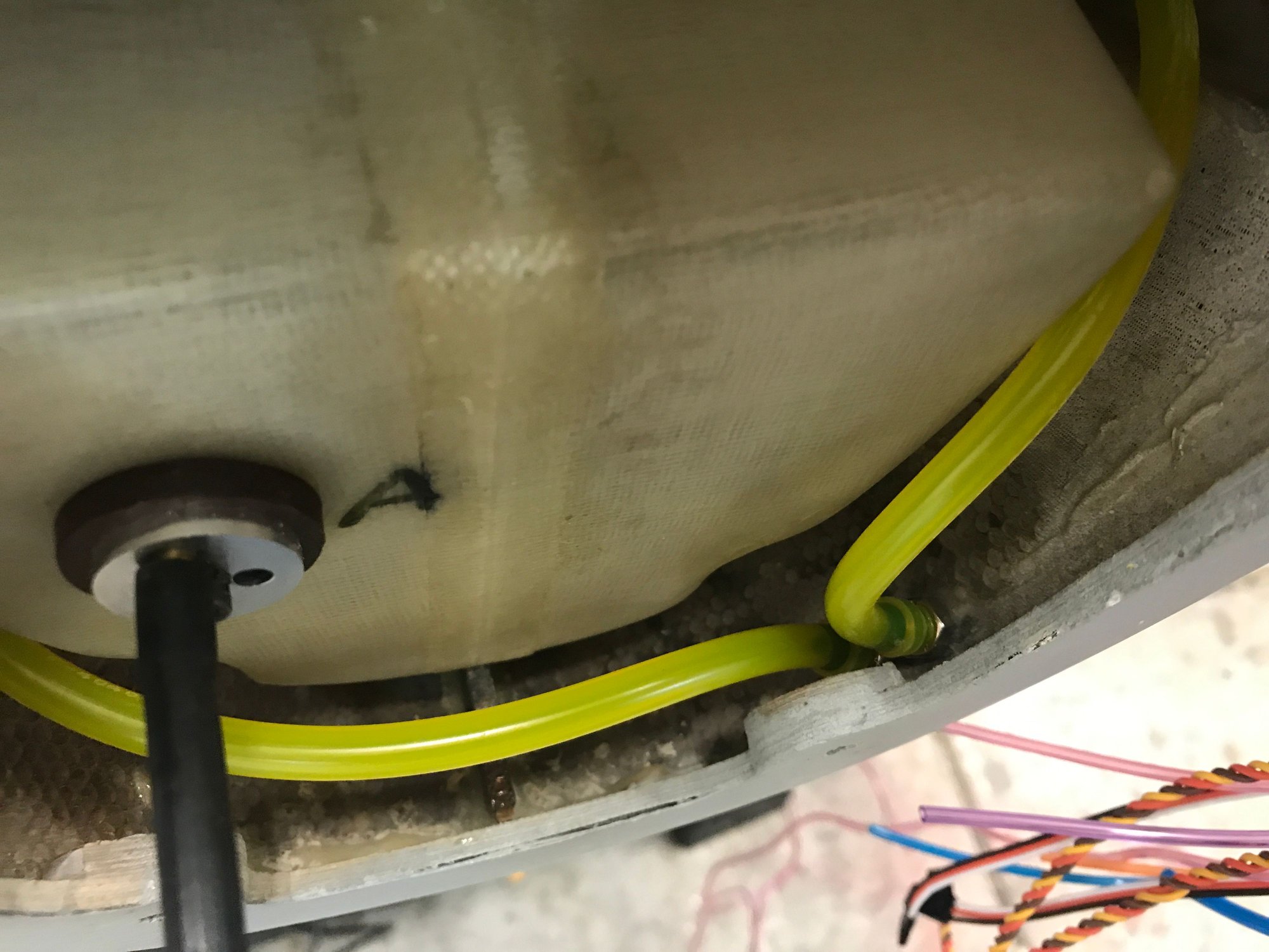

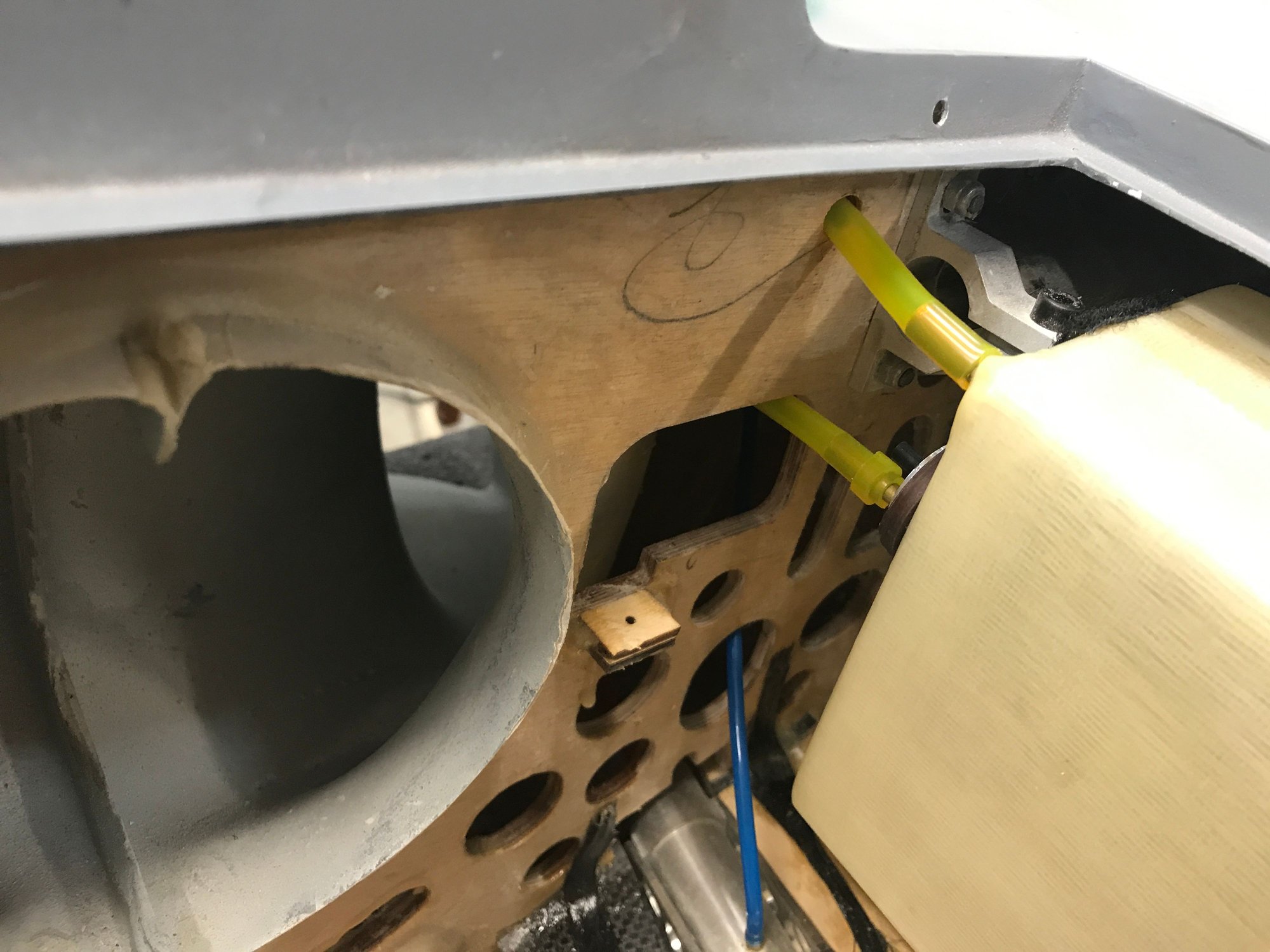

So after some break got back to the f-18 and did some changes,#1 moved the center fuel tank about 4Ē back closer to the cg ,to achieve the I did cut away some of the inlet about 3/4Ē from the top and 4.5Ē depth #2 I changed all the plastic air sticks to robart air lines #3 installed new vents to the 3 main fuel tanks to much larger for much better ventilation to make sure that there no problems with the air supply,thanks for watching.

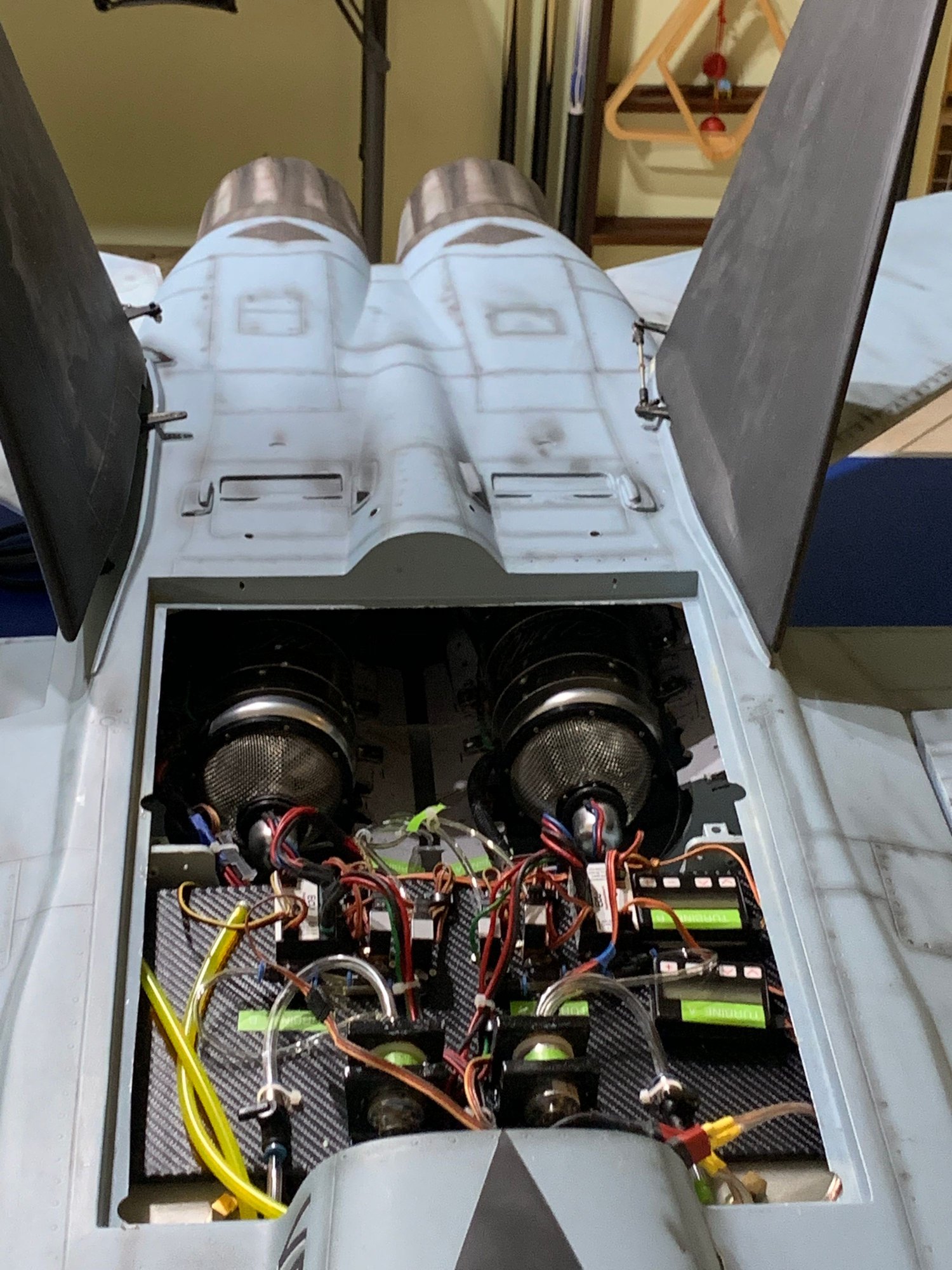

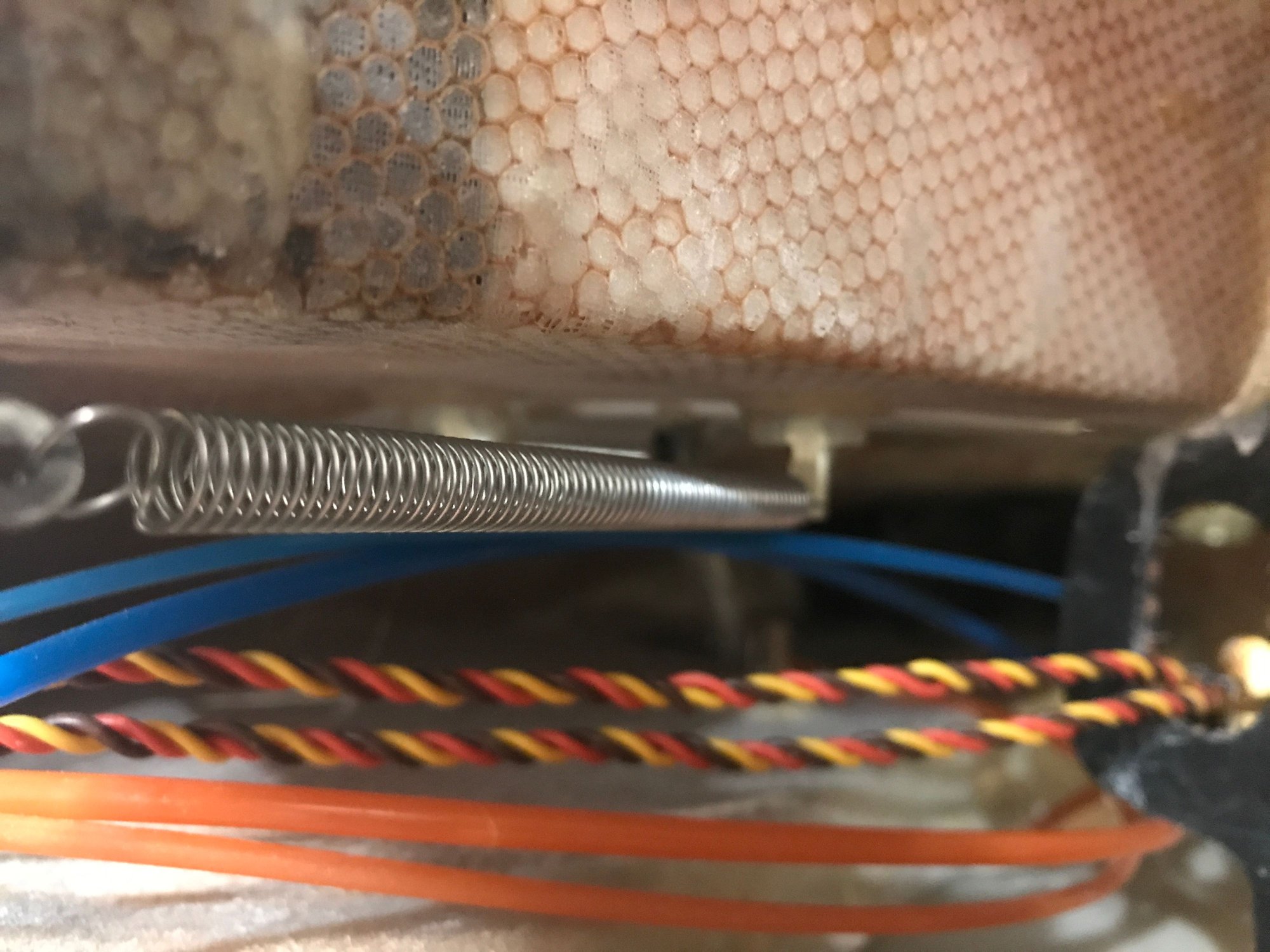

So I did some more work on her,elevators servos heat shield fuel tanks plumbing and I placed two springs for the speed brakes they will be opening with the regular brakes on the same time and close with springs.

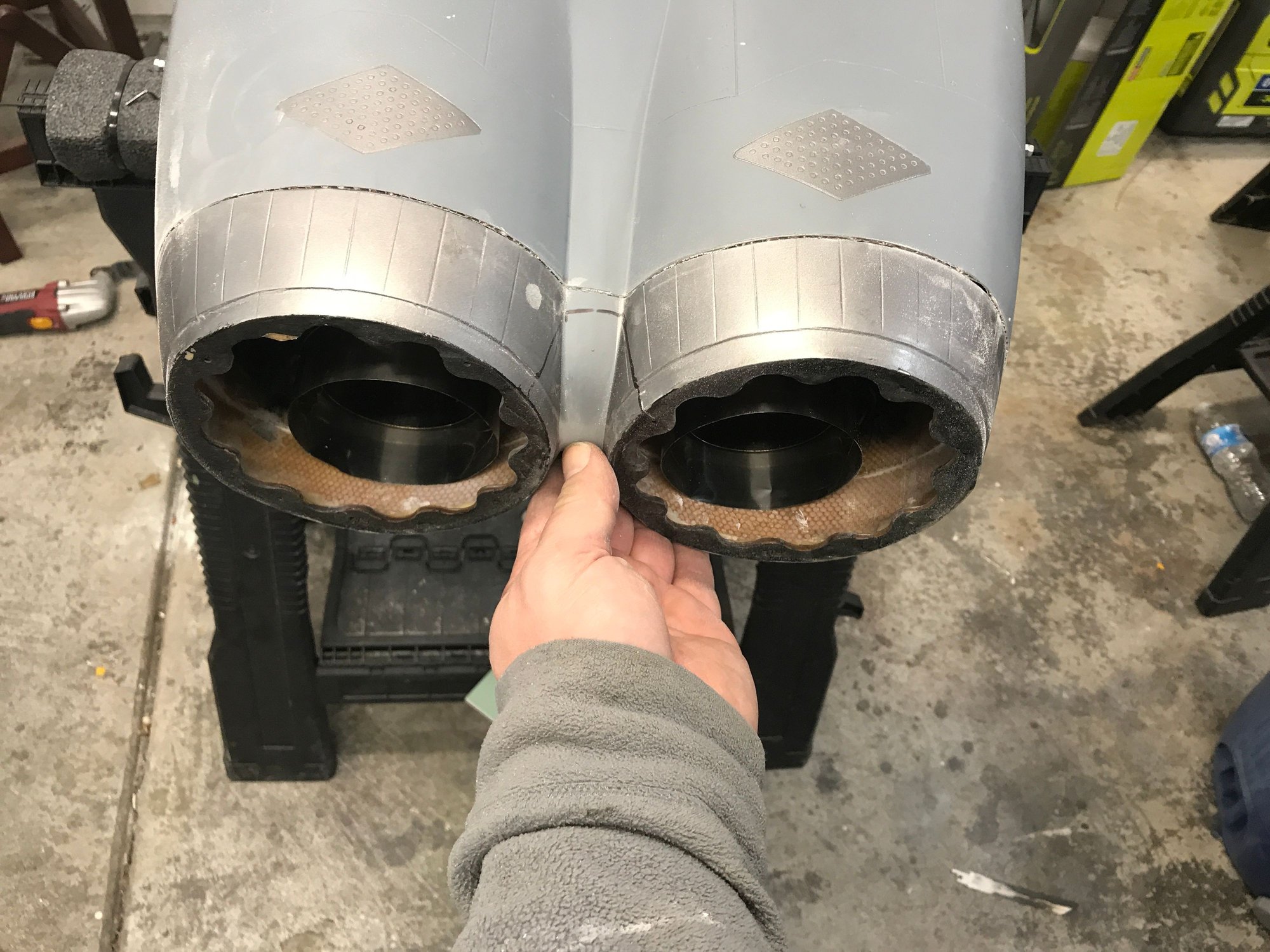

Itís yours the 1:7 scale or the 1:6 ?i have two hatches for the twin version and yours have only one for single turbine,did you have a chance to fly her yet?

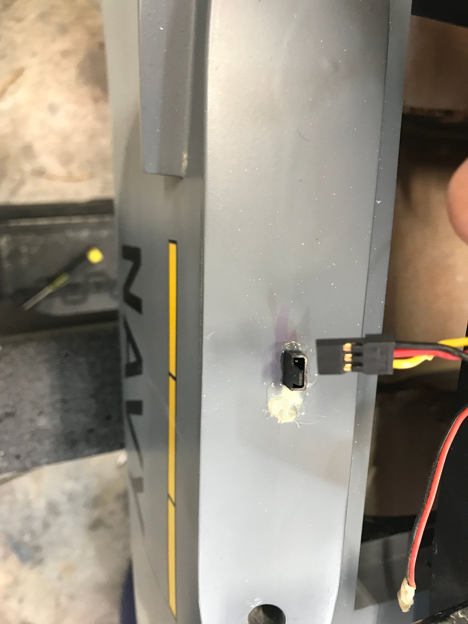

And where is your center wings spar support donít fly the jet with out of the very important element.

Default Meant to add these photos in comments. Donít know what happened
[QUOTE=qnel;12525757]
post
Iím glad to see yours. Iím about finished with my FEJ 1/6 with 2 cheetahs.. this is new one no honey comb. But had to reinforce the elevators.

1/6th scale.. yes twin... not yet... almost ran the turbine and checked for leaks. Whereís the CG? Requested for manual. Probably another 2 weeks. Have you flown yours?

Thanks it was missing. I need to manufacture one. Glad you noticed. Did your come with one or did you have to make it?
