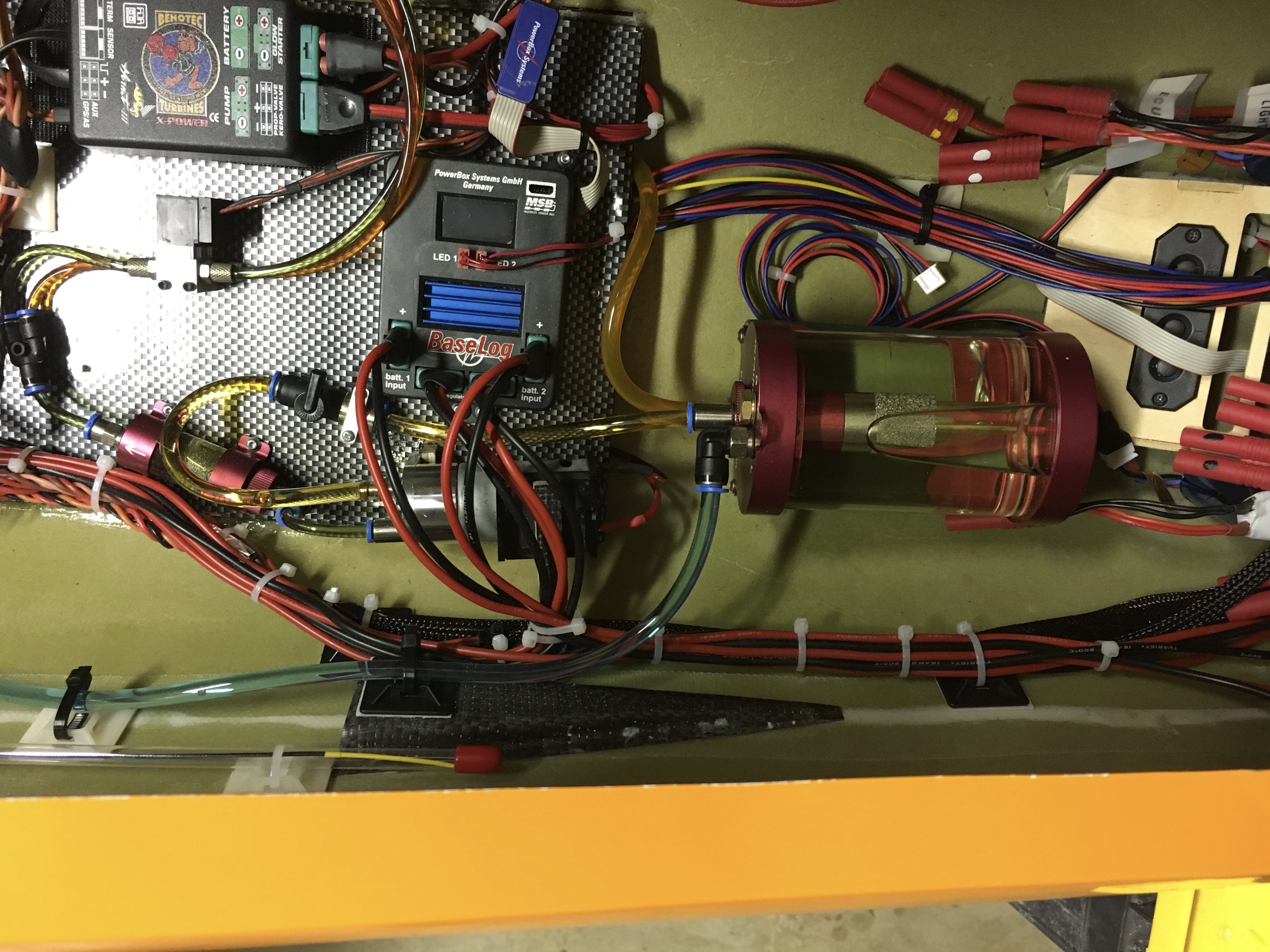

I can attest to the above described findings. Between Peter Ayache and myself, my 1/4 scale MB-339 has 25 flights. Zero problems, running a Behotec SB-220. Since this was my first experience with the Intairco system, I ran extensive tests, similar to the prior videos. No evidence of cavitation and amazing resistance to shutdown from air in the large airtrap and the small filter in line.
The super clear cylinder makes it easy to see even the smallest contaminants.

My god, Tom, You are using Festo fittings and Tygon. According to some here on RCU they can't possibly work and must be avoided ! You must be very lucky! ( or just know what you are doing !)
Perhaps one day I will describe the unique but simple and very cheap dual air trap system I have used for 17 Seasons in my BVM F4, zero flameouts , essential for a model which gas the gliding characterstics of a cast iron manhole cover.

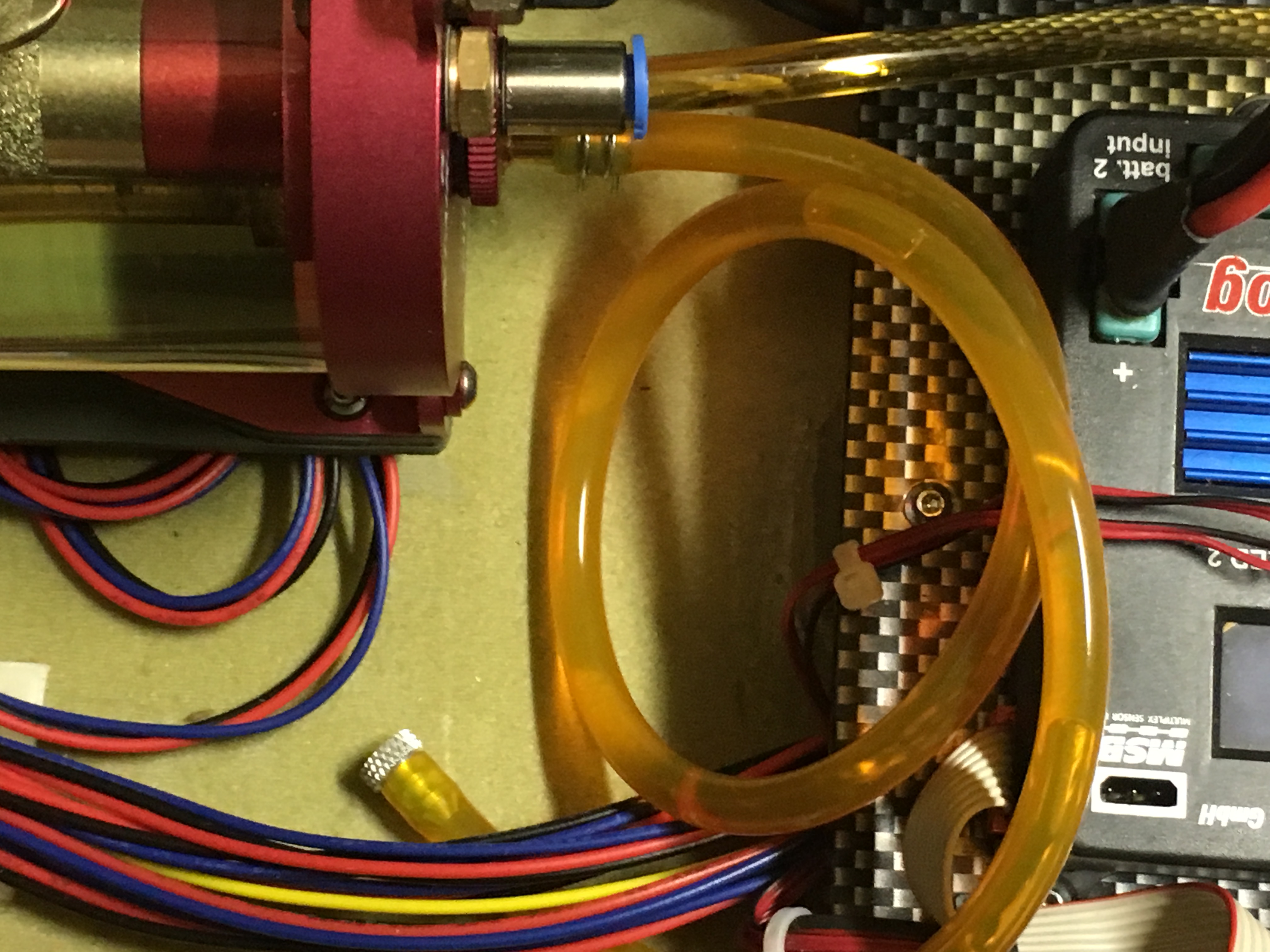

You are right David. I never mix Tygon with Festo Female sockets. My first photo obscured the fill fitting. It is a nipple with a 6 mm clip, not a Festo fitting. I like to run my fill lines well out of the fuse with flexible Tygon rather than PE tubing.
Cheers....TA

Tom, I wasn't suggesting for a moment that you were connecting Tygon TO the Festo, that, we know, does not work. I was just commenting on the fact that you are using Festo fittings , which some condemn and Tygon which some here say should not be used.
Really, I must stick to just one glass of red after a good days flying ( my SkyGate Hawk) which uses lots of Tygon and several Festo fittings Both in suction and pressure !
