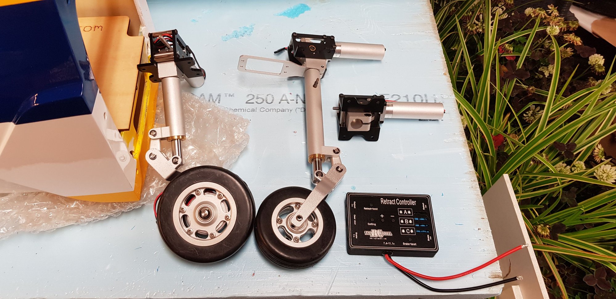

I have just received my Odyssey. The retract & brake controller seems to be an updated version from the one supplied a couple of years ago.
Does anyone have a link to the manual sheet for this new controller, as I can only find the sheet for the older version, or photos of the wiring connections?
This new version has no positive, or negative symbols on it, so I have no idea which way the wires are plugged in.
I am also wondering if the manual button works with just the battery & the retracts attached?

Good luck getting an instruction sheet. I asked for one when I first received my Odyssey about 5 months ago.
I havent been able to get the retracts to work with just the controller but they are supposed to.
I will attach a sheet they sent me with mine.
the red/signal wires orient to the top of the controller. Black to the bottom.
Hope this helps
Keith
Also, check the wires that come from the brakes. I found that the connector is wired wrong. The red wire should be in the outside pin not the middle. I modified an extension so the red wire went to the signal or outside pin and the black stayed on the other outside pin.

Many thanks for the info. I found this vid on You tube which shows a guy testing the retracts without the Tx or Rx. He is using a servo tester plugged into the Rx retract port of the controller. I tried this & it works.
With your info & his vid, all should be ok.

Have anyone got the Geardoor function to work properly?
Have managed to get the door to function....but the opposite way. Gear down door close....gear up door open!

Reverse leads

you can easily reverse your gears direction - will that help ?
