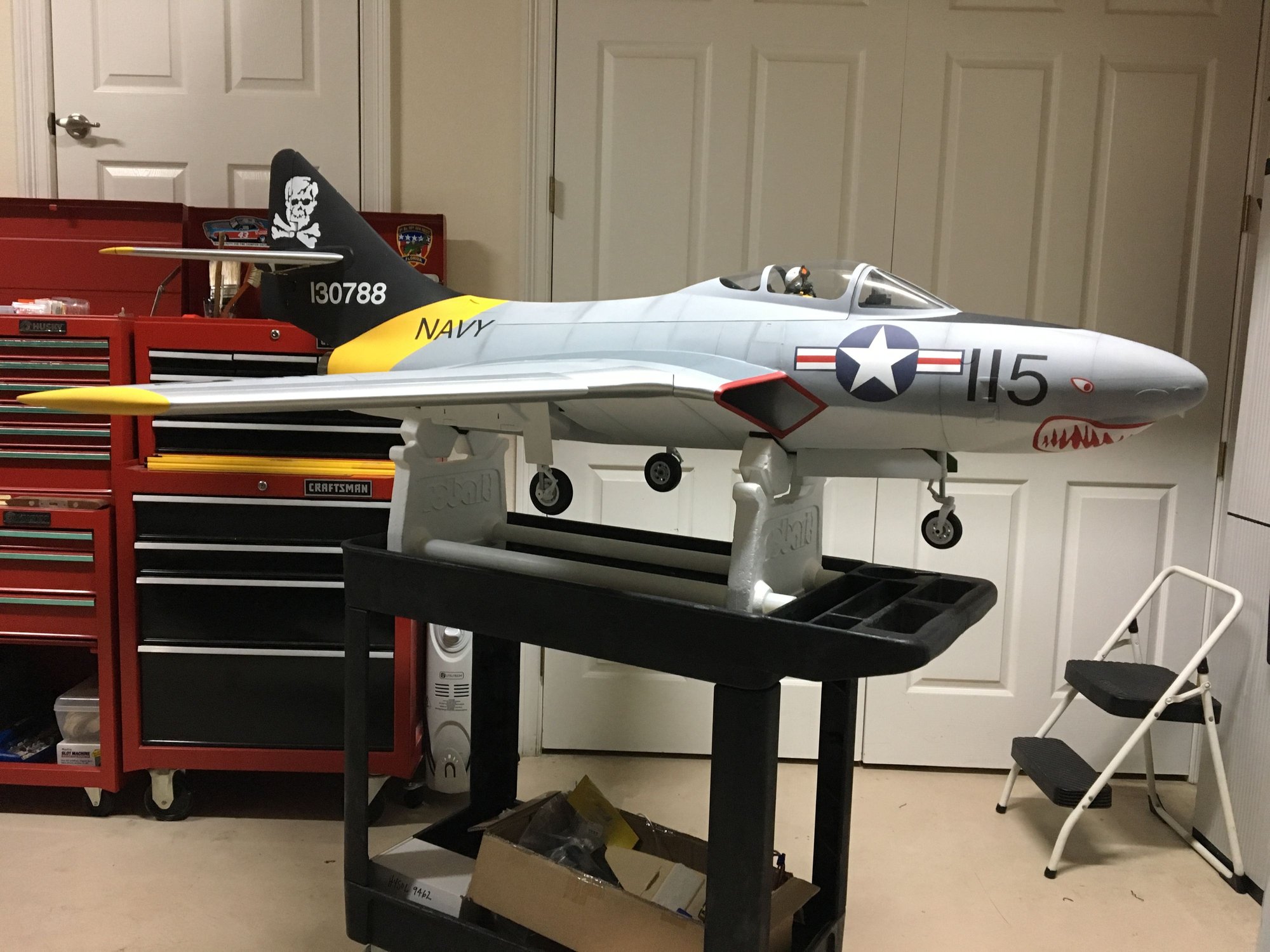

Building another Cougar. I had the Skymaster X-treme F9F, now building the TopRC kit. The TopRC jet looks to be much better built, and the paint is MUCH better than the SM. Paint from the SM Cougar would come off in my hand when I picked it up...
Using MKS HV747 & HV1220 servos. Gear is painted, but work keeps getting in the way of my hobby. Planning to power with a JetCat P100RX. This one's gonna take a while. Most of these pics are from my SM Cougar, painted the bottom white, main gear doors added, Fei Bao F9F cockpit added.

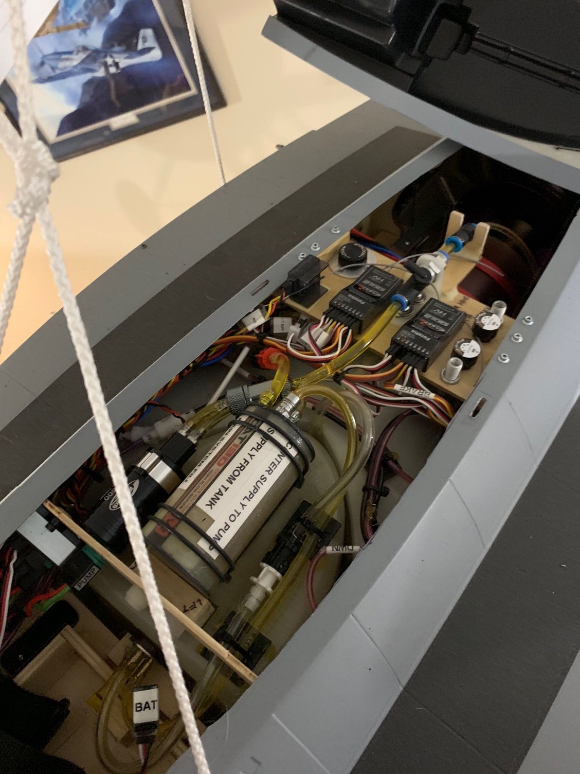

Yup, I have. I balance at 185mm and absolutely no issue on flight performance (other than being a little heavy on climb-out. I have a Wren 70 in her, located a bit further forward than in the picture (ground out the flange on the inside of the intake duct when the stock pipe imploded - so new pipe from Gary Mueller, and moved the engine forward.) I have the adhesive felt/aluminum insulation on the outside of the tanks from Aircraft Spruce just to help with keeping the fuel cool.
Tanks are in series, draining the saddle tanks 1 and 2 then the main tank 3 and finally a 2 oz UAT. I fly for 8-9 minutes and land with a safe reserve in the main tank.
All this is at 7000 feet.
Hope this helps!
Greg

Jetflyr.................wow thanks your picture is exactly like the way I have my tanks set up as well. Is your tanks 16oz each? If so, should be the same amnt of weight.....Just to confirm, you balanced at 185mm WITHOUT FUEL. I have my tanks set up on a tee. The two saddle tanks should be used at same time before the main tank is used. Do you think this is ok? Just for info, do you remember how much weight you had to put in the nose for balance?
tks

Yup, I balanced 185mm without fuel in the tanks - but 2oz in my UAT up front. The saddle tanks are Sullivan/Pylon 12oz saddle tanks, and they are in series. (I prefer series since they drain completely, and they are so close to the center line that it is not an issue).
Before I put the saddle tanks in I needed 4 -6 oz of weight in the nose, no change with the saddle tanks.
First flight was main tank only, then a single saddle, then both. The airplane didn't know the difference other than the extra weight for the first few minutes of the flight.
Do make sure you reinforce you main gear mounts before you have everything in the airplane .... they will need it!
Hope this helps!

Well I have received a lot of suggestions....a couple have said they made no change to the CG with the additional tanks. So what I think I am going to do is balance the plane dry, then fuel it up and see if there is a significant difference. After seeing the results, ,if in fact is becomes noticeably tail heavy I may add a little more weight to the nose and try to make it 50/50 at takeoff and landing. I am at 5300 ft and want the extra thrust of the 100 but also do not want to have to spend more $....the throttle does not have to go all the way to the top
sleibach@cableone.net is offline

Did you consider putting the extra tank on top of the existing one?
