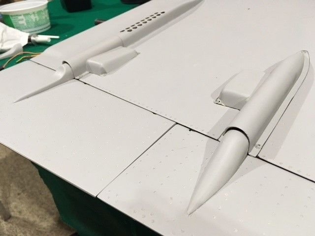

I finished up the wing servos by mounting the servo covers. One of the wings seemed to have a very thin skin at the leading edge of the cover, and the screw would not hold. I cut a slot and slipped a piece of wood in to give the screw something to bite to. A bit of trimming was needed so the cover would fit flush. I mounted the trailing edge covers using Zap Goo. They look nice, not sure they'll stay. That's what's nice about the Goo, I could take them off if needed with no damage. It took some work to make sure they moved smoothly with the surface.
Cover installed
Added wood to give screw some bite
Trailing edge covers installed
Cover installed

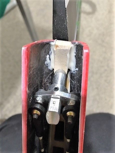

#102
On to the Rudder servo. The horn provided is not very wide, so I was able to find a servo horn with the same width between the holes. I needed to mount it in a way that it's all removable even after the rudder is glued on. I used screws with lock nuts that provide studs handing down, then I can slide the ball links on and off even after the rudder is glued. I moved the horn on the rudder a bit farther up than the flats provided, made my own. I also only used the back set screw. That way I'll be able to take it off if needed. One screw can actually hold better than two anyway. I trimmed just a bit off of the rod hooked to the rudder so that it would not hit the fuse. Once I had everything lined up and working smoothly, I was confident to glue on the rudder. If needed, I can take it all apart. It's a nice system.
To add a bit of strength and take away some strain on the hinges I added a piece of wood as shown in the last photo.

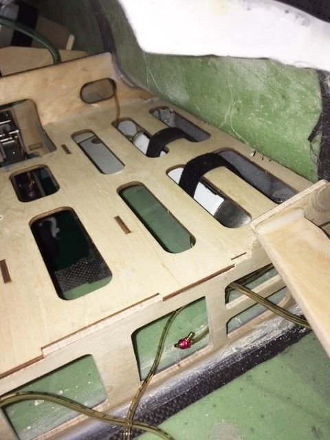

If you built a jet before, you know it's a challenge to get everything to fit. It's important to figure out where all the controls will be, and make everything accessible. The hatch on the side is the best place to access the controls, so I wanted most of the things I needed to get at located there. I added a piece of carbon fiber to move the air fill valves closer to the edge of the door. I also mounted a jack to plug in the Jet Central control panel. I could have bought a small one to carry on board, but I didn't need it. I'll put some velcro on the hatch and set it there during the start sequence, then unplug it and put it in my pocket before shutting the hatch. I also mounted the air gauges, as well as the receiver power switch and LED towards the front. I made a loop for the fuel fill that will be available there as well. The fuel shut-off valve will be easy to reach inside. Off to the right you'll see the display for the Booma RC battery system, the AR smart switch. This monitors everything on the two receiver batteries.
I mounted the bubble-free tank up in front as well. I made a bracket and used a Velcro strap to hold it in place. I like that I can look inside when the canopy is open and see how well it's filling, as well as make sure there is not much air in there after a flight. In the second photo you can also see where I plan to put the turbine control module and the receiver. There's room on the edge for all of the receiver connection wires to come up from the bottom. Underneath the panel shown I'll mount my main gear air valve. The other four air control valves (brakes, air brake, canopy up, canopy down) will all be in front. I'll show the locations for those soon.
Controls accessible through the hatch
Bubble free tank mount, and everything else

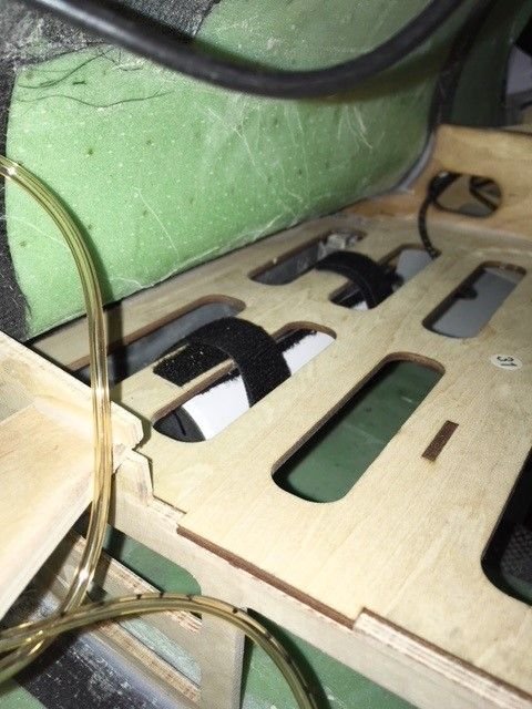

Got the plumbing installed in the fuel tanks. I used Hysol to glue the machined fuel tank inserts in place. Be aware these are not included in the kit, but it's something you need. You can get them from places like Dreamworks RC. I used Sullivan stoppers and typical tank hardware. Prior to installation I'll test them to make sure there are no leaks. I've seen pinhole leaks in Kevlar tanks before, and had to use some Hysol to patch them. These look good, so hopefully they'll be tight. I plan on using Velcro to hold the tanks together, Velcro at the base, and Velcro strap to hold them down. It will be one of the later things I do so I have room to run all the wire and tubing through the plane.
I made a mount for my UP3 main retract sequencer valve. It will be mounted under the main tray using Velcro. I like that I can move it to make it easier to hook up or make adjustments. That will be one of the first things I hook up. The only thing connecting to the main tray will be the source from the fill valve/gauges. Won't be long and I'll have everything in place, so I'll start the long process of routing plumbing, making servo extensions, and routing all the wiring.
Fuel tank with stoppers installed
Air valve mounted with Velcro

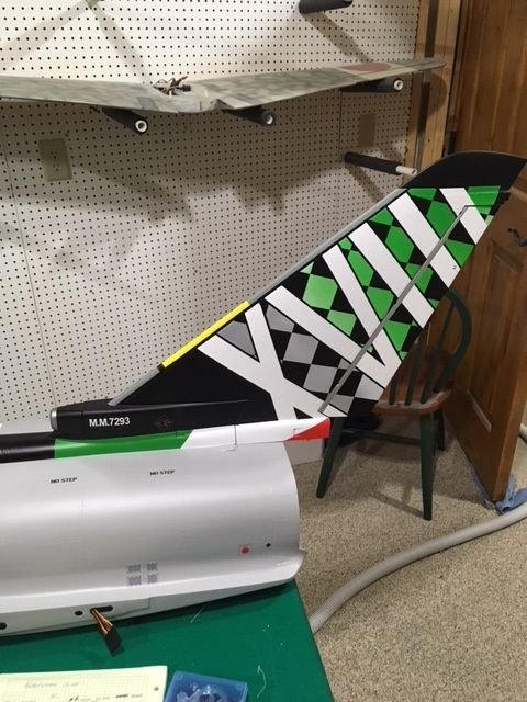

I mounted the vertical stab so I could start routing the wires from the tail. I had to grind out the hole for the front bolt a bit, but in the end it matched up well. I was happy with how it mounted, it feels secure. I installed the Ashlock connectors that will hook up to the wing. These are secure connectors that minimize the connections you have to make when installing the wing. (Dreamworks RC sells them). You'll need a servo connection crimp tool to make your own. I ran the wires from the tail and secured them (as shown earlier in this post) to prevent them from touching the pipe.

Now that you mention it I see what you're talking about with the tail piece screws. The pipe sits tight around the rings, leaving no space to put the screws in. I might be able to deform the bell on the front just enough to slide the pipe forward through the afterburner rings to access the screws, then slide it back into place. I say slide it, but it's difficult to move that pipe in with the sharp edges always catching. If I find a procedure that works you can be sure I'll post it.
Doing some test fitting my turbine will be pretty far back on the mounting rails to get me about 1" between the end of the outlet and the start of the narrow part of the pipe. If I have to move a battery back, that would be better than putting nose weight in it. My Cheetah 160 turbine is not as heavy as some others (8 oz. less than a JetCat or Kingtech 160) so I still may have to move some weight back.

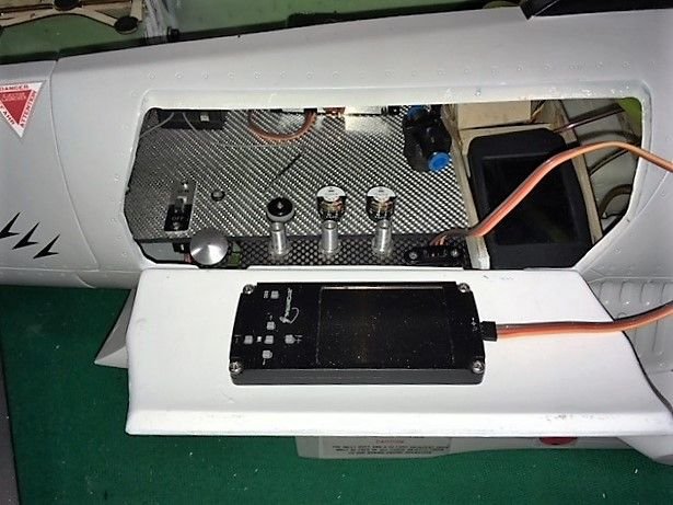

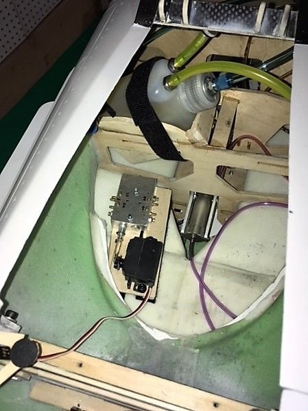

I'm setting up the operational canopy using servo's and valves. I mounted them up underneath the cockpit. As long as you keep everything flat they'll fit. I was going to just make it manual operation to save the channels, then I decided it's just too cool to open it with the radio. To allow me to only use ONE channel, I decided to use an inexpensive sequencer from Hobby King. It allows you to set all of the throws, and delays. I haven't mounted the canopy yet to test it, but I should be able to get the timing right to make it work.
I'm using one of the rotary knobs. Since I have to rotate the knob a half turn to actuate the canopy, there should be less chance that I would hit a switch in error that caused the canopy to open in flight with obvious results. To actuate the sequencer, you have to cycle it three times quickly. Once that initiation is done, it will cycle when you hit the switch (twist the knob in my case). Don't forget to download the manual if you buy one, that's the only way you have a chance of setting it up. It's about $15. See the photo below.
By the way, while you're ordering from Hobby King they have a wing bag that will work (1100mm version). I had to modify it a bit because of the wing tip pylon, the tip of the pylon sticks out through a hole. Two wings fit, but it's really tight. I think I'll use two bags, put one wing in each. At only $27 each they are quite nice (looks like $29 now). I can hear it already. "That's a nice looking jet for something from Hobby King"

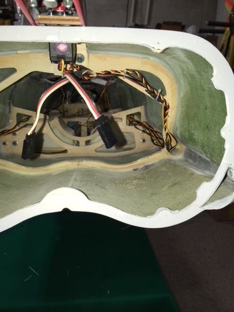

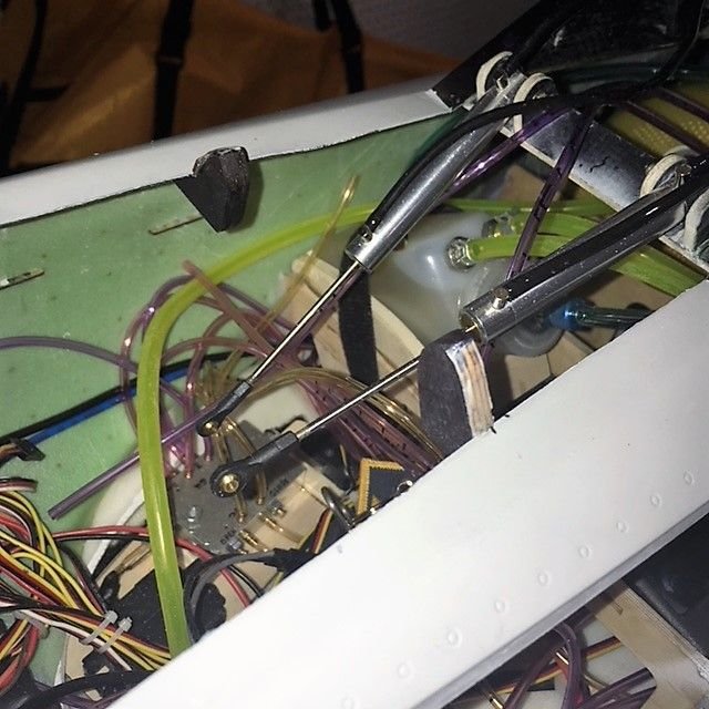

Getting all of the wiring and tubing installed is a bit of work. I think I have everything located in a way that will work out. All of the canopy air controls are located up under the cockpit. I was able to run the wires from the front underneath that front shelf, but it's tight. Organizing the main area behind the magnetic hatch now. Once I put that shelf in it should look pretty clean. Just don't peak under the hood! I didn't have much luck with the electronic switch I wanted to use to kill the landing lights when the retracts go up, so I went old school and used a micro-switch that is actuated by the main air valve. It worked out well. Here are some in-progress photos showing where I put everything.
Initial CG checks made me think that I was fairly close on nose weight. I'm close enough to completion that I think I'll throw everything in and see what I have. If I have to move a battery back it's a bit of work, but better than adding lead to the nose. I'll be curious to do an all-up weight check as well.
Canopy air controls
Canopy air controls

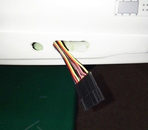

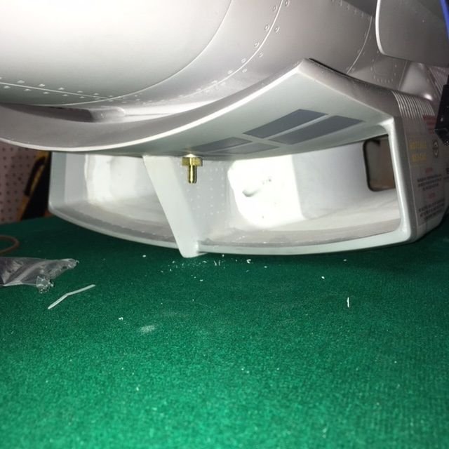

So far the door actuators seem to be holding air fine, but I've done minimal testing. I still have to get the canopy hooked up to see how those air cylinders work as well.
Spending more time routing and organizing the cables and tubing. To prepare for the fuel system I had to determine where to put the vent fitting. I like to be able to reach it with my overflow tank sitting on the wing. It's also good if it exits out the bottom so it doesn't spray fuel on the side of the plane. I decided to put it down right in front of the left intake. I added some reinforcement in the form of a piece of glass. See the photos for the install.
Some investigation of the canopy prior to installation revealed that they say to use some self tapping screws to hold it on. That's not good for me, screwing into some thin glass material. I mounted a piece of ply to the mount with some 4-40 blind nuts in it. I also added a piece of wood to help strengthen the canopy hinge. I used some of my own hardware with ny-lock nuts to hold it together. It moves smoothly without a lot of friction. I should be getting the canopy mounted in the next couple days.
Vent fitting inside fuse
Fuel vent fitting location outside
Modified canopy hinge

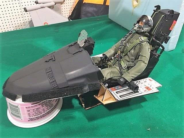

While the glue was drying on the canopy guides I did a bit of work on my Cockpit. I added some scale detail on the dash cover (area right under the front canopy). The seat belts went on nicely and I added an extension to the oxygen mask. A few other minor details and I'm happy with how it turned out. I usually have to build a cockpit with little help, so despite the cost it was nice to have a good looking starting point. It's slightly tall, so I will re-mount the two things that stick up from the top of the ejector seat to make sure they don't touch the top of the canopy when it closes.
