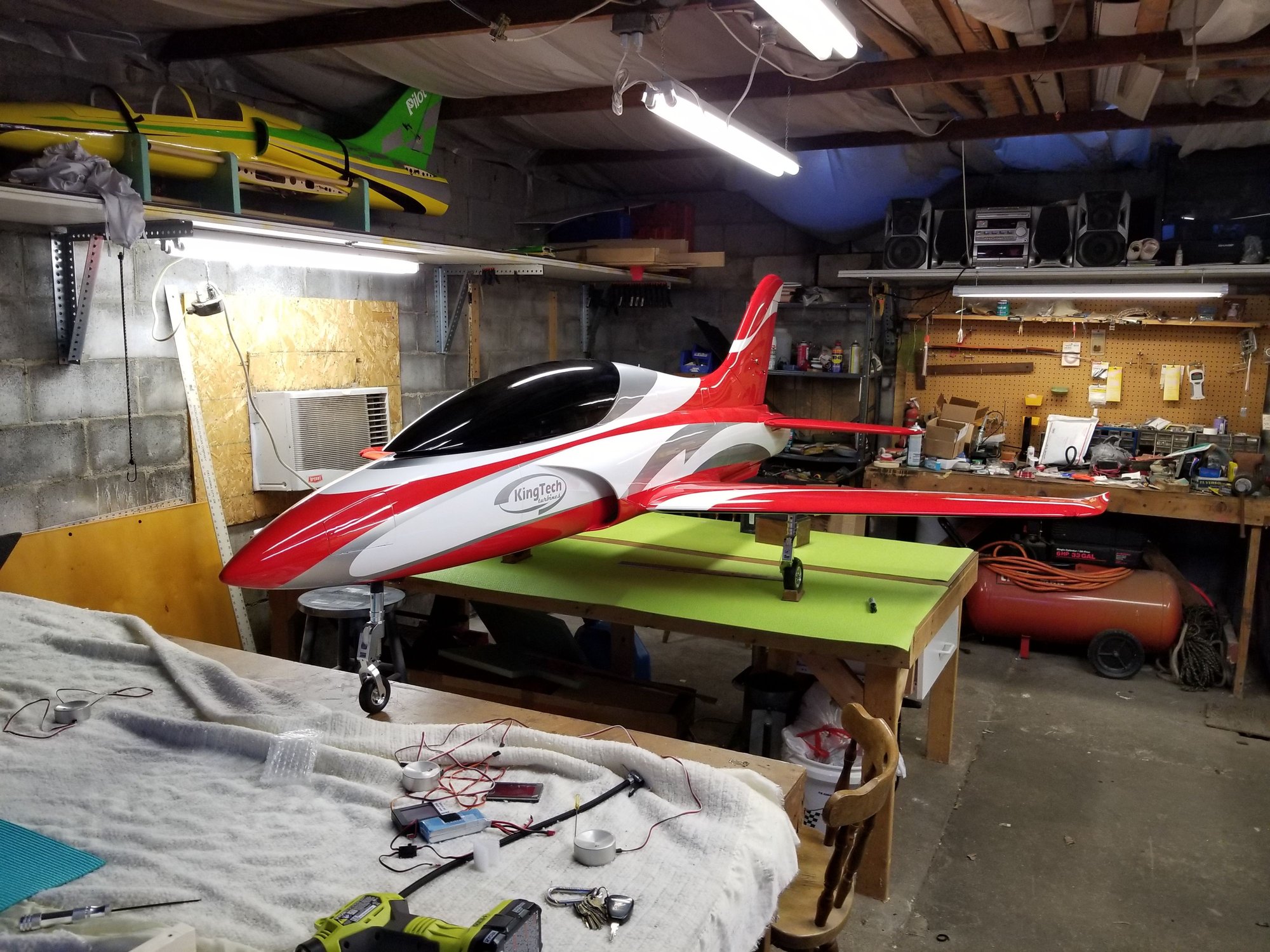

I posted it on the FB page but for those not on FB ... I finally got a chance to check my CG today and I'm around 353 - 355mm by my calcs.
Weighs 50.83 lbs with PBS 230N turbine, smoke system, light system, two 2S-4000mah flight packs, one 2S-3300mah for smoke/lights, and one 3S-5000mah for turbine. All LiPo and could probably drop close to a pound by using smaller batteries.
Flies great ... can ride a wheelie on landing for 75ft or more (depending on landing speed). Slows down to a crawl for landing. No crow needed to slow it down.
JS

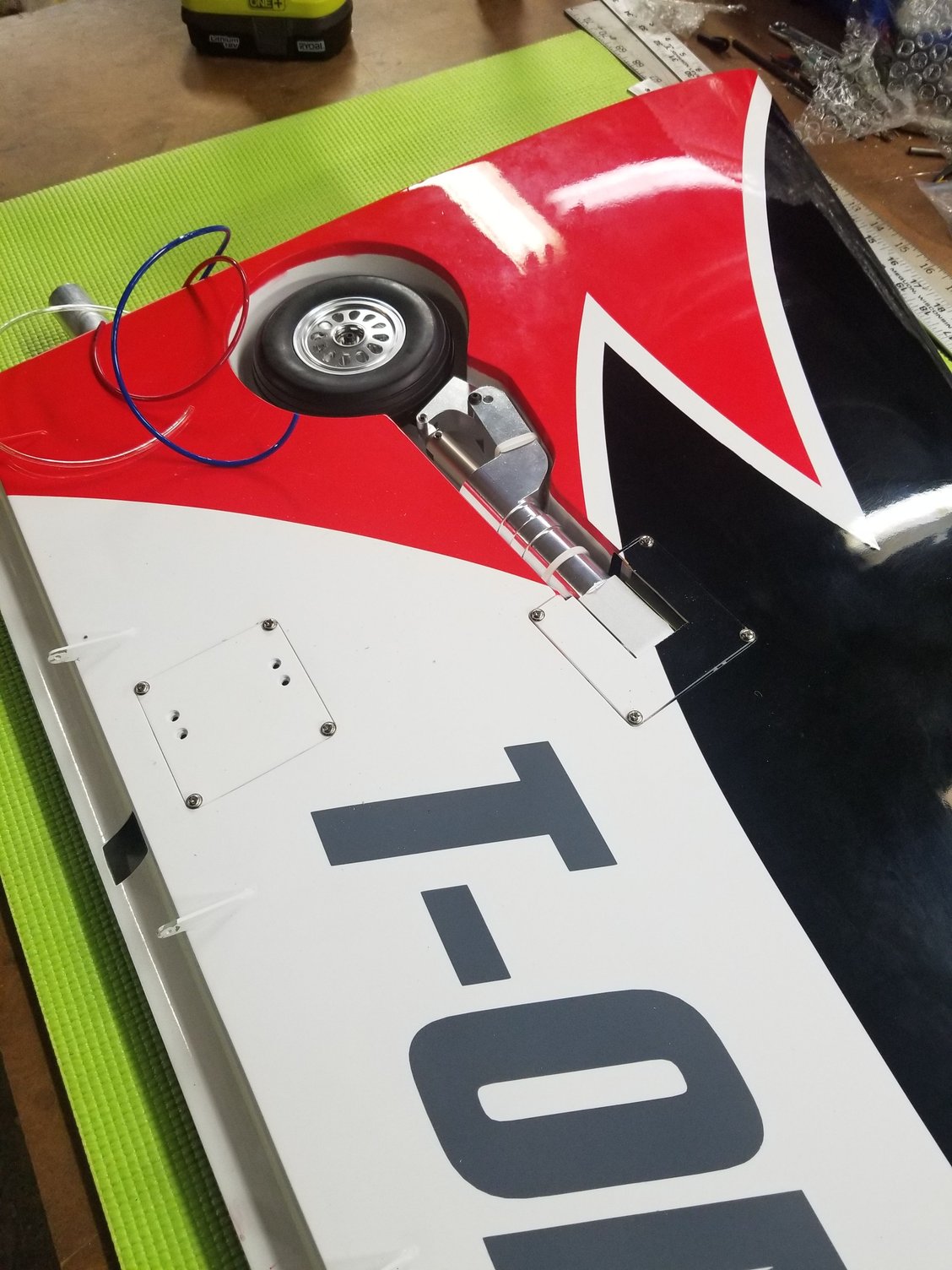

Jsnipes, What did you use to fabricate the holders for the covers for the main landing gear? Just realized the plane didnt come with anything to mount those with. I was seriously looking around for like 2 hours thinking I lost them. Thanks

See photos below. They were hand fabricated from a piece of plastic.
Last photo shows the strut cover trimmed to avoid clearance issues since I mainly fly from grass.
Hope this helps.

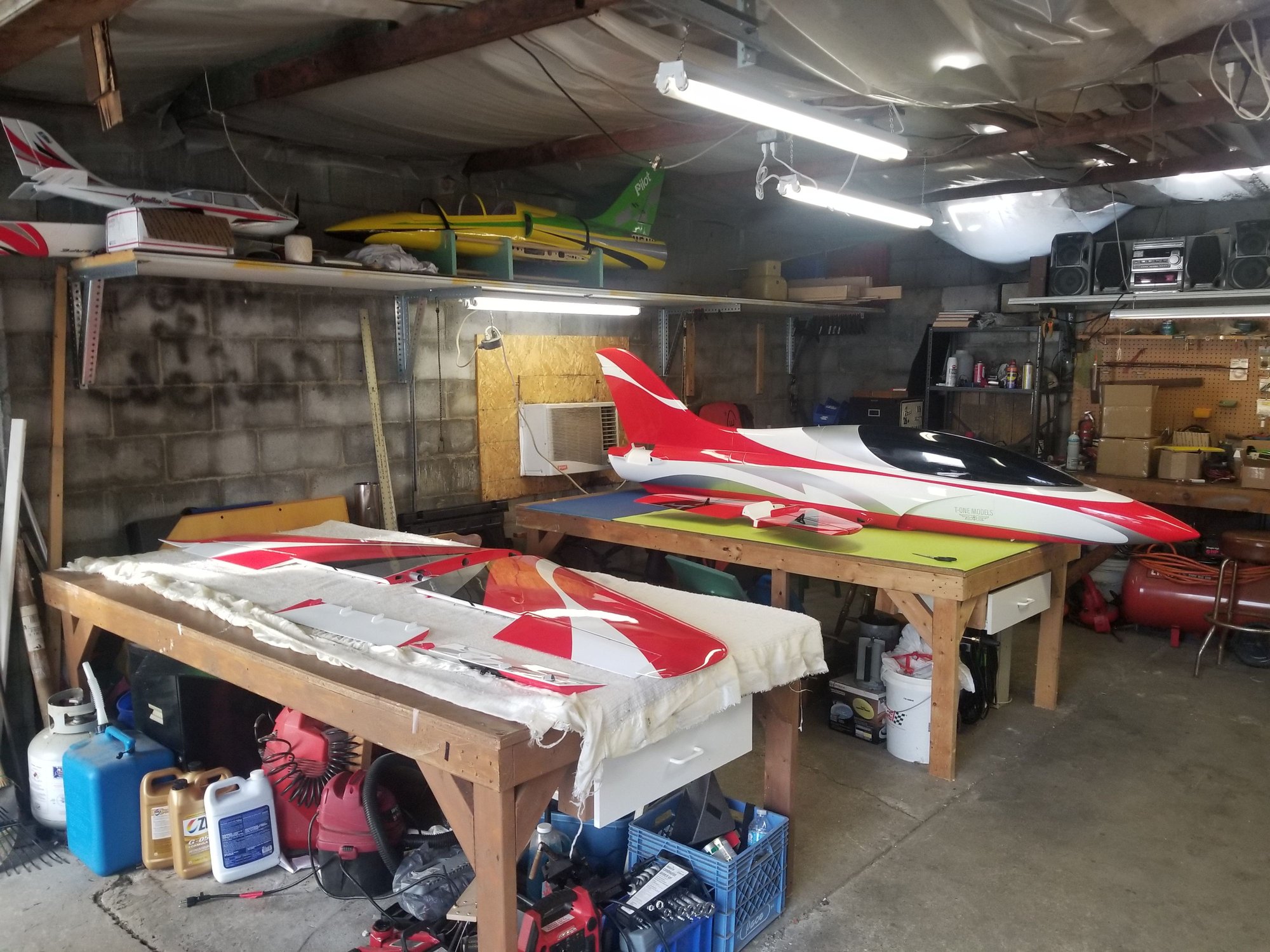

Let's see if it's easier to post pics now...

Not bad... at least they aren't upside down!

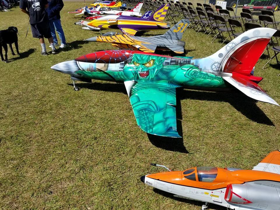

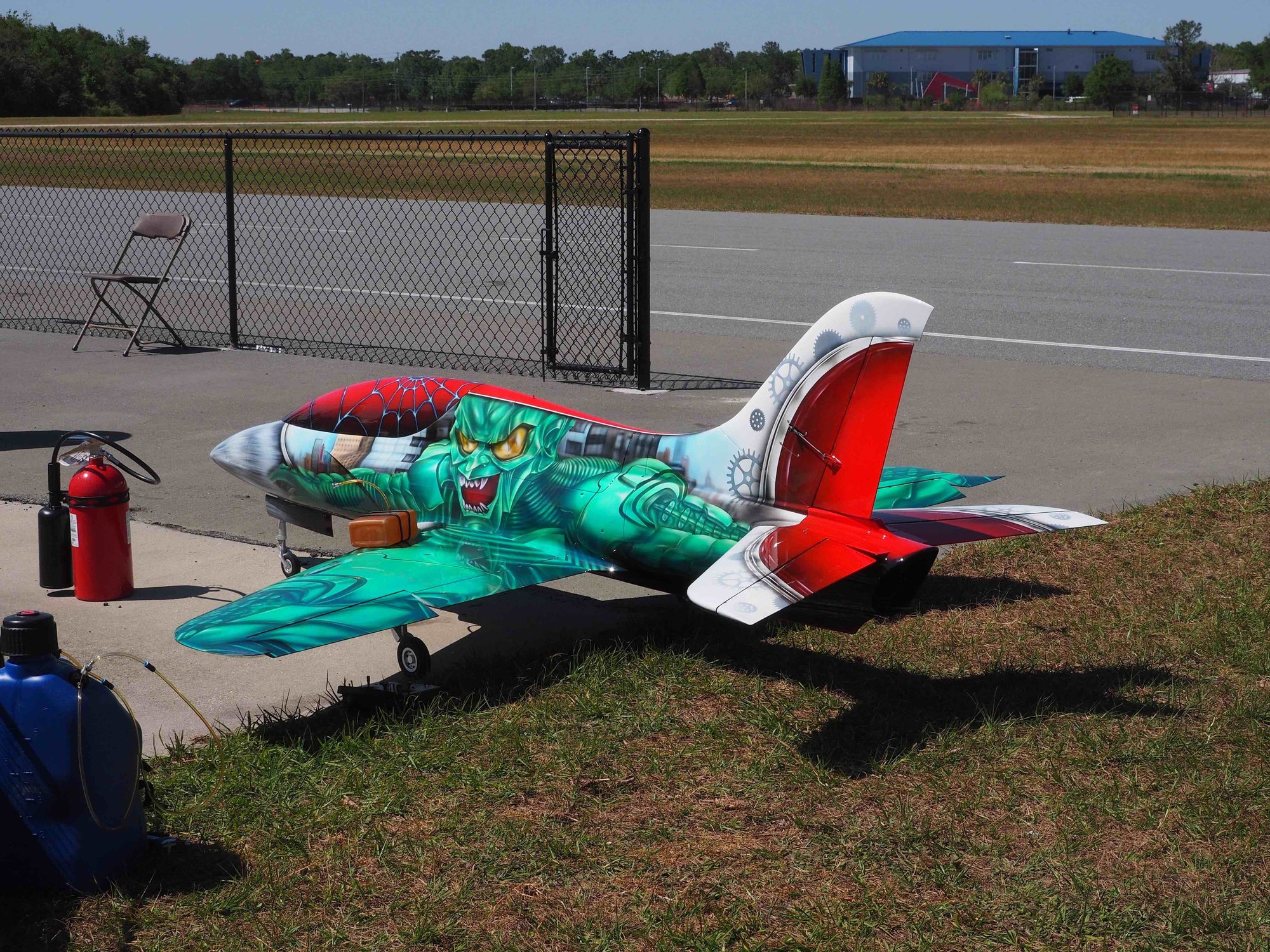

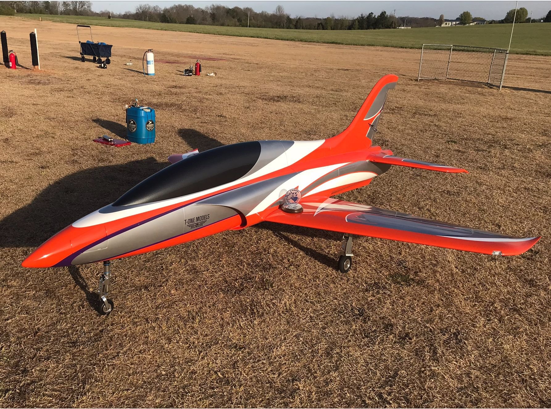

Florida Jets and my Green Goblin T3.. Kris maiden it for me and did a HELL of a job...
clavin is offline

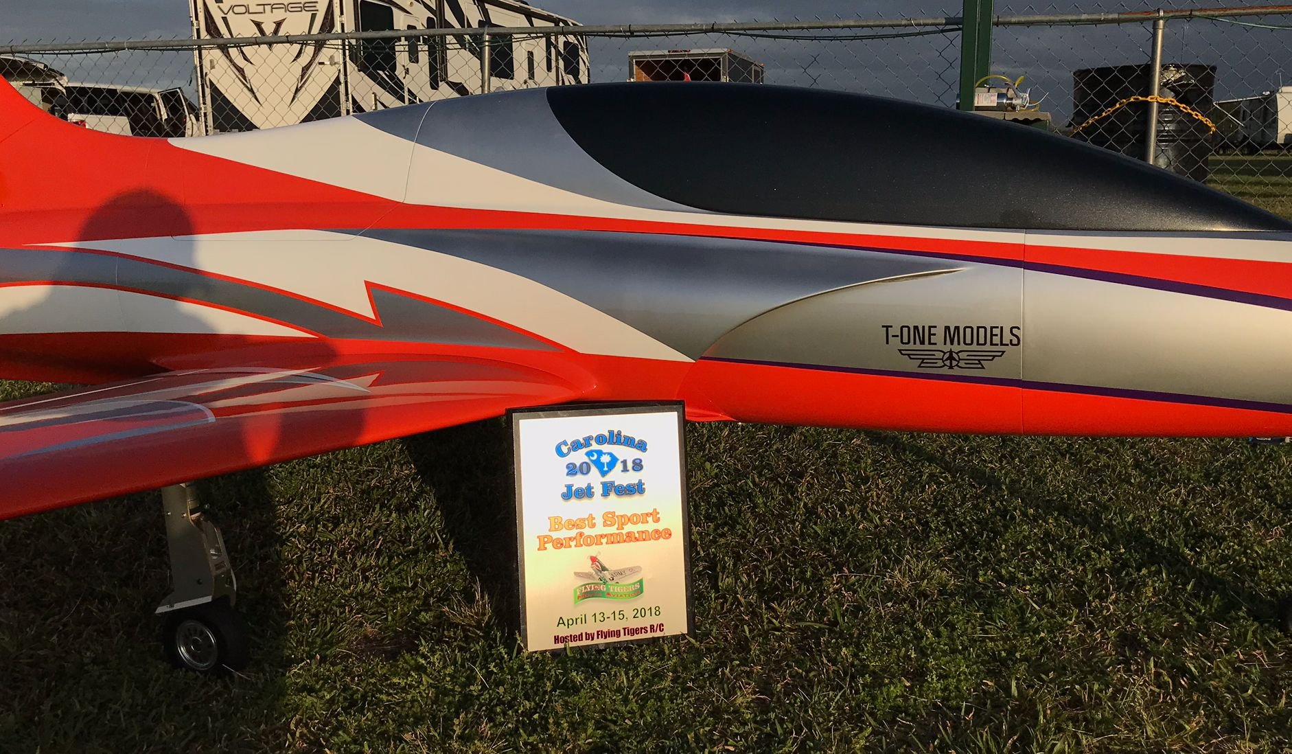

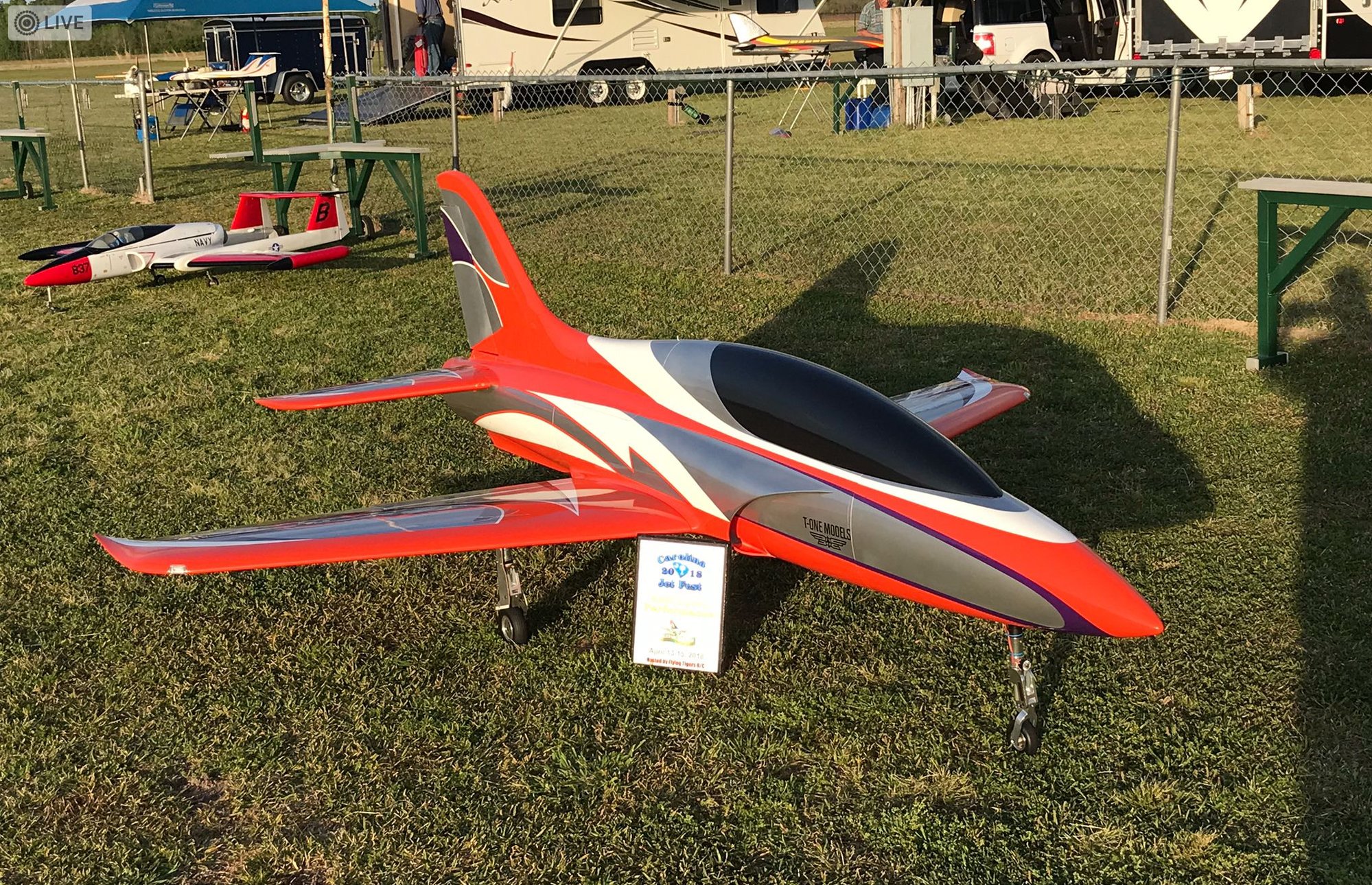

Two for two! 15 flights on my T-3 at this weekend’s Carolina Jet Fest jet meet. Fully dialed in and flying great! Thanks to T-One Models and Pacific RC Jets for providing such a great airframe. PBS 230N turbine is perfect match. Jeti CB200, MKS HV777A+, and Cortex Pro for guidance. JS
jsnipes is online now

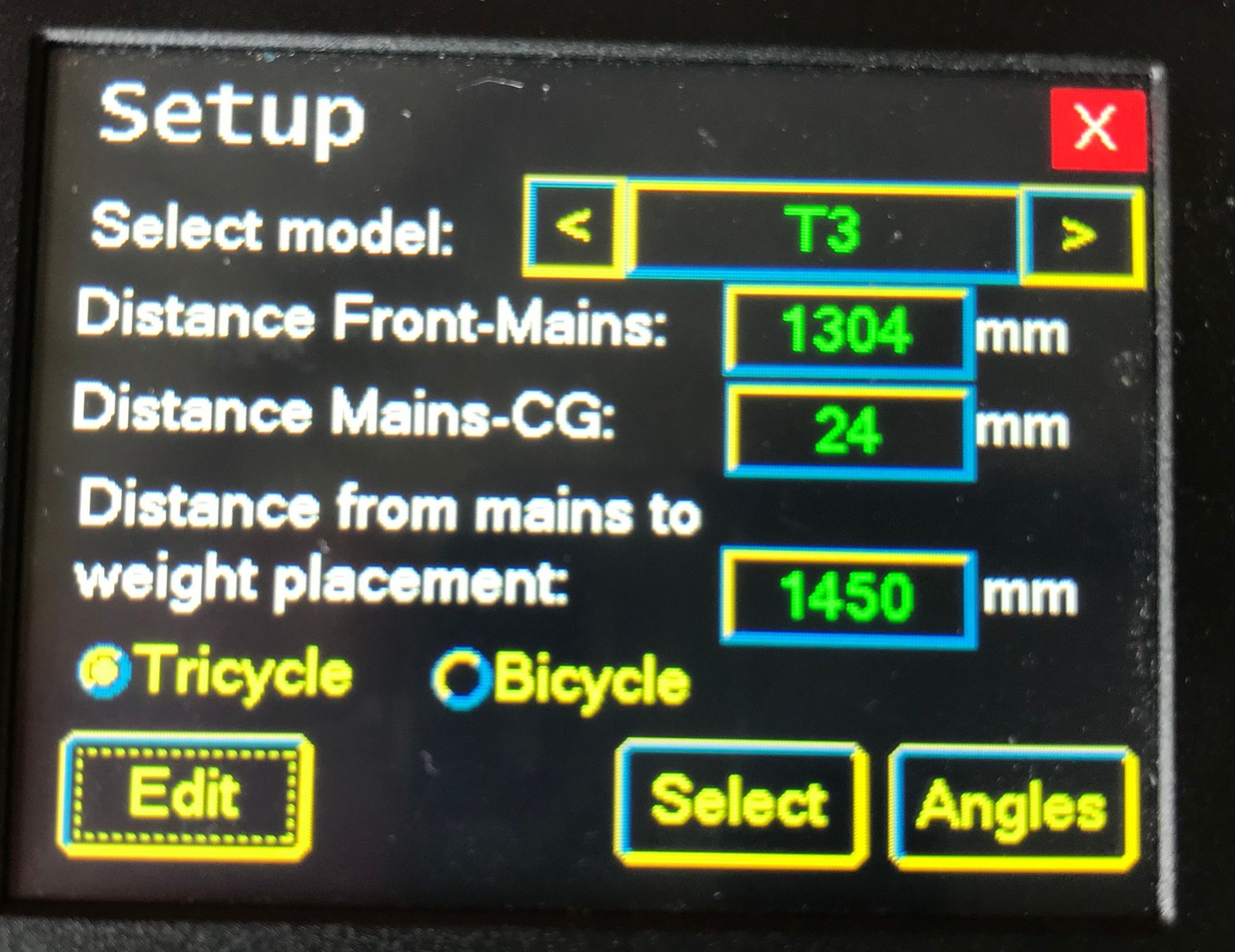

CG is ~355mm. See pic below for Xicoy CG settings.
Cortex Pro is -35 gain for flying and -60 for landing. (Rate mode only) Gyro setting will affect expo setting.
I am only using one rate for takeoff/flying/landing. I’ll have to measure the actual control surface movement next time out.
My expo settings are 41% aileron, 25% elevator, and 40% rudder for the throws I fly with.
Aileron expo is higher than I expected with using a gyro but it is what it is. I tend to fly smooth maneuvers so others may prefer less expo than me.
Hope this helps!
