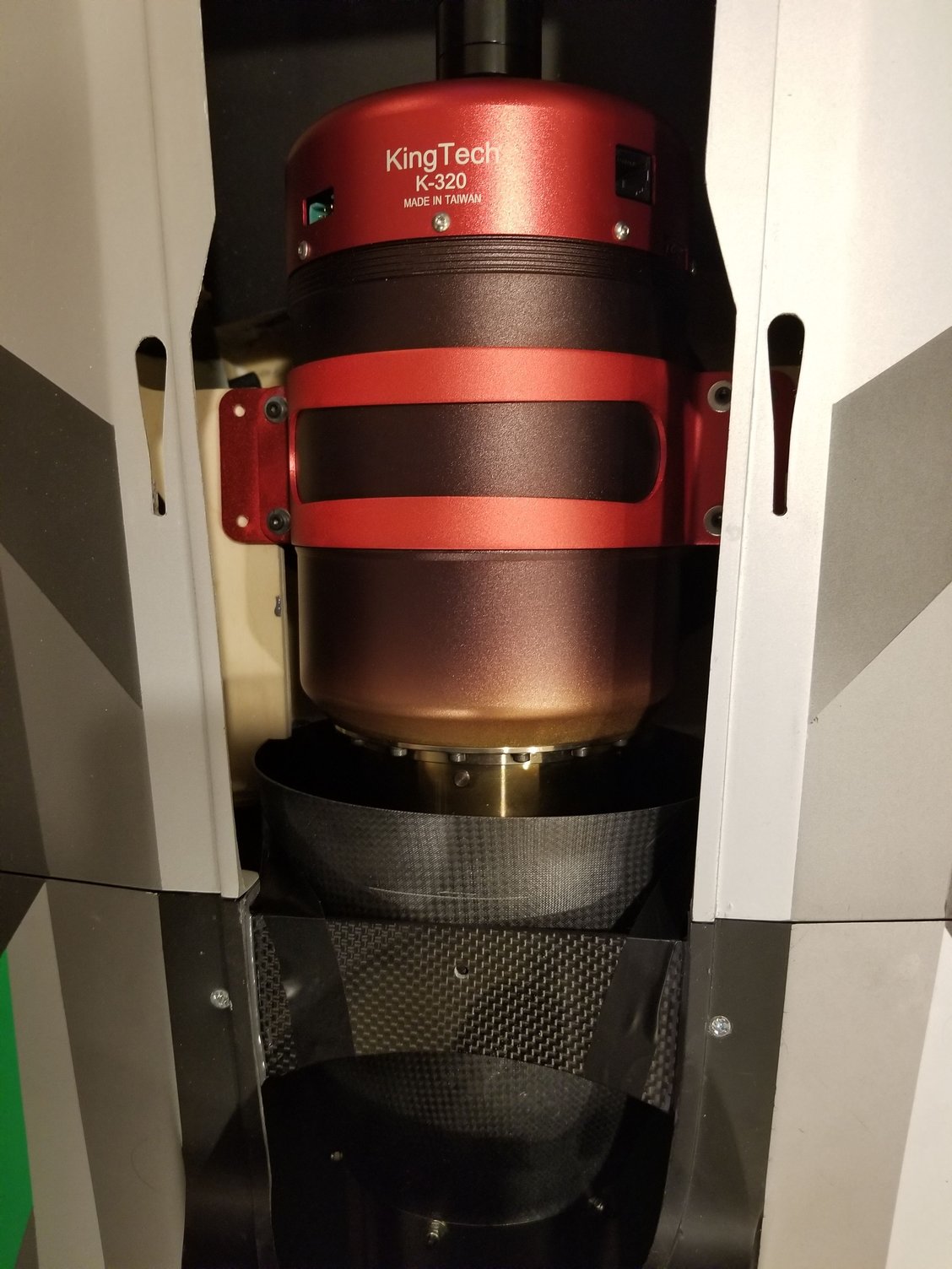

Guys, what do you think about this engine location? Assuming that I'll cut 1 inch from the carbon of the cone of the pipe. So all in all, the engine cone will be 1.25 inch into the carbon cone. (Currently it's 2.25 inch in)
Do you think it's okay to place it all the way in the front of the miunt?

Its the gap between the turbine tail cone and start of the steel pipe tube that is important. Set that around 45mm. The carbon bell needs cutting back as much as you can for max thrust. Having the mount at the front of the wood rails should not cause any issues.

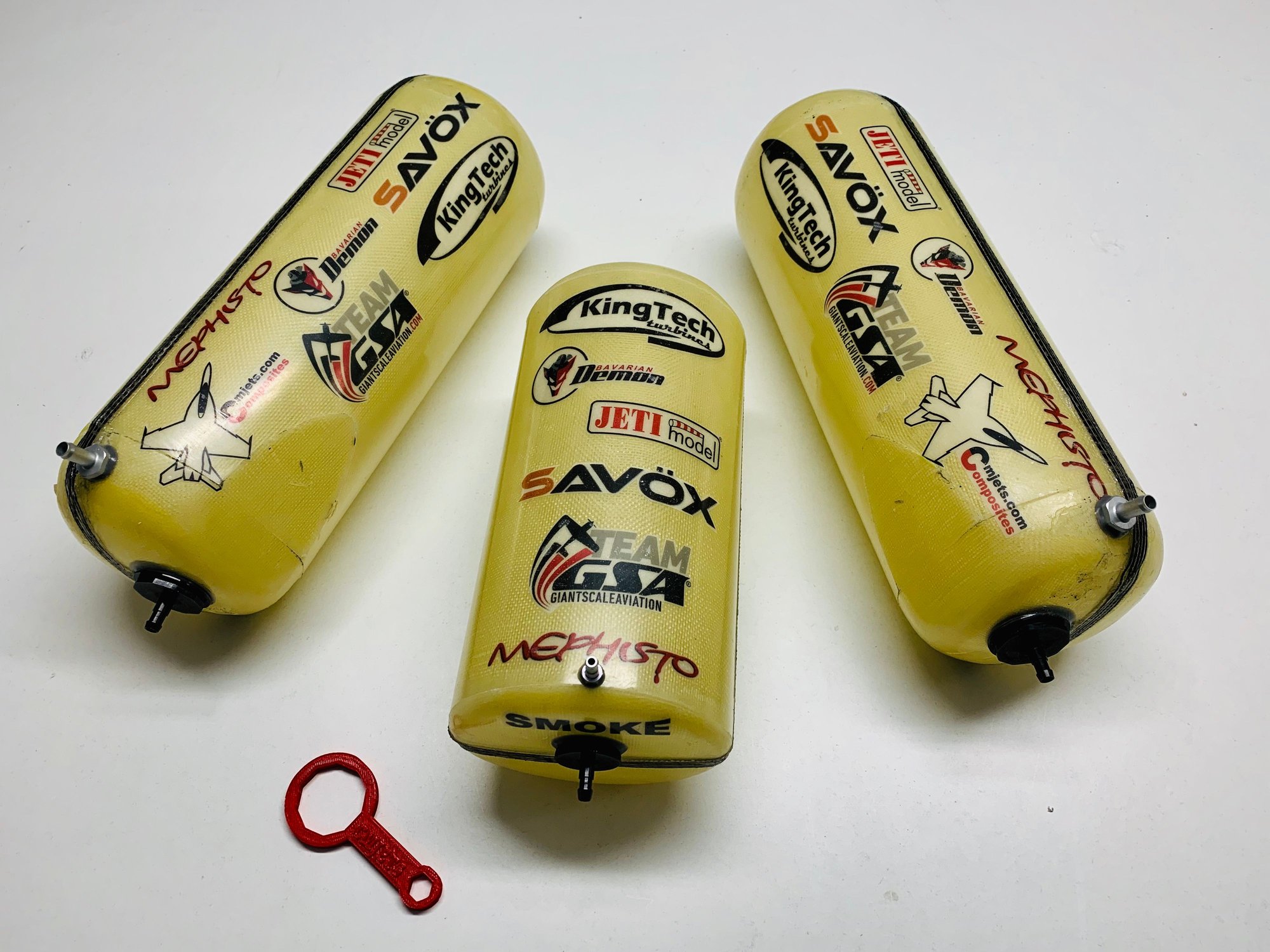

Default Mephisto set Tanks
hi all, here another set of Tanks.
BR from Spain
Carlos
Thank you Dave!
BR from Spain
Carlos
Hi Carlos,
Is this set lighter than the original one supplied with the kit?
Ziv
ZivBit is online now
Reply With Quote

cmjets
cmjets's Avatar
Join Date: Apr 2005
Location: Pontevedra, SPAIN
Posts: 1,574
Gallery
My Gallery
Models
My Models
Ratings
My Feedback
Yes sir, same weigh aprox. I will take a picture of weight for show you.
BR.
Carlos

Hi again, my tanks completed, with 30gr metal clunk for smoke and felt filter and hight Flow fittings for kero, are:
kero tank 190gr
smoke tanks 150gr
BR from Spain
Carlos

  #316
Dave Wilshere
Join Date: Jun 2002
Location: Watford, UNITED KINGDOM
Posts: 10,317
Gallery
My Gallery
Models
My Models
Ratings
My Feedback
Just weighed a CARF tank and its 172g with tube and clunk. Don't have a smoke tank here.
Dave

18gr not is weight

For 18grams Ill go kevlar all the way!!
I got the tracking Carlos, hoppefully i can fit the tanks Next week!!
thxs a lot

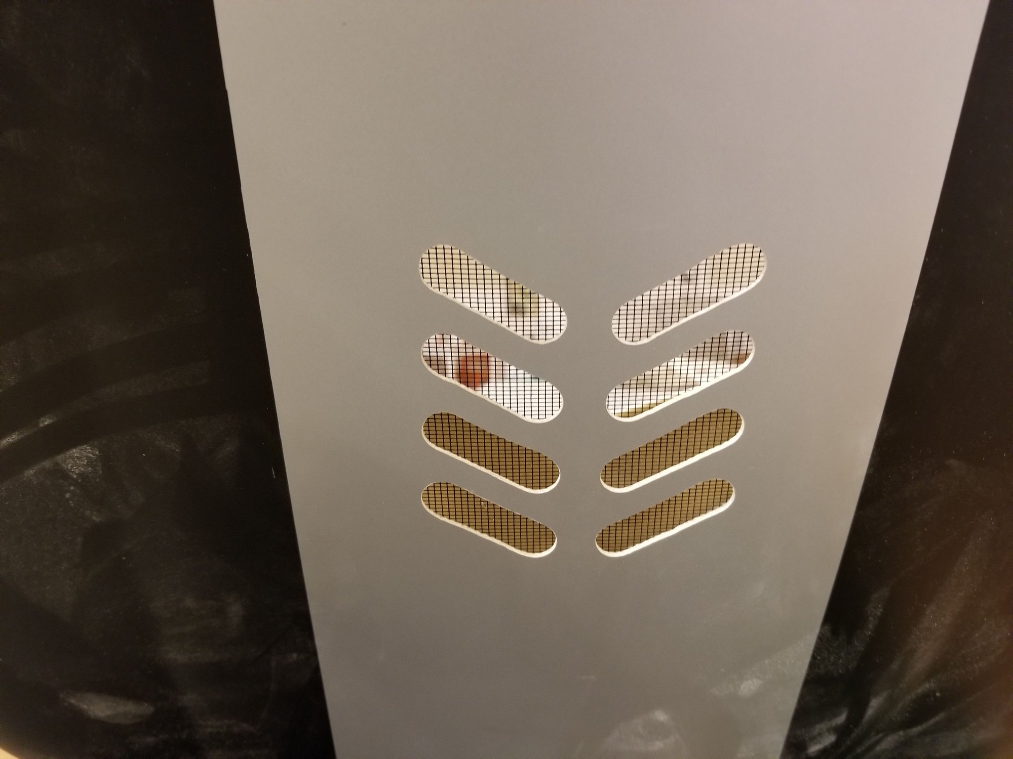

I zivbit-ed my middle wing thanks for the idea, Ziv!

Ha ha... Great one Elad.

Nice job!
