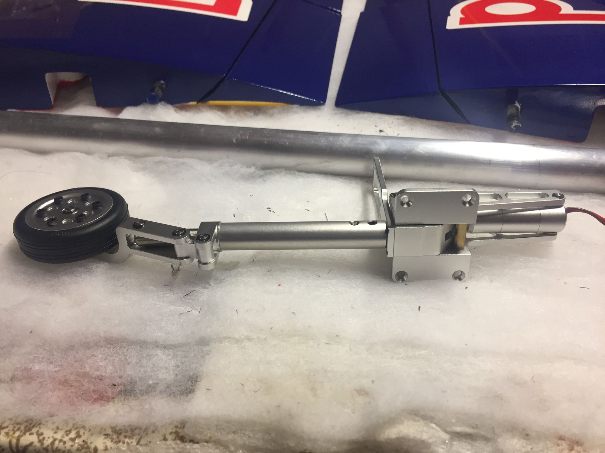

Would somebody that very recently received their Mini do me a favor? Please post a picture of the main landing gear with the wheel and tire. If something's changed, I'd like to update the manual.
Thank you!

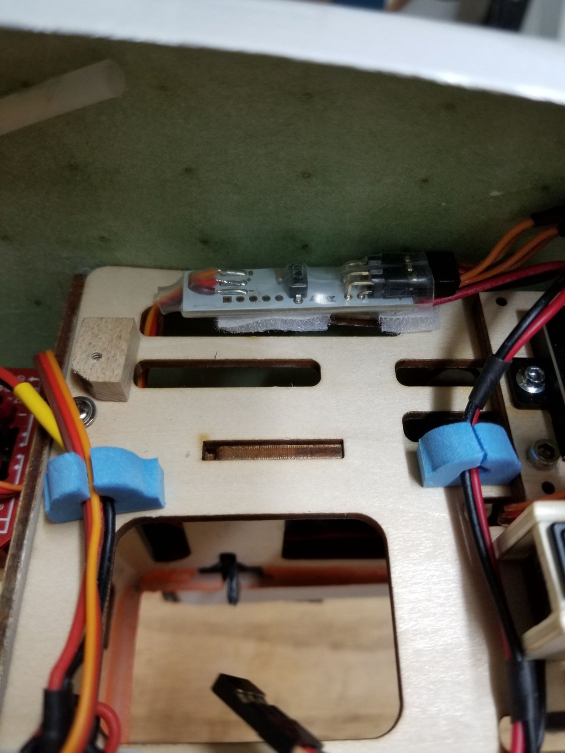

Xicoy brake controller
I hav had a problem with the latest jp brake controller, flat spots on tires as the controller will not soften the brake pressure very well.
i removed the jp brake controller and replaced it with the tiny xicoy brake controller. 48 dollars at DreamWorks. It really works much better. Noticeably so..It has 5 different brake settings. I just installed it so i have not flown with it yet.
my jp controller weighed 2 oz and was over the nose wheel.
my cg went from 190 to 200mm when i replced it with the xicoy.
Thank you!
I received mine about 3 weeks ago if that's recent enough. I've not started the build yet. I'll post up a picture when I get home from work this evening.
Speaking of that manual, a HUGE thank you for that. This is my first turbine build and as the plane didn't come with a manual, yours will be a huge help.
Jason
Air3D540 is offline
Reply With Quote

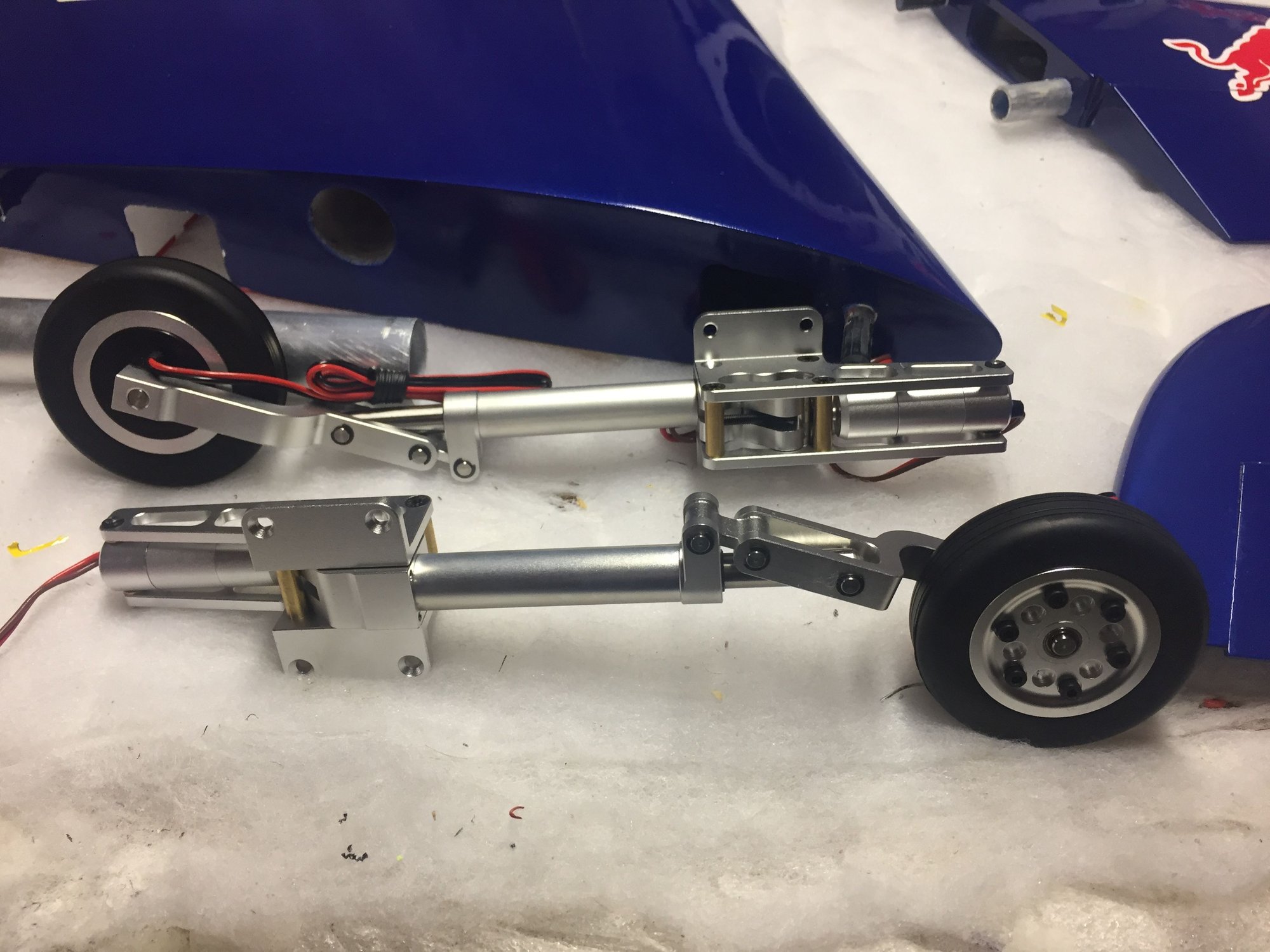

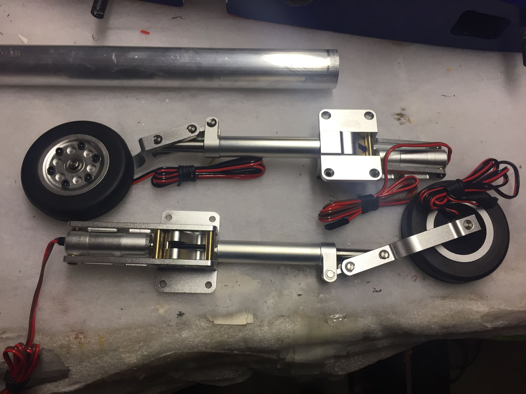

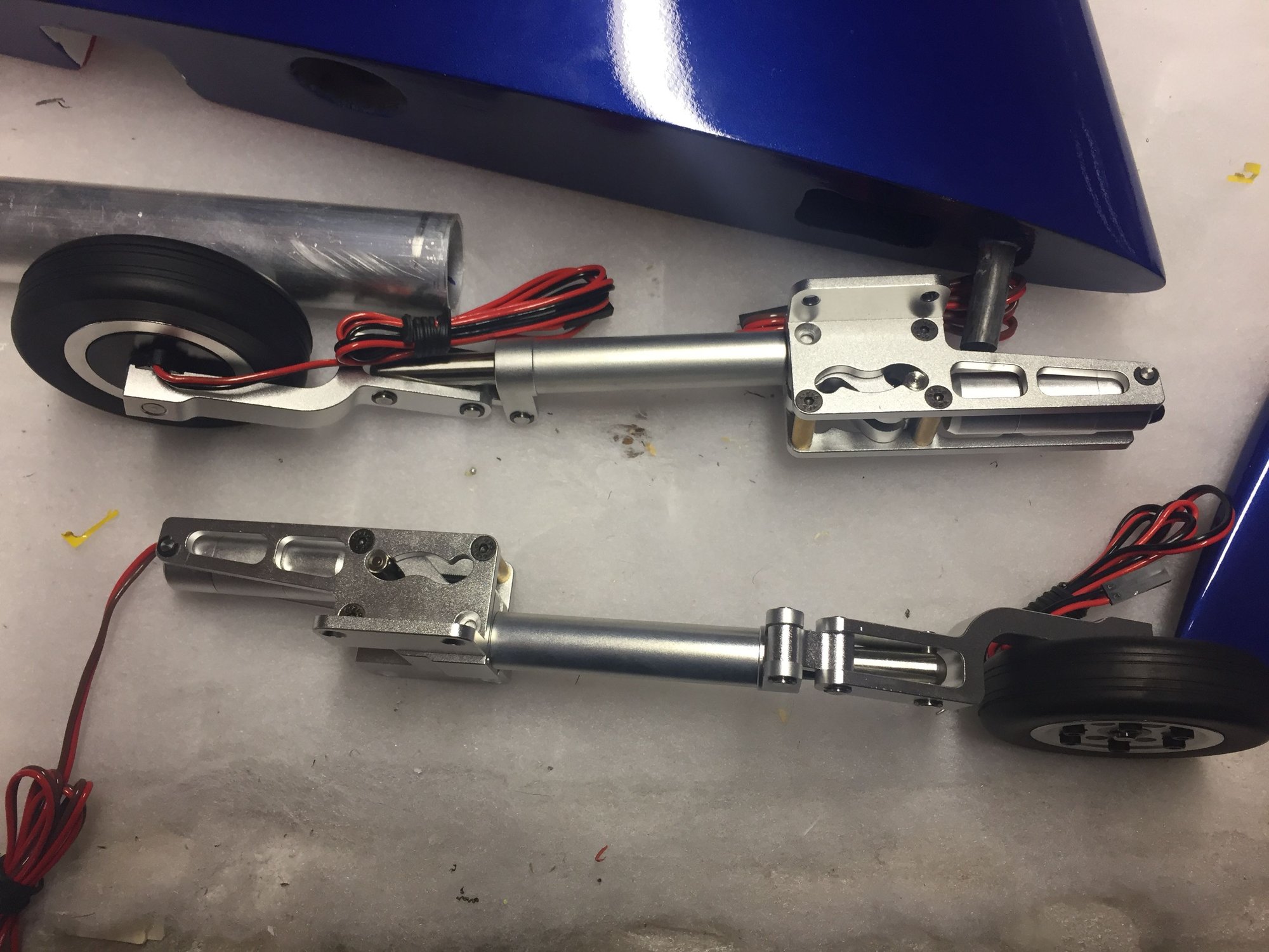

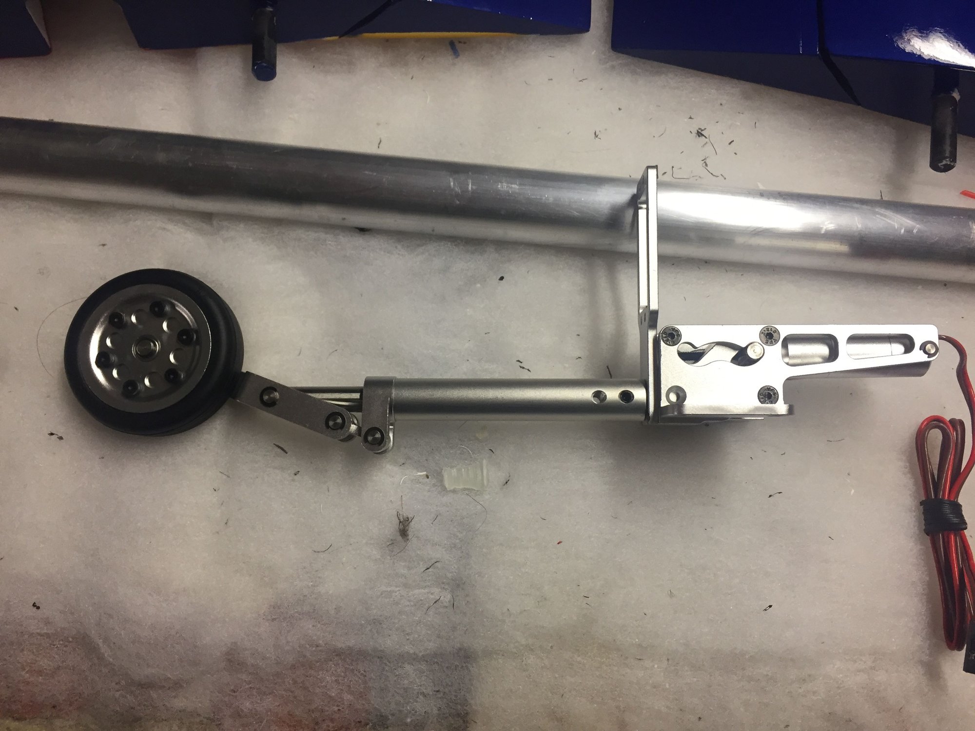

Thank you!
Here are the mains and the nose as well. It was delivered about 3 weeks ago, so fairly recently.
Air3D540 is offline
Thank you for going through the trouble. I really appreciate it. I don't see anything different from the the ones on mine from August.
