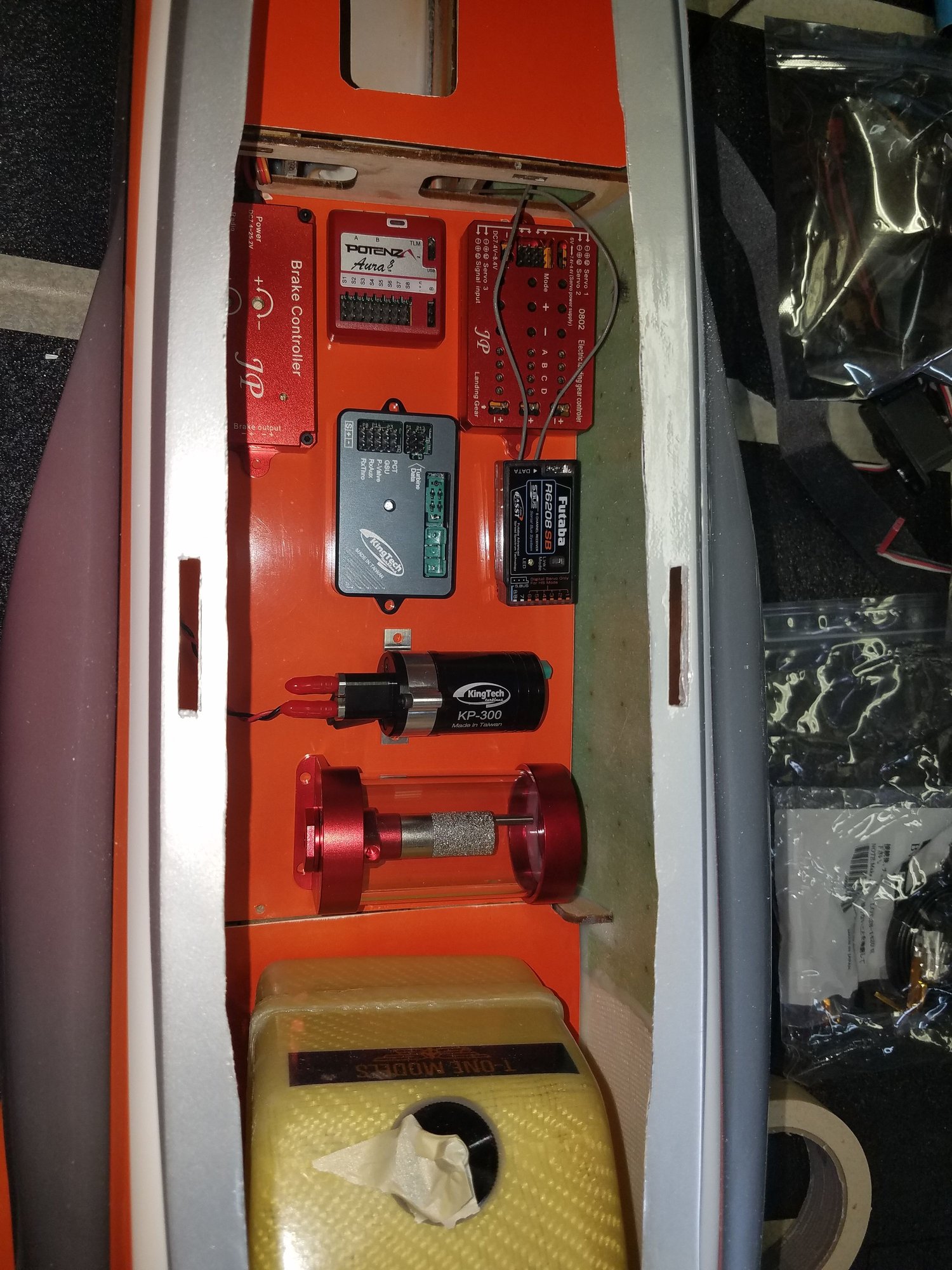

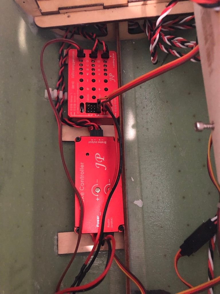

T-One installed the gear and brake controllers under the main deck. This is cool and they are out of site, but it seems like if I ever need to get to them, I'll be pulling the main-fully-populated-deck out.
Do you see a problem with the config like this? They did a great job mounting them.

I had done the same with the gear/brake controller......but in your case you got the updated separates controller for the brake/doors and gear and the brake could need adjustments....

I considered mounting them there but did not for the exact reason you mentioned. Didnít want to have to pull the whole main deck to get to them. You can see where I located them in my pic, you can just see the edge of the brake controller at the bottom of the pic mounted in the front above the nose gear.

Hey there.. The Mini looks great! Once you get your gear and door setup done you really wont need to mess with it any longer. For the brakes you might need to adjust the power. Once done you should not need to mess with it ether. They install them there to keep them out of the way. again these are not something you will need to access all the time. Good luck and congrats....

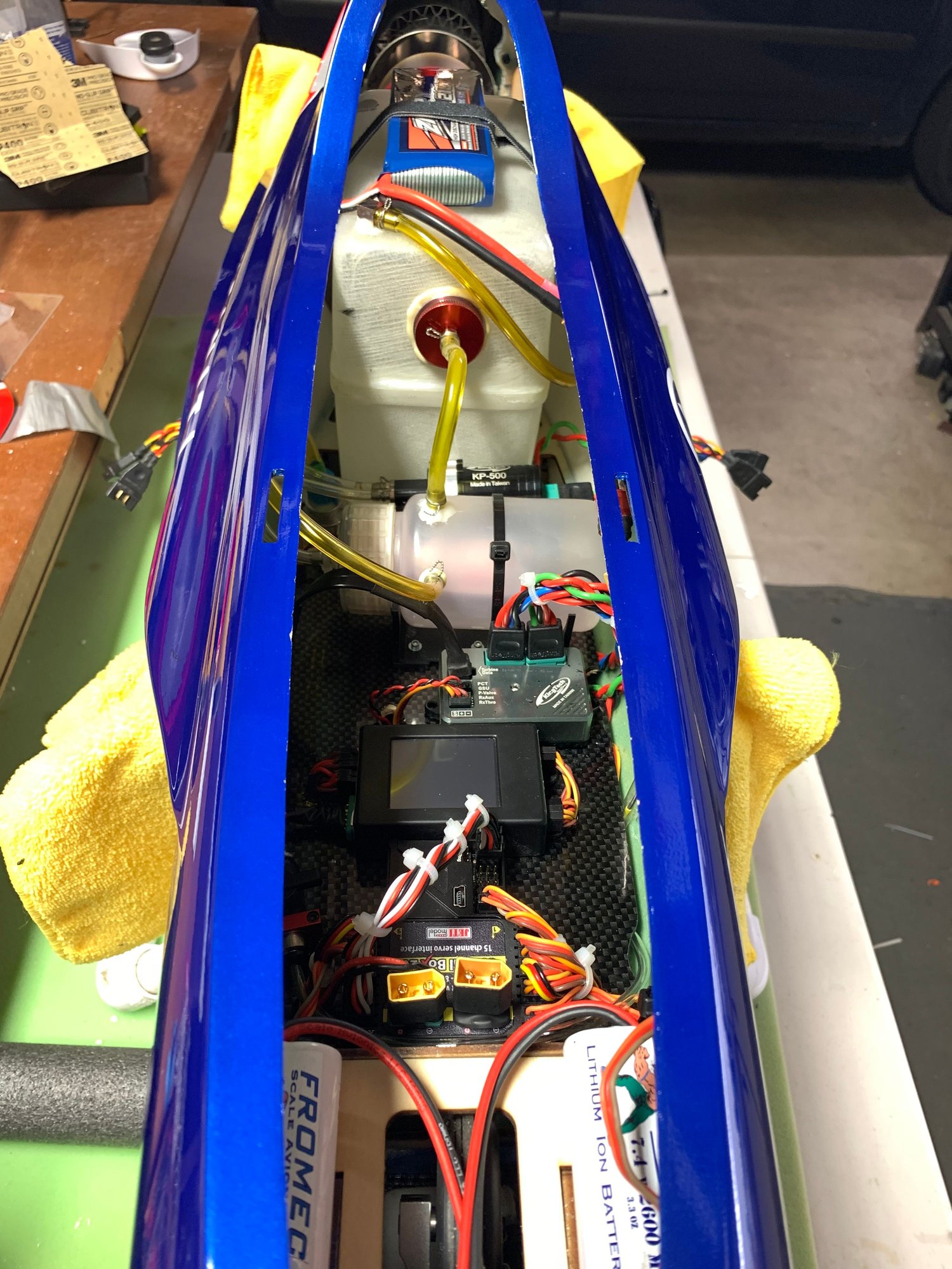

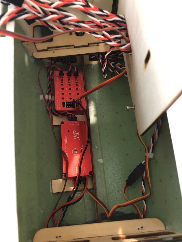

Come on Dan you could have gotten a full size T1 in that car. Also I mounted my controller underneath the main deck in my T1 and have not had any issues with it. I did mount a separate switch to turn the gear controller on and off between flights so I am not sitting there sucking down battery. I know at idle they don't take much, but I like to be safe.

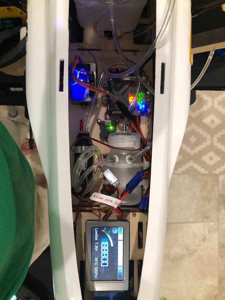

Here is my setup with CB200/cortex pro. This gives a CG about 195. I have another mini with Powerbox Mercury SRS and similar battery placement, which flies nicely for me. I understand many prefer the CG farther aft. If you are new to jets I urge you to start farther towards the front end of the recommended range and slowly work your way back.

I mounted all of my gear on the wooden deck so I would be able to get to it if need be.

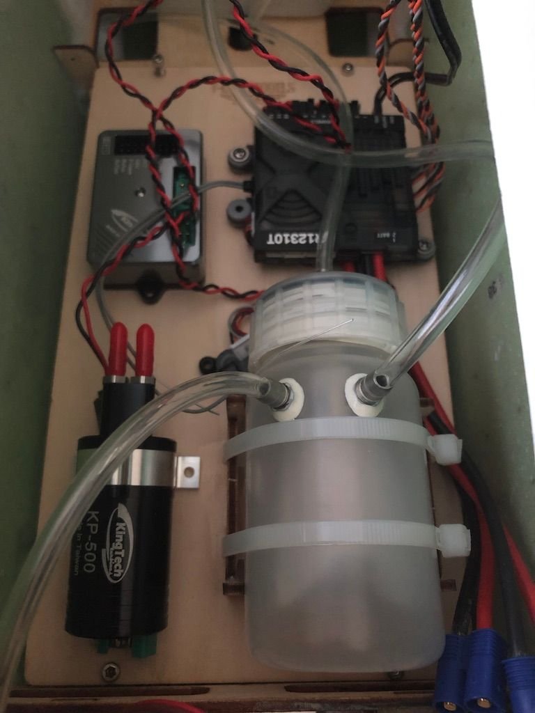

Messy, but getting closer.... Going to balance again tonight and then lock things down.
Q: Is it ok to put the fuel filter in the second bay, closer to the turbine?

Fuel Filter anywhere after the pump is fine
