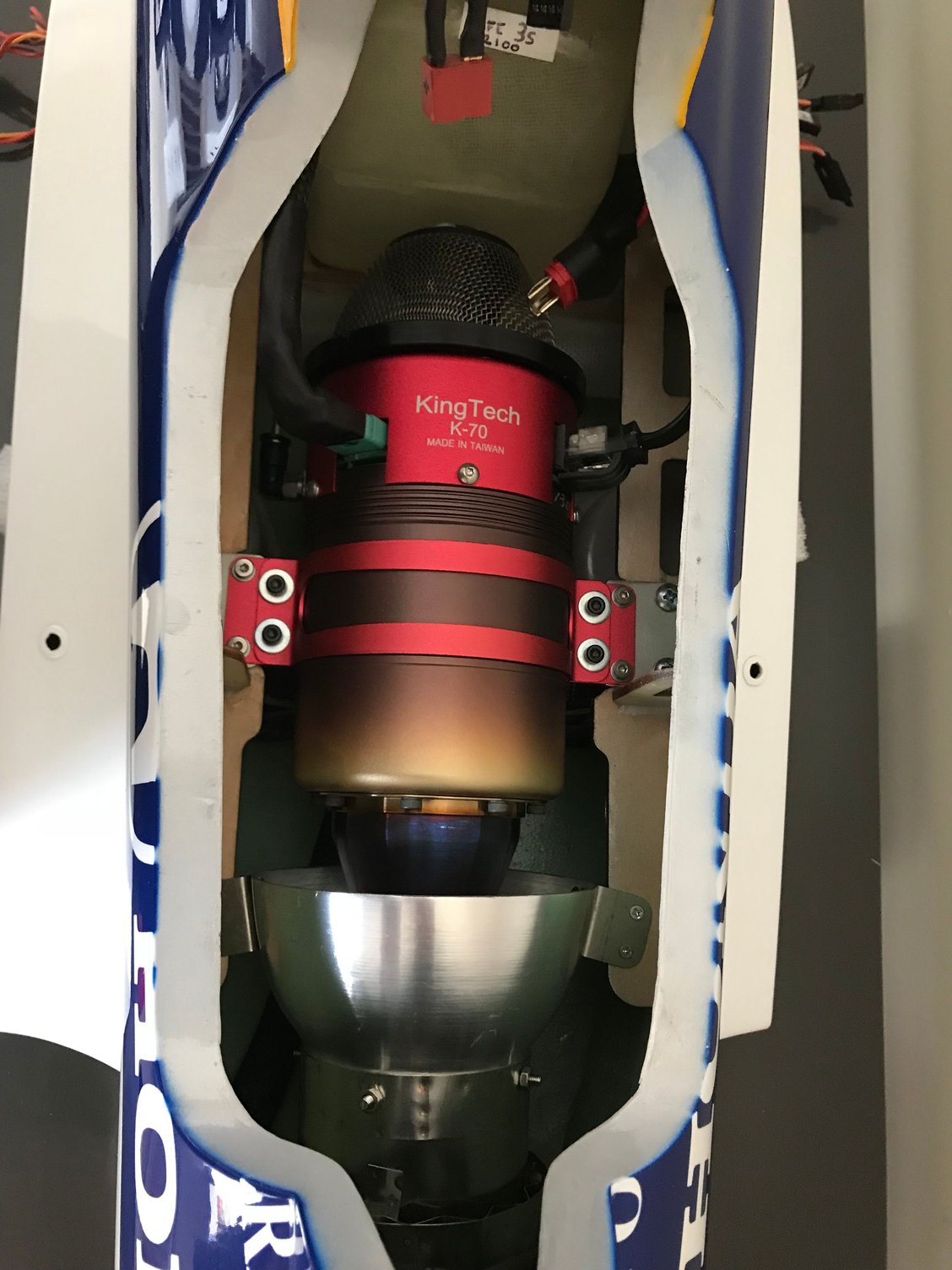

Maidened my mini last week, I have my CG at 200mm (UAT full) in the rear of the wing tube, 2x 1300mah lipos over the nose wheel and 1x 3s 2100mah life over the tank.
flies really well on the K70, might turn down landing flaps a bit from 70mm, needs a lot of down elevator when they are down although the plane does fly well at high and low speed
Strange all the CG variation but I thought mine flew well at 200mm, i also have a powerbox Mercury at the front and the turbine just before the former.

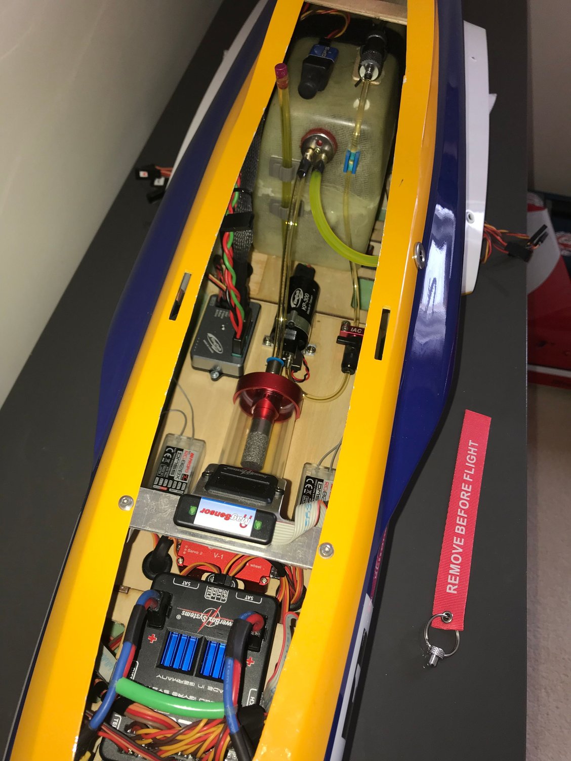

I flew mine for the second time this past weekend, it feels much better now. I moved my two flight batteries from over the tank to over the nose gear, I left the 2100 LiFe turbine battery over the tank. I'm also using a Mercury SRS so my setup is very similar to Joe1199 above. It requires just a hare of down elevator when inverted early in the flight, pretty much neutral towards the end of the flight. I flew my big T-1 right before I flew my T-1 mini and they both feel the same except the mini is much more sensitive in the roll axis. Speedwise, my mini with a K85 feels faster than my T-1 with a KT 140, but I have not substantiated that with GPS/Radar numbers yet. Smaller aircraft usually feel faster to me so it could just be my perception of the speeds.
Tip22v is offline

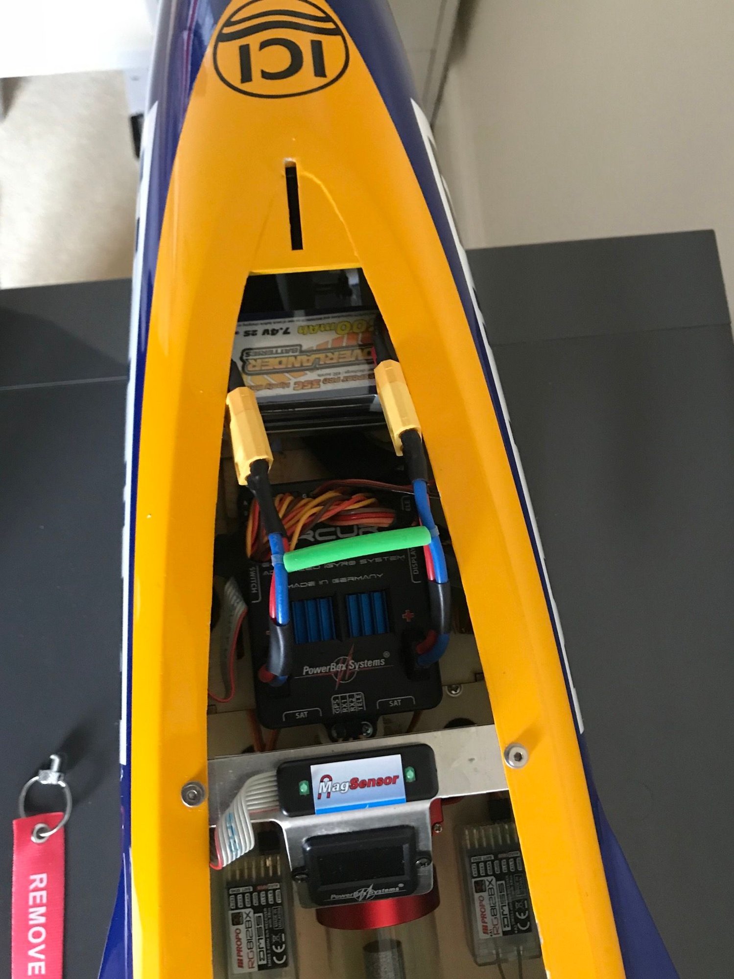

Originally Posted by Joe1199 View Post
Tip22v, where would you say your CG is on the wing tube now you have moved your batteries? Similar to the picture above? Or further forward now you have adjusted balance
With my rx batteries moved over the nose wheel my CG is 75mm in front of the line between the main gear struts, which is about 182mm on your ruler or slightly forward of the center of the wing tube. I've used two different Xicoy CG computers to verify my numbers and I still can't figure out how folks are getting 200mm without putting all batteries over the fuel tank. What I do know is that when I had all my batteries over the fuel tank my CG measured 199mm (aft side of wing tube, just as your ruler is placed) and it flew a little tail heavy for my taste. I've only been flying turbines for six years so I'm relatively new to them comparatively, plus I fly at a field that is relatively small compared to other fields so I find myself making tight turns fairly often, which can be disastrous in a swept wing, with lots of elevator throw and a CG that is more neutral because you can easily get the wing into high angle of attack and stall even at mid throttle or more. This almost happened to me twice on the maiden of my mini. Fortunately, moving the batteries forward has helped out immensely and my second flight was much more fun!
Are you using a CG computer? if so, can you post a picture of weights on your mains and nose wheel? I'm curious as to how your weights compare to mine?
Tip22v is offline

I got two more flights on the T-1 Mini yesterday. After the CG changes, and some further tweaking of the aileron throws and down elevator with full flaps she is now flying almost exactly like my larger T-1. Yesterday I flew both my mini and my bigger T-1 back-to-back multiple times and I can hardly notice any difference in their handling and flight characteristics. The T-1 mini definitely seems faster than the full T-1 but I have not measured the speeds empirically so it might just be my perception. I am very impressed with the fuel economy on the K-85, both flights were just over five minutes and I landed with just over half a tank, I'm confident I could have flown another two - three minutes with plenty of reserve. I'm still fighting the asymmetrical braking as our runway is not very long. I ran a test on the factory retracts and the cutoff amperage looks to be about 0.4 to 0.5 amps. Sometime soon I'm planning to switch out the factory controller for a Xicoy gyro assist controller I purchased a few weeks ago. If anyone has already done this I would appreciate your feedback on your settings and how well it's working (or not working).
I'm done talking about where the CG measures out to be, what I can say definitively is that if you put your two receiver batteries over the nose wheel and your turbine battery over the fuel tank you'll be close on the CG, you can then tweak from there based on your personal preference.
